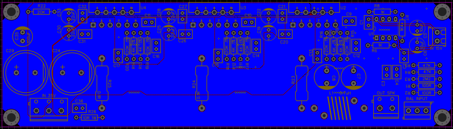

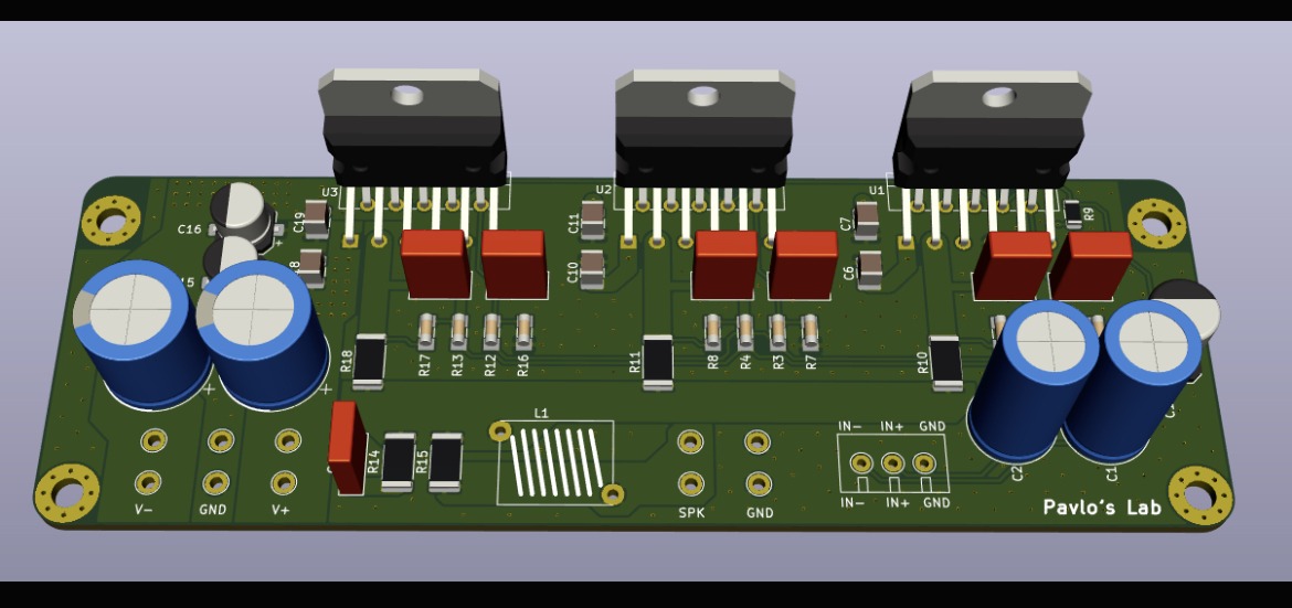

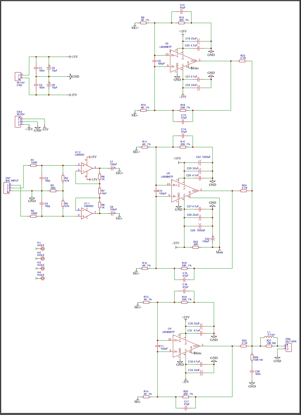

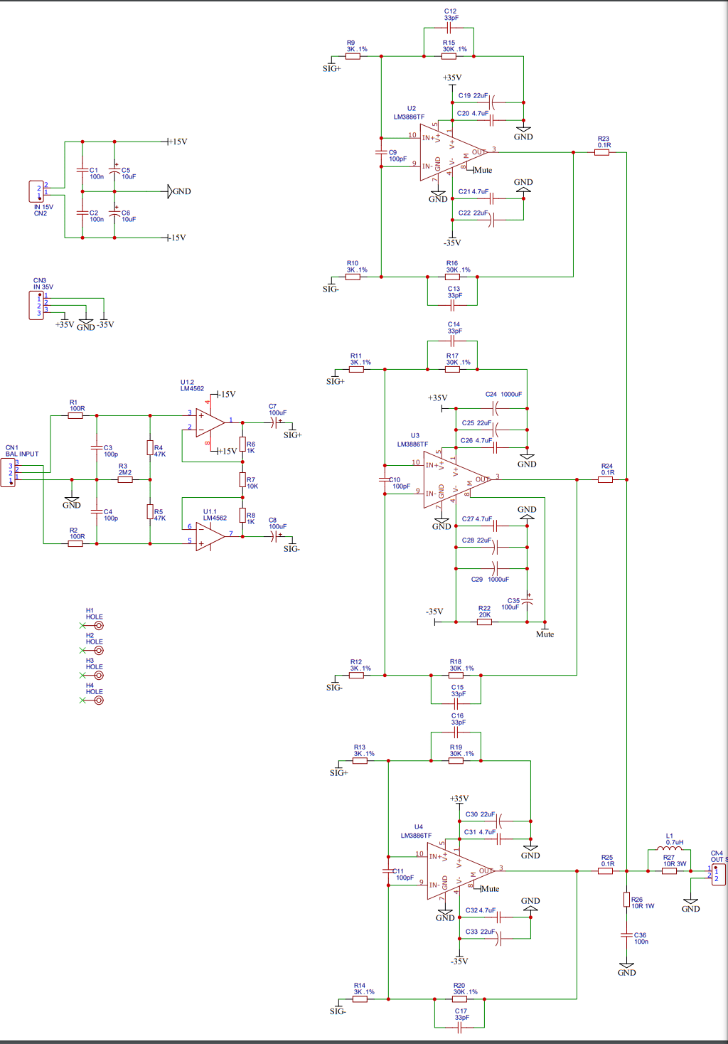

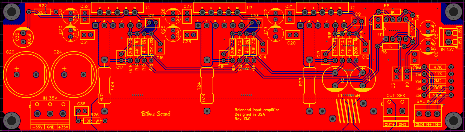

Schematics and gerber files are in attachments.
It is not the best practice to parallel amplifiers like this, but I went for it anyways just for fun!
Noise gain is 10 V/V
Signal gain is 20 V/V
It is essential to use 0.1% feedback resistors:
Any thoughts are welcome and appreciated.
- it will improve CMRR as each LM3886 acts as a difference amp
- it will match the gain for all three ICs - which in turn creates less standing current in output ballast resistors.
Stability components C12-C17, C9 - C11, and L1 R27 should assure good stability at the gain of 20k/4k = 5 for each of LM3886.LM3886 noise gain = 6 whereas DS says min stable gain = 10?
Gain of the first stage is 1 + 2*1k/1.4k = 2.4287
Total gain = 12.14 and allows for output voltage swing of ~ +/- 34 V - assuming power supply voltage of 36V to 37V should fully utilize those chips.
Overall gain can be configured with only one resistor - R7:
- 2K will give you gain of 10
- 1.8k -> gain of 10.5556
- 1.6k -> gain of 11.25
- 1.5k -> gain of 11.6667
- 1.4k -> gain of 12.1435
- for speakers with 8 ohms each chip will see 8*3 = 24 ohms
- for speakers with 6 ohms each chip will see 6*3 = 18 ohms
- for speakers with 4 ohms each chip will see 4*3 = 12 ohms
- for speakers with 3 ohms each chip will see 2*3 = 6 ohms - not recommended
My recommendation would be to go to a gain of say 12 (above the minimum for stability) and do away with all those comp caps.
Things like 100pF across the chip inputs are a brute-force way to ensure stability, they lower the loop gain and increase the distortion.

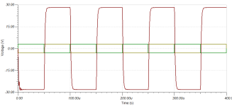

The compensation caps are only needed if you want good performance as the output swings near the supply rails. The LM3886 is perfectly stable mid-rail with a gain of 10 V/V (20 dB).My recommendation would be to go to a gain of say 12 (above the minimum for stability) and do away with all those comp caps.

Coming back to this post because I am not happy with the sound of my current build that does have cap across chip inputs.My recommendation would be to go to a gain of say 12 (above the minimum for stability) and do away with all those comp caps.
Not sure exactly what it is, but will be diving into trying different measurements and experimentation to hopefully pinpoint the issue.
Maybe after all it does make sense to omit that cap and raise the gain.
Note that THD measurements were excellent, but the amp still does not sound good.
Meaning probably need to measure something else... not sure what yet...
Maybe time delay in the feedback loop?... idk...

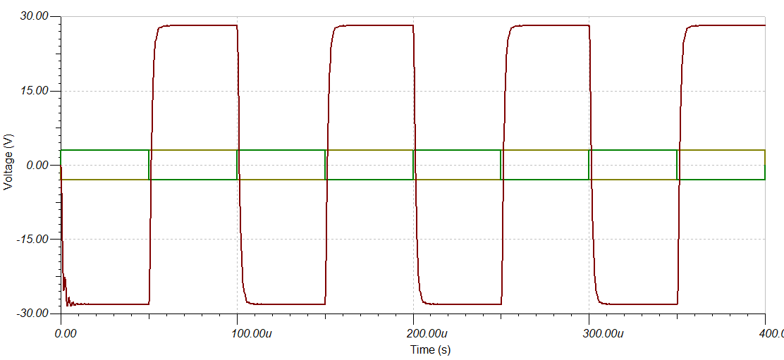

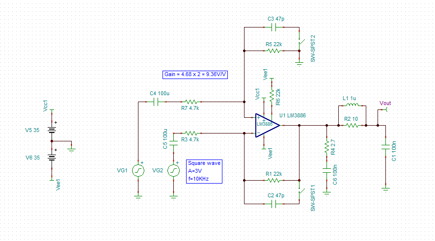

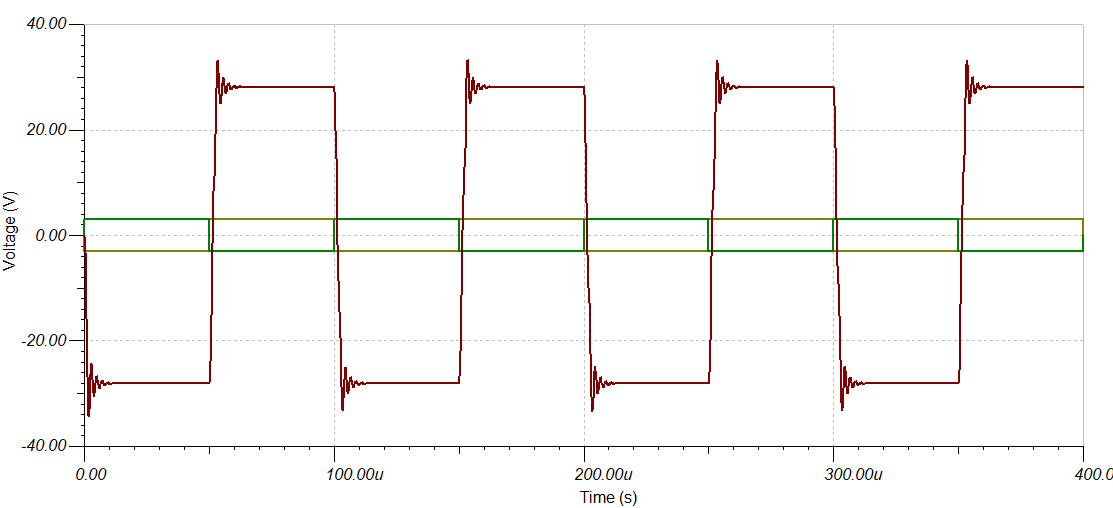

If LM3886 to be configured with gain of less than 10x, feedback lead compensation is needed for stability.
Cap across feedback resistor of 33pF or 47pF will accomplish that.
It will form a low pass filter with a feedback resistor.
It will also help to prevent stray capacitances from inverting pin.
Capacitor across inv and non inverting pins needs to be removed for compensation to work properly.

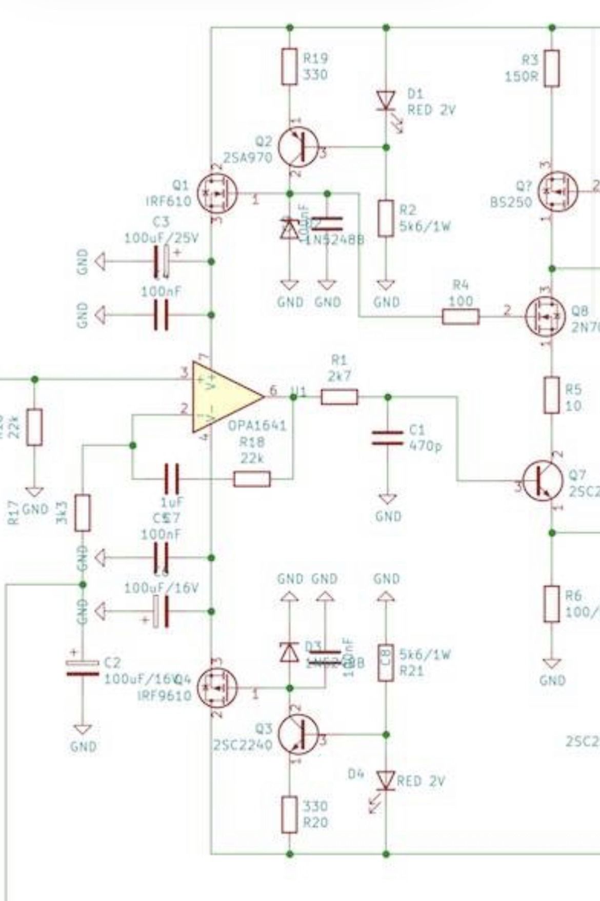

Some time ago I came by this amplifier called Q17. Here is the thread link - https://www.diyaudio.com/community/threads/q17-an-audiophile-approach-to-perfect-sound.374507/
It uses similar power delivery with CCS using MOSFETS. The author claims better sound when using them.
Schematic is attached
I’m currently working on design that will have three lm3886 with most components in SMD.
I’m also planning to put input buffer on separate PCB for two channels. Probably will add voltage regulators for 15V on the same board. Gain will be adjustable between 21dB, 26dB and 29dB.
As a result I am hoping to get THD+N below 0.001% at 5W and output power 70W/140W into 8/4 ohms loads.
I also test listened my previous builds against Modulus-86 and it did not sound as good at all. I fixed it by modifying compensation and by using film caps in the feedback loop.
Promises to be a fun project.
