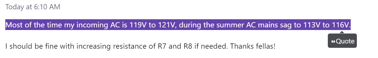

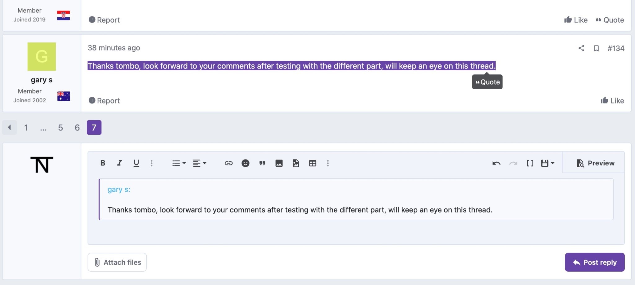

If you mouse-over and select the text from any post, including one directly preceding your own, a widow should appear with the option to "Quote" that section of text. See below for an example.The Forum software doesn't let you quote the immediately preceding post, regrettably. I guess it wasn't clear that #114 was a reply to #113.

You have fairly consistent mains then Vunce,Most of the time my incoming AC is 119V to 121V, during the summer AC mains sag to 113V to 116V.

It does if you mark some text... if you really want to be clear if you quoted the last post....The Forum software doesn't let you quote the immediately preceding post, regrettably. I guess it wasn't clear that #114 was a reply to #113.
