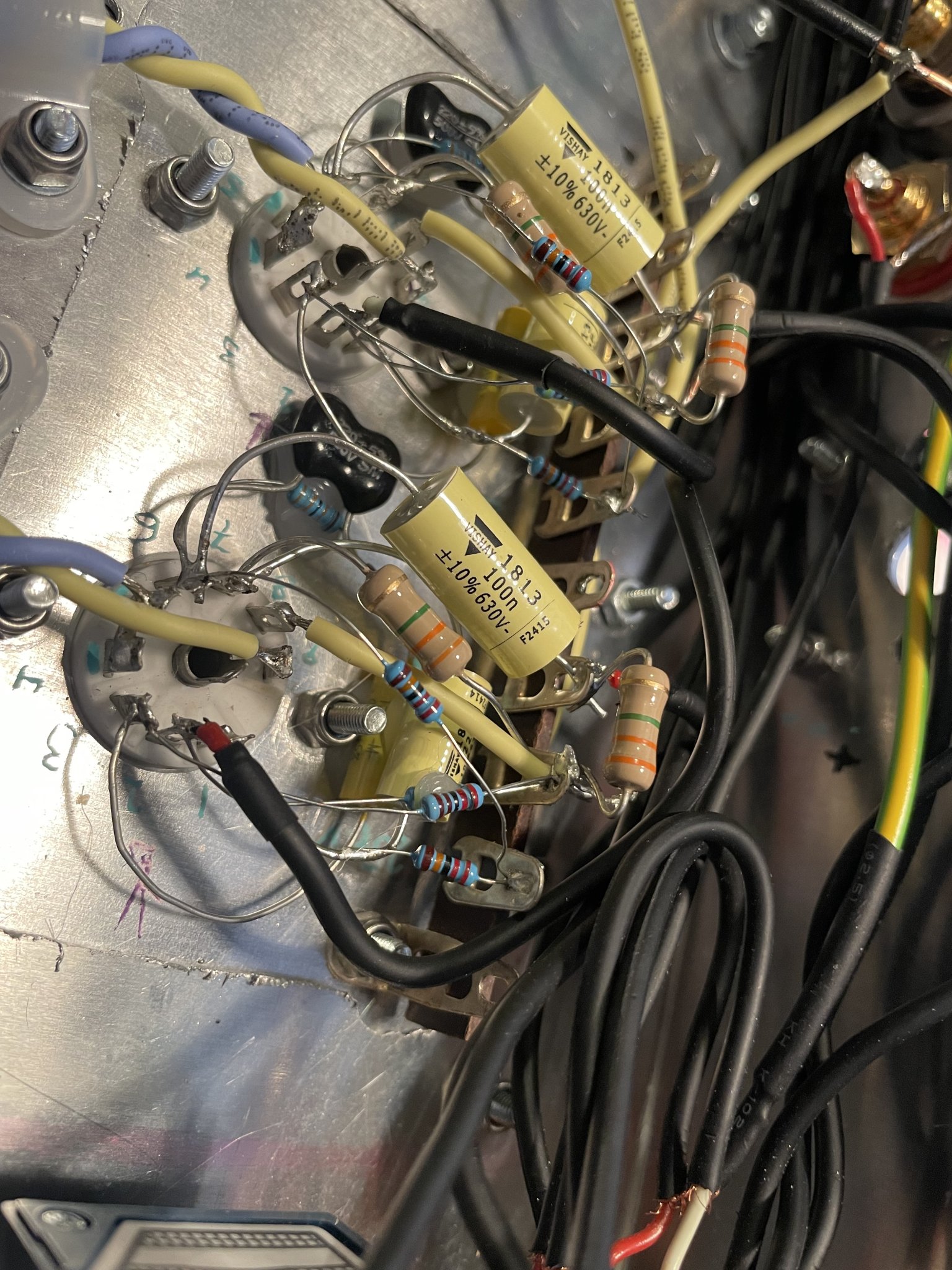

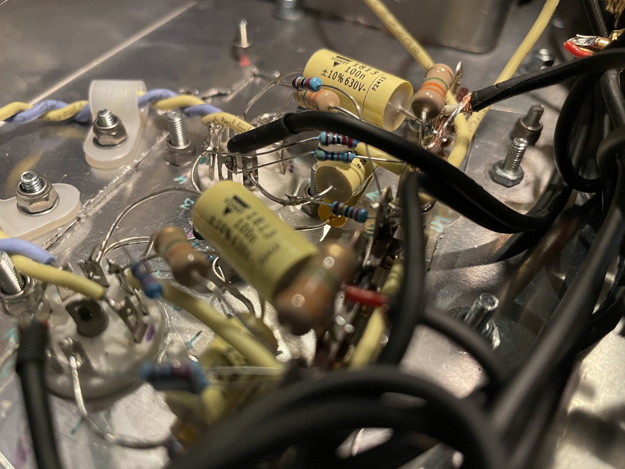

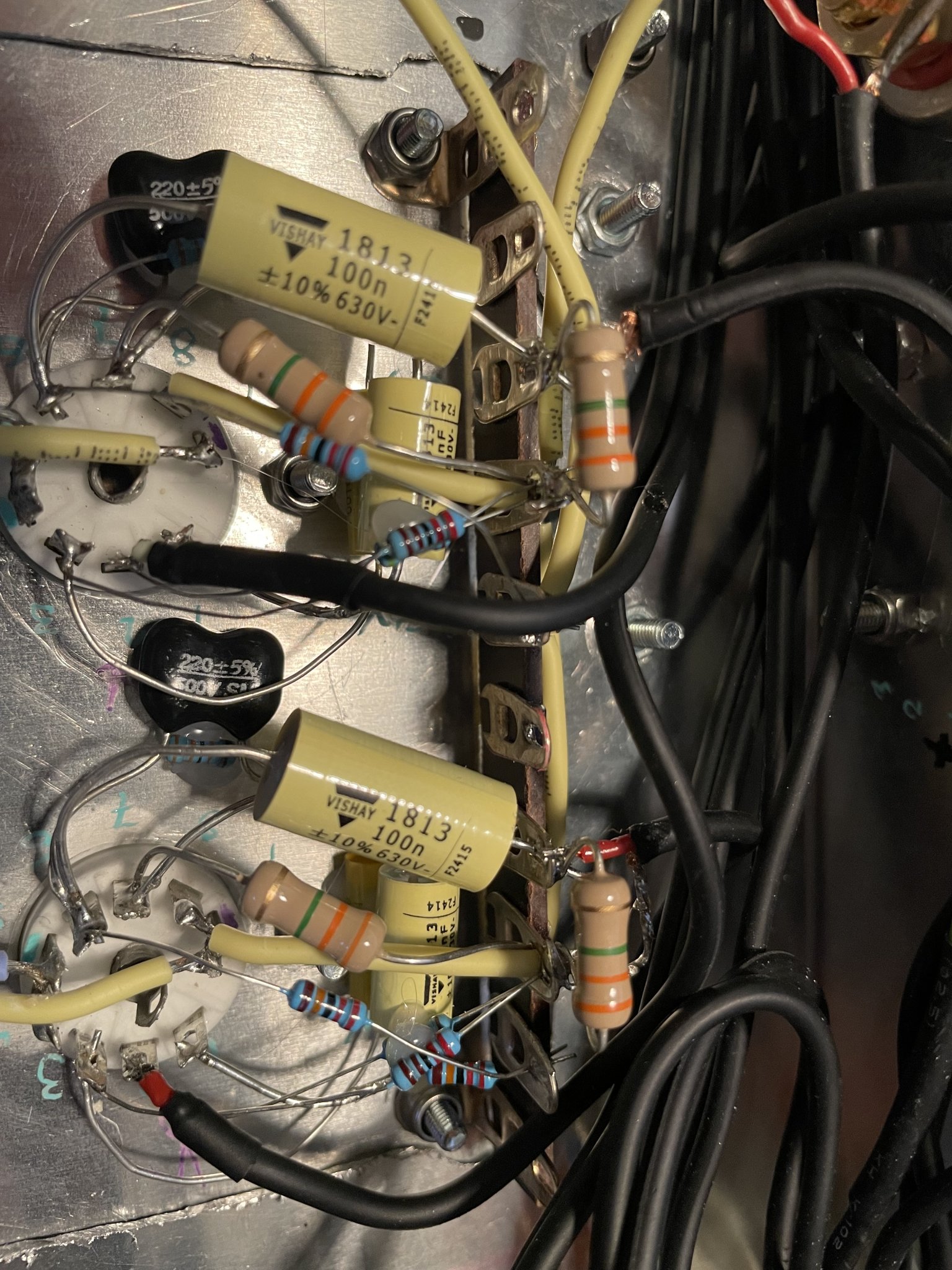

I've built a Angelfire phono amp (the second one) but it has no bass output. The cartridge is a Shure M44-7. It is a passive preamp with a phono stage. The other two inputs works great. The phono input has ample gain and no hum but it is very very bright sounding and lacks all bass output.
I've checked that all the components are correct, and they seem to be.

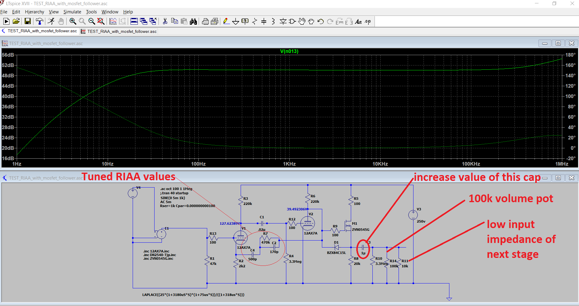

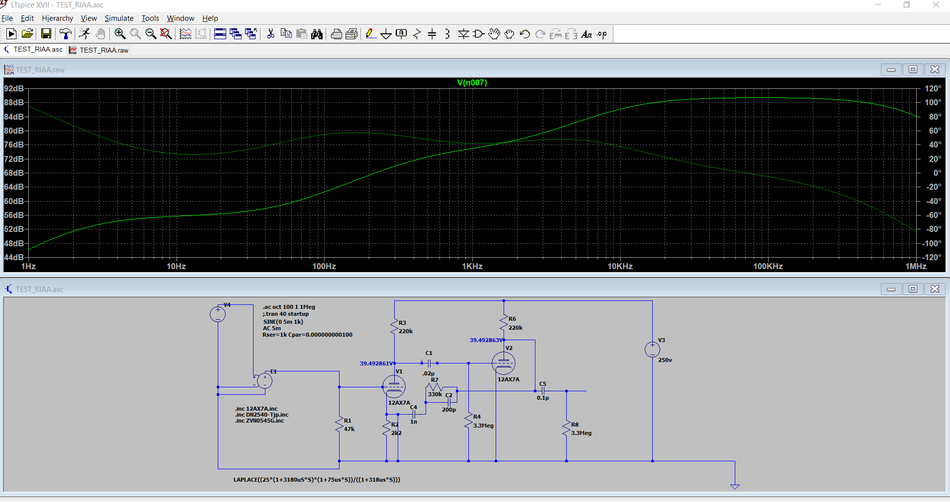

I just ran your chosen circuit in LT-Spice and the frequency response isn't really anything I would suggest is accurate for RIAA.
Maybe it can be fixed, but if you are going for active RIAA correction, you need to really get the right components and make sure they measure accurately. I do active RIAA and passive RIAA. I find active sounds 'livelier' but building a proven passive RIAA correction is a FAR wiser decision if you haven't build one before.
Anyhow, I attached the schematic as I ran it in LT-Spice. Maybe I missed something but I think it is correct. You want to see a nice flat frequency response on this simulation.
Reactions: Jeanper

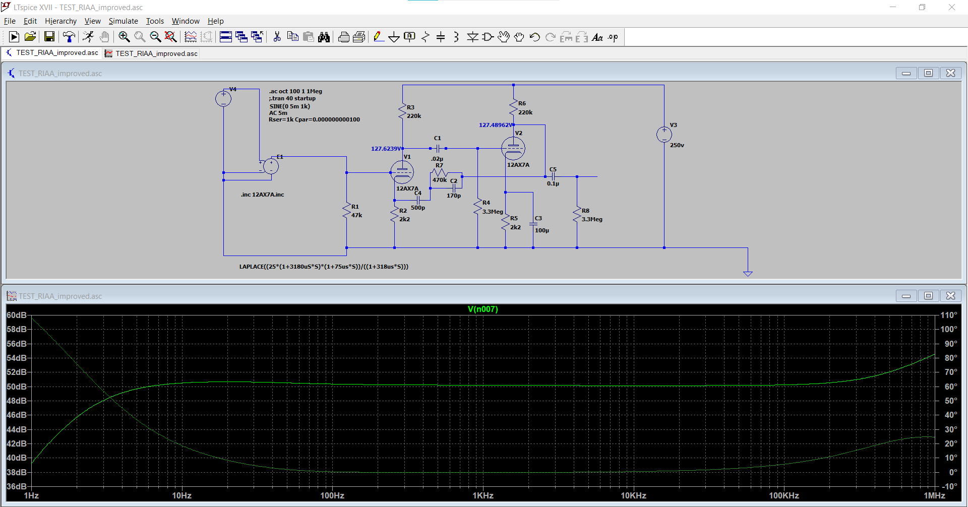

Here, these changes in the attached schematic might work better. I offer no garantees though! This is just a quick simulation.
Use a 2k2 cathode resistor on the second triode, and by-pass it with 100uF (10v) cap.
Then change the resistor and cap values in the RIAA network to values I put into my LT Spice. You will probably need to trim some values.
It could be that in your original RIAA that some value is incorrect (or something is shorted) too. I would not rule that out.

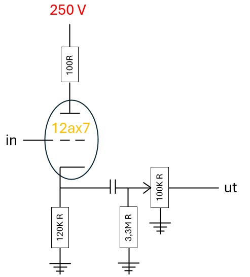

That preamp can only drive 200k ohm loads without a buffer. What in the next stage input impedance ?
That's an excellent observation. I see the OP answered and says its a 100k volume pot. But what if the input impedance of the next stage is only 10k Ohm?
See the attached simulation.
Reactions: rayma and Jeanper
Ideally speaking, this phono amp should have no volume control, and the following pre-amp would then have the 100k Ohm volume control (by-passed by a 1Meg resistor for safety).
If this amp had an output buffer stage, it could better support a volume control. I am using MOSFET followers for output buffers on phono amps. They take up very little space.

Rayma is right. I am using a MOSFET follower usually because it performs extremely well, and no additional heater current is required with a MOSFET. It also doesn't take up much space. Make sure your B+ can deliver the (modest) extra current for the buffer. Btw - nobody can hear the difference between MOSFET follower and tube cathode follower either. 😉
I would suggest you try zvn0545a (and protect the gate with a Zener diode). Just don't exceed it's 700mW limit. This device works well with the 12ax7 due to its very low reverse transfer capacitance value.
Anyhow, check the attachment to see what this might look like. I made a few additional suggestions in the attachment too. If you implement a buffer, then use a decent sized coupling cap, then you will get far better performance.

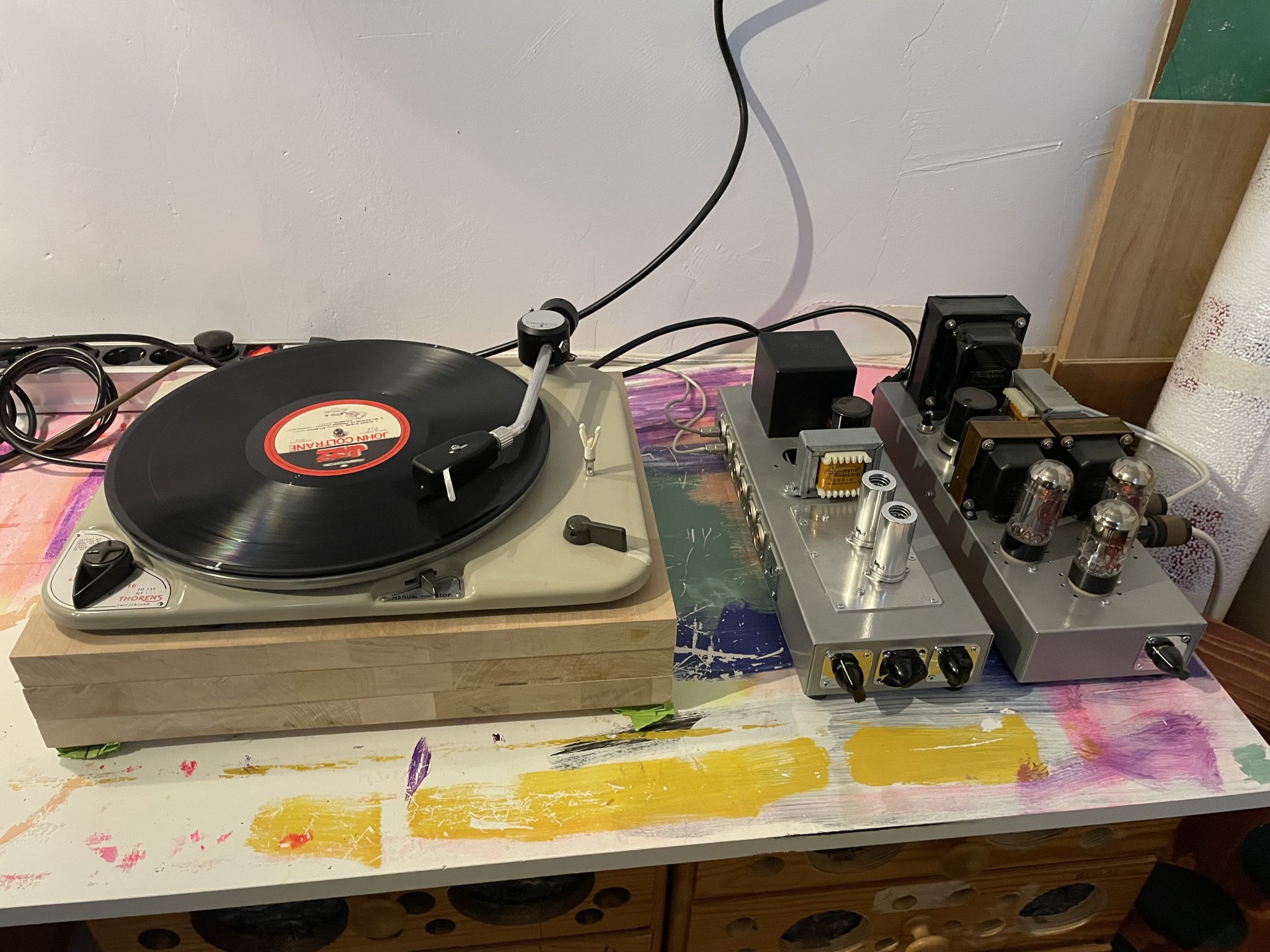

@soulmerchant the TD135 i nice. Looks real cool. A poor mans TD124. I mainly use it on my primary system but it has been going through som TLC in the hobby-room, changing some of the rubber dampers, the belt and the "disc". It runs real quiet. Hence I thought i would try it with the new RIAA.
