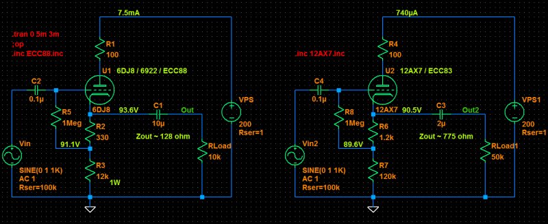

This is how it should work: 6DJ8 version for heavy load, 12AX7 for light load.

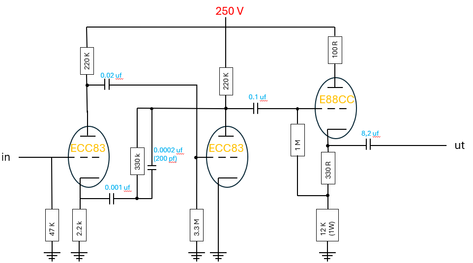

I was thinking a tube buffer like this. Will it work?
A tube buffer is not as good as a MOSFET, but yes, it will work.
My advice:
1. Output coupling cap should ideally be 1uF instead of 0.1uF (as a minimum, I would suggest 0.47uF).
2. Carefully measure the RIAA caps and resistors. Use more than one cap in parallel to get correct values if needed.
3. I would use the RIAA values as shown in my simulation because I trust my SPICE models. They most closely matched my measured values in real life. But hey, results may vary so this is entirely up to you.
4. Use grid stoppers. Also ferrite beads might help to get rid of any RF hash.
5. 12ax7's don't make particularly good cathode followers. To help things, at least run with a little more current. Each 12ax7 triode can dissipate up to 1W, so having it dissipate 0.33W is not going to be am. I don't know your power supply, but it can surely spare an extra 1 mA. Check to be certain.
6. You could also use a 12au7 on the cathode follower. They're cheaper and you won't hear any difference.

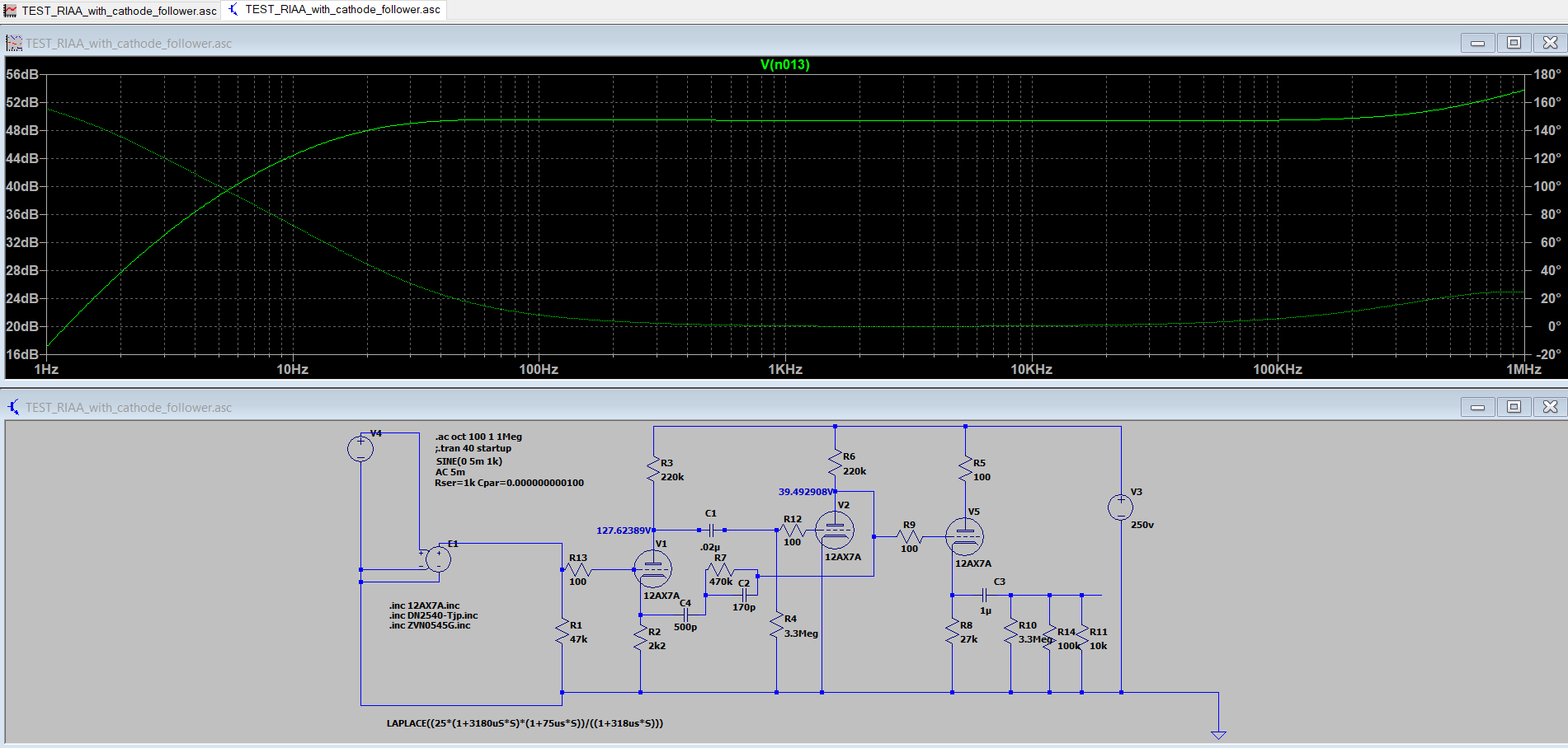

Check the attachment. It's not quite the same as Tim Paravacini's but hey...

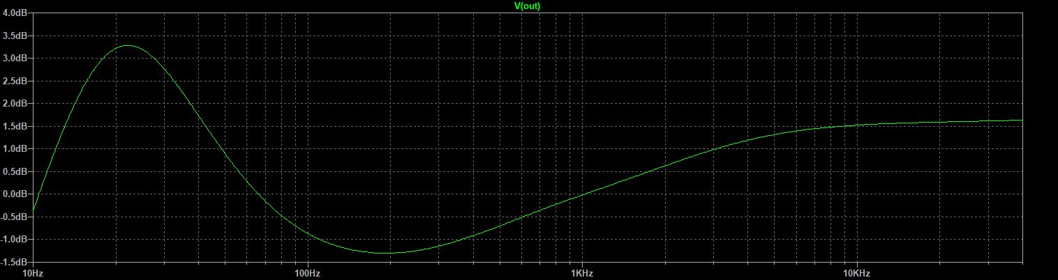

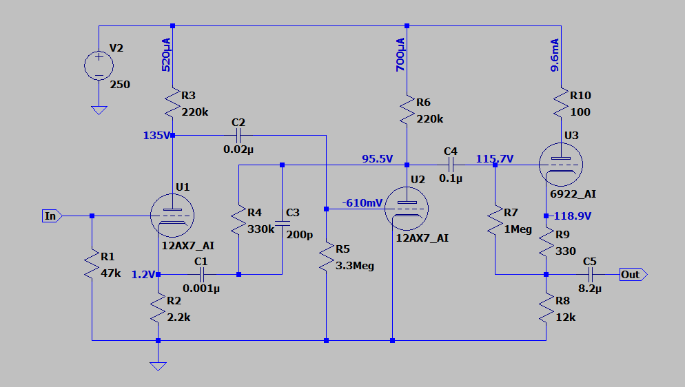

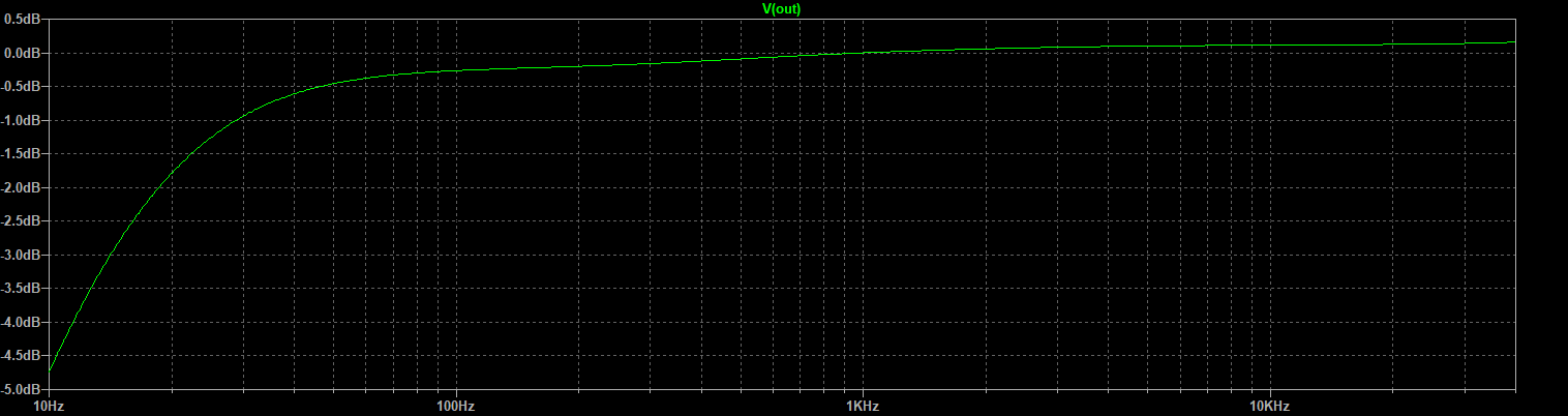

I finally got around to modeling this circuit, which comes with some caveats. Most vacuum tube SPICE models don't account for grid current but that is a must in a circuit which uses grid leak bias like this one. Adrian Immler's tube (valve) models are among the best in this respect so I used those for simulation (hence the "AI" suffix on the model names). Attached is the schematic with DC currents and voltages shown. These all pass the "sanity test" and suggest that all three stages will at least bias up to workable operating points.
But the RIAA accuracy is very poor (see attached plot). The RIAA standard has three time constants and I couldn't see how the feedback components (along with C2) could get you there. So if accurate RIAA playback is an objective there are a lot better circuits to build from. The one referred to in post #23 is a similar design and worth considering. Although I didn't model that one, its passive RIAA filter is at least topologically correct. Adding an output buffer (tube or MOSFET) would be a straightforward modification.

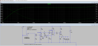

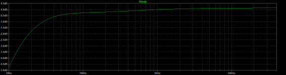

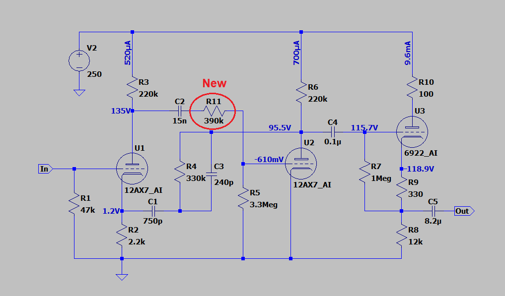

I know that I said I was bowing out of the conversation, but I couldn't let a problem go unsolved. So I have a modified schematic to offer.
First, I wanted to keep the mid-band gain the same so the 330k resistor value is unchanged from the original schematic posted on the "Fun with Tubes" website. The 330k feedback resistor and the 2.2k first-stage cathode resistor set the gain at about x150, or about 43.5 dB. Although a little higher than usual, it's not exceptionally so.
To get a reasonable RIAA playback curve it's necessary to add a build-out resistor from the plate of the first stage to the second stage grid. This is R11 in the attached modified schematic. All of the feedback components had to be changed as well but the result is respectable (see the attached frequency response plot). Note that all components are standard values so no series/parallel combinations are required to get the values specified.
The response is down about 1.8 dB at 20 Hz (relative to 1 kHz) but this isn't bad for such a simple circuit. Take a look at this modification and see what you think.
