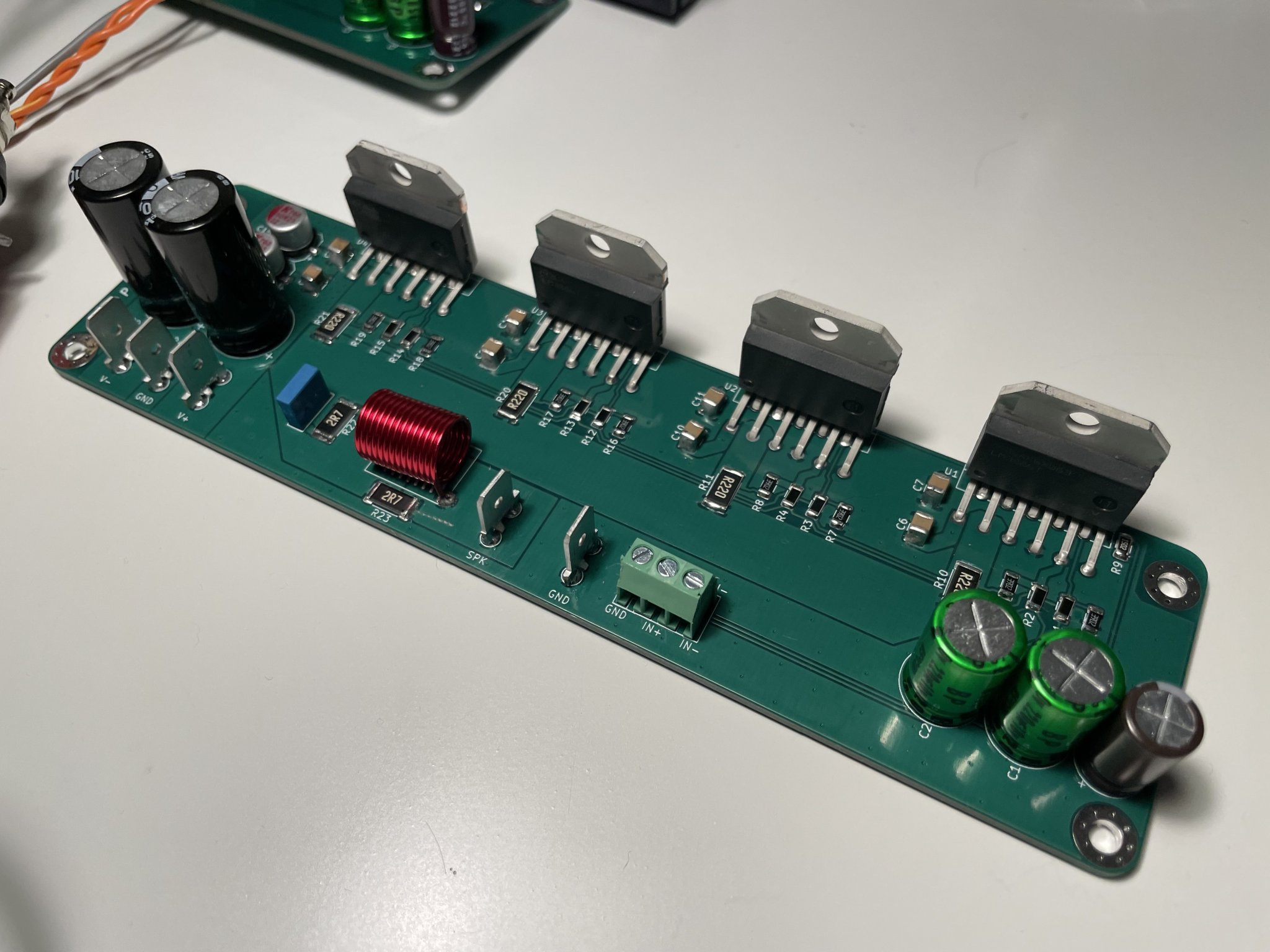

Excited about my latest revision of the LM3886-based amplifier!
Initially, I was thinking of putting two of them in parallel, but then it was three, and later on, it became four lol. The reason is that I want to bridge two channels and thus quadruple the power to 200W (or 400W into 4R).

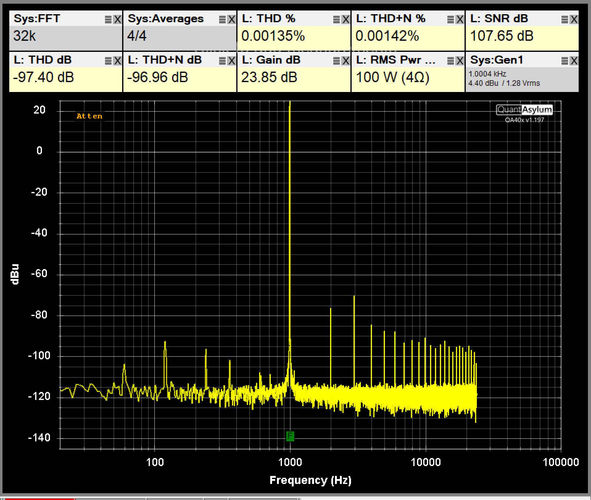

So far, using a 25V-0-25V transformer, I was able to get 100W into a 4R load with very low THD+N of 0.00142% @ 1kHz. THD is even lower at 0.00135%.
The 8R load showed even more impressive results of 50W at 0.00047% THD or 0.00066% THD+N.

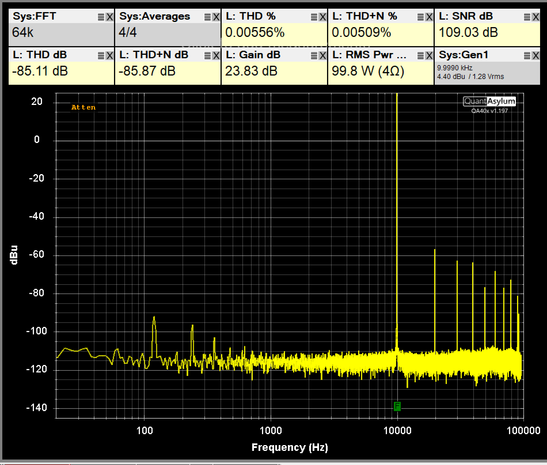

10kHz measurements are also attached.

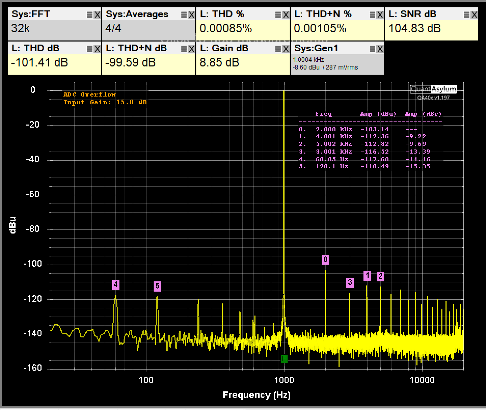

It is argued that the most realistic test for the amplifier is running a 1kHz tone into a 4R load at 5W of output. Such a test is attached too and results in 0.00085% THD or 0.00105% THD+N.

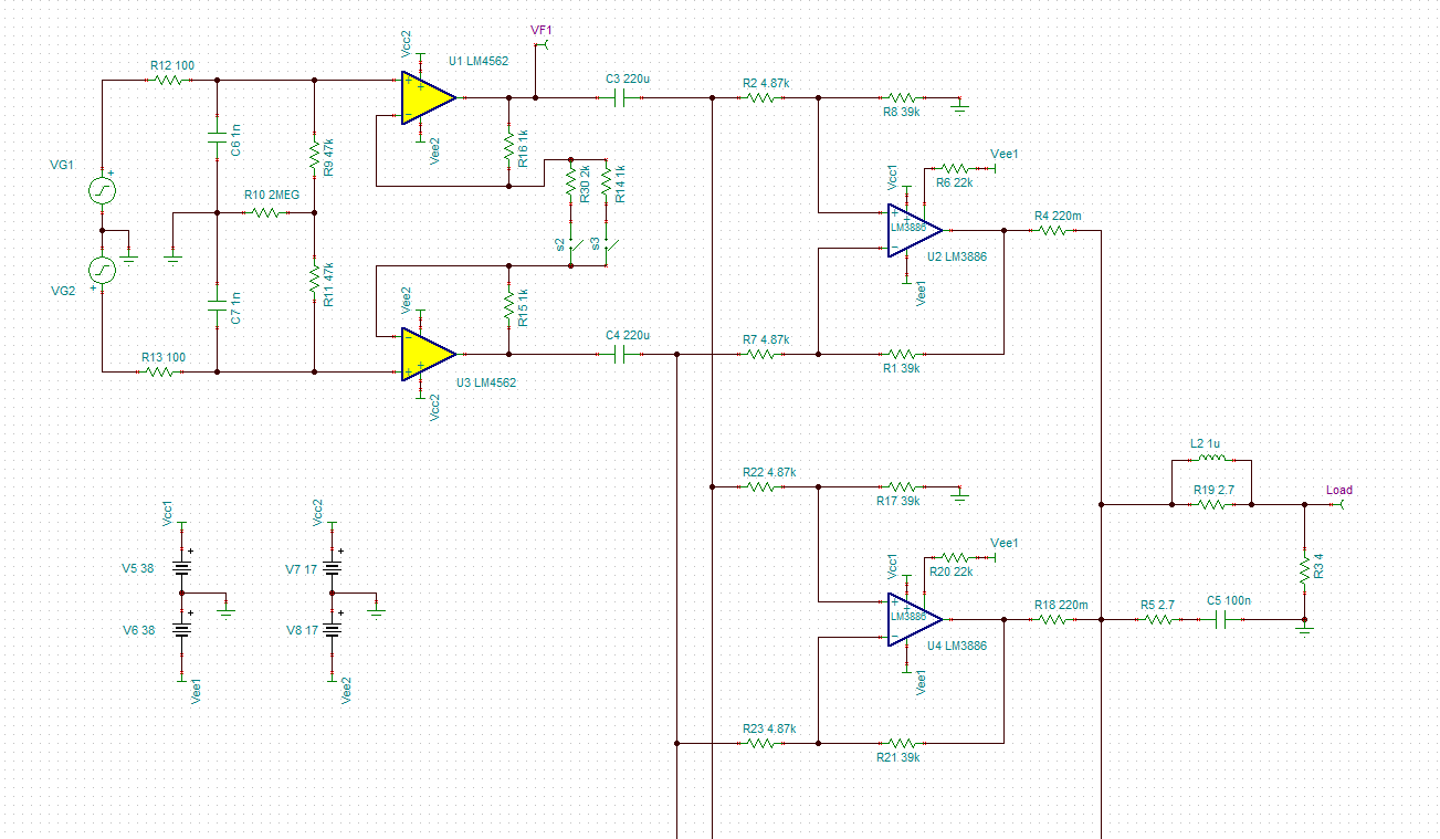

From my experience lowering amount of components and thus complexity for LM3886 allowed for lowest distortion possible.
Previously I tried using servo schematics like in TI app note but complicated layout resulted in higher distortion. Using LM3886 in true balanced topology allowed to minimize offset errors and servo was no longer required.
More reading here - https://hifiocean.com/blogs/news/differential-configuration-for-lm3886
I am not using so called “stability components “ from TI data sheet either - including them did not look good on a square wave test. Talking about series RC network over the feedback resistor and C in parallel with inputs.

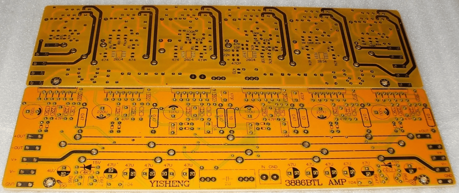

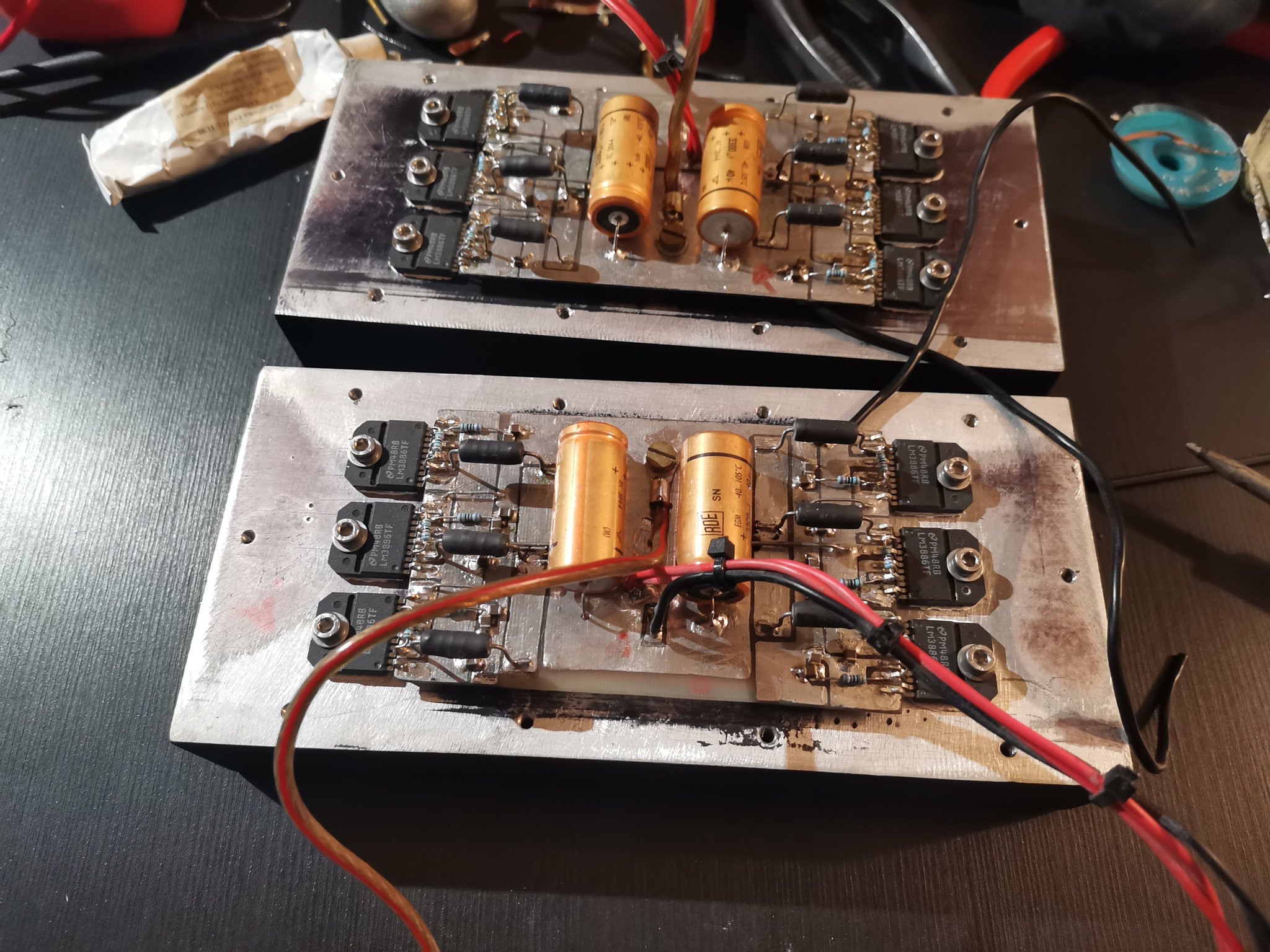

The Chinese board has servos to synchronize the amps. The LM3886 has been in production a long time, I think if you get all from one production batch, they should be identical and not need it. An .22 Ohm resistor in the output of each LM should match them up. If you buy mixed up chips from unsecure, different sources, maybe recycled as most stuff on Alibaba, this may not work.
The 6x version has the bridge converter included in the design and servo's each amp. It can be safely driven with a higher voltage than the 4x and deliveres more power. If it works at all!
Only 0.1 ohm at each output, no DC servo, important is to use 0.1% resistors in feedbacks of parallels, 0.01% even better.
I wonder about the value of the load-sharing resistors required. Matching between ICs is not well-controlled. I expect the current sharing resistors have to be larger than with just BJTs.
Ed
Hi Ed,
I can say only for what I built and it works, lot of 14 (2 I have spare) lm3886 was bought from Distrelec in Switzerland and they appear to be from the same lot.
I would avoid by any means using chips from different lots/shops in parallel. Like this, 0.1 ohm is enough, mine blocks are not heating on idle at all, and I did not measure any current through these load sharing resistors without signal. What I believe does matter is to match feedback resistors as close as possible, to extreme precision. It's simple math that even slightly different gains will produce high internal currents between chips when driven. But if this is taken care off, it works as per application note.
