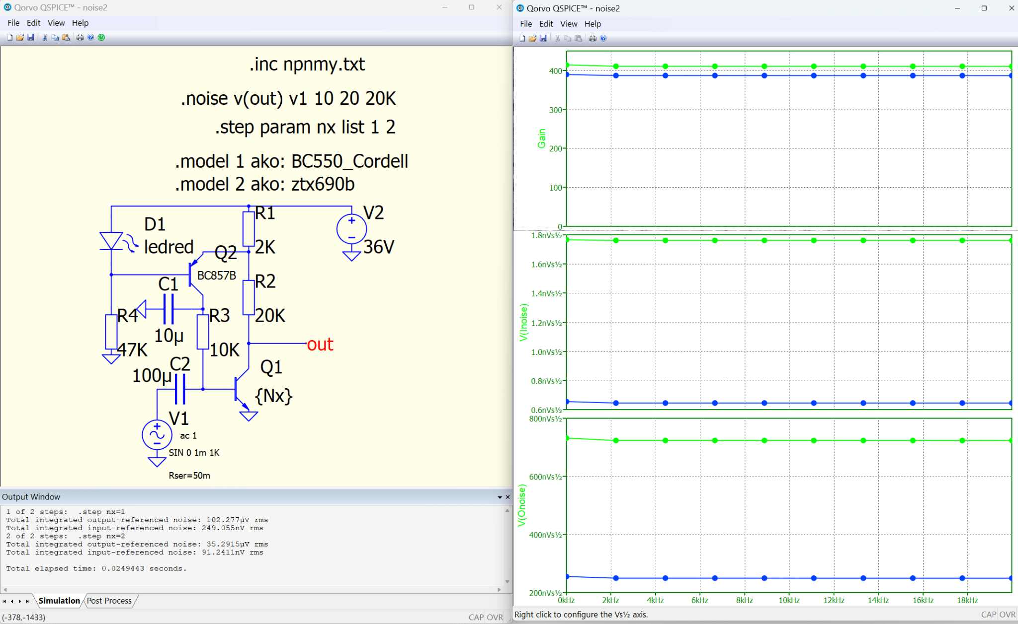

These are some (readily available) high voltage BJTs I found recently, perhaps these are useful?
2SC2705
2SA1145
I even found some models for them, as I was lookiing for higher power 2N5551 / 2N5401 BJTs, the worked the same for me in simulation:

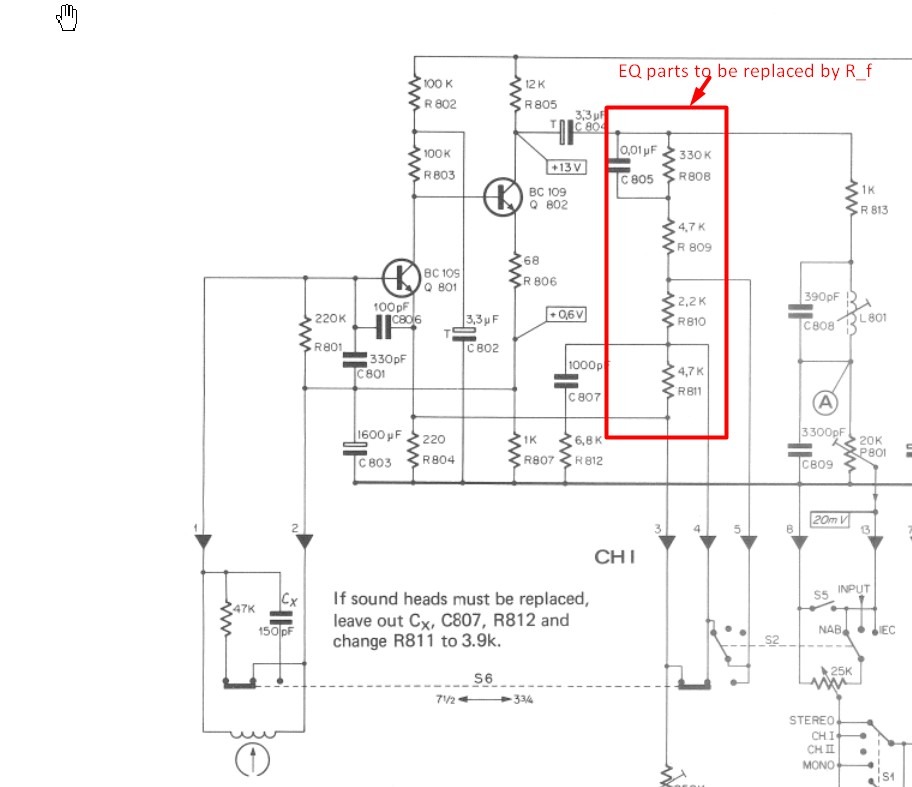

Here is the original schematic of the A77's FE (dc-supply is 19V)
Of course the R804 (similar to open-loop gain) must be adjusted for maximum possible OL gain. I could set it stable for around 70dB.
With surprise, I measured the same setup a TIA on Rf 10^7 (140dB) setting: was barely able to match the Revox FE. The TIA had still ca. 5dB SNR less than the A77. I cannot understand how. I can only suspect that TIA was optimized for capacitive source... but 70dB vs 140dB and still not equal... hard to figure it out why.
