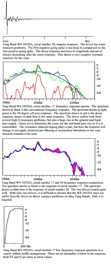

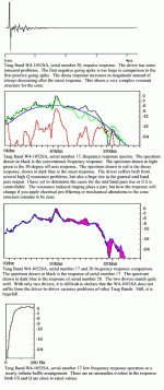

I am just posting some updates and revisions to the modifications. First, please do not be afraid to try the glue ring plus equalizer modification because another modification exists. I have included a frequency response graph of the worst-case response to this modification using the GemTac glue. Narrow notches in frequency response at 8.5 kHz are not particularly noticeable or offensive. Most modifications using the equalizer and glue ring will perform significantly better than the one shown here.
Second, there is a second section added to the equalizer. I guess you could call this the anti BSC circuit. I advise using the revised circuit and not attempting BSC. I have included both one and two meter response graphs. While linear in format (equal data density), the low frequency cut-off for these tests is 150 Hz.
Third, I have included a four-box test of low frequency performance. While it is possible to change the acoustic output between 60 and 180 Hz, in all boxes the low frequency roll-off begins at 95 Hz. F3, when compared to the highest bass output is about 72 Hz regardless of box design. I hypothesize that this is a limitation of the three-inch cone in this advertised four-inch driver. I have measured the same phenomena with other four-inch drivers and believe that it will be consistent across all available four-inch drivers with sub 100 Hz Fs.
I advise keeping internal box dimensions at least 6.75 inches wide and tall and 6.75 inches deep. I would go no smaller than these dimensions. With the revised prefilter/equalizer circuit, the driver performs well in this small cube. The associated upper register bass rise is helpful when listening full-range, and is even helpful when augmenting with a woofer. When using the .16 cubic foot box, use the revised prefilter/equalizer. When using larger boxes, vented or sealed, change the 15-ohm resistor of mod one to 18 ohms, but keep the small capacitor at .56 microfarad. When using the .16 cubic foot box, use the 18-ohm resistor and increase the .56-microfarad to 1 microfarad as shown in the schematic.
All audible octaves are important. The octave between 40 and 80 Hz is no less important than any other octave. While I have and can listen to this driver full-range, I would prefer to augment it with a woofer or sub woofer. Hearing and feeling the music in that 40 to 80 Hz range increases my listening enjoyment. I will use passive speaker level crossovers as low as 300 Hz. It is too expensive and too difficult to use speaker level passive crossovers lower than 300 Hz. For this application, a bi-amp setup is the only practical way to achieve the crossover.
When using the .16 cubic foot box, introduce an electrical drive F3 of 150 Hz, producing an acoustic F3 of 100 Hz and cross to a woofer at 100 Hz. If you go second order on the high pass and fourth order on the low pass, you can drive the 1052SA to its thermal power ratings while not exceeding claimed Xmax. With one driver per channel and an “average” sensitivity of 88 db after modification and equalization, you can produce 104 db levels at one meter holding to RMS ratings, and 101 db at two meters holding to music or peak ratings.
