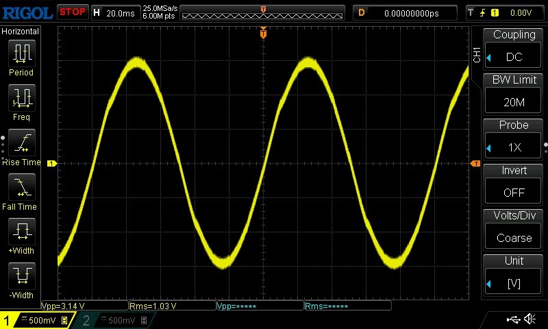

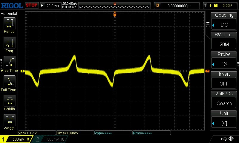

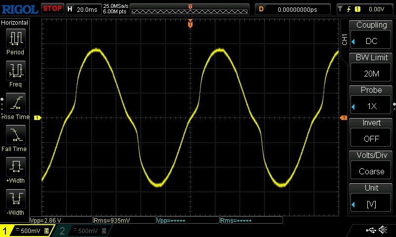

I made a test transformer with a few turns and thick wire just to test the B/H curve of the core
Zeta4 please check the H, B numbers. Are they realistic?

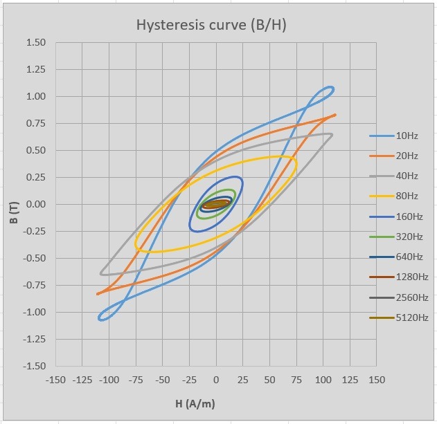

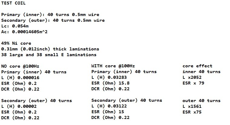

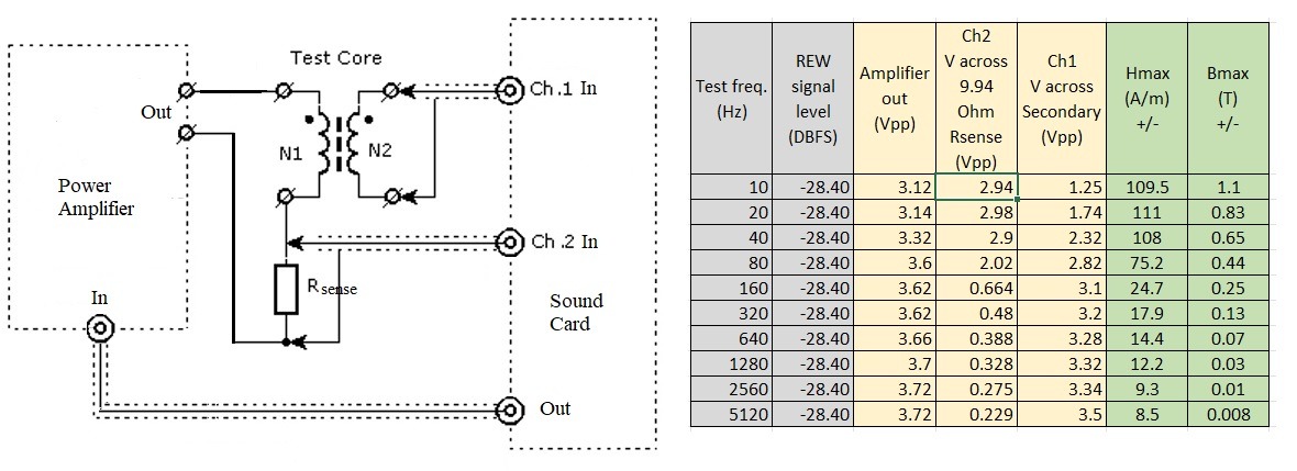

George
George
B number looks about right, the curve is beginning to flatten out to somewhere around 1.2T. Not sure about the H numbers though as the curve
looks wider than I would have expected. I'll check in my files but its probably OK.
Joined 2002
Thank you Zeta4
You are probably right. I need to do more controlled measurements.
I have noticed that during these high flux tests, core gets magnetized and curves change dramatically due to this.
Demagnetisation is required prior to each test run.
George
OK, I just wondered if there was anything special you were looking for. Ideally the a loop for a typical 49% material peaking at 1.4T
would cross the H axis at around 20 A/m but this is without any gapping. Even the normal lamination overlap would increase this but not
to the level on your plot. Anyway I hope you manage to sort it out.

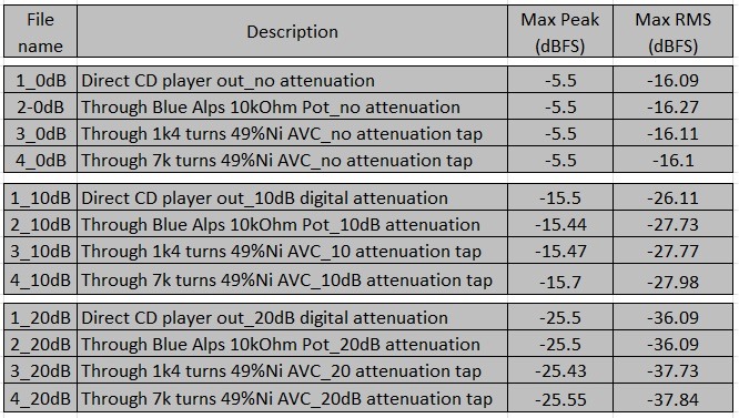

I was listening for differences btn the 1k4 turns and the 7k turns AVC.
I made some recordings of the same musical piece, first of the non attenuated , then of the 10dB attenuated and then of the 20dB attenuated content. I thought to share the files. There will be at Dropbox for a week
You may download them , listen to them and say what you think of any difference you may notice or not.

I forgot to mention that
CD player (Rotel RCD-965BX) Ro=200 Ohm. Vout=2Vrms. The musical track played has a max at -7.5dBFS. Therefore max Vout=0.84Vrms
Sound Card (M-Audio Audiophile USB) Rin=10kOhm
Musical tracks are dual mono 16/44.1 recorded with Steinberg Wavelab 4.0
George
OK! There is not much I could detect anyway. No difference in dynamics, back round noise and soundstage imaging. Clearly, the Alps sounds a bit warm at all settings. I've learned to associate this with 2nd order harmonics. Both AVC do not suffer from this, at least not significantly but the 1k4 lost brightness at -20dB. This is as far as I can tell. I hope it helps.

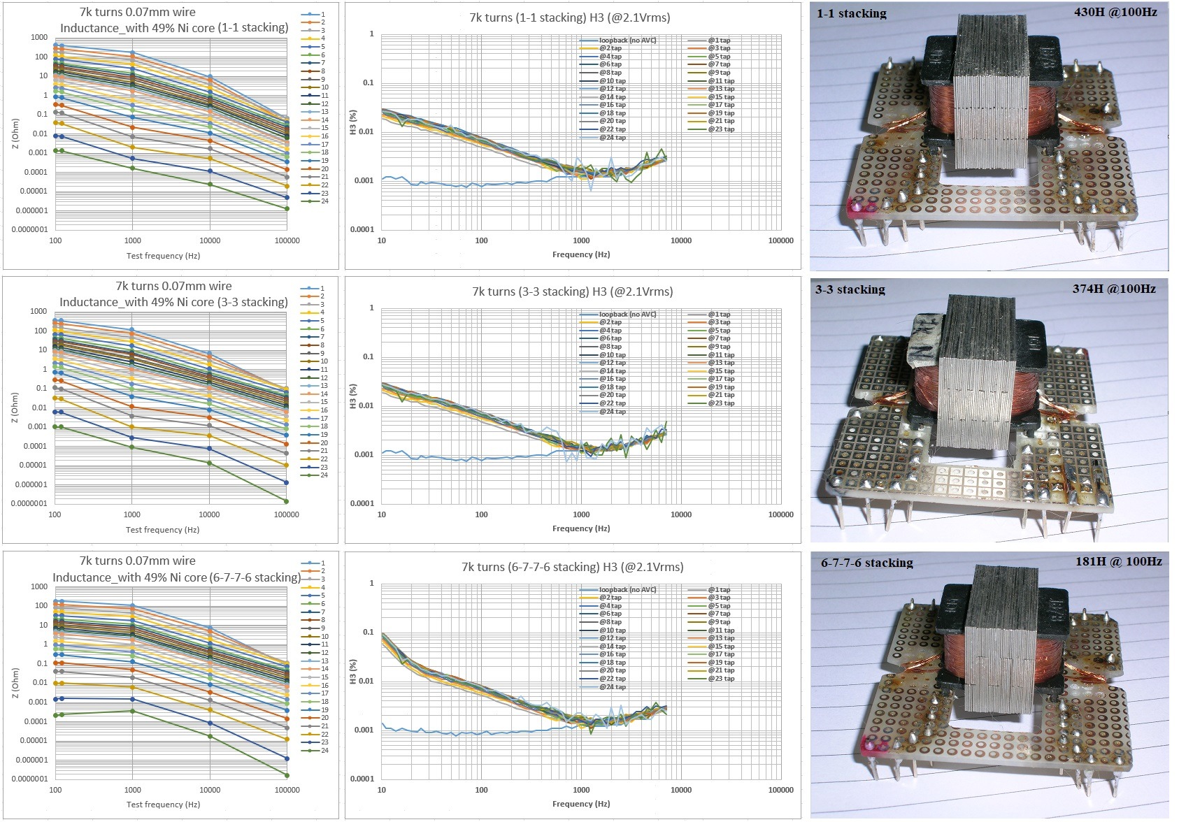

I worked a bit with the "pinstriping" i.e. different core laminations stacking.
Below is the result with 1-1, 3-3, 6-7-7-6 alternate stacking.
With gap increasing, I don't see 3rd distortion reducing anywhere in the audible freq. range.
What I 'm doing wrong?
George
Hi George
Thats a bit disappointing but I dont think you are doing anything wrong. The only thing that differs from my experience is the relatively
high numbers of turns you are using. By contrast Ive rarely used more than 4K turns. This will affect the flux density by the square of
the turns and it will be very low. So its probable that the pinstripping is having no effect at your signal level because of this. You could try
significantly higher signal levels to see if this makes any difference.
I try to minimise the number of turns while maintaining the necessary inductance so as to minimise interwinding capacitance which has
an effect on frequency response. With nickel the permeability of the core is approx inversely proportional to frequency so the inductance
at say 50hz will be a lot higher than at the measured freq of 100hz. I'm not sure about 49% nickel but with 80% it will be nearly double.
So you need to take this into account when you size the required primary inductance for a given low freq cut off with a given source
impedance. Its a bit of a balancing act really.
Geoff
