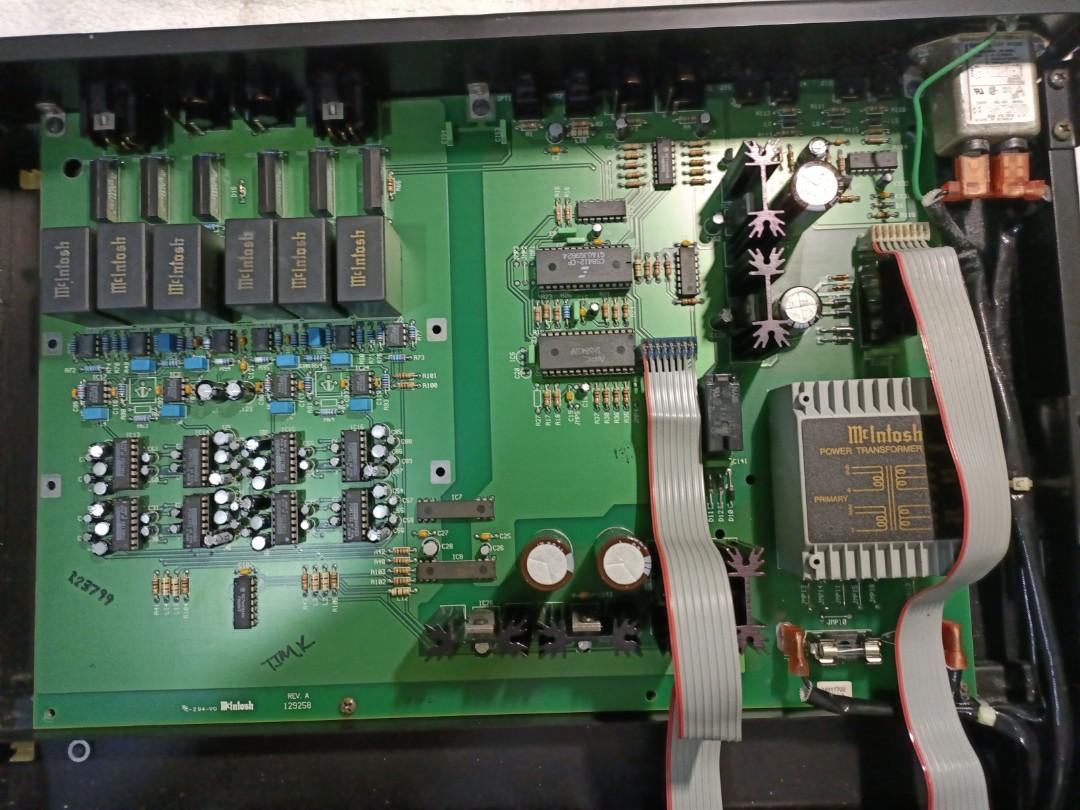

Any thoughts on the above? I have one on the way and was curious about possible mods (Not that I'm capable) 8 Burr Brown 1702..What exactly do I have here? Thanks!
I've never had a chance to hear that DAC, but it's very similar to my DIY DAC or EVM-1702 evaluation module, so I'm guessing it might sound good. As for upgrades, it all depends on your skills with a soldering iron. A lot can be improved there, I/V stage, regulators, replace CS8412 and NPC digital filter, decoupling.
