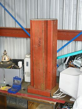

Arc Welder Transformer used to power Amplifier
And finally a Pic of where the transformer's going to go.
i call this my Amp Tower. It will house at the bottom the transformer, there will be a computer fan running at 1 third speed forcing air upwards.
then there will be a Aluminum spacer which will still allow air to pass around it sides on which the bridges for each channel will be mounted.
Above that will be a electro - capacitor bank for each channel and finally about that with be 5 Pre-amp / amplifier channels boards mounted one above each other.
the power transistors will be mounted on the "C" Section Casing and will be covered with Aluminum covers to assist cooling and prevent electric shock form wandering hands. there will be a small gap at the top to allow hot air to escape.
It will be painted black and all input, output power connections will be at the back.
On the front will be the on/off switch and an idicator led for each channel to show that they are powered.
Also Volume, Treble and Bass controls will only be adjustable through cutouts in the back as the volume, treble and bass will be set and forgotten and volume levels will be adjusted from the DVD Player remote.

well, it doesn't look that bad as what I've thought in the beginning,
since welding arcs that used here are squared toroids, I mean
they do not look like dough nuts, but laminated C cores....
but those you're using still that looks efficient with banked capacitors......
rgds,
hienrich

John Biles said:
I know my use of an arc welding transformer is not the norm, but the stupid thing works fine with my designs.
and no one should be surprised by that. those transformers are designed to output lower voltage once large current goes through: high voltage helps initiate the arc and once that's done, you don't need as much voltage. to maintain it.
However, for your application where the current draw is much much lower than what those transformers can handle, you shouldn't see much (if any) voltage droop.
Thankyou hienrich and tlf9999 for your comments. So this may not be such a dumb idea after all. More welders might find their transformers missing.
Here are the dc voltages i can get 2 x 28volts with wire size switch set at 0.6mm or 2 x 37volts with the wire size switch set at 0.8mm. or 56volts and 74volts.

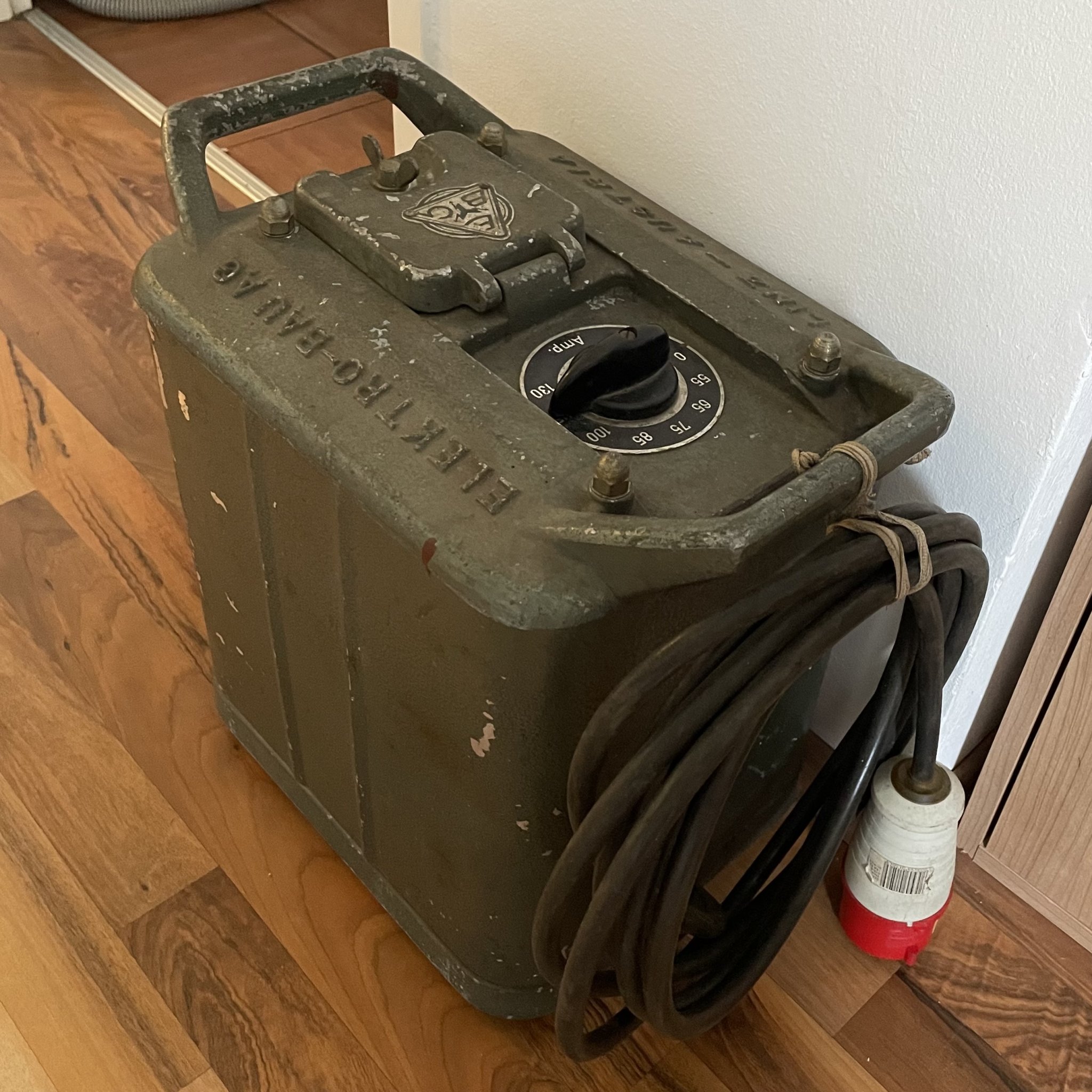

I am attempting to, sorry for the 20 years late reply 🤣
I chanced upon this beautifully made arc welder and wonder if I could do anything with it, and I googled and voila! Your thread showed up 😊
I wondered the progress that you made with yours, please share with us.
