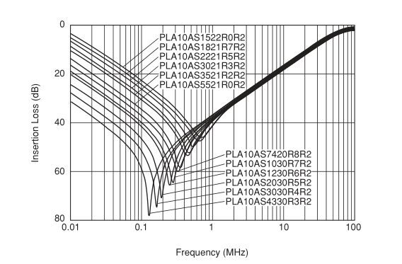

Suppressing CM noise currents isn't very straightforward and the EETimes article points out why - they are sourced from a very high impedance. So high impedances are needed to make a dent in their magnitude. Ferrite beads (for example) are useless as their impedance typically tops out around 1kohm. The first line of defense against CM noise is a CM choke and a typical insertion loss plot looks like this :
The different lines represent different current ratings, the one with the highest loss has the lowest current rating. Notice above roughly 1MHz all these different current rating chokes behave about the same - their parasitic capacitance determines their insertion loss. They all have SRFs (self-resonant frequencies) between 100kHz and 700kHz, the frequency where their stray capacitance resonates with their inductance.

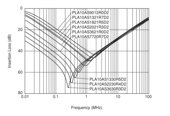

To improve the HF performance its a standard technique to segment the windings - with two segments on each side the insertion loss plot looks like this :
More segments are possible of course but I've not seen any commercial CM choke with more than two. These two plots are from Murata devices designed for power lines - signal line chokes with high insertion losses close to the audio band aren't so easy to find. However on signal lines, transformers can do a reasonable job of increasing the CM impedance.
