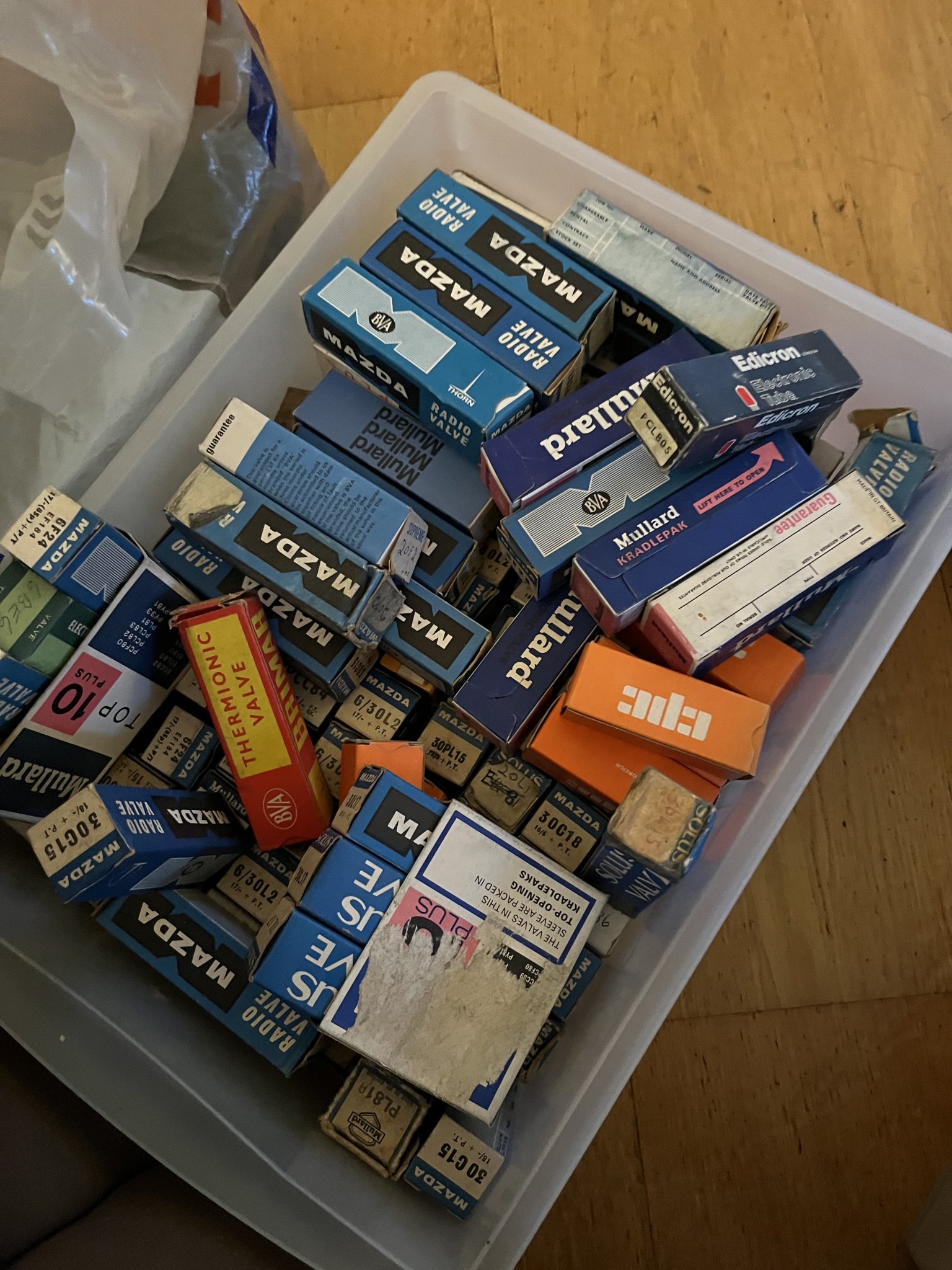

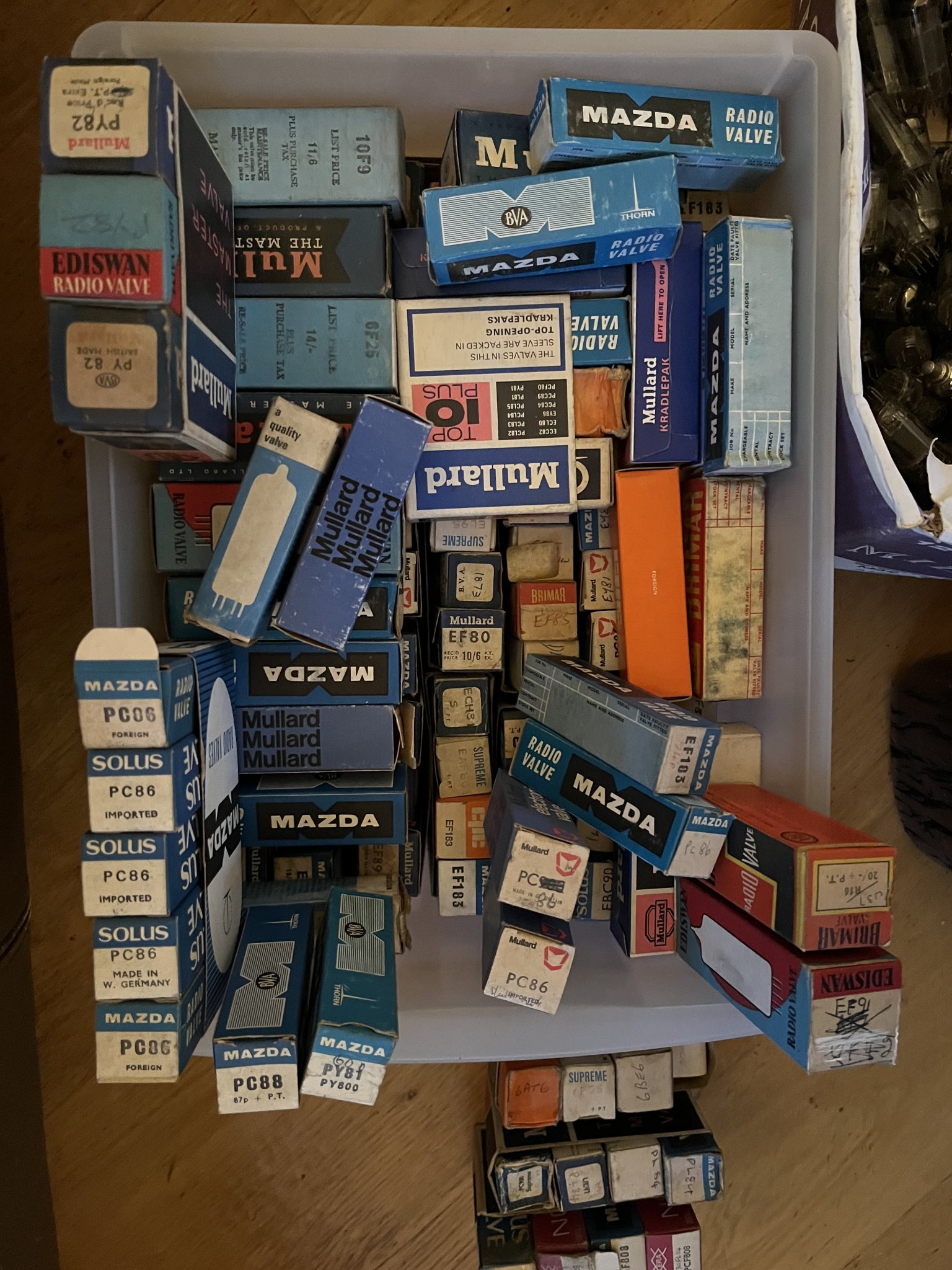

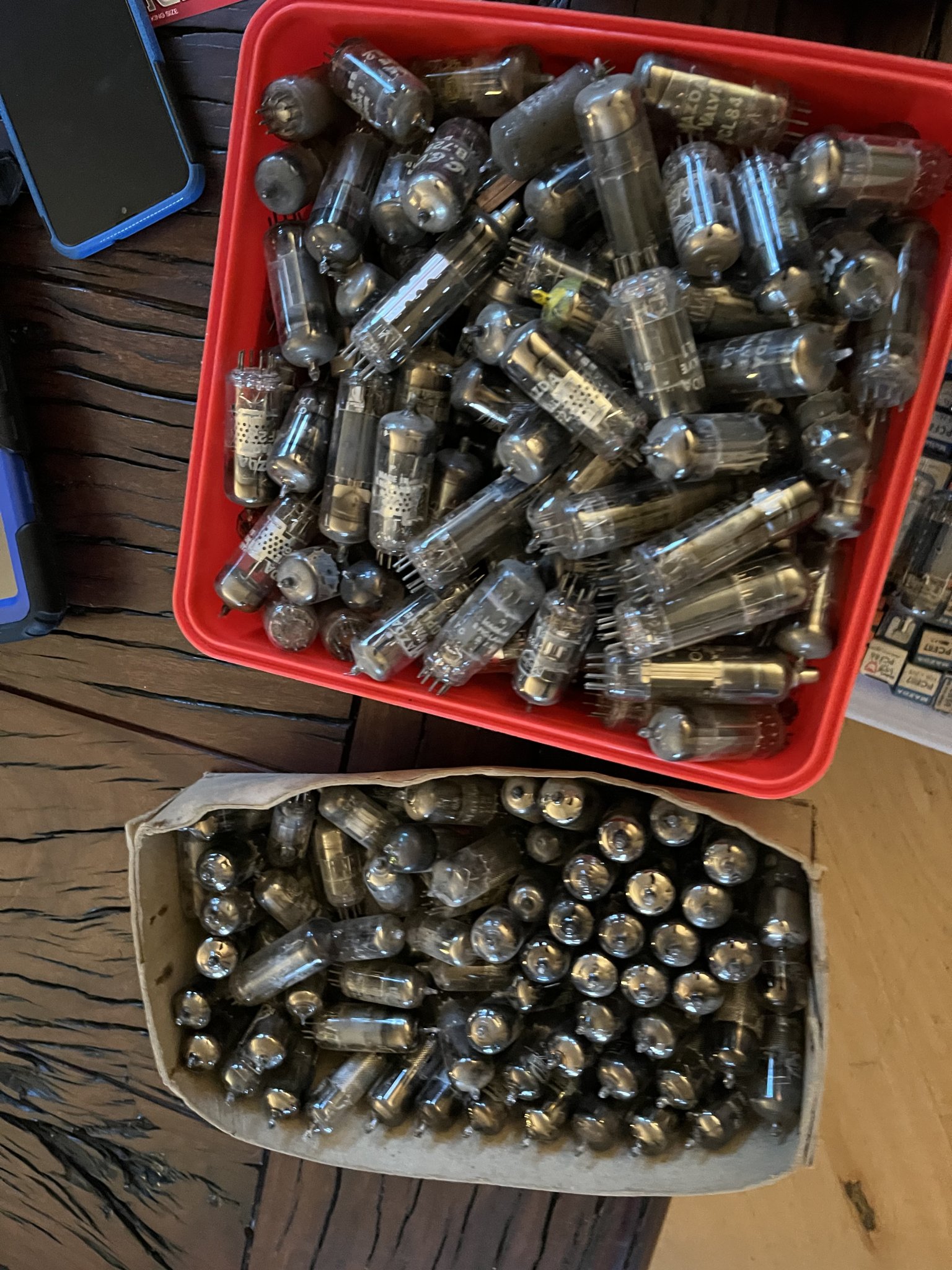

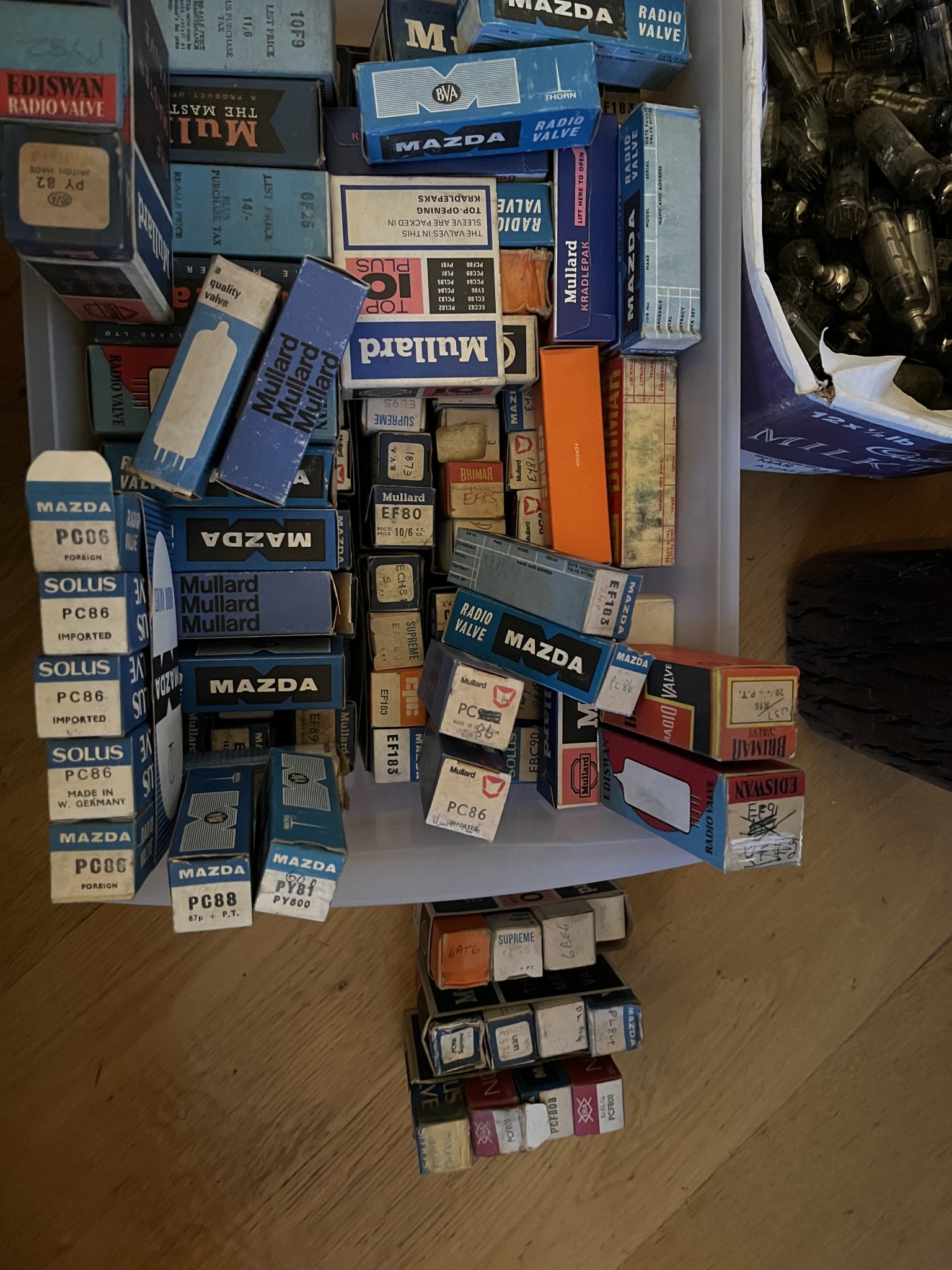

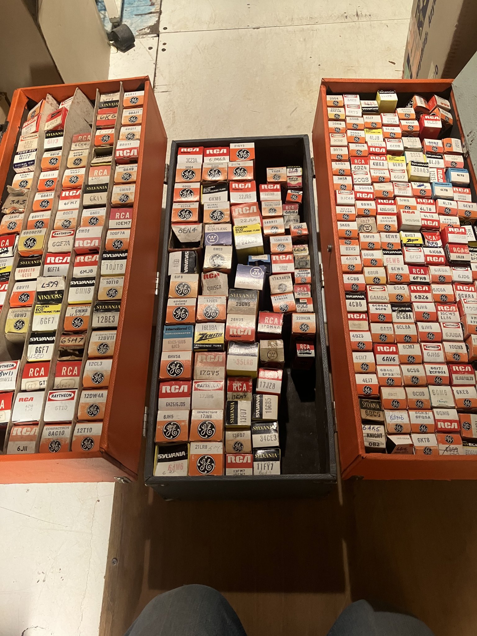

Are these of any use for audio?
I have acquired quite a few tubes that I think must be for old tv’s and radios but are they of any use to us audio people?
Of course. It is slightly inconvenient that most of them are P valves, meant for television with 300 mA series-connected heaters, but you can also heat those with voltage. You just need some unusual heater voltage values then, see their datasheets for details.

I agree with the first part about the resale value, but those 6P36S Soviet sweep tubes would probably work just fine as output tubes in a PP pentode amp.
Perhaps something like Pete Millett's Engineer's Amp.

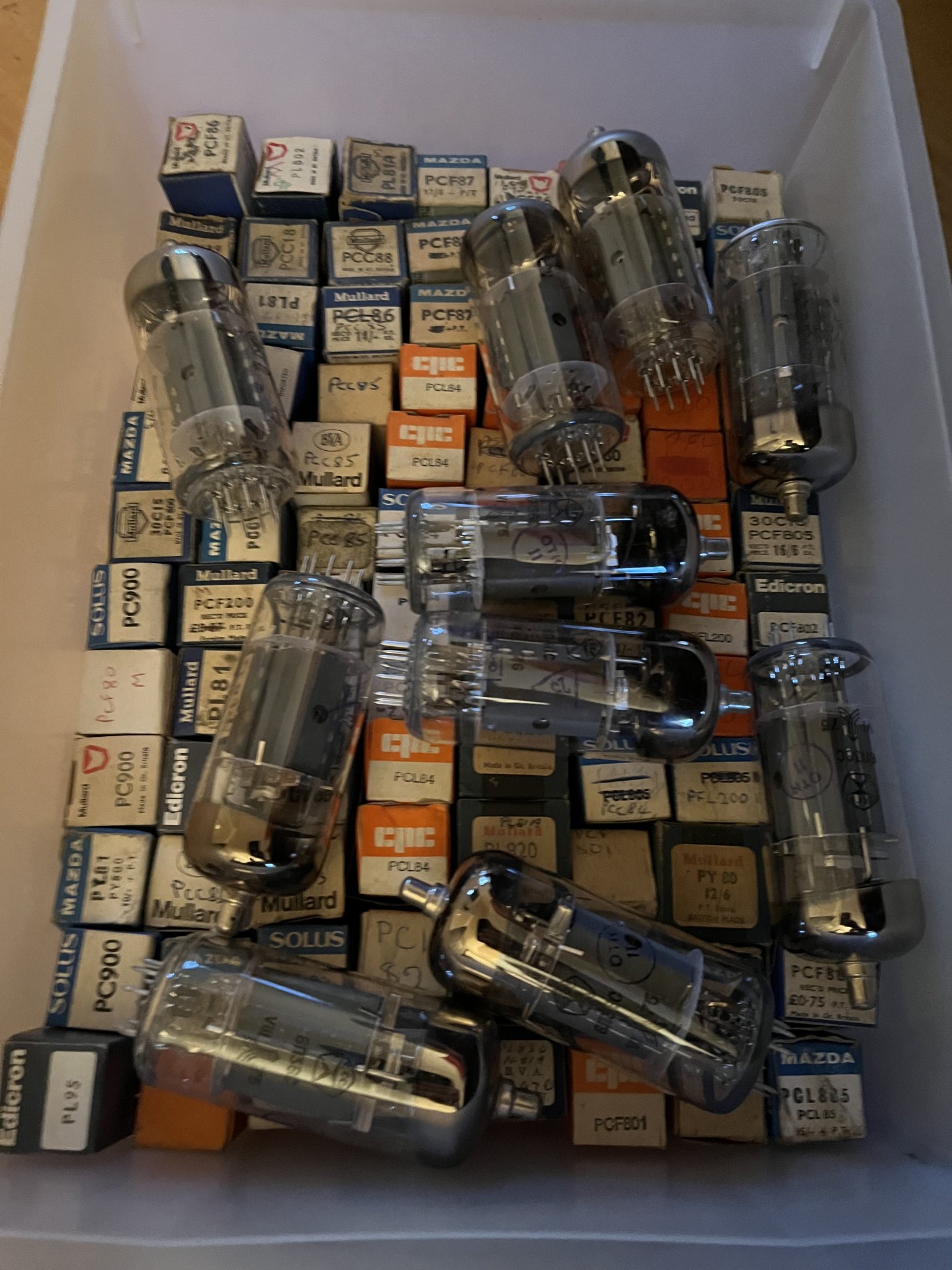

Geez, Andy! They might not be to everybody's taste but some of those valves have promise! To pick but a few:
  • The 6F24 is a good frame grid pentode and a kissing cousin of the EF184 - both make good triodes too.
  • The EF80 is another good pentode that makes a good triode.
  • The PC86 and PC88 are both meaty triodes that could make good drivers or cathode followers.
  • The 6/30L2 is a twin triode with goodly transconductance and mu around 17.
  • The PCL805 is a good candidate for a spud amp.
  • The EL95 will do as an output valve.
  • And the PY82 is a perfectly capable rectifier.
Landing a stash of valves like that reminds me of an older cousin handing over their Lego that they had grown out of - I mixed it with my own stash and started building things I'd not previously imagined :)

All sorts of heater voltages, mostly singletons, the inspiration for dozens of experiments. :) Some of which were even GOOD!?!? Almost all of which taught me something (even if it was just DON'T DO THAT AGAIN!!!)
