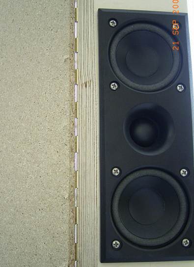

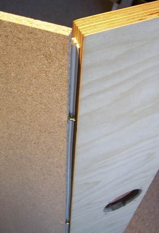

PHY-HP publishes recommended plan for a large folding baffle. The plan specifies the use of (difficult to find and expensive) piano hinges. This is to seal the folds.
My actual baffle wings are with piano hinges. I´ve done a picture of it, showing the gaps in the hinge, that don´t seal much. I have even taped the hinge with duct tape, but couldn´t hear any difference.
In a previous attempt of isolating the wings I used hooks and eyes with a rubberprofile in between (see second picture). This was rather efficient in terms of isolating, but mechanically rather feeble.

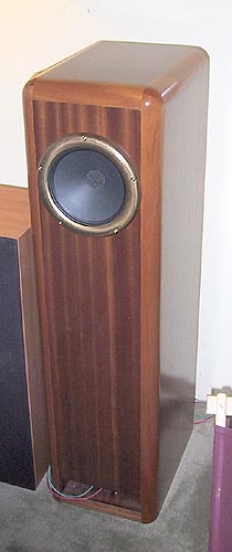

From the other end of the spectrum
I needed some outdoor speakers on the WE, so i refurbished a set of old Stromberg Carlson portable PA enclosures with some 12" FRs i had kicking around... not the be all & end all, but you can listen to them & enjoy...
