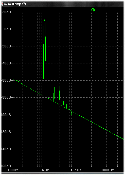

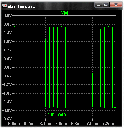

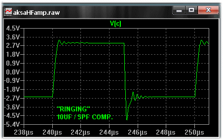

By aksa - The trick with loop gain is useful, thanks to GK and Andy_C, very useful way to figure stability.
Here is another one . It does work with the "older" models (2sc/a) , works even better with fairchild models (ksa/c ksp ). You drive a 2uf - 10uf cap at the OP with a "fast" square wave at 10k, also add a second -2.3v voltage source and short the input cap (attachment 1 is self explanatory). The first output plot is driving the standard resistive load. The second is with a 2uF OP cap and 10pf lead comp. (slight overshoot) , The third is with the original 5pf lead comp. (1.1mhz UGP) , here is where it really gets "ringing' but still does not break out in sustained oscillation. This little amp is REAL stable .. but this is just a single stage OP. If you do this blasphemy on a triple (with more complex models) the "cause and effect" of total loop gain /UGP AND the parasitics/higher gain in the more complex current stage (EF2 or triple) is quite evident.
One can also step (.step command) through different Cdom's , biases and do this with different device models to see the effects on distortion harmonics and stability.
I feel quite confident because when scoped in real life , you see nearly the same responses. :)
(attachment 5 is the fft , nearly similar to the 55 !! )
