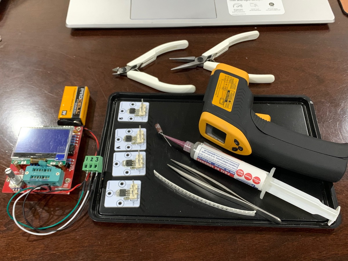

To assemble the LU1014D to the adapter PCB you will need the following:
1. An electric hotplate - similar to the single burner dorm room cook plates. I don't recommend doing this in the kitchen where there is food as you will be heating up lead based solder annd there are noxious fumes.
2. An old frypan or skillet that you will not use for food anymore. Nonstick aluminum if good as it heats evenly and the paste is easy to clean.
3. Solder paste - a no clean type with Sn63/Pb37 is good in syringe with an applicator tip. Hypdermic needles can work by I prefer the tapered plastic "Henna" nozzles (search for Henna Nozzle 20ga or 21ga).
4. Good tweezers (stainless steel ones made in Switzerland seem to be the best). Invest in good ones as they are extension of your fingers.
5. A flip up binocular magnifier headband - this helps you to see the tiny parts annd pads as you work.
6. An IR thermometer to know your skillet temperatures so that you do not overheat the parts.
7. Optional SMT high current header pins from Samtec HPM-03-01-T-S-VS
Here are some of the tools needed. Use pliers to bend the leads to lie flush with the pads if you are using LU1014D's. If you are using LD1014D's, they are premade for SMT installation and no lead bending is needed.

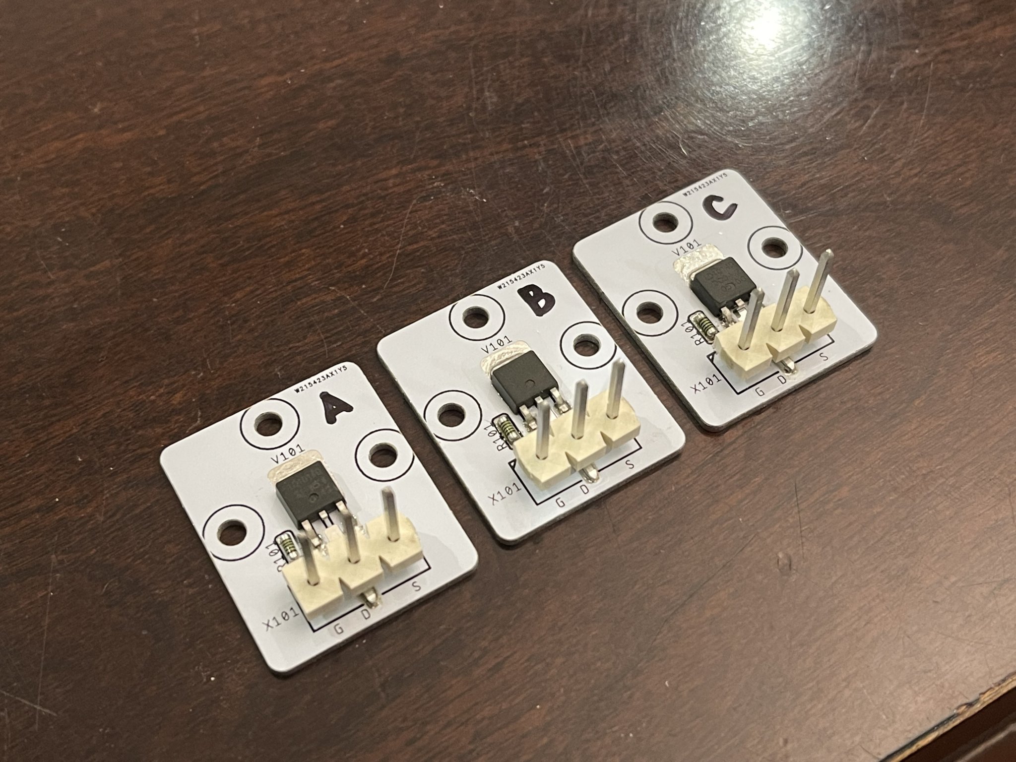

This is what the parts look like once assembled:
attachment.php

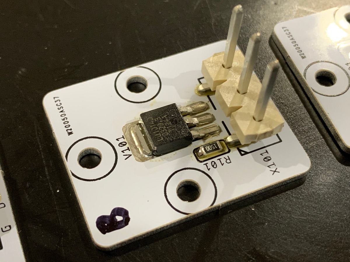

Closeup:
attachment.php
You may notice that the resistor value is 150ohms and not 100ohms - I ran out of 100ohms and 150 should work fine as a gate stopper.

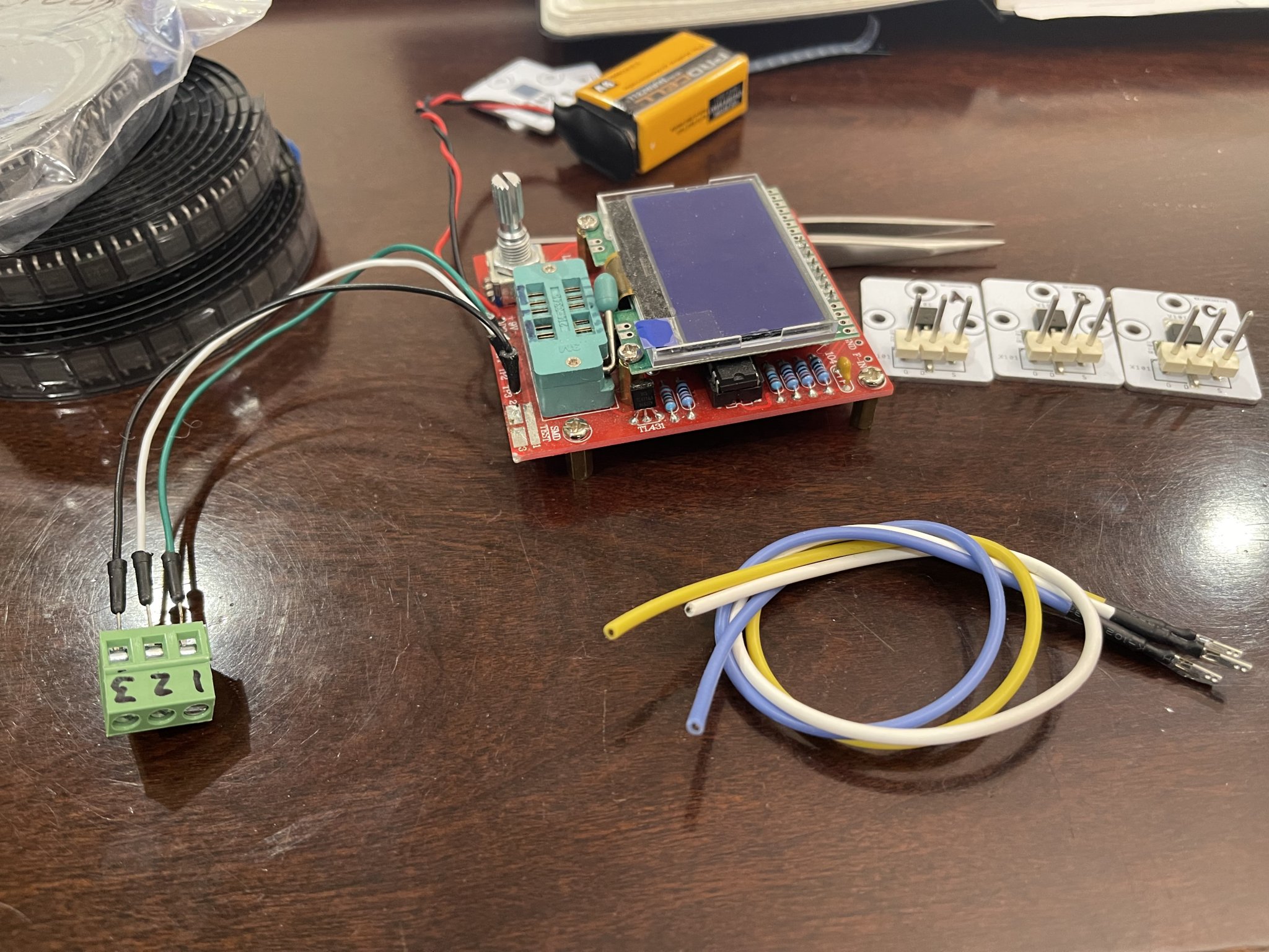

Just do a search on eBay or AliExpress “Transistor Tester” and you will see many variants. They all probably use the same underlying electronics. It seems that the ones available nowadays are typically color screen and come prebuilt (I had to assemble mine from a kit). They are about $20.
Here is an example closest to what I had with monochrome screen and has external probe leads.
12864 Mega328 ESR Transistor Resistor Diode Capacitor Mosfet Tester w/ Test hook | eBay
LCR - TC1 Multifunction TFT Transistor Tester Diodes Full Color Graphics Display | eBay
GM328A English Assembled Transistor Tester Diode Capacitance ESR ATMEAG328P USA | eBay
I’m sure anyone of these would work fine. They also can measure passive parts and is a handy LCR meter.

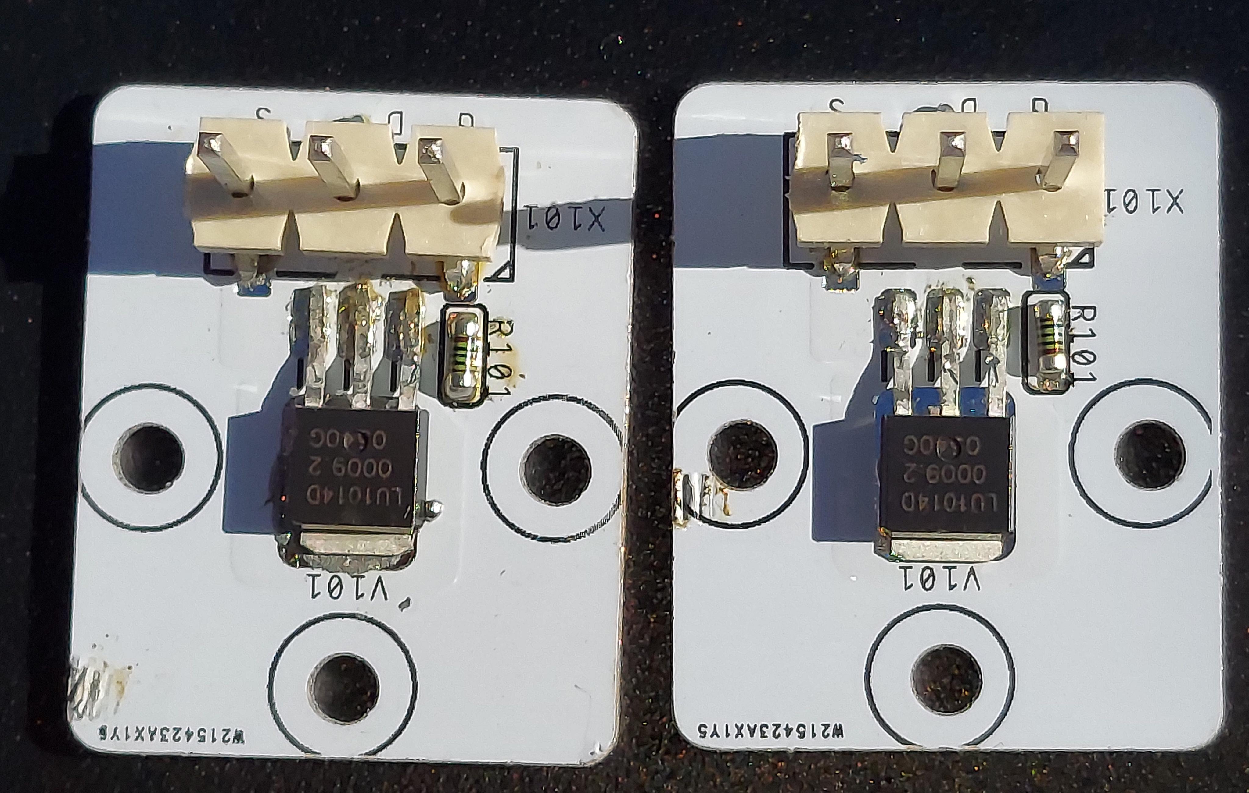

I just made my first attempt at smt soldeing on your boards using the method @lhquam showed above. I've attached an image.
I felt, without really knowing, that I might have used less that the optimal amount of solder paste and or not qute heated it enough. The devices are secuely attached, and resistance measuresments (everything to everything) are the same.
WRT solder application, it seemed that the past did not stick to the pads as readily as I expected. Is there a pre-treatment recommended (like a small dab of liquid flux)? I used the recommended Kester.
Also, does the paste solidify or dry out in the needle. Hopefully I can just use it again without needing to clean it out now, or just before I go to use it again.
Thanks for your tutorials, and all the work you share.
Skip
Founder of XSA-Labs
Joined 2012
The paste has flux built in. If you heat it hot enough, it melts and flows and forms a smooth fillet. Yours looks a bit lumpy. Maybe not hot enough for long enough. Once it melts keep the heat there for 10 more seconds to flow.
A hot plate on the bottom really helps since this is aluminum PCB.
I take a skinny resistor lead and plug up the syringe needle. Put it in a ziplock and put it in the refrigerator and it keeps for a year. When the solder paste feels too hard to squeeze out even with a new needle tip, it’s time to throw it away and get a new one.
