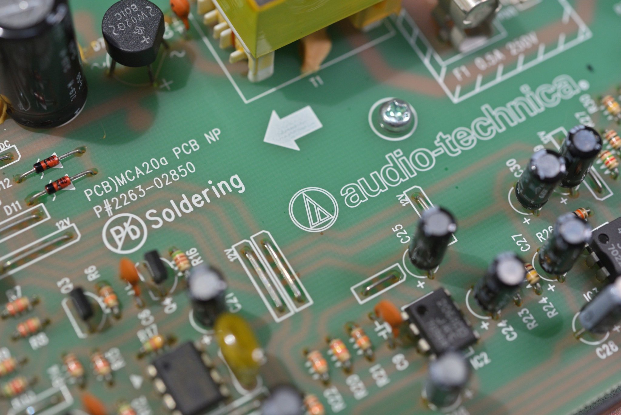

Here, for your viewing pleasure, are photos on the inside.

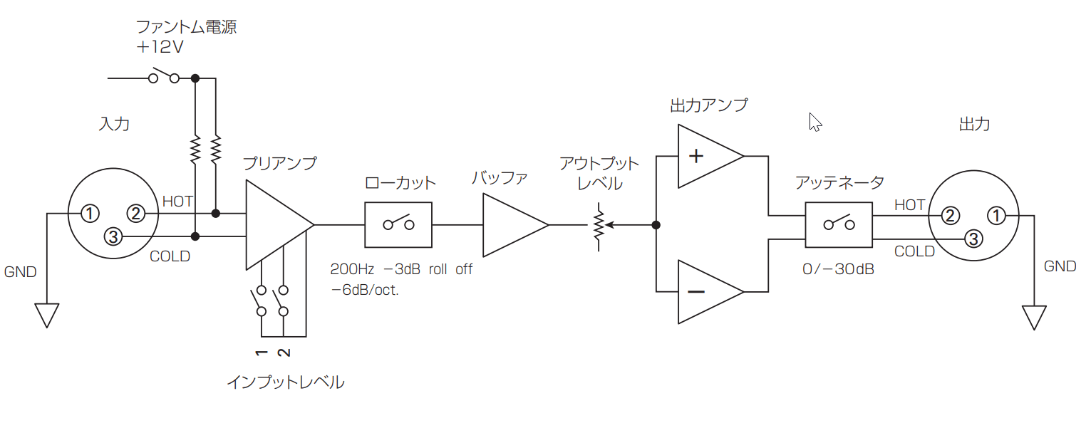

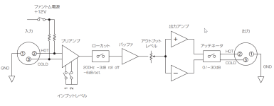

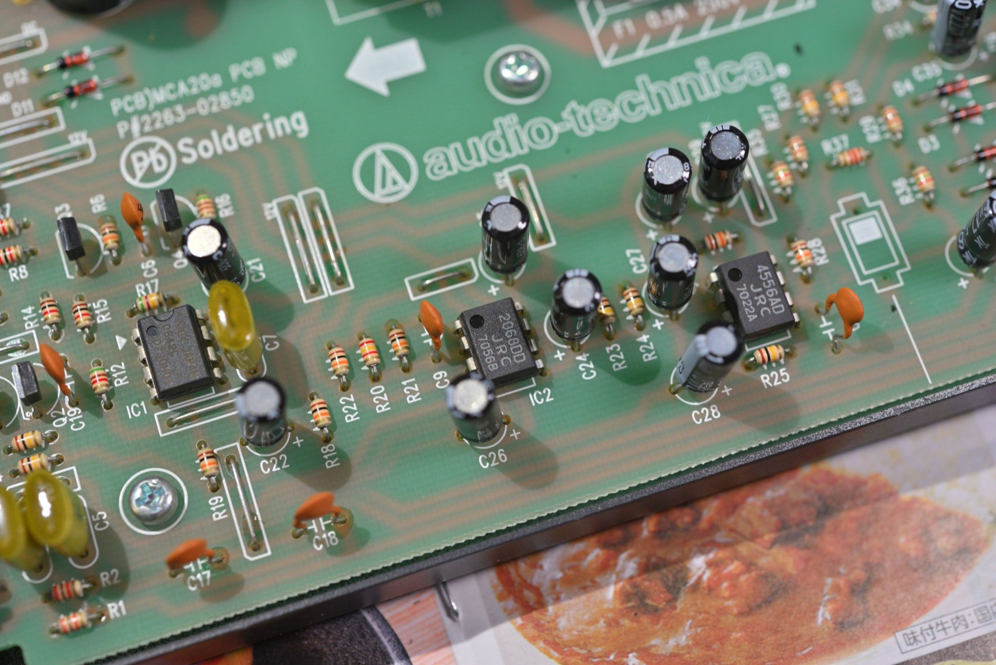

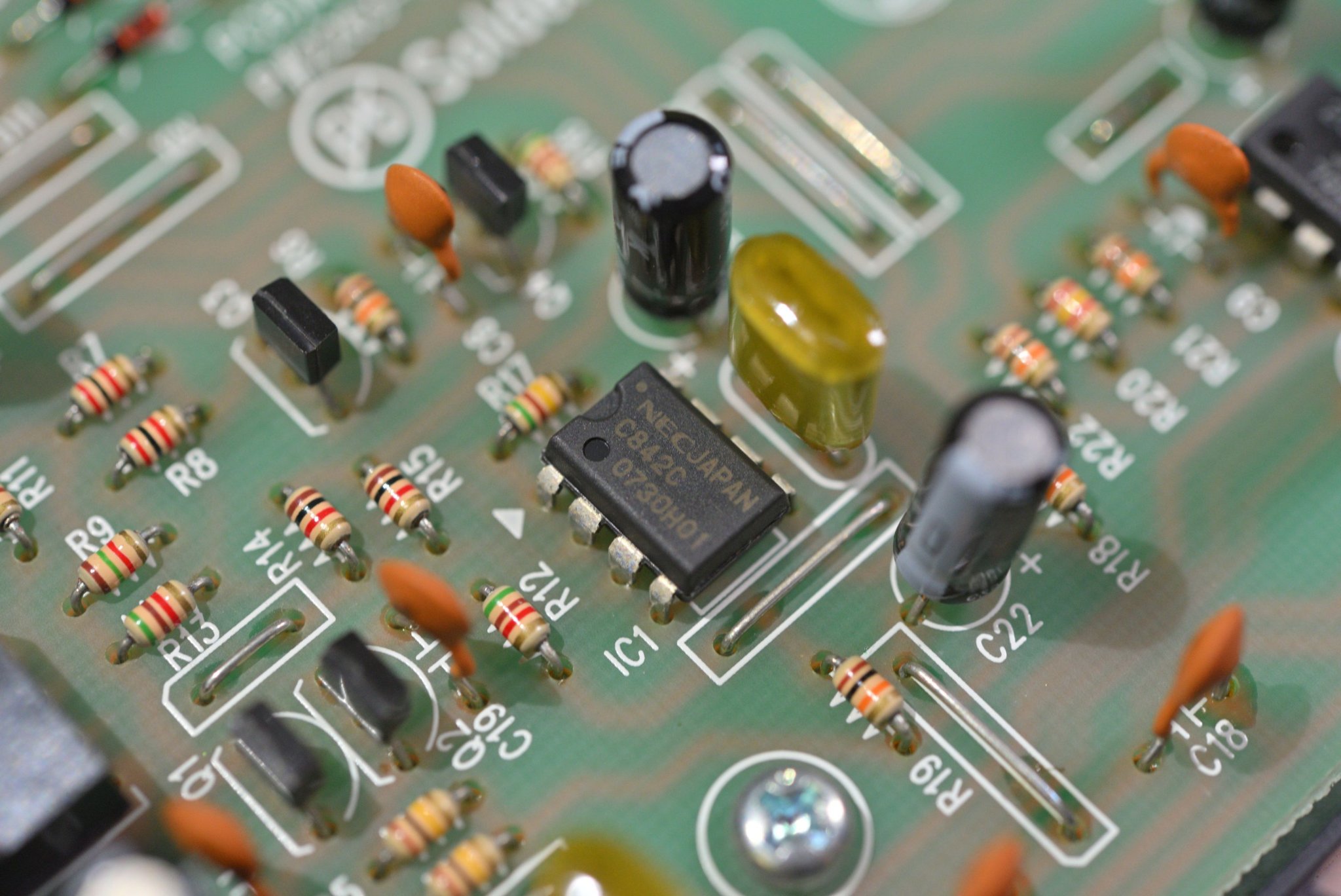

As for the circuit, the linear power supply comprises a small transformer, bridge rectifier, filter cap, and a 24 V voltage regulator. A set of Zener diodes creates +12 V and -12 V supplies and a virtual ground for running the three op amps, a NEC C842C, JRC 2068DD, and JRC 4556AD. The 4556 is a dual hifi op amp, it's the output stage, the 2068 is a low noise dual op amp, used as the input stage and buffer. The C842 is a high speed, general purpose op amp so it's probably part of the power supply. Interestingly, there are four very small transistors near the C842... I don't know their function.
