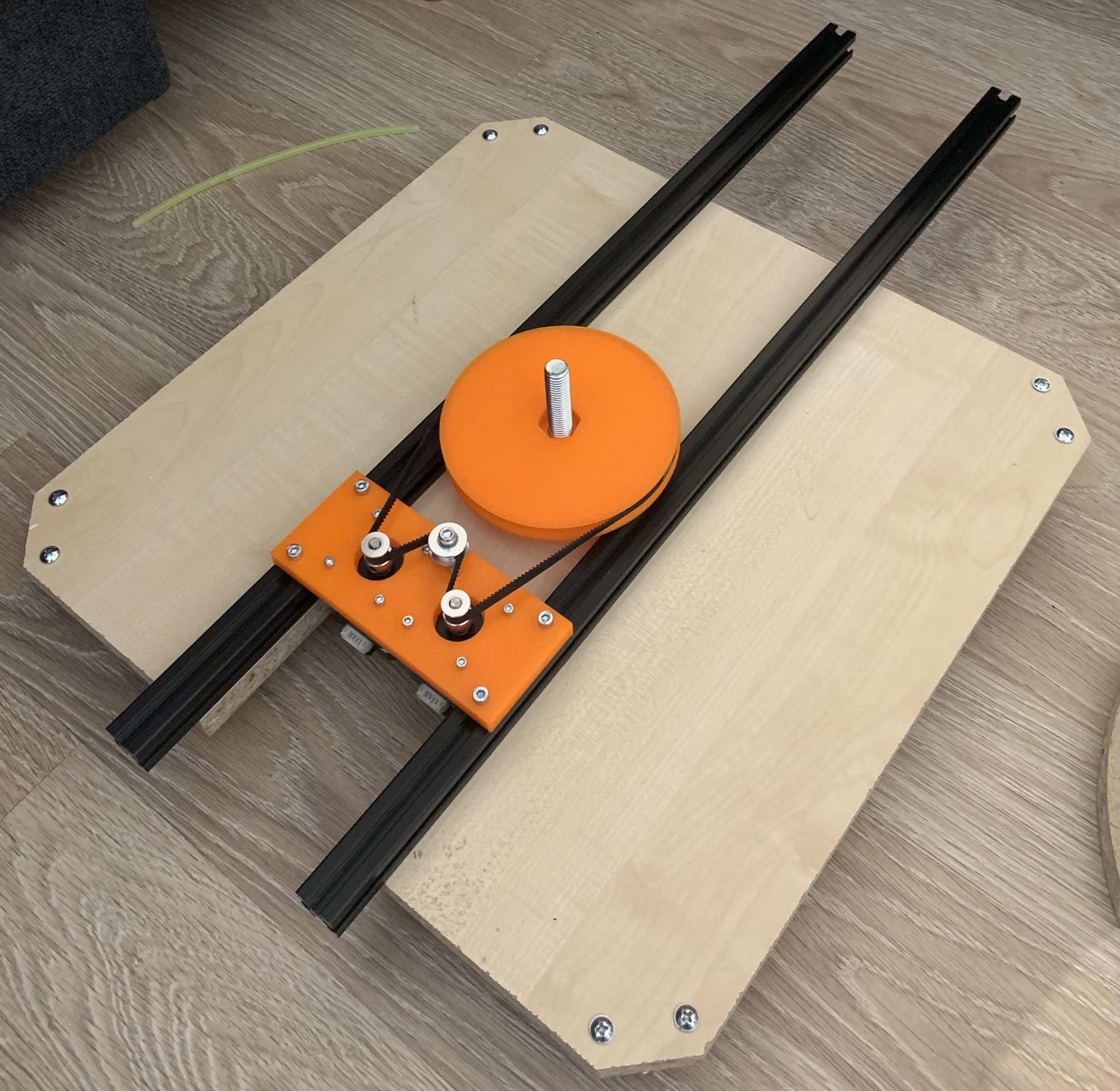

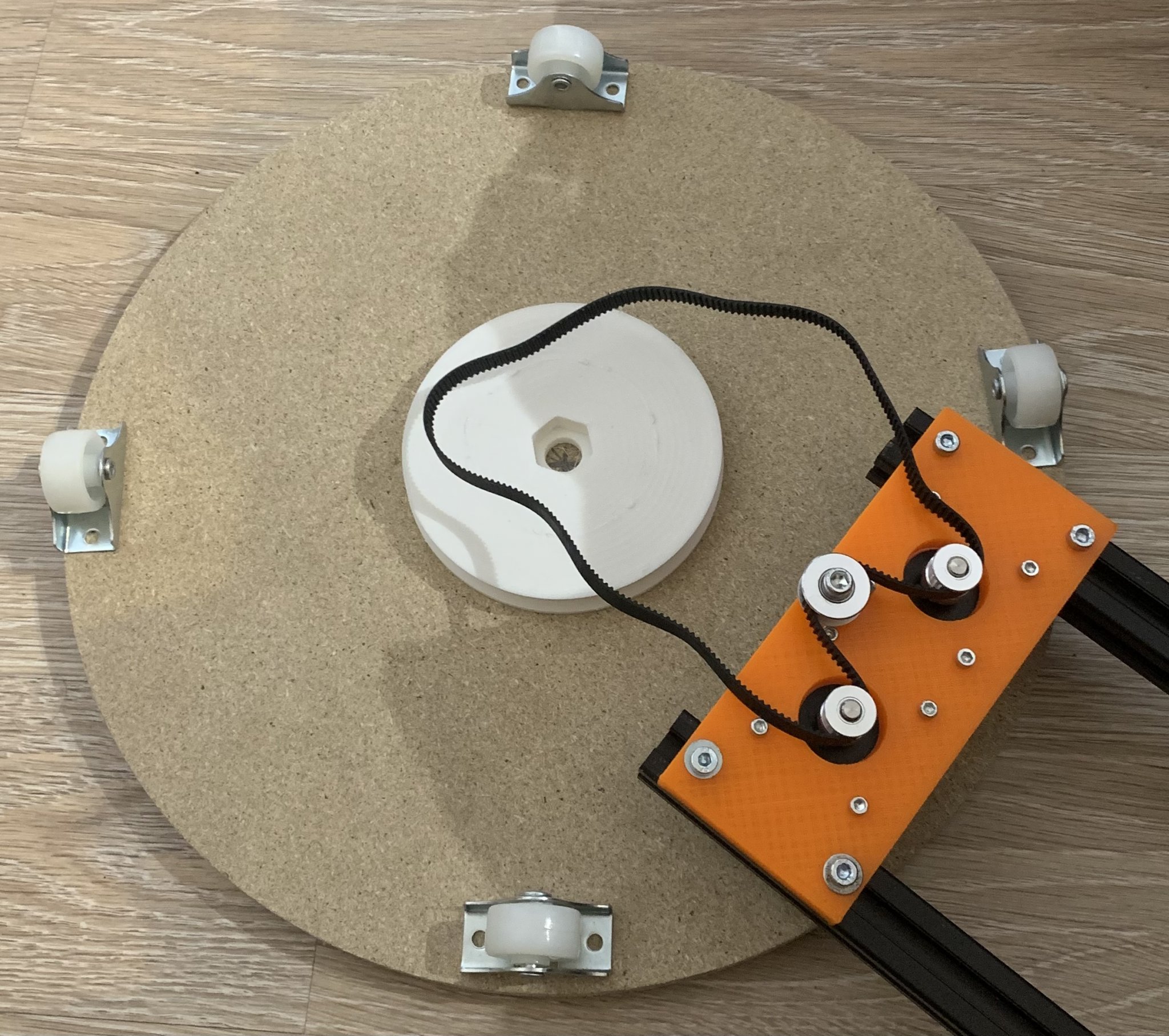

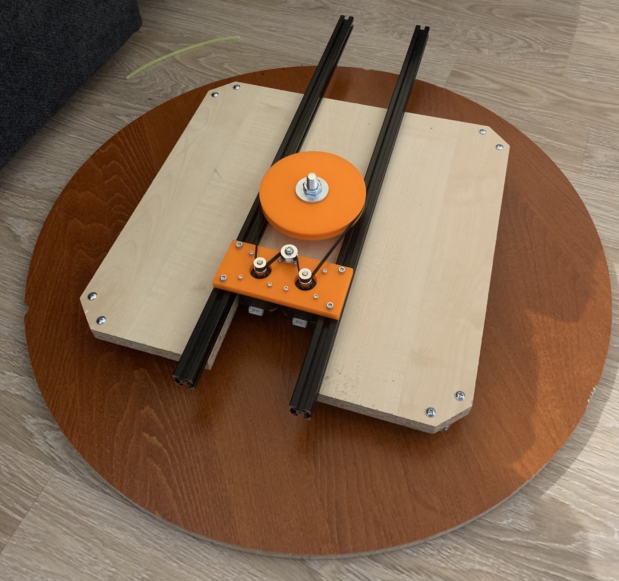

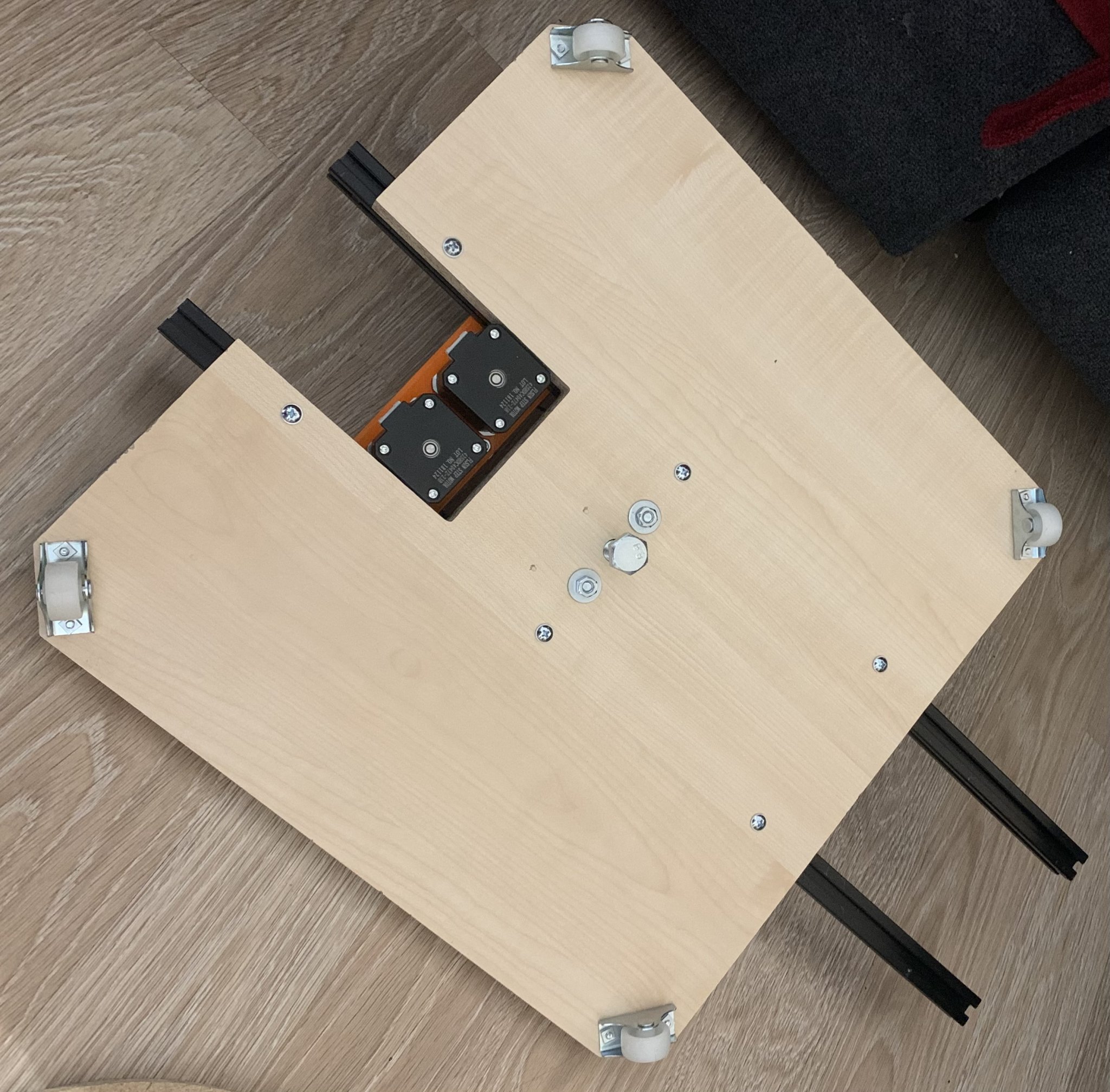

I will not build exactly this one, but it will be also based on GRBL, Arduino and CNC shield. I will use two smaller motors and a pulley between them, just because I had them from a 3D printer. Powered from an old laptop supply.
From a serial terminal, it works perfectly. I got it moving also from Clio Pocket - if your Windows use a decimal comma instead of a decimal dot, you need to change that in Windows to get it to work. At least in the current 2.2.0.0 release.
So this is more or less a failure. I upgraded the belt from 6 mm to 10 mm and a larger toothed wheel. And the two motors still loose steps at some points, the screw for the axis is maybe bent or there is too much friction somewhere. I still think a pair of NEMA17 motors must be able to handle this - I only need a higher gear ratio. Now I need to figure out a gearbox to fit.
