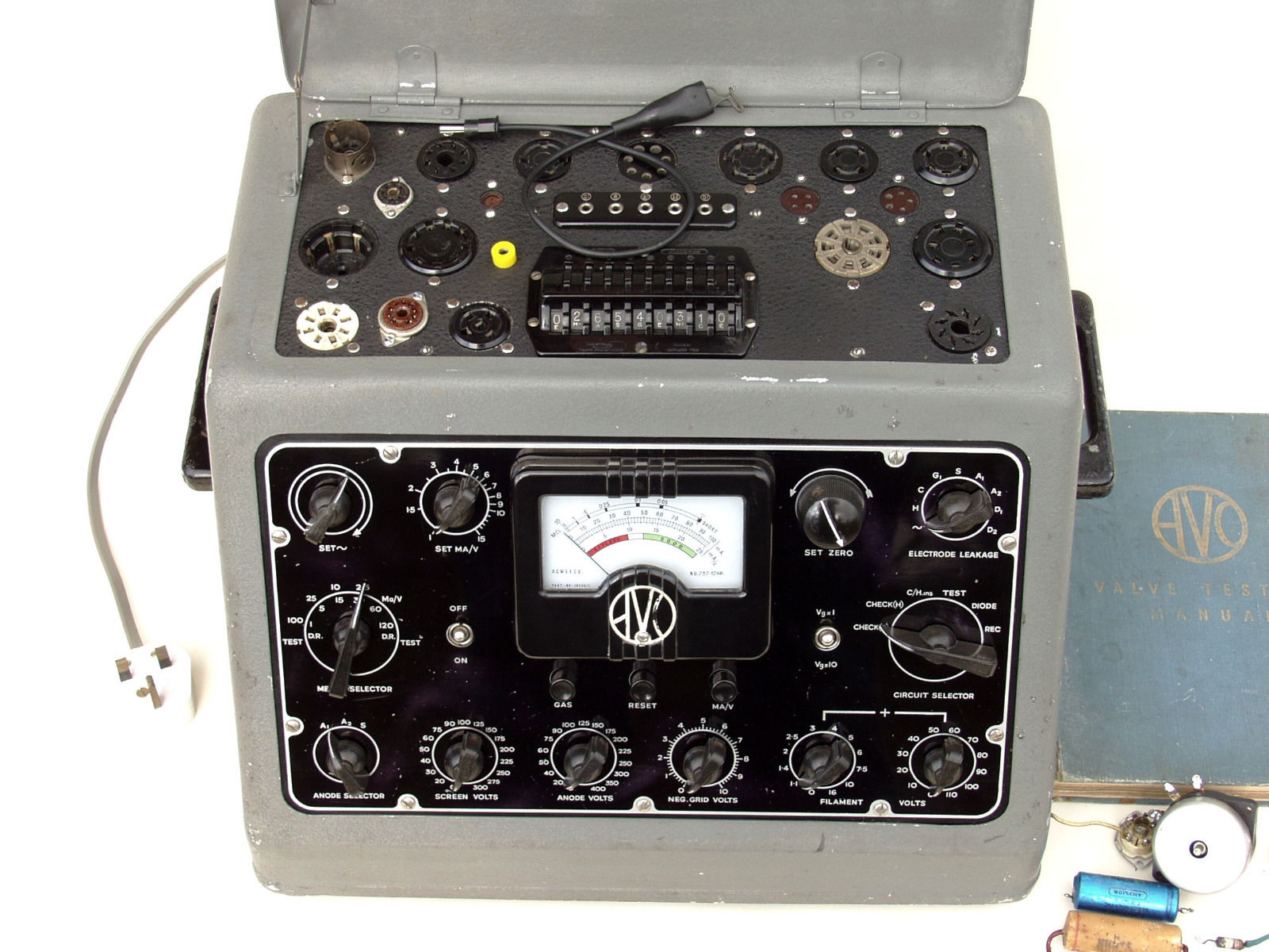

Actually either the "Valve Tester" if it still has the second panel without a roller selector switch, or the later "Valve Tester with Universal Panel" if the second panel is equiped with the roller selector switch.
AVO offered a third panel for the "Valve Tester" to keep up with the introduction of new valve types but soon chose for the roller selector switch.
"Valve Characteristic Meter Mk.I" is the name for the tester in the last attachment. It only started to be named Mk.I after the AVO Mk.II was introduced.

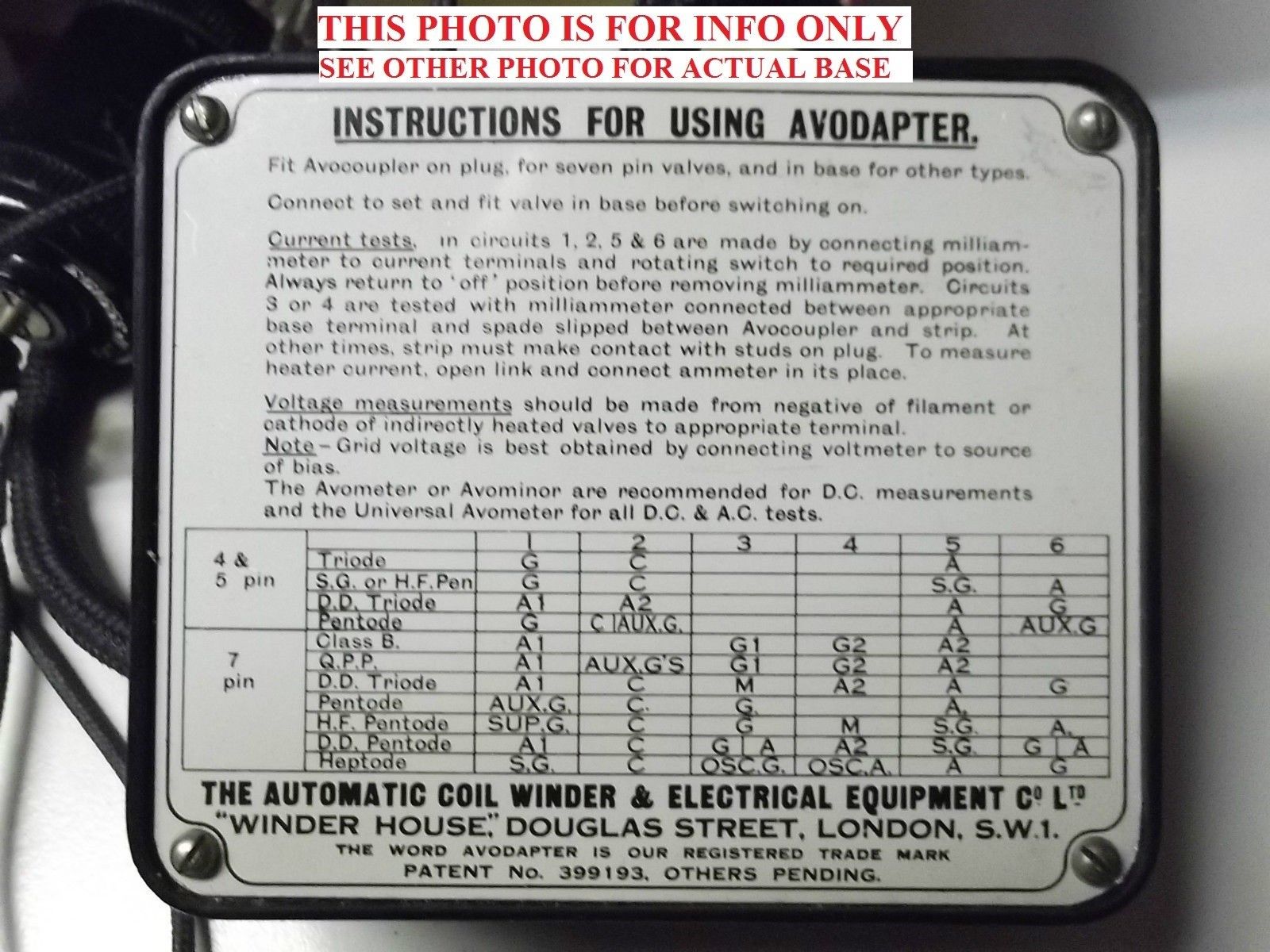

Actually AVO had an earlier valve tester called -quote- "the Avoadapter " where a meter is inserted into the feeds using a rotary switch using a base and flexible cable which morphed into the later model .
This allowed various tests to take place and no I didn't use the internet I have AVO,s own original manual dated early thirties so the original "valve tester " as put forth in indisputable print by the company itself is really the "first " .

The AVO book I have is dated -1934 and along with the Avoadapter is the Avocoupler and enables the adapter to be set up for 5 or 7 pin valves which is an early version of later valve tester adapters with a socket at the top and the base having the pins.
Two spring loaded side studs allow for 7 pin use.
The conclusion at the end of the book describe the adapter as "helping towards a clearer conception of modern radio servicing "-end quote.
