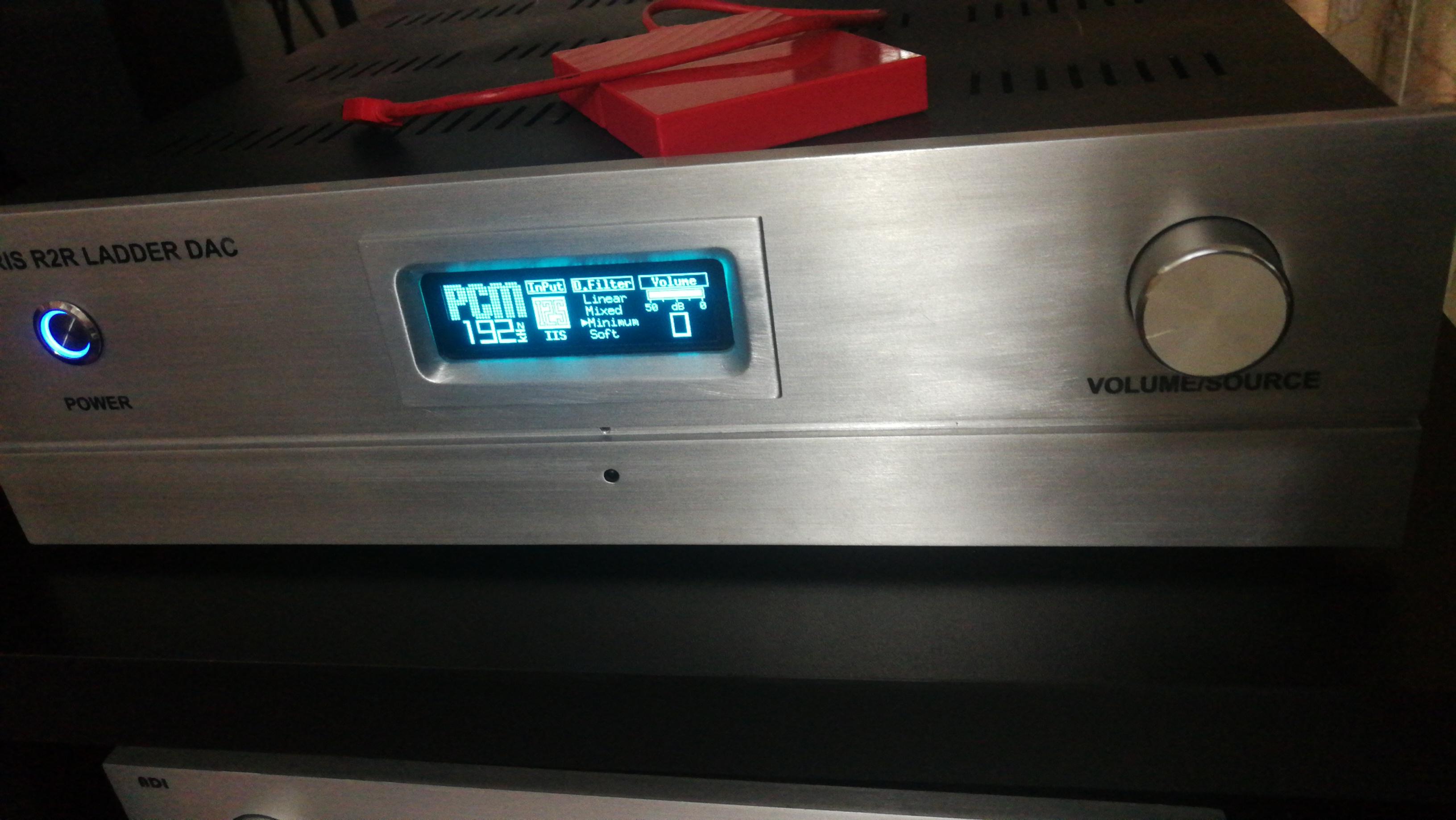

I am using AZ OLED lite kits with dam1021. My setup is with a raspberry pi, and using Moode Audio. It is working perfectly, but it does not show up "DSD" once dsd file is played, instead it shows "PCM 192khz". Another observation is once I play flac file it is always " PCM 44.1", where as my Gustard x26 DAC shows some of those files are 96 khz or like this. Is it a problem? Image showing a dsd playback, this file shows 2.82mhz sample rate in Gustard.

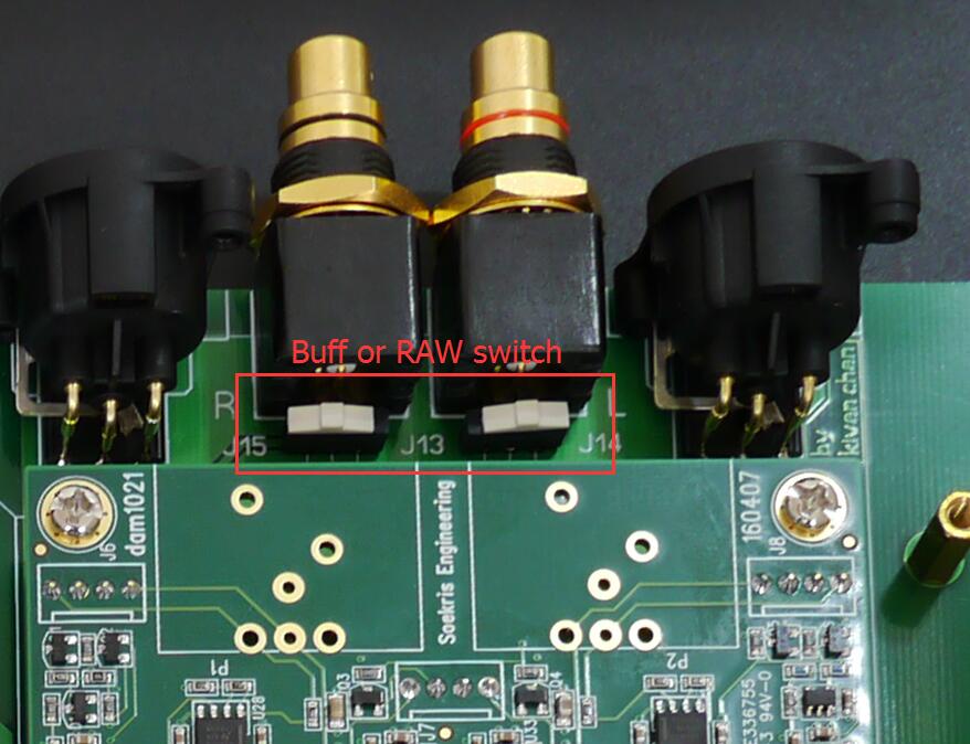

Both switches are inward, RAW
Both switches are outward,BUFF
Maybe I missed it but which switch position is buffered?
Left/Left
Left/Right
Right/Right
Right/Left
I assume based on the attached screenshot that it's Left/Right
Please check the settings of your raspberry pie player soft,Az1021 will not make any judgment, only display the status of dam1021.
