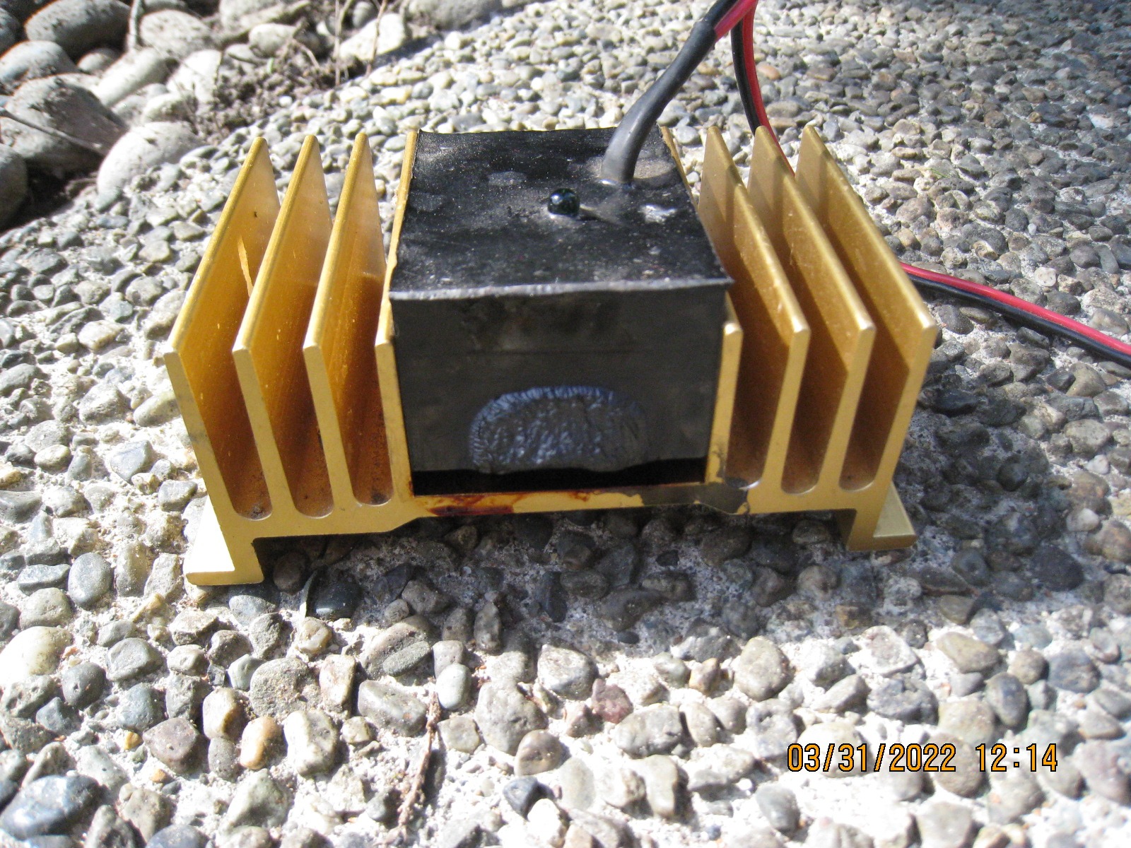

I purchased the "Battery Life Saver" perhaps more than a decade ago, off ebay from the OEM as a "cosmetic second". I dare say it works. having brought back its money's worth of lead acid batteries from going completely useless. Last night, I connected it (along with the "brick" charger) to my 24V lawnmower whose batteries are losing capacity - and went to bed. During the night, it burned emitting magic smoke and oozing a quite noxous brown oil that I cant quite get the smell off my hands (see pic). A potentially more dangerous situation than smelling up things out in the garage and my person.
I called the place which is still in business and offered to send it back for FA. They offered 10% off of a new unit, which is ~$100+. There was no reason for it to fail, as it's rated for use up to 36V. It's potted as I assume they dont want you to discover "how it works" easily.
I'm not sure I want to buy another unit. I'm an engineer, I have a function generator and I know how to drive a FET to sink current pulses. The OEM touts "Square Wave Technology" - I know what a square wave is. When it was working, I never bothered to assess the frequency, the duty cycle, not the current amplitude of whatever it does when you connect it to a battery.

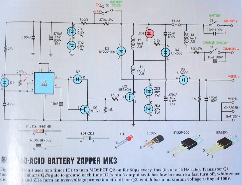

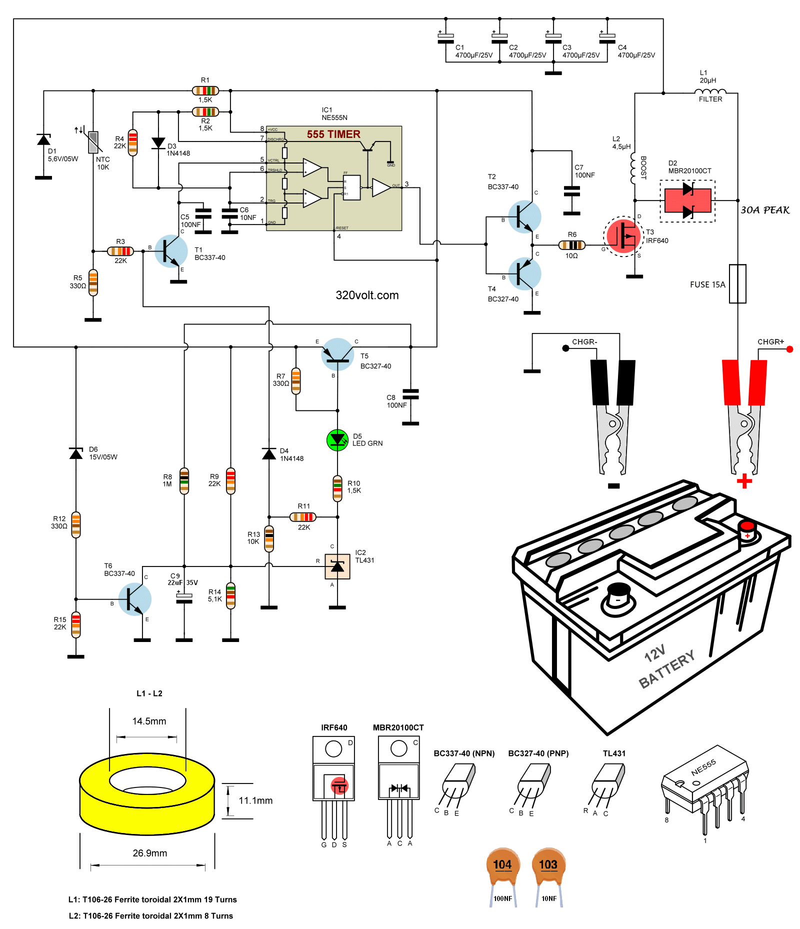

I did build one very similar to the schematics presented above using 555 timer and IRFZ44 as the main switcher but it's only 55 Vds and I have a memory the voltage spikes mine produced was more than that, maybe up to 70 Volt, the FET lived for a while but eventually died although it didn't get particularly hot, I ran mine at as high frequency as possible by checking with a scope to get the max surge out of the flyback inductor, I think it was maybe up to 5 kHZ but my inductor had too high inductance which set the upper frequency limit, can't really remember as it was so long time ago. I think maybe one can run at much higher frequencies as the point is to let the voltage spike penetrate through the sulfate and break it up, and the faster the repetition the faster the desulfate process goes I would think.
Today, I just finished something very similar to the Zapper MK3, above. I drive the fet with one of my function generators, got as best I could dig up with the relative coil values, getting it that the larger inductor blocks the flyback pulse so most of it goes into the battery. (I have a 0.27 ohm in my fets source, so I can see the current waveform; hopefully what I'm looking at is the smaller inductor "charging"...). It's putting a positive going spike 40V above the 24V dc value; I'm trying to do both batteries at once. Heatsink isnt even warm, guess I can sleep tonight with it on.

On closer inspection, the parts lists don't give detailed specs for the inductors, but luckily the pictures in the EPE article show Jaycar part numbers:
LF1322, 1.0mH, DCR: 0.74 Ohms, Wire Dia: 0.8mm
LF1310: 0.22mH, DCR: 0.3 Ohms, Wire Dia: 0.8mm
0.8 mm is close to 21 gauge

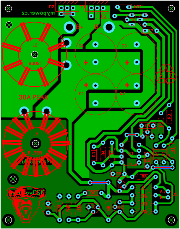

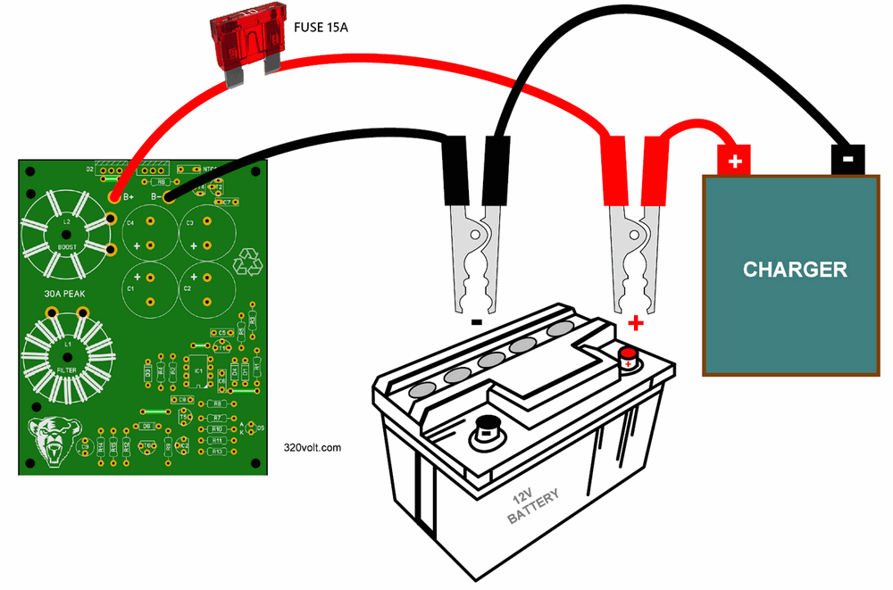

Hello, it works.
The long test has begun. Results of the first day. (This is just a simple time test.)
  • Fully charged expired battery (12v 60ah)
  • A 10 A load was connected, after 40 minutes the battery voltage became 10 V
  • The battery was recharged and connected to the desulfation circuit (1 day in total)
  • A 10A load was reconnected. After 95 minutes, the battery voltage becomes 10V.
The process will take a month, now everything is fine. Green light appears :)
source: http://wiki.mypower.cz/desulfator
