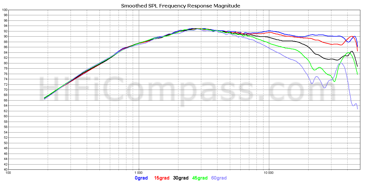

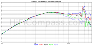

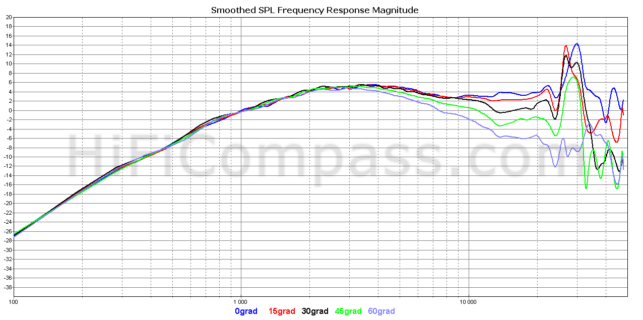

Don't know ... there is only one company in the world which can do it as far as I know that's probably part of the price problem ...- Firstly, a pair of 1 inch domes typically contains a couple of Euro worth of diaphragm material. The process of making them is similar to that of making aluminium or titanium domes. I see no reason why every Be dome should be priced several hundred Euro over their aluminium or titanium counterparts.
Did you compared the sound of both T34? I only had the T34A here in a prototype and compared in a well dampened room to T25B. And prefered T25B.- Secondly, in some cases, there are other metal domes that perform at least at the same level as their beryllium counterpart. One great example is the Bliesma T34A vs the T34B. Still people go for the beryllium version without hesitation. Some have even described the sound difference. It is like a copy-paste of any other beryllium vs anything else-review. It is like people struggle to listen past the material. A bit like when people are unable to un-hear the "metallic sound" of a metal dome, while the flawed dispersion pattern of a soft dome just gives "soft sound".
But T34A is crazy off axis, I had the impression there is even more top end off axis as with T25B.
I didn't had the chance to give a listen to the T34B but to be honest also being curious if there is a lot of sound difference beside the off axis behaviour - resonance frequencies are pretty close.
That is correct.But T34A is crazy off axis, I had the impression there is even more top end off axis as with T25B.
the T25b has the "same diaphragm shape as the T34B, that is why.
easily seen in the measurements.

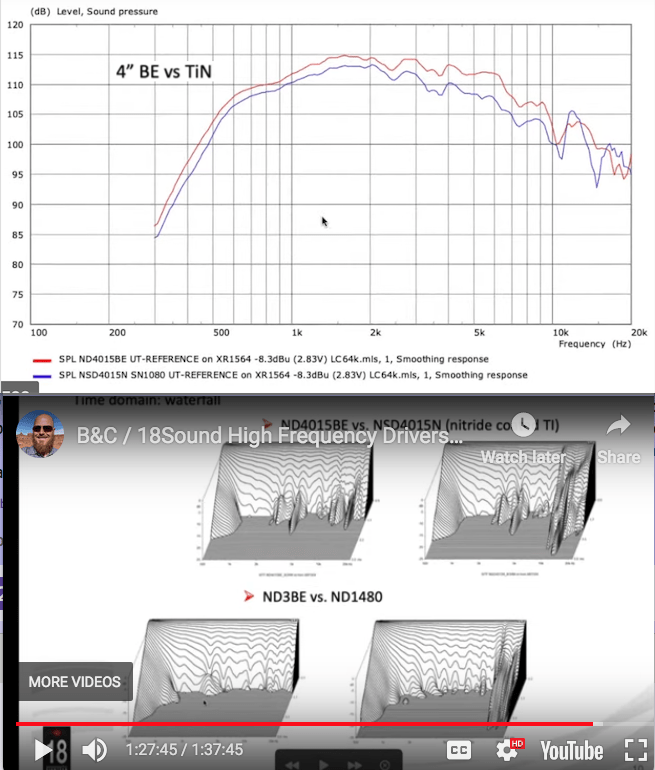

When people test beryllium compression drivers, even 4 inch drivers, where the main break up is well within the audible range, people describes them as having "the same sound as beryllium domes", while small beryllium domes do not ring in within the audible range. They do not have the same type of sound.
Hello
Can you point out where you have seen break up modes in 4" Be compression driver measurements?
Rob

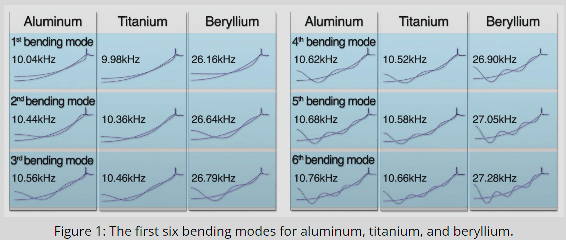

It is hard to determine such things on frequency response curves as everything is filtered through a phase plug. I will however recommend this article:
https://audioxpress.com/article/Voice-Coil-Spotlight-The-Beryllium-Advantage
If we look at this figure:
We can clearly see that beryllium is a significant improvement over aluminium or titanium. However, we can also see that there are several wavelengths within the radius of the dome at 4 inch/26,9kHz. The 1 inch dome has its first resonance at 26,16kHz. Moving up to a 4 inch with the same profile, this should give us the same initial resonance at around 6,5kHz. What we typically consider to be the break up point is close to 1 octave above this point. The first resonance is typically not as pronounced on domes as it is on cone drivers, so it is really not to be regarded as a problem.
But there are two huge factors to add to this. One is that the above figure is very shape dependent. To my understanding, it is based on a simple dome with the materials Youngs modulus and mass as the main mechanical properties. In practica cases we can see 1 inch aluminium domes breaking up at 15kHz, but also at 30kHz. This is very shape dependent. There are also other properties in the material that comes into play when we use a taller dome profile. It is a bit like comparing a flat stone bridge to a flat steel bridge. It does not tell us all about the differences between arced stone and steel bridges.
Also, my comment was that the typical sonic signature of a beryllium 4 inch dome would not be the same as a 1 inch beryllium dome should be valid. It is more reasonable to say that the sonic signature of a beryllium 4 inch dome is close to the sonic signature of a 2 inch aluminium dome.
Unfortunately I have not had the oportunity to do that. But I see that they are both measured by Audio Compass. It is quite fascinating to see how close they are to each other.
I often argue that top end dispersion is one of the audible advantages of great metal domes. It seems like you have come to the same conclusion.

ThanksIt is hard to determine such things on frequency response curves as everything is filtered through a phase plug. I will however recommend this article:
Might be on an FR curve although typically the peaks are visible you have irregularities in the impedance curve and clearly visible in a waterfall plot
The domes in the table are all 4" How are we moving up from a 1" dome? 26.19k is the first on a 4" not a 1"? Are you considering the 1st bend mode as a resonance?
I don't see how you could off the cuff say that this 4" Be should sound like a 2" Al.
Based on what??? Really should be looking waterfalls to see what is actually happening.

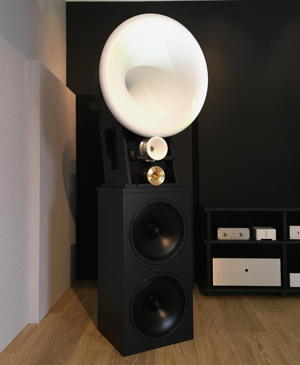

Yes as @Snickers-is mentioned i prefered B&C DCM50 (450-2800 Hz) instead of JBL2446 with Truextent beryllium (600-3000 Hz) in the Tractrix 200 horn.
DCM50 have a organic smooth airy and very detailed warm sound. In the classical ca 300-3000 Hz «thelephone» range it cant be much better
But if i compare all factors i honestly think i have better sound today with my current system on the picture here and it is better sounding that almost every other systems i have heard. I am very «afraid» of selling the JBL2451 Truextent beryllium drivers i have. Maybee i never get as good sound again?

I should have put my glasses on there... But how can they claim that the different modes are at the same frequency?The domes in the table are all 4" How are we moving up from a 1" dome? 26.19k is the first on a 4" not a 1"? Are you considering the 1st bend mode as a resonance?
I don't know??? 1" vs 4" you would expect the 1" to be higher and I didn't see any references to 1" unless I missed it somewhere? That data is from the Materion large format compression driver materials comparison AFAIK it was all based on 4" domes. And they used a JBL core to test.

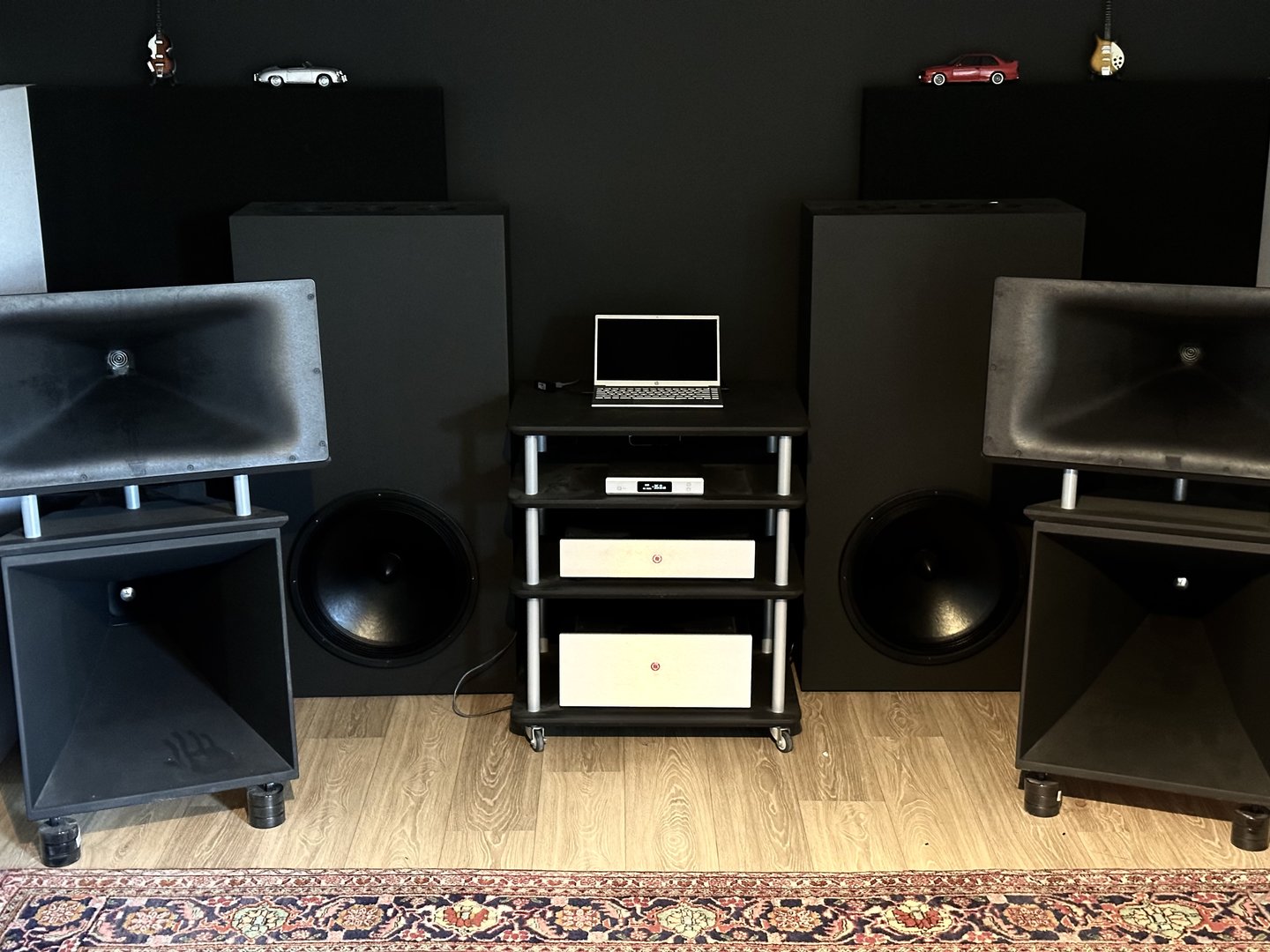

Are those twin TD15M?
TD12M apollo
They are here today with TAD2001 in the small Tractrix 1000. Audiolense take care of the crossover and it sounds better here than in my room & old system. The new owner altså tells that Purifi amplifiers lifted the sound quality even a little more.
https://www.hifisentralen.no/forumet/threads/bjarnetvs-hi-fi.55582/page-36#post-3724642

Are you sure those are not simulations? Maybe the diameter has been considered secondary, so they have tried to match the size of the dome so that every mode ends up on the same frequency? I have no idea to be honest.
