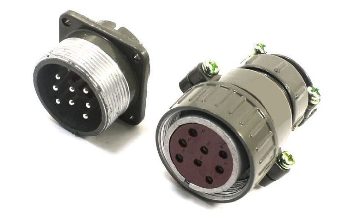

FWIW for about 10 years I sold and used active PA cabinets which were daisy chained, as many as you need depending on venture size, from 2 per side for Clubs to 24 per side for Stadiums.
I used multipin Cinch type industrial connectors, the large round ones with a chrome plated ring for secure mounting, 2 to 4 pins carrying mains, 4 for balanced Audio (+hot -hot, ground, shield) , each cabinet had 2 chassis type connectors for daisychaining ... never had a problem.
Each Cabinet contained it's own 400+100W biamp and crossover.
It was "the thing" for some time, certainly more practical and fast than a full setup with big power amps + processors on each side of Stage and a myriad cables feeding speaker level signal to a bunch of cabinets, horns, etc.
Cherry on the cake: if one cabinet dies for whatever reason, its fuse blows, it self removes from the picture, the rest keeps working, public notices nothing.
