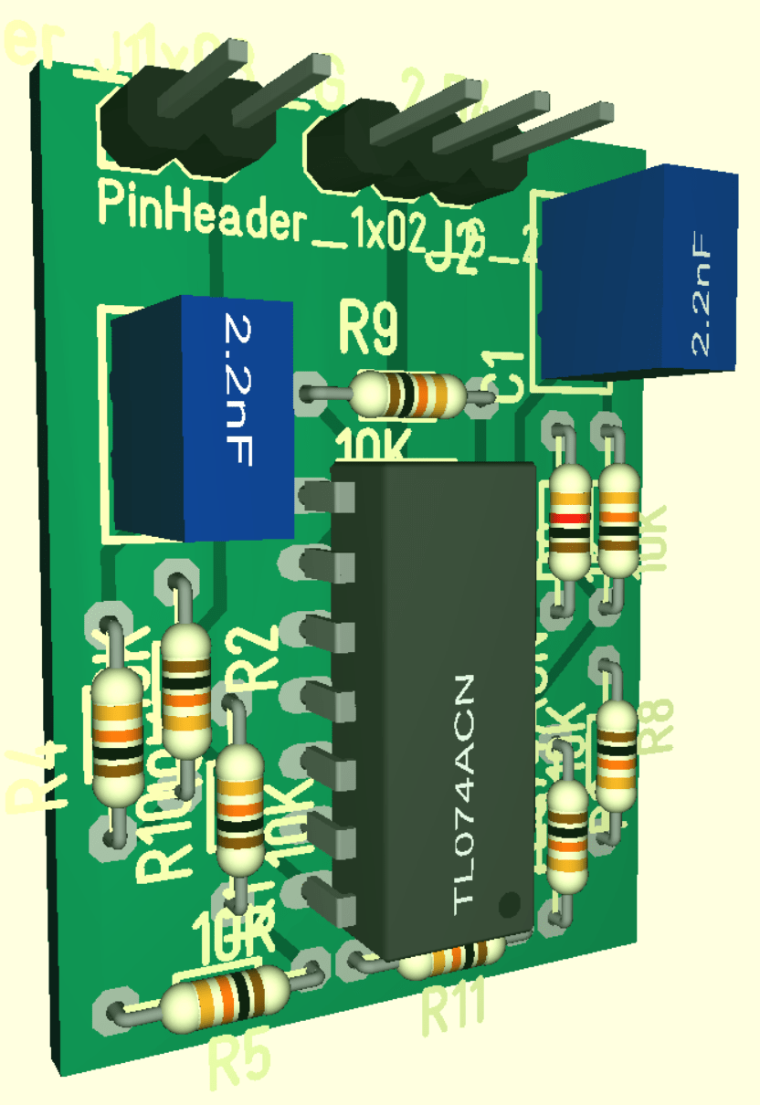

OK, have some progress to report. I managed to come up with a thru-hole layout for a daughtercard on a 25x35 mm footprint PCB. The pins would obviously be the right angle type in practice. This card would plug into a 2+3 holes on the motherboard for signal and power+gnd. It would probably be better if I restricted the motherboard to 8 cards (two sets of four in two lanes) for size purposes, but I will have to see how the cost scales for that layout. A 35mm board mounted to another PCB at a right angle might just fit inside a 1U case... if not I can reduce it by a few mm by moving the pin headers on the daughterboard down, since there are no tracks there.
I want to ask about PS rail decoupling. I used a single 0805 SMD 100nF ceramic cap on the opposite side of the board as the other components so that I could place it directly between the V+ and V- pins of the DIP op-amp package. I am wondering how much bulk capacitance (e.g. 10-100uF local PS reservoir caps) I should place on the motherboard, where, and how many? Just a pair at the entrance to the board, or should I use a smaller value pair adjacent to each daughter-card on the motherboard?

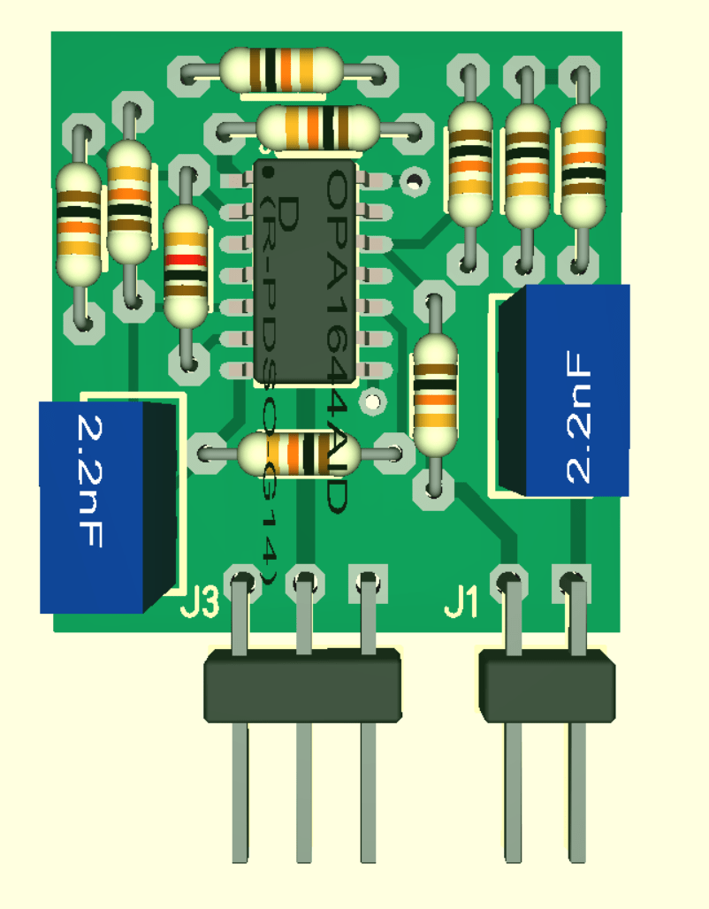

After some investigation of what quad-amplifier op-amps are available in a DIP package and what was not, I decided that an SO package would be better for versatility. After the substitution I was able to redesign the board to be much smaller, now just under 1 inch square. The SO package is really not all that difficult to solder to the pads. After that and the one SMD resistor on the back, everything else is thru hole...
Hmm, I am having trouble creating a decent ground plane on either side. The problem is that the board is quite small and or the components are packed in tightly. There is not enough room in several places for the ground plane to continue through to other parts of the PCB area. I tried to move some tracks and added a via just for ground, but I am worried that this will cause more problems that it is worth. Of course I could oversize the board by 10% and this would open up enough area around the edge of the board for the place to flow to most of the board, but there will still be a couple of islands not covered. Is the ground plane all that important for a line level circuit without much amplification, if any?
I should add that I expect the op-amps will be FET type input state and so resistances will be higher and currents lower.
No bueno. I tried all SMD and it was (a) a mess and also (b) larger footprint compared to 1/8W thru-hole where you get free access to both sides at each TH. Also, this is a project that will be assembled by DIYers like me who are not well versed in SMD soldering and working with small SMD is a PITA when you cannot read the markings! I am trying to keep it simple with one SO device and one 0805 cap. Hard to mix those up...
Another option to consider is to use a 4-layer board and route power and some traces on the inner layers - in small boards the cost penalty is minimal IMLE. I use JLCPCB out of HK for my boards. The ground plane is helpful. Don't route traces you may want to rework entirely on inner layers at least until the design is completely debugged and settled. Consider capacitance between planes and certain circuit nodes as well, you can window those areas if there is a concern.

just my 2 cents on mother/daughter setups - connectors will cause issues. I would make the modules larger such that you use no more than 4 boards max per unit. It also makes the daughterboard easier to secure mechanically...

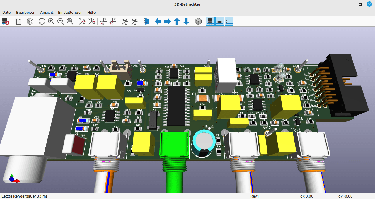

After 25 yrs using eagle I moved to KiCAD. I had to learn much, but it was worth the effort. A nice feature I got used to is the 3D preview, quite convenient to check component placement. My preferred size with hand-soldering is SMD0805. Just switched to 4-layers to achieve best EM immunity (cell phones!). This is the preview of my latest "guitar strip", i.e. complete pre-amp channel featuring overdrive, reverb, tone control, master volume and soft clipping.
