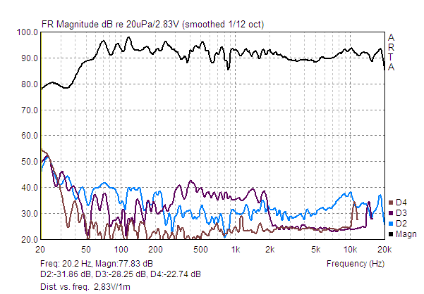

Because sensitivity was not main issue, 92dB/W for domestic use is (IMO) more than enough in active setup (bas-himid, passively crossed mids/highs) with more than 100 watt SS amps..
More important is low distortion to frequencies below 100Hz, 2" voce coil, transient response ( possibility to use 6dB/okt. crossover), and smooth directivity patterns in cooperation with TPL150H,and all this at very competitive price. Result is very natural and "pleasant" sound, even at high SPL.

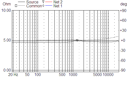

I wonder how badly, the crossover affects the electrical damping of the TPL.
Padding with a resistor can only make it worse.

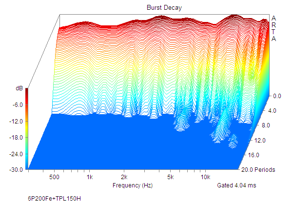

Just thinking about the ~5ms decay at resonance.
Anyone done their own impedance measurements of the TPL?
Not sure what the conditions were when they made the impedance plot on the datasheet.
Attached.. Quite pure resistive load.
Nothing like resonances, look second attachment (time axis in periods..)

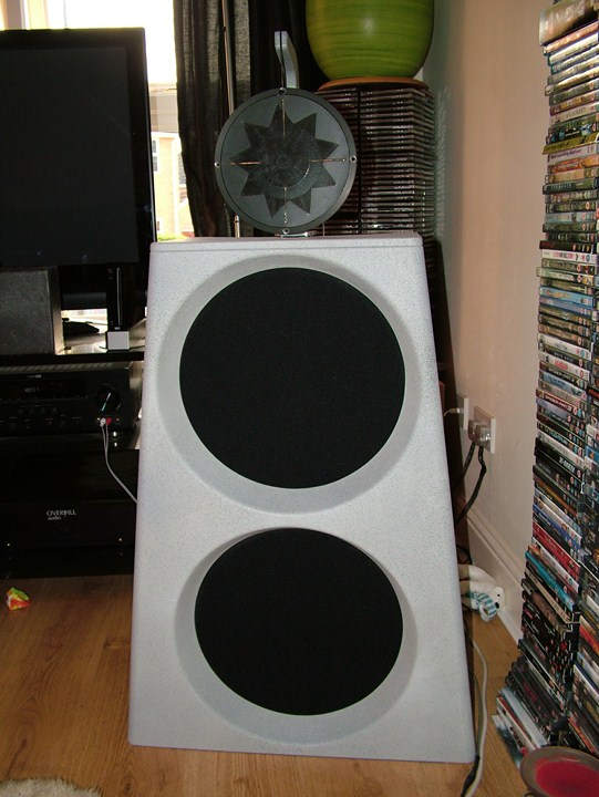

Beyma 15 inch 115K

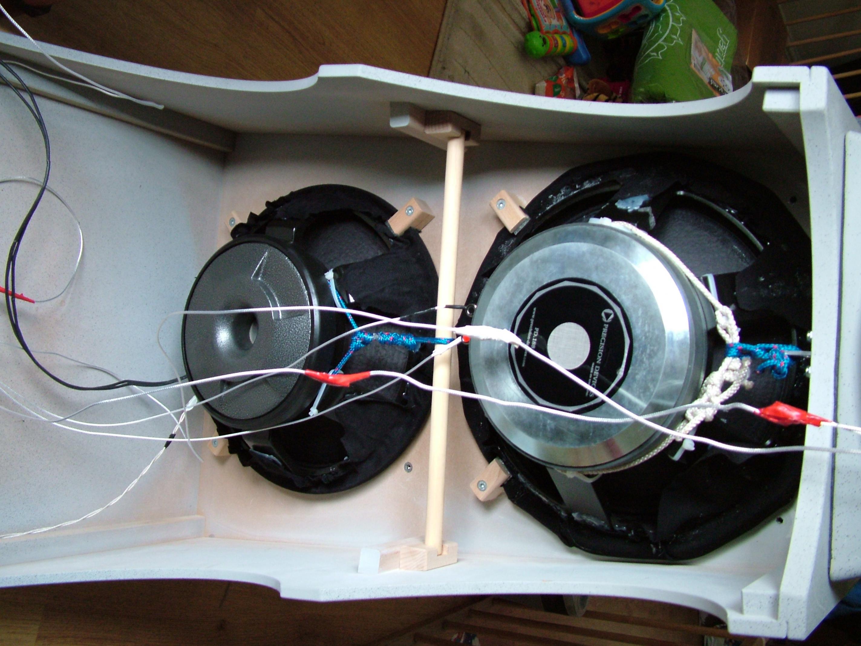

Hi Angelo,
You mentioned the Beyma 115K...I have used a pair in various cabinets and can highly recomend it.
It is great value and runs the Precision Devices 1550 very close, and the PD is more than twice the price!
The attached show the 115K as bass with the PD 158 as low midrange, 100Hz to 400Hz.
In open baffle the Beyma and PD 1550 are almost identical below 100Hz.
If you cross over higher, up to 250Hz then the PD is cleaner and more detailed, also the PD can handle more power ( only a factor with Eq).
In a 90 litre sealed box the PD is the better bet, I run the PD 20Hz to 80Hz as corner subs. I only use them for home cinema when you want effects and expolsions rather than music.
All the best
Derek.
