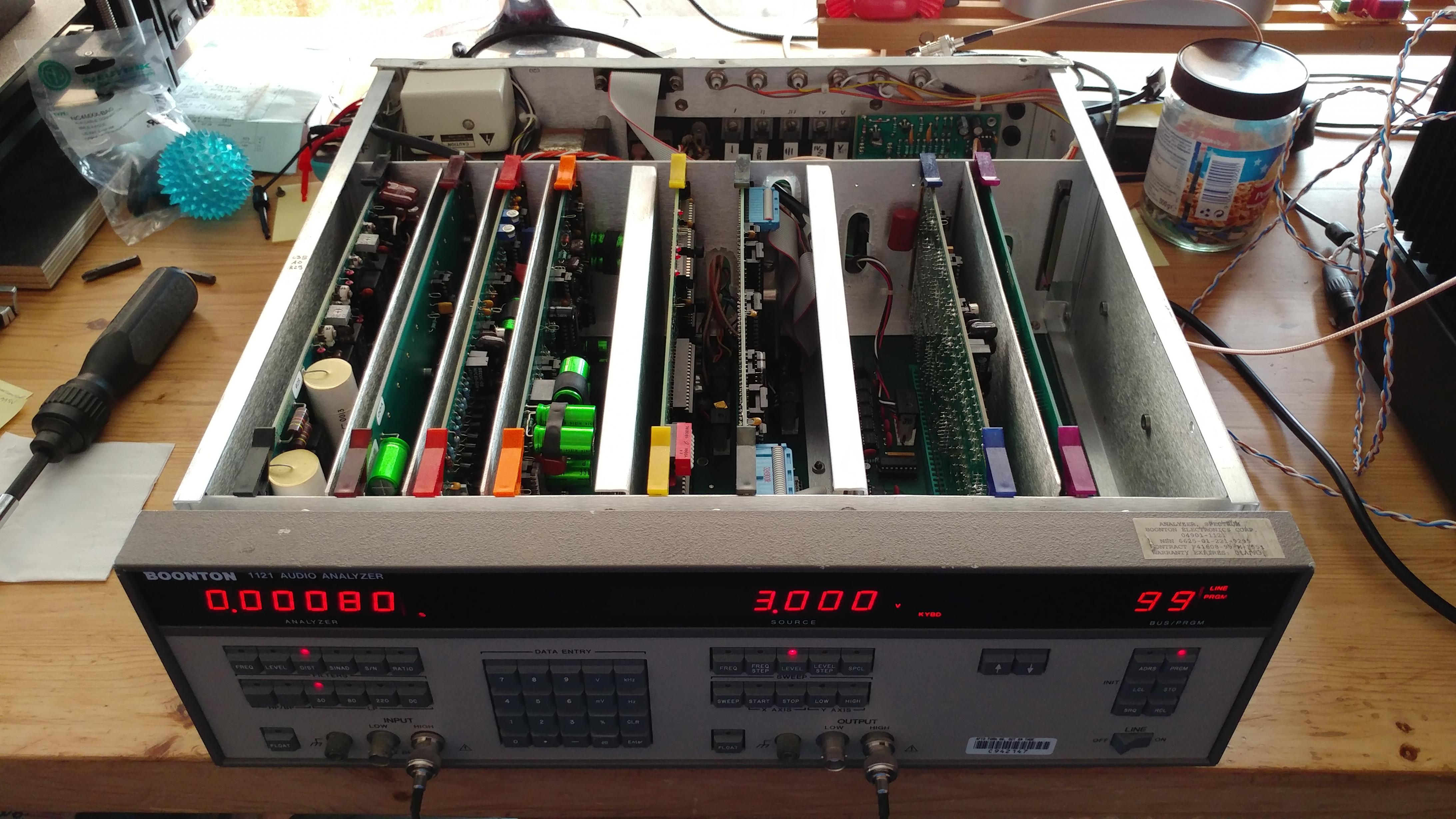

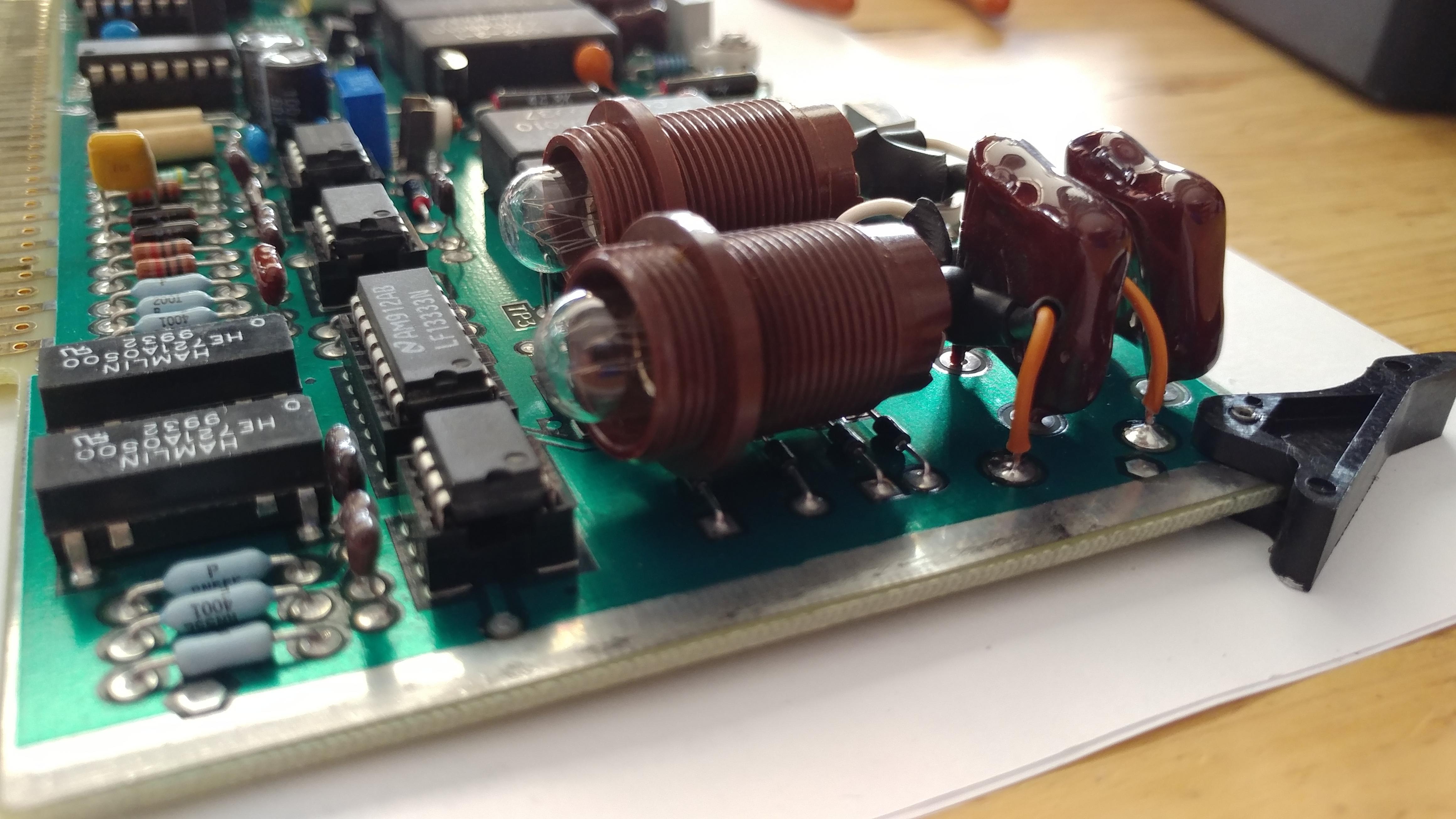

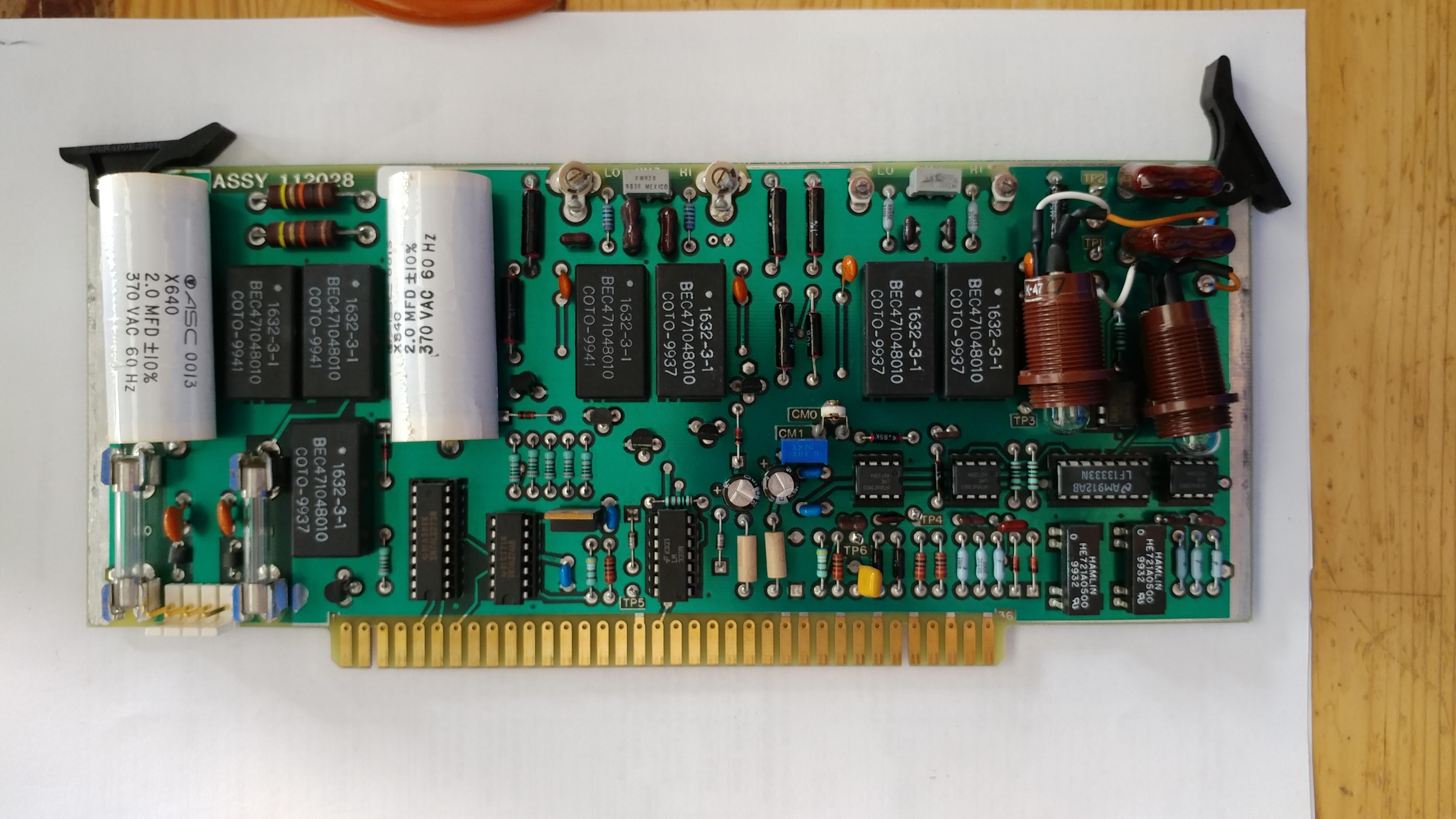

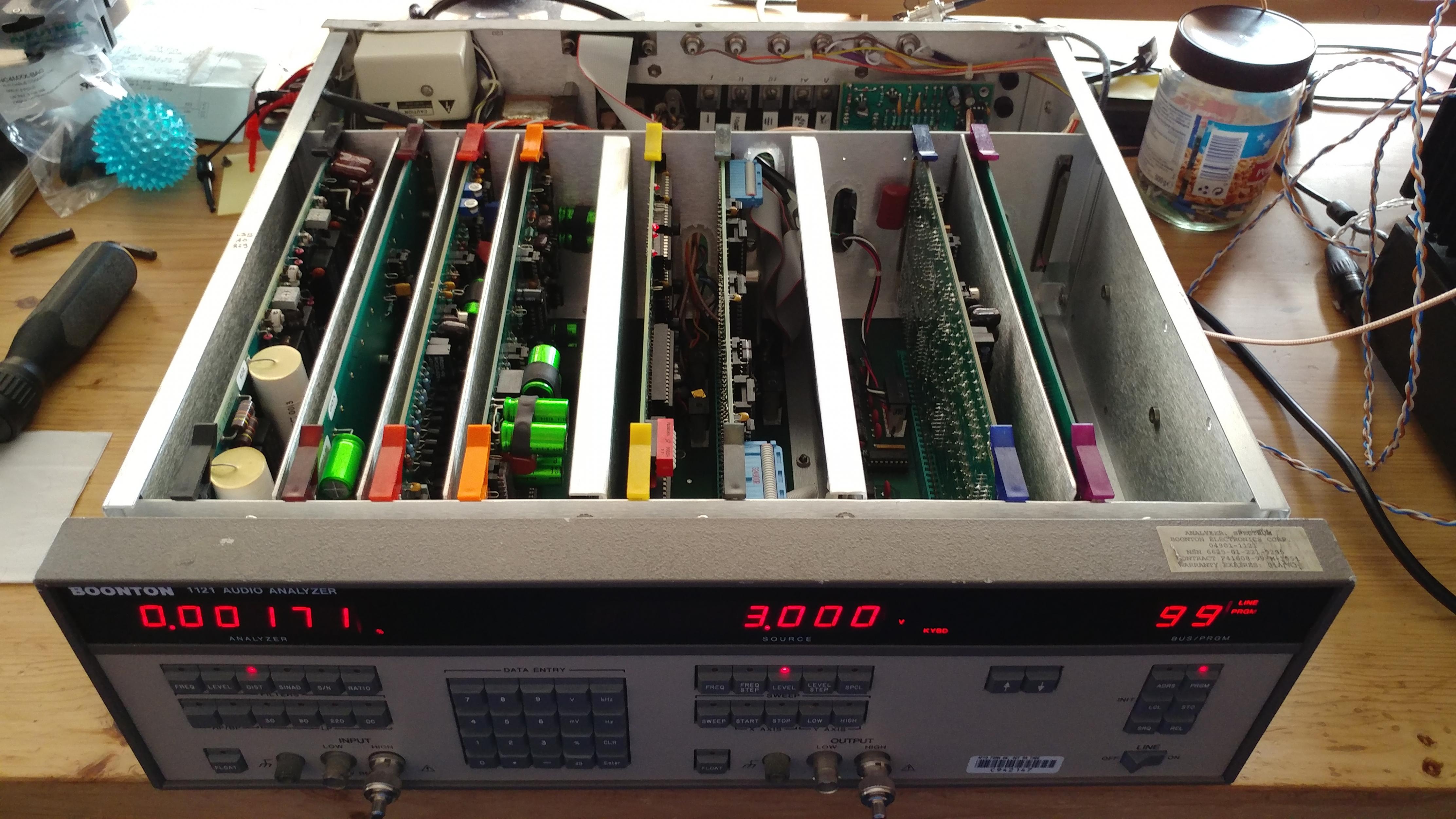

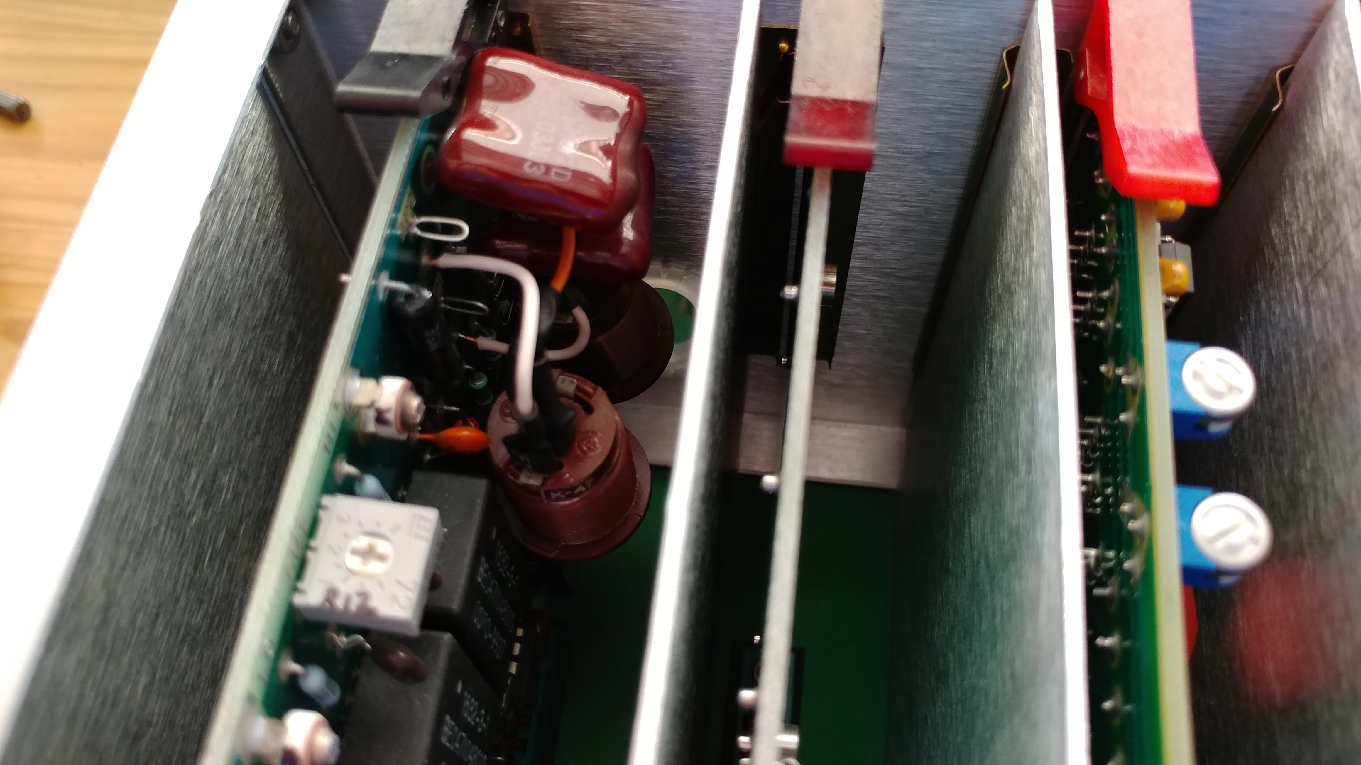

I finally got around to installing lightbulbs instead of R13 and R14 in the input board.
The bulbs were sourced from eBay, they're "Glühlampe E10 23mm 220V 3W" types. The sockets are from eBay too, they're some USSR vintage military Bakelite E10 spring loaded sockets. Wiring is solid copper CAT5e.
I wish I'd taken before and after measurements, but I can provide measurements with and without the 30kHz low-pass filter, maybe someone can fill in the blanks then. With the output high running into the input high via a short BNC cable, I get the following DIST for a 1kHz signal (30kHz vs full BW):
1V 0.001% vs 0.0027%
3V 0.0008% vs 0.0017%
10V 0.001% vs 0.0027%

Good work. What is the cold resistance of those lamps? They are smaller than anything I have found so far.
I seem to have run into a limit at .0006% myself. Look at the spectrum on the monitor output to see what the distortion causes are. The light bulbs will lower the noise. More can be done with resistors in the input network to further lower noise. If interested I'll provide the details.
I use an AD797 in U9 because I got lower distortion from it.

Lower noise would always be welcome. Can you give me a rundown of the resistor mods that you've done?
The bulbs' cold resistance measurers 1.28kOhm
I can provide a link of you're interested.
There's one more mod I have to do, iirc there's an opamp that can be jumpered, gotta read through the thread once more. And I gotta say, the analyzer is such a treat to work with.

The light bulbs are a problem here. The instrument is designed to handle 240V on its input and the lamps need to handle that before the input ranging switches. 240V miniature lamps are quite rare here (120V country) and the sockets are large and clumsy.

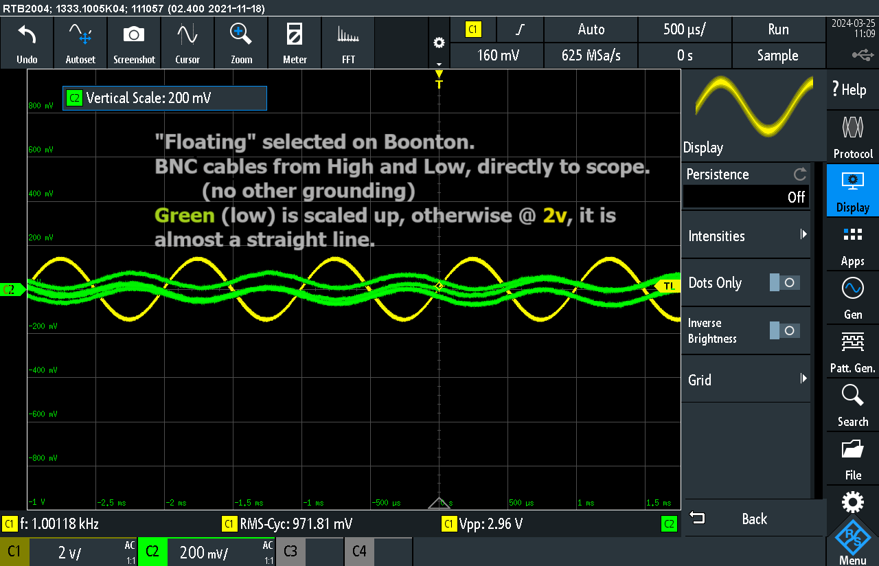

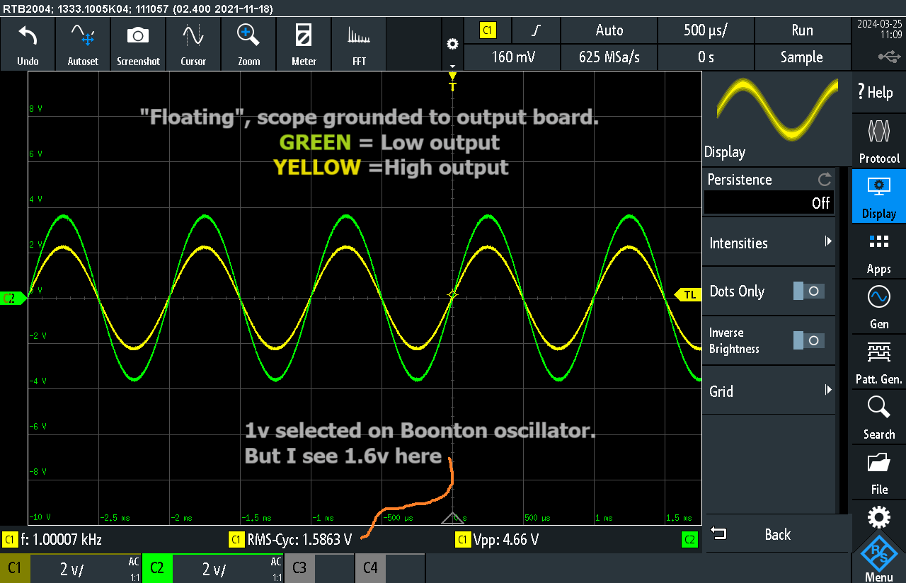

Not trying to hijack. Found this thread trying to revive my 1121. Lots of good info. I also laid out and am currently making extender cards as mine was missing. I will end up with 8 spares I will share once done, and will offer for much less than the ransom I found for the ones on Ebay and elsewhere. Lordy. I have the same oscillator errors as listed earlier so something with the source signal chain. I am using this piece of gear to teach my Tech about troubleshooting because it is so easy to work on and there's little danger of spring probe cataclysmic shorts like on high density SMT designs. I used to use this piece of gear to characterize VLF receivers back in the day. Been gathering dust in my rack for a few decades. Will be glad to have it back in service. Did the replug of the socketed parts to no avail. Time to start probing. And then hopefully modifying!
I just got a Quant Asylum 403 audio analyzer, so I am testing my Boonton 1110 oscillator, which shares nearly the same "Source" board as the 1121a.
Without any tweaks, the Quant tells me -103dB THD, "High" output, float not engaged.
With new electrolytic caps everywhere (except the extra-large psu filter caps), I get -106dB... a -3dB improvement.
But I am not understanding something about the 1110.
In "floating mode", shouldn't I be seeing (on my scope) the "high" and "low" as a sine and cosine of equal value ?
I tried simple BNC cables between instruments, and in one photo below, I connected a seperate ground to a Boonton internal board Ground point.
Reactions: 1 user
Joined 2004
The output is actually "bridge tied" and the whole circuit floats when in single ended. Its sine plus inverted sine. Opamp upgrades help and are simple but the big limitation is the analog multipliers. Finally the FET attenuator is a limitation. Still you should be able to get to -106 dB THD=N in a 30 KHz band. Float the output and tie the ground of the chassis to the QA403. and check where best to tie the low side of the output. You will need to experiment since there will be ground leakage that limits the system noise. A real PITA to pin down and impacted by every connected device.
