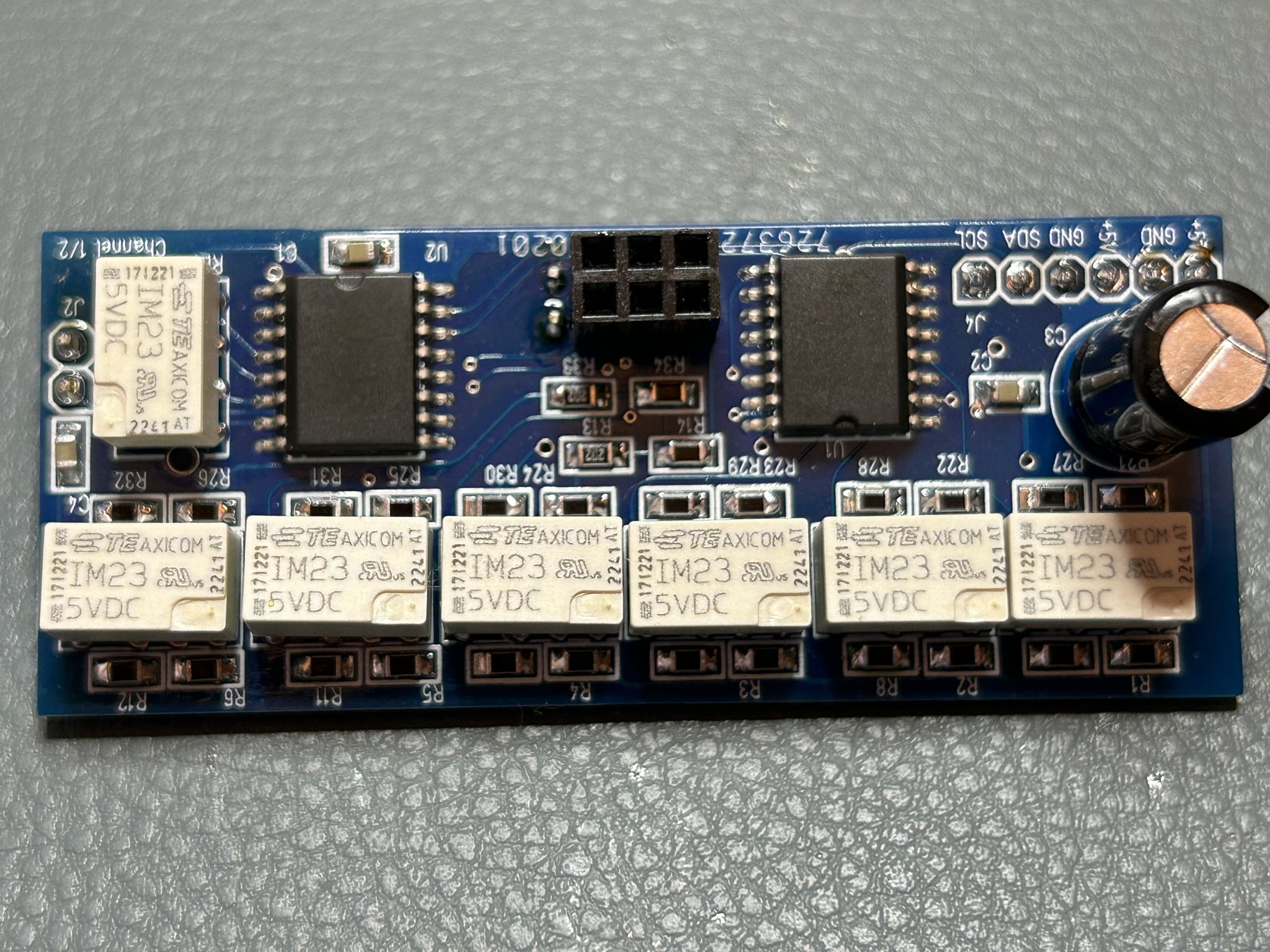

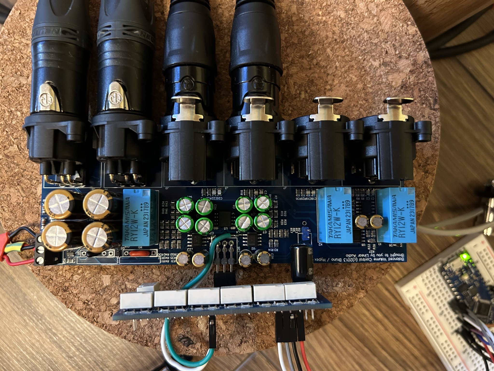

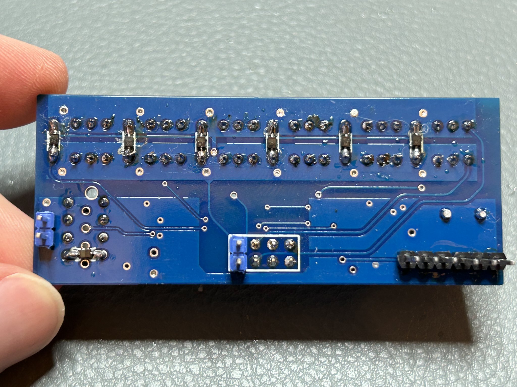

I've finally received the PCB boards for the 64 steps volume control. I've assembled one of them and and installed IM23TS relays from TE Connectivity, Panasonic ERA 0805 thin film resistors, Nexperia BAS316 diodes (same one used for the Bruno Preamp's relays), headers. Managed to program an arduino nano to control the PCF chip and change volume. Connected to the preamp and..surprise, I have issues that I can't figure out.
I'm using an IR remote and sensor to control the attenuation steps. I'm starting at max attenuation (0x3F) and rise towards 0. My arduino code is based off of alexcp's sketch.
Issue #1 - noise. Sounds like groundig noise. I did connect the boards GND1/ 2 to the preamp net tie J4/10 as per Hans' document.
Issue #2 - switching clicks and pops. There are audible clicks when changing attenuation levels. More proeminent (tweeter endangering levels) when I switch from step 32 to 31 and then back to 32. I have tried the 2 step approach as suggested by Hans in post #1086 without luck. It pops even more when I reach step 25 and from there at every step towards 0.
I did a brief measurement at P1 to P6 and it does seem that around step 32 the impedance jumps from 4.xx to 3.9x and then back to 4.xx on the next steps towards 0. This is awfully strange, I would expect impedance to go up and down progressively as I change attenuation.
Issue #3 - there's no music when I feed signal to the input. When the source signl is very low, I can't hear anything. If I start turning the source's volume knob, oh boy robots and crackles start to be heard in the speakers. Like really loud crackles and noises. Did I by any chance connect P1-P6 in a wrong way to the preamp board?
I've attached some pictures and my arudino sketch maybe it helps someone help me a bit here. I'm stuck.
Thanks!
NOTE: I haven't connected anything to earth ground, as the preamp and amplifier ( an Ice power stereo module) are not in a case yet. The issues above do not reproduce when using a normal pot (linear or log).

Issue 2:
The code you uploaded in your last post no longer implements Hans's suggestion from post #1086. Its currently commented out. I suggest it didn't work for you as you have set a delay of 20ms (way too long).

Thanks @geoffw1 that was only a test. I had initially tried with 5ms but still didn't work.
So issues #1 and #3 were because I had connected the board opposite to how it should. Hans had attached a schematic in post #427 but I missed it. Having the connections done properly, it works well. So I get the prize for lack of attention and stupid :headbash:
Issue #2 still persists.
I have reinstated the code as suggested, using the 5ms delay. Turning all relays to 0, which ix 0x00 (right?) creates a more than distrubing click in the speakers.
If I turn them to 1, though, the clicks are less audible but they get louter as I progress towards 0 attenuation.

Well done on sorting issues 1 and 3 out! As far as the remaining issue 2, it may well be worth persisting with Hans's procedure but try it with various values for the delay. Its probably simply a case of tuning the routine to suit the relays you have.
