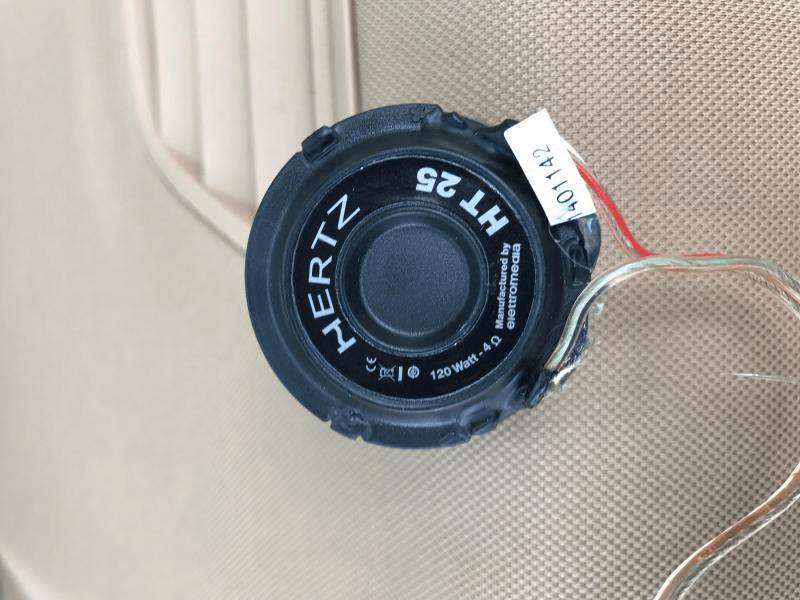

The current situation that I am trying to improve is a cheap OEM car tweeter in a 2006 car with a single capacitor of unknown type. I have a Hertz HT25 tweeter, of which I do not have specifications. I have a multimeter. Besides that I can of course always e-mail Hertz and hope they will give me some data.
So personally I think that my original plan, given the current situatuin and perhaps with different values for the components as suggested, will still give me better sound. But the more data I can measure or receive the better I can design a crossover that fits my situation. I understand why I came with different values than Galu, I now noticed the calculator was configured to calculated the crossover frequencuy as f6, not f3. Chaning to f3 gives me the same values (http://mh-audio.nl/Calculators/CBBC.html).

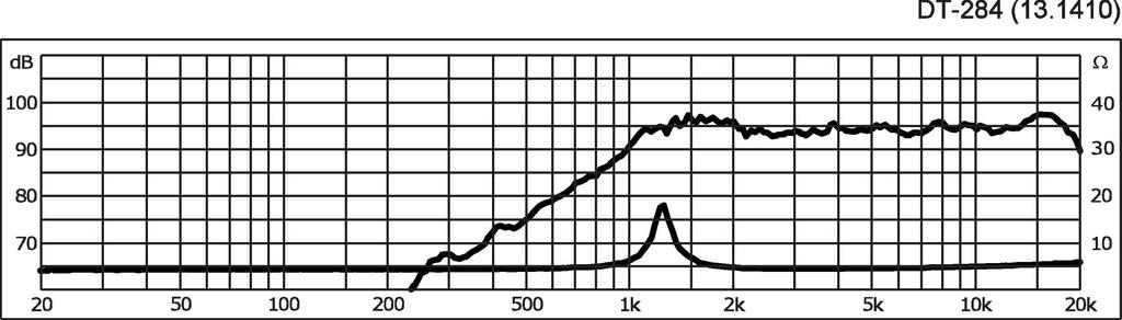

As for a "guestimate", you could look at the 4 ohm tweeter impedance curves that are published by the major manufacturers.
This may help reassure you:
The impedance curve (bottom trace) for a Monacor DT-284 dome tweeter (intended for car Hi-Fi applications) shows that its impedance departs little from its nominal impedance of 4 ohm at frequencies above its resonant frequency of 1,300 Hz.
https://www.monacor.com/products/pa...y-and-speaker-building/hi-fi-tweeters/dt-284/
