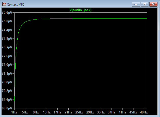

I am trying to buildt a custom contact mic using https://www.richardmudhar.com/piezo-contact-microphone-hi-z-amplifier-low-noise-version/ (circuit picture below)
I want to record frequencies in range if 5-20 Hz. I simulated the circuit in ltspice and found better frequency response at the lower frequencies by replacing C1 by 100uF capacitor.
Frequency response:
I am looking for comments and suggestions for this change also can anyone suggest a suitable amplification circuit for amplifying mainly the lower frequencies (after the pre amplification).
My objective is to convert the microphone output into digital signal and process it further

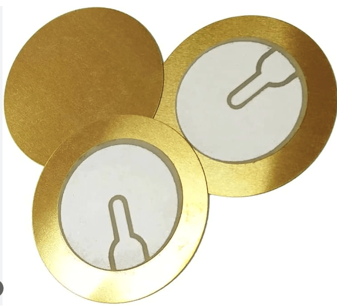

A useful comment might be that there's no way the piezo element is going to output much in 5 - 20 Hz. They use those as tweeters; ever see a piezo based woofer? Did you see the frequencies the fellow on that website was describing? I thought I saw kHz...
A mechanics steth, you could connect the hose to an ordinary, abundant electret mic which would have a far better chance of making signal at those frequencies. The compliance of the steth membrane would be more dominant; if it's not floppy, how's it going to move at 5? I'm pretty sure the hose length wouldnt be much of a factor at 20.

Piezo elements convert strain into charge movement (and vice versa), so you need to convert the sound to strain of the element efficiently at the frequencies of interest, which is a problem in acoustics. Piezo elements work down close to DC as witnessed by piezo gas lighters where a large DC strain generates many kV leading to a spark.
I see. It is true that the piezeo element outputs very less signal. I will investigate further how woofers are made/designed. Although my objective is not to output but rather to input from a contact piezoeeletric microphone.A useful comment might be that there's no way the piezo element is going to output much in 5 - 20 Hz. They use those as tweeters; ever see a piezo based woofer? Did you see the frequencies the fellow on that website was describing? I thought I saw kHz...

yes it certainly improved the frequency response.C1 can certainly be larger, 220uF for instance, to avoid attenuating 5Hz appreciably. Adding a low-pass filter with cutoff around 50Hz might help reduce noise.
notedC4 is good for loads of 10k or greater as it stands. Adding a 100nF ceramic cap to the opamp's decoupling might be wise to ensure no high frequency shenanigans.
I see but the open loop frequency response of the FET OPAMP starts from higher frequencies such as 1Khz. I want to be able to use the op amp at frequencies as low as 5 Hz. I am a beginner so let me know if i am making a mistake.You may want to investigate FET opamp amplifiers. With a piezo source, you are forced to use large resistance in your design and so you need amps with low current noise.
