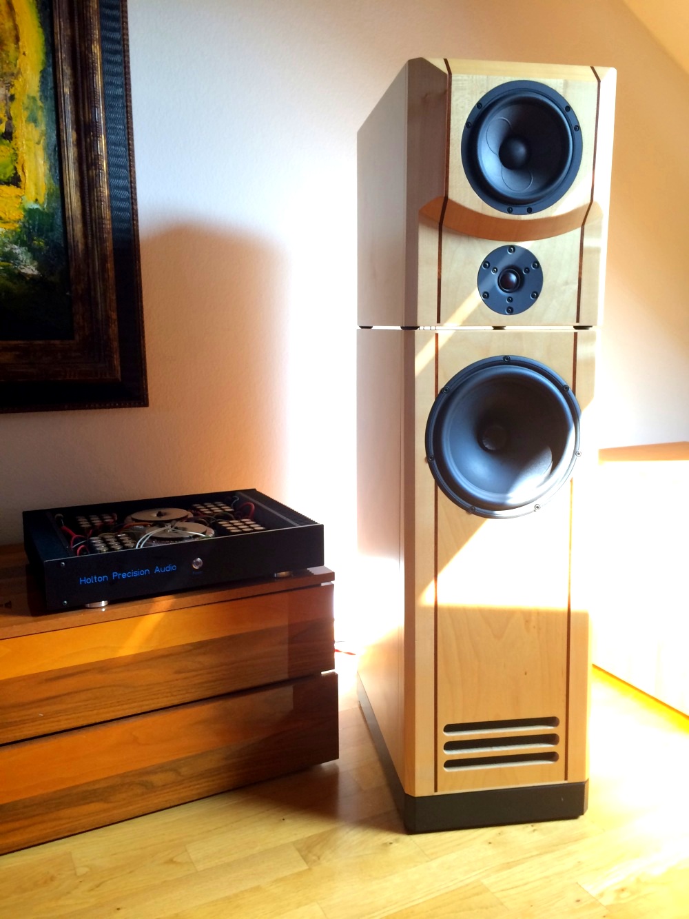

Not really... Not all recordings are equally good so after listening to a couple of bad recordings I suffer from listening fatigue. But I think I would suffer from that even with the highest high end amp. for the good recordings: I think I would stop listening to my previous amps sooner than with the NXV500. Sound has no sharp edges which I consider very, very pleasant. I even turned op the volume of the tweeter from my Troels Gravesen Jenzen Next on step up. It's a small difference but the NXV500 can handle it without getting "sharp".
When I sum up the differences from my previous amp the list would be:
Warm but not too warm
Better soundstage
Bottom power for bass is very good without exaggeration
Balanced very good between al frequencies (bass, mid, highs well balanced)
As far as I can remember I like this amp better than my Pass Aleph 5 which I built many years ago.
Better soundstage

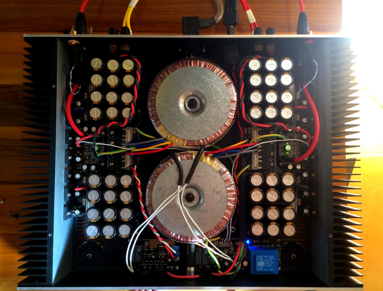

Well, I've been listening to the NXV500 r2 for some time now. The last stereo power-amp I had was a 100W Rotel. That was ages ago. Since I started building my own amps I only made mono amps. The NXV500 is the first stereo amp in at least 20 years. Now I know why I always wanted mono amps. Our cats never liked to sit on a mono amp. Our 11 year old cat we have now didn't like mono amps either. She likes stereo amps however to sit on. I don't like that. It seems the cat and I disagree about this. She has claws but I'm bigger. hope I can win this fight. Must remember she is female and also fights like a female...
Anyway. I had a small disappointment when I fired up the NXV500 after the transformer debacle. The DC protection on the UCD700 power supply did mot function as it should cutting off the power instantly after turning the powerswitch. As there was no DC on the speaker output I disconnected the DC protection and contacted Hypex what was wrong. There was nothing wrong. Hypex sells it's linear power supplies for the UCD 180 and UCD 400 with a normal working DC protection. When I bought the UCD700 power supplies I assumed they had a DC protection similar like the smaller ones. I was wrong. Only half the DC protection is on the UCD700 power supply. The rest is on the UCD700 module itself. Luckily I got some help and got the scheme to complete the DC protection. So now I have a working DC protection. Guess what... now I'm really happy
