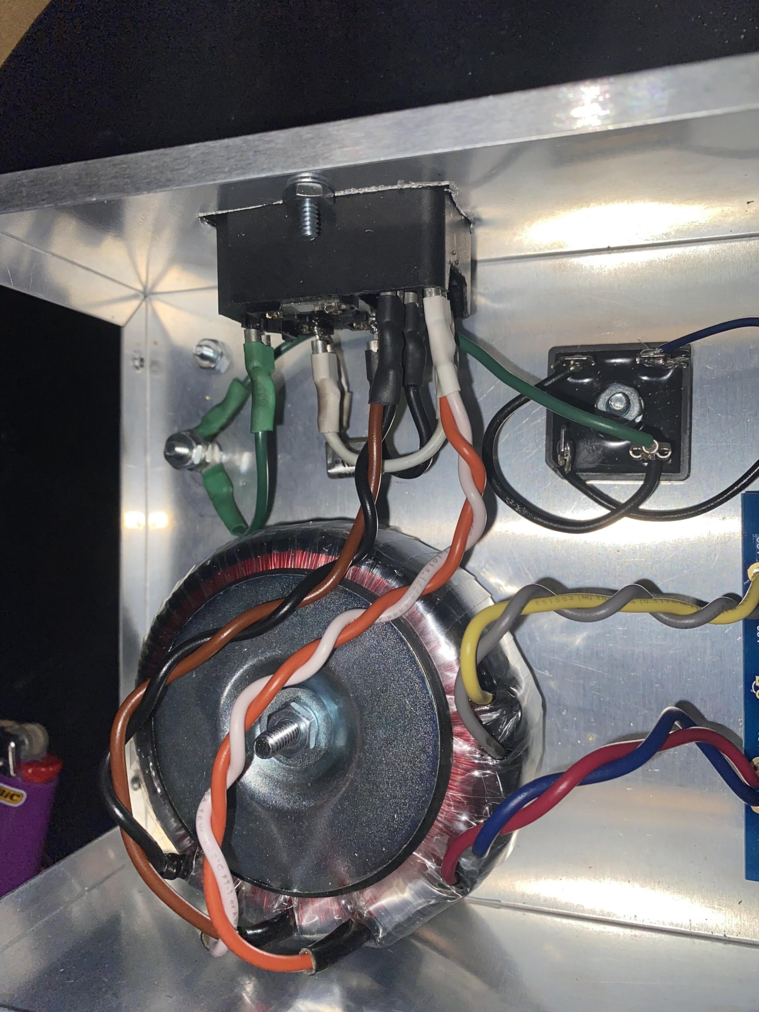

Building a Pearl 2
Better?
Just wondering...
Ben, I agree with you that the wiring to ground needed to change. But it seems to me that the ideal point of connection should have the fewest joints en-route to the safety of ground. In other words in this case where an IEC socket is employed I'd have wanted to make the connection there. I do see that this socket doesn't really have the facility... but maybe it should.
Electrical panelboards have a bus bar with lots of connection points so that connections and wires are not shared. There are rules about not running two wires into a breaker too.
I'm in the process of renovating an old power supply (for my 1980 Leach preamp) and one of the changes I'm considering is changing the power cord to three-wire. The end of that green wire is the bull's eye target -- safety-grounding wise -- to which the chassis ought be connected but also the signal (I've got a bridge too). Maybe there's a short ground bus bar that will realize this ideal. Or is that "notion"?
Thoughts?
Joined 2012
I don't think manufacturers of EIC sockets would want to take responsibility of ensuring an effective and reliable direct connection of their socket earth ground to chassis ground.
For diyers, I think that the simplest and best chassis ground point is implemented with a long screw or bolt that is fastened to the chassis with star washers and nuts, and the earth ground wire from the IEC socket terminated with a ring terminal that is fastened to the screw with a star washer and nut. The other ground wires then go on top of that.
With the earth ground wire at the bottom of the stack, it cannot be removed unless the other wires are removed.
Another safety consideration is that all metal conductive panels of a chassis need to be electrically connected. Many if not most anodized chassis and their heat sinks are put together with anodized screws, with a questionable electrical connectivity between all parts. Chassis panels and heat sinks should be checked for electrical connection to chassis safety ground. Parts may need sanding to ensure that every part of the chassis is able to conduct electricity to chassis safety ground.
Reactions: 1 user
Just to provide a little context. My experience with "nuts on nuts"... especially with lock washers has been that attempts to remove just the top one often results in disturbing the bottom one. "All Thumbs Are Us".
Everything's fine so long as you don't mess with it once it's attached (although my preference would be to reduce contacts.... especially serial ones).
I still like the idea of a ground buss (sp?).
