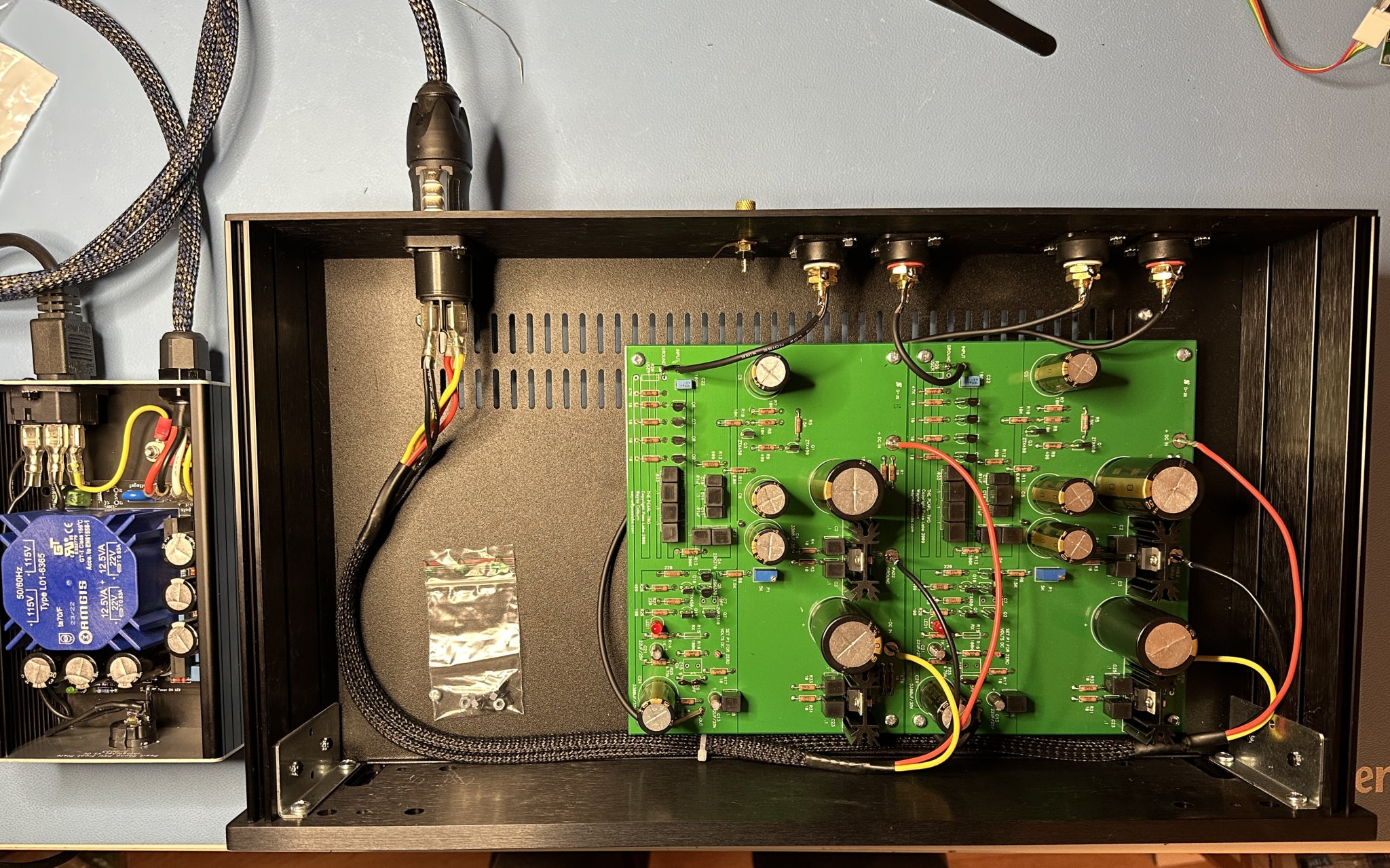

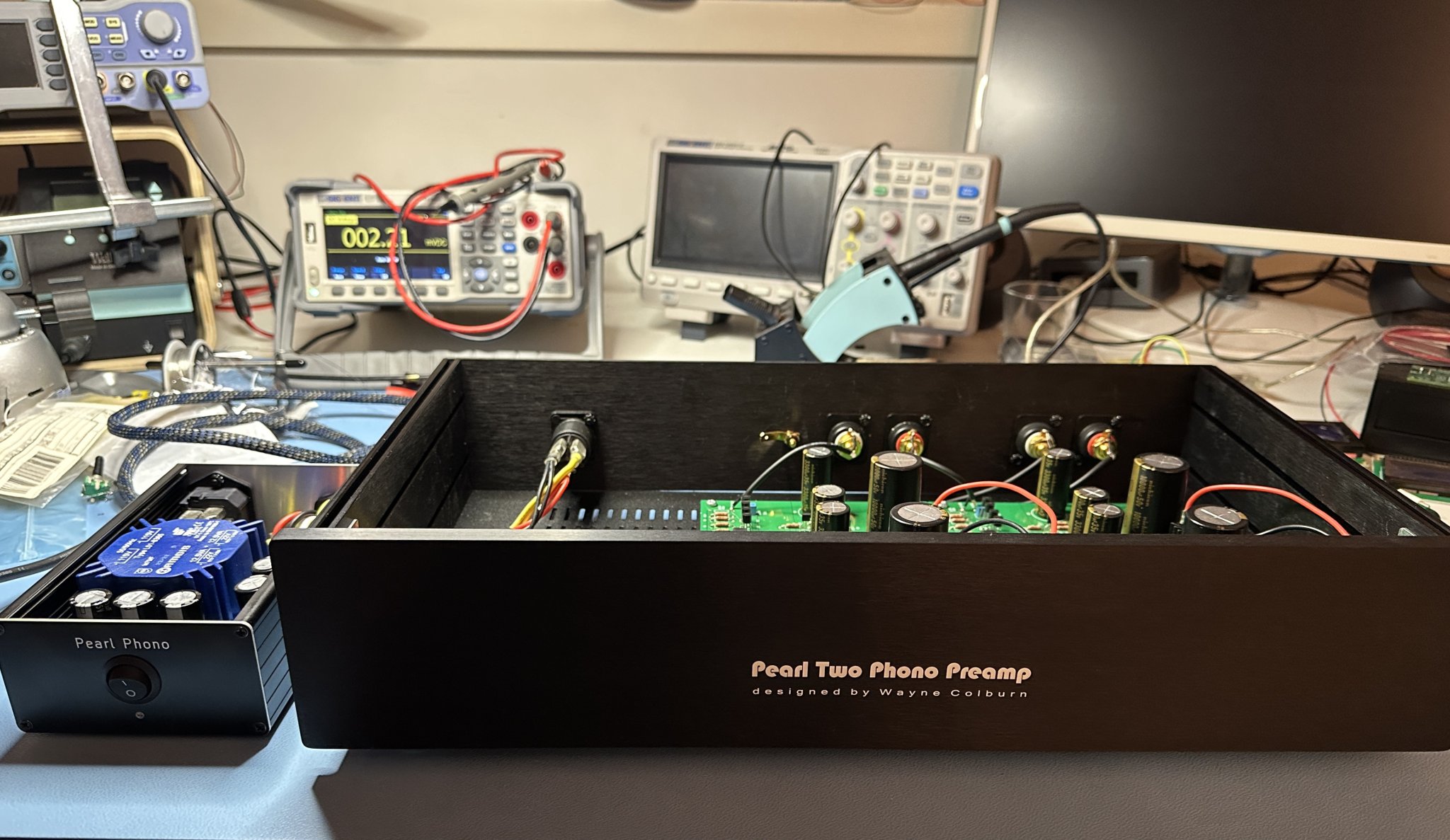

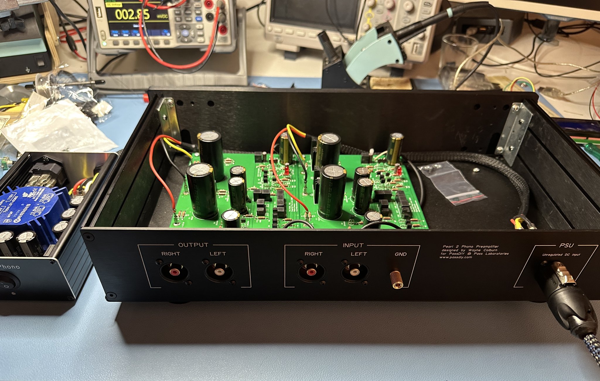

I know I'm late to the party now that everybody talking of P3, but I'm a proud owner of a P2 since about three month.
It's very silent (powered with @rhthatcher external power supply) and sound amazing
Some picture took before final assembly

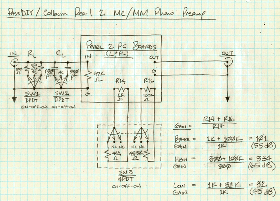

Hi, Anyone up for helping me out to determine some resistor values for different gain/feedback settings?
I have a pearl 2 I put together a while ago with fixed gain around 40db IIRC for MM use, eventually I'm going to try out some MC carts so I want to up the gain a little and while I'm at it, make it adjustable. I have got some really small SPDT switches that fits nicely on the pcb so that it is possible to have two different values for R14-16.
Now my problem is this: I can not get my head around what the value on those resistors should be, ideally and if possible I want 5 db or so steps from say 30-35 to 65db, so thinking of maybe make R15-16 into 4 steps with 5db apart and use R14 as a hi/lo setting.
I have been searching this thread, and indeed find some relevant posts, but I'm still struggling to figure out what the values should be to make it as "adjustable as possible" in my case.
Thanks, but I really want to try out the spdt switches as they would make possible a very neat way to switch between two values in each spot without running any wire or longer leads, only compromise being a few more switched connections in the feedback loop, but with high quality spdt switches I think this should be OK.
I will for once provide pictures when done if it turns out as I hope as it dosent seems to meny people have opted for this solution and I think some might find it a good way to add some easy enough flexibility for gain settings without running feedback path "too far" off board

I forget which post I got this from. It's somewhere earlier in this thread.
This is how I built my P2 with a 3 way toggle switch.
Here are other notes from my build on my PC. Maybe helpful for you.
Notes/Modifications
  • Added Cap between R14 & ground
  • RIAA EQ Optimization: R12 to 990 and C20 to 0.22 – See DIYAudio Pearl 2 Thread Post #1340
  • C7 & C15: Empty
  • R15: Jumper
Reactions: 1 user
Nice thanks! Exactly what I needed, think I can do calculations on my own with that info :)
I will check out those other mods you mention as well, although some might already be implemented the first time around, think I have to start taking some notes on these things, like you did 🤔
