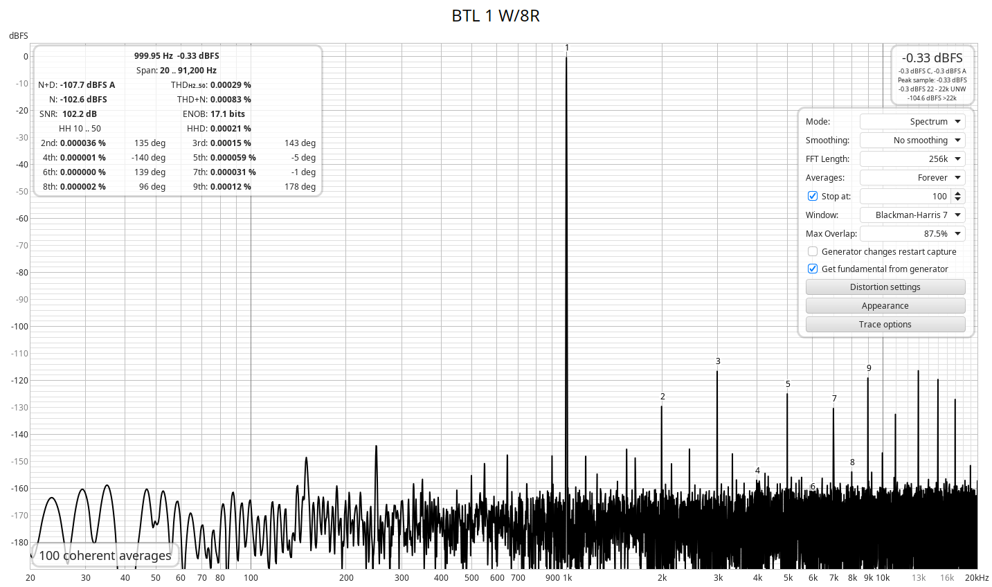

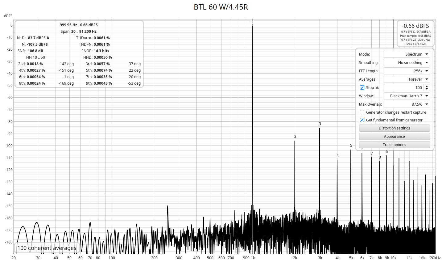

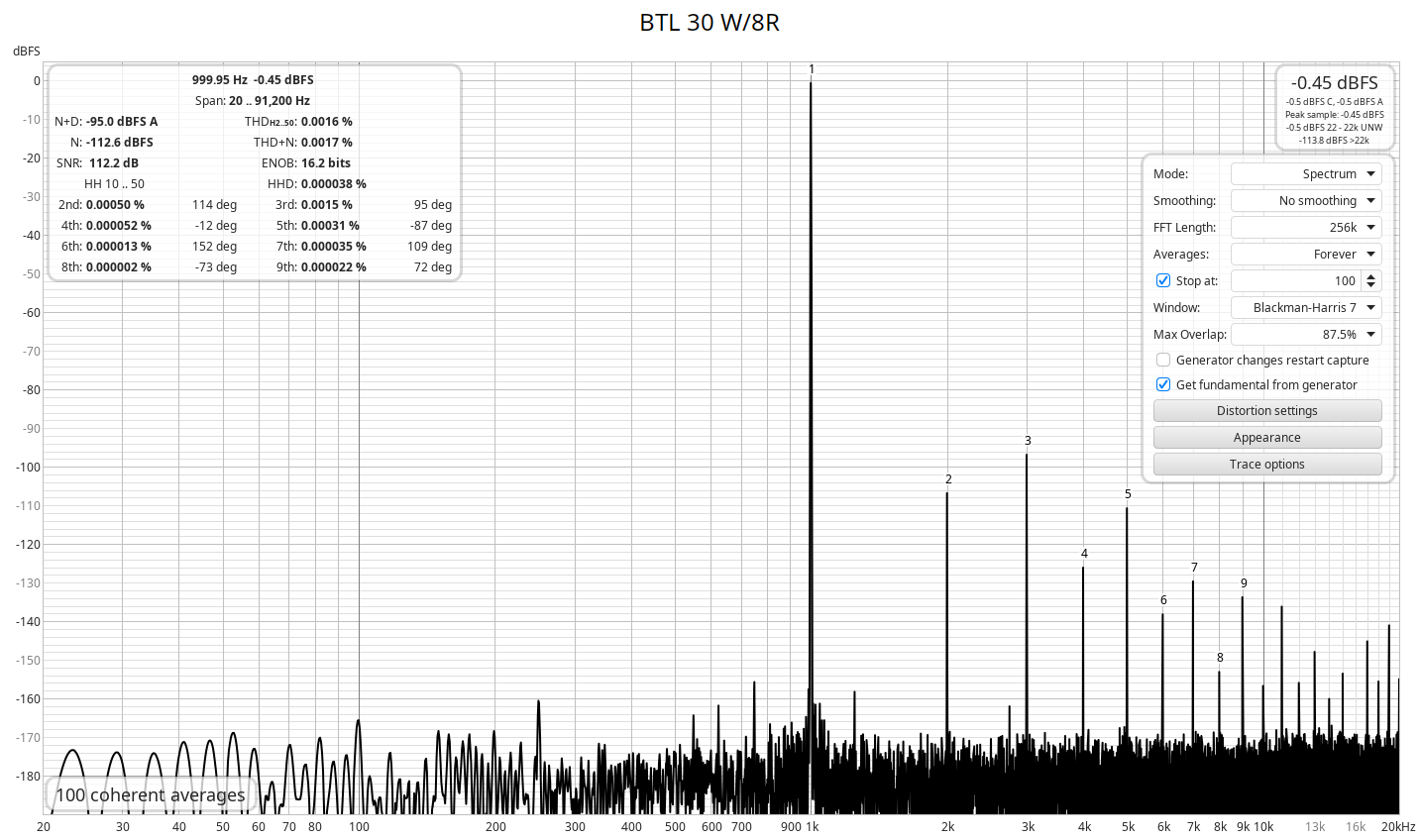

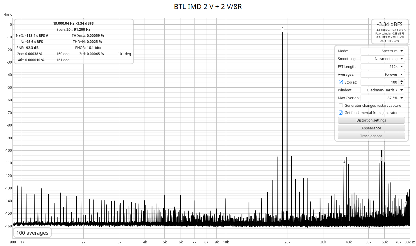

Joined 2019
Bridged (BTL) operation should be no problem. Output MOSFETs are adequate for much higher output power. As is, bias is adjustable from 0.7 to 1.4 A, with 1 A being recommended value. Amplifier maintains the same harmonics distortion profile even in the class AB operation.
Max. output power should be 30 W/8Ω and 60 W/4Ω.
What happens to the harmonics profile in real life is hard to say. Usually, some H2 cancellation is expected. But, it shouldn’t matter at all as distortion is extremely low.
For bridged operation, output zobel values of 100 nF/10 Ω are a better choice.
Joined 2019
Well, not hard at all as it is easy to drive stereo amplifier as a bridged monoblock. :)
Here are distortion measurements for 1 W, 30 W, 60 W and IMD distortion, with the same conditions as at post #149. As expected, there is an overall distortion rise and H2 level drop. Measurement at 1W contains signal source distortion close to 0.0001 %. For this I had to use DAC as a signal source.
