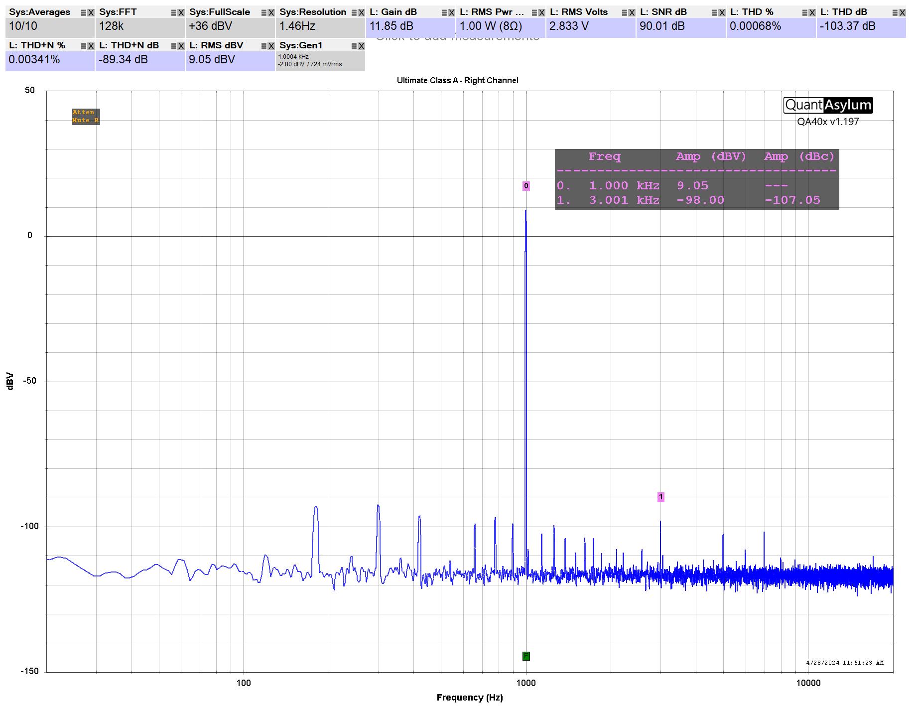

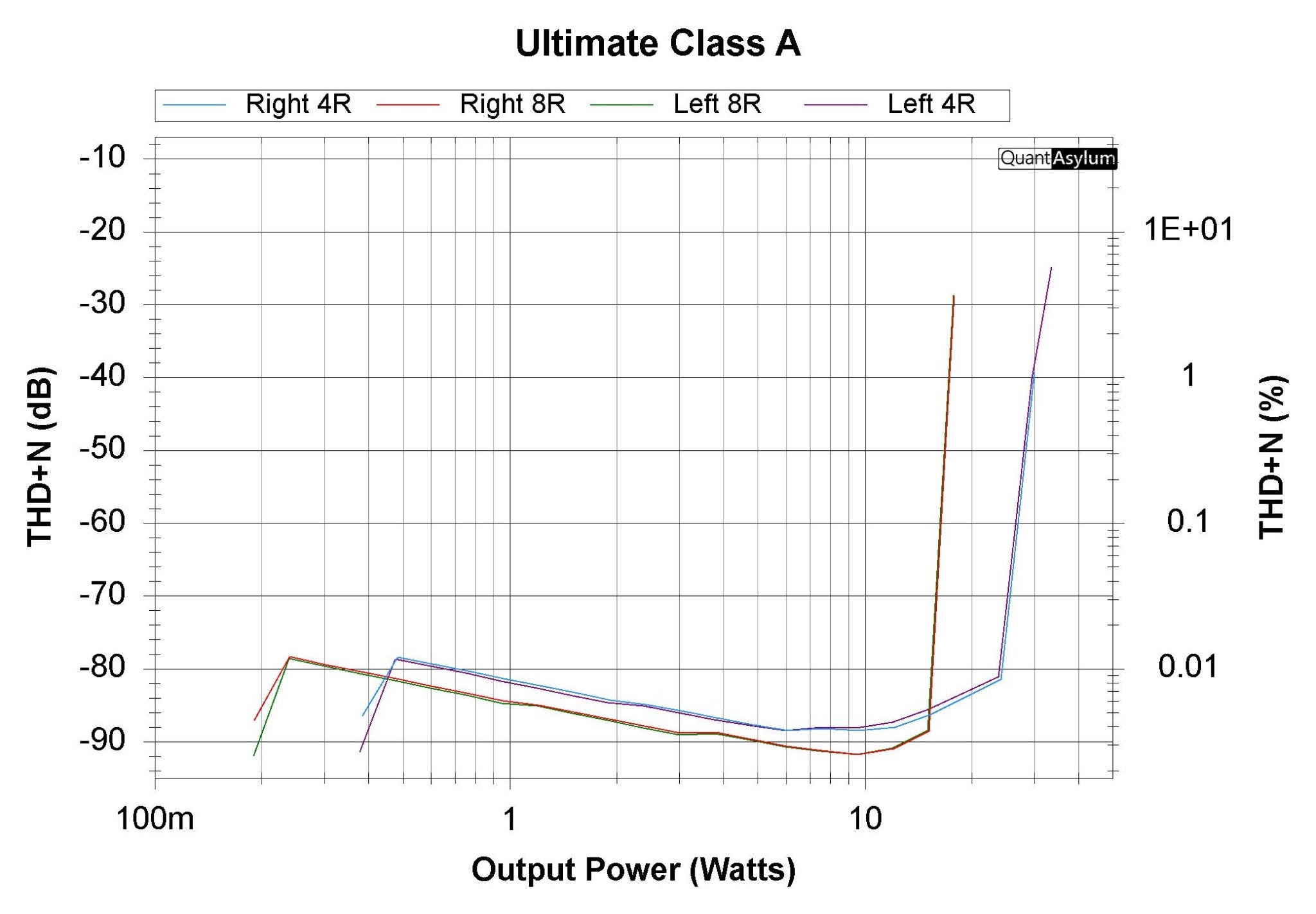

I had some time free up. I was listening to the amp in the background most of morning. I also did some quick and dirty measurements. I am still learning how to measure properly, and this was far from ideal. Mainly, I wanted to make sure that it was at the very least built without any major flaw that would show up in measurements, but not through listening.
tl;dr - it all seems just fine to me on both accounts.
Quick Power vs. THD - Both channels behave identically and to expectations for all practical purposes.

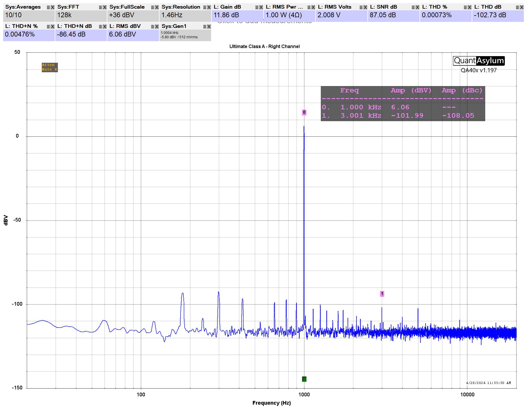

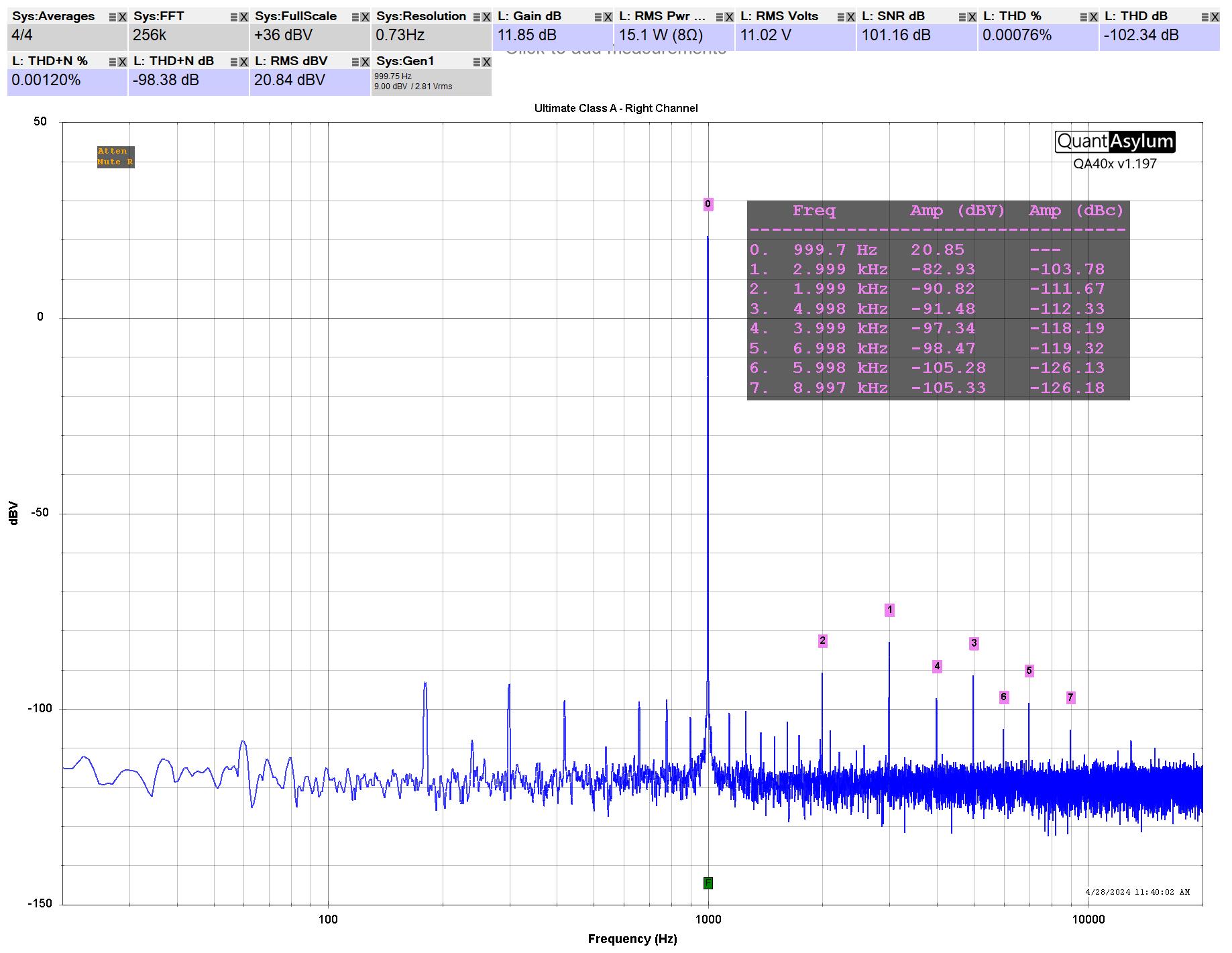

Representative channel at 1W 4R and 1W 8R - channels behave the same for all practical purposes.
PSU is clean enough. It's not to the extremes of my "wretched excess" external PSU, but it's quite good and about 1/10th the weight... and it's in the same chassis.

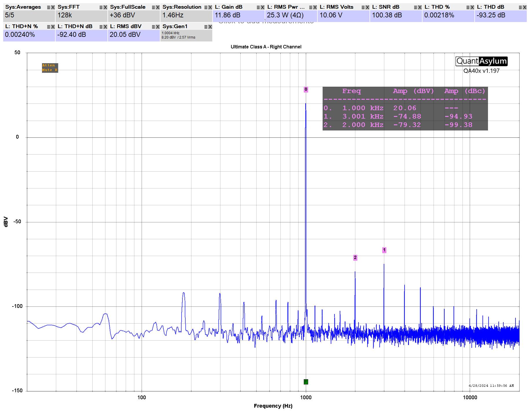

15W 8R and 25W 4R - Practical / Rounded power output limits.

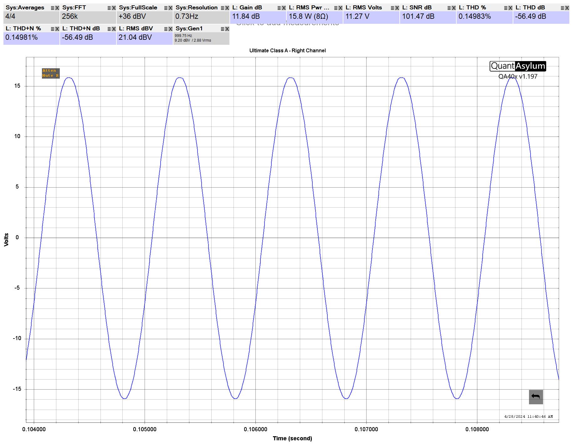

Clipping behavior into 8R - Nice and even. I could have sworn I did 4R also... but I may have forgotten to save the graph.

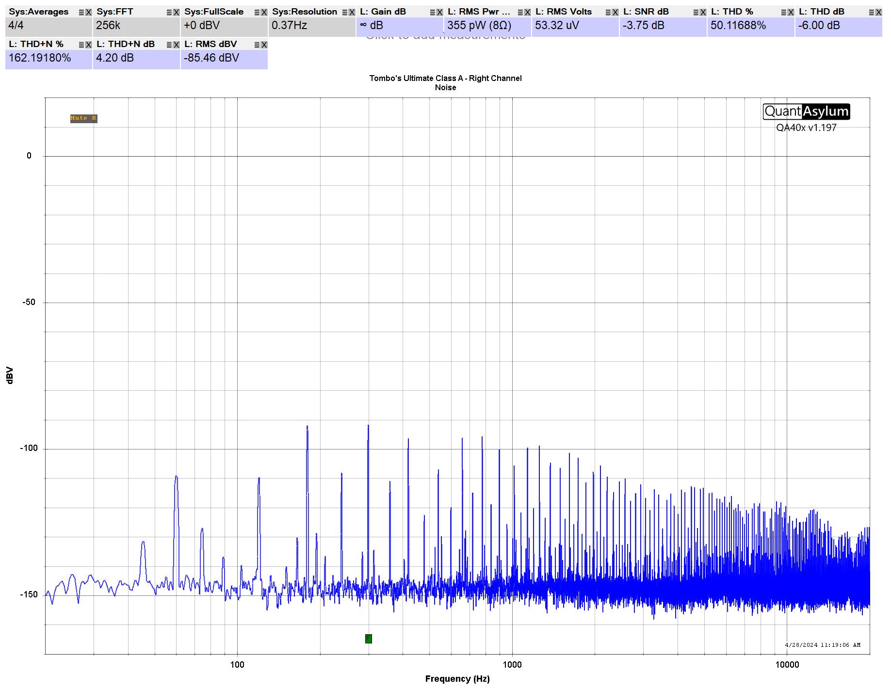

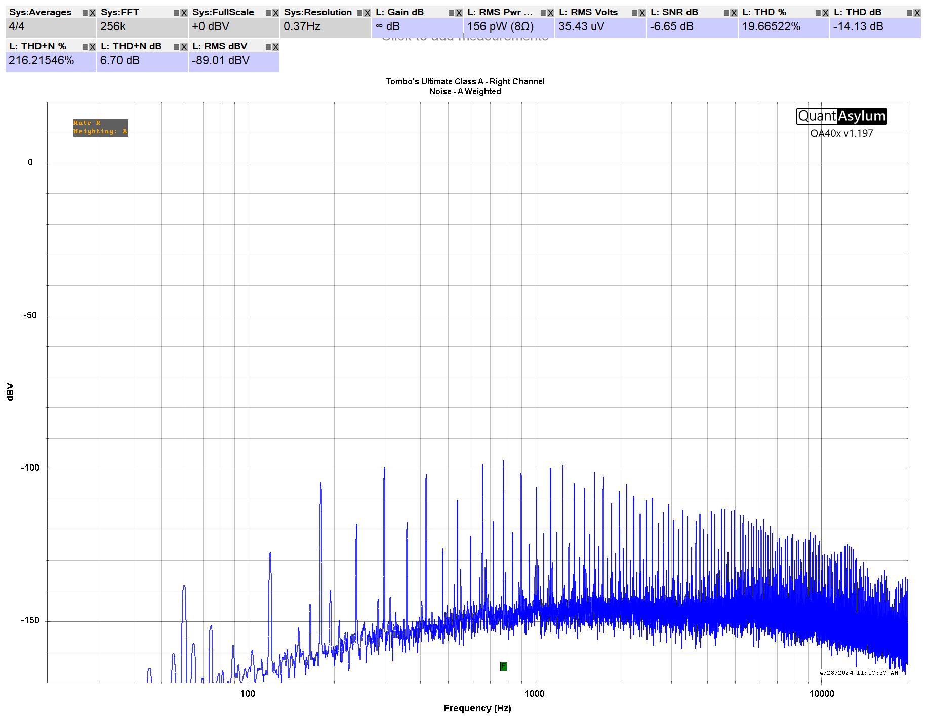

Noise and A-weighted noise. Looks a mess, but it's all below ~95dBV. What really matters is that it's dead quiet...

All looks perfectly well. As expected, QuantAsylum own distortion prevents proper amplifier distortion measurement. Still, results are very useful and confirm successful build.
For noise measurement, did you put short circuit on inputs?. Otherwise, you are measuring noise generated by 47 K resistor at input + some EMI.

^ Definitely. There are some tips and tricks for lowering the amount of distortion added by the measurement system, but I generally don't go to extremes.

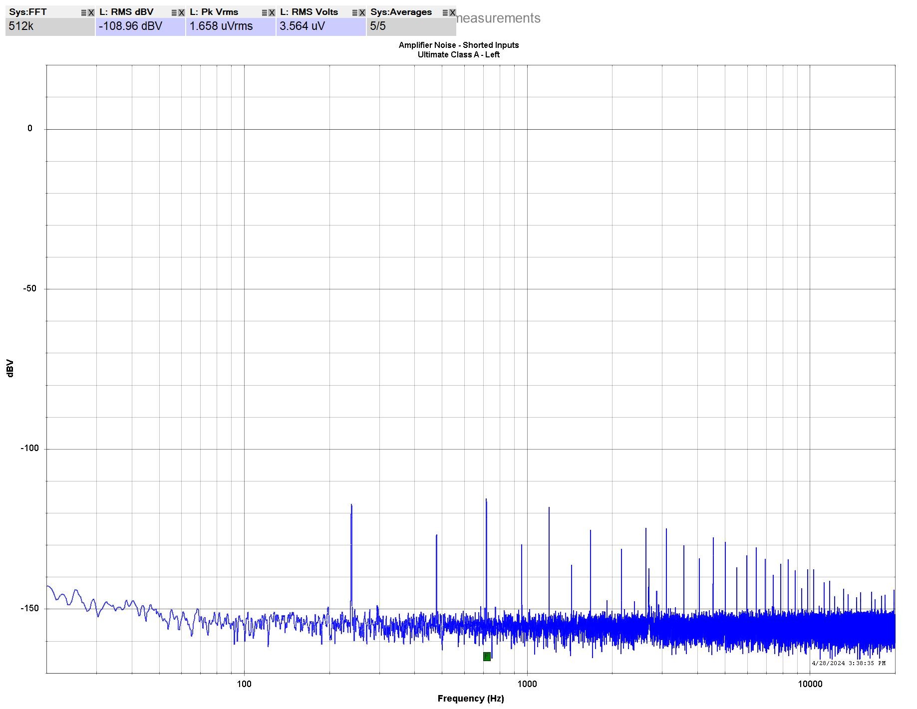

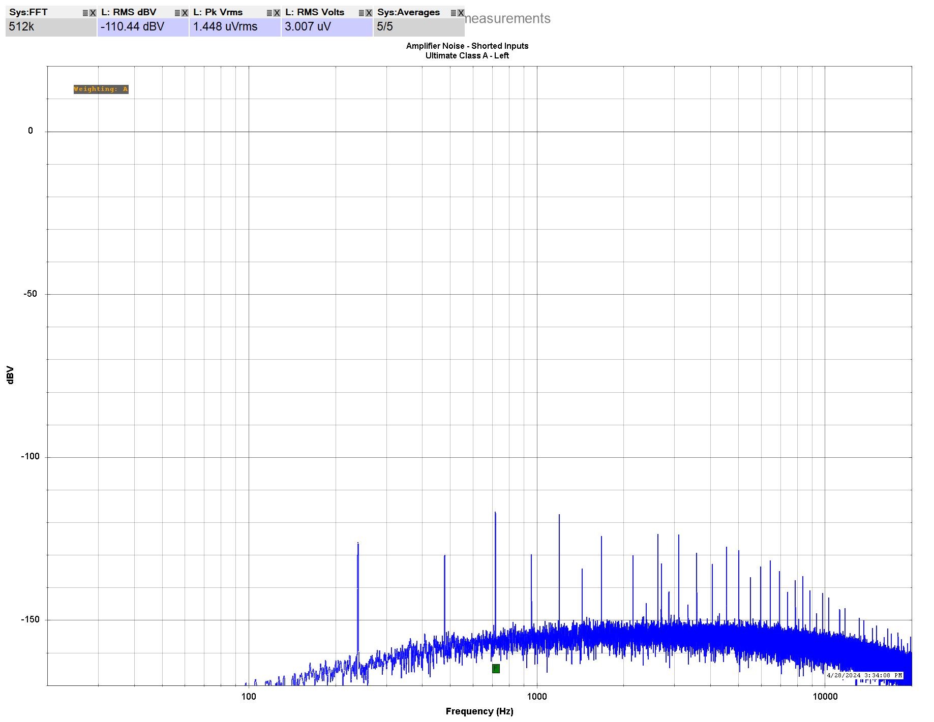

I've never tried shorting the inputs for the noise measurements. Wonderful suggestion!
Here's a before and after... That's now part of my process. Very interesting. Also, for full transparency, the amplifier was measured sitting in the rack with all sorts of other nonsense spewing nasty EMI toward it, so no doubt I'm also measuring things not associated directly with the amplifier, but it's measured in it's "natural environment.

Right Channel Noise A Weighted.jpg Right Channel Noise Shorted Inputs A Weighted.jpg
Shorting inputs is a standard procedure for noise measurements. Otherwise, high input impedance allows for EMI incursion. While measuring single uV levels and below, there is always something “in the air” around.
Your noise measurement is now close to mine(post #4) with noise peaks at 1.6 uV. It is nice to observe nothing at 120 Hz. Confirms PSRR performance of both amplifier and voltage regulators. :)
Distortion measurements for high power are spot on, but at 1W, measured distortion is actually from QuantAsylum. In example, measured distortion for 1W and 15W into 8Ω are almost the same: 0.00068% and 0.00076%. Result for 1W is not right.
I’ve used measurement equipment with own total distortion at 0.000001% level.

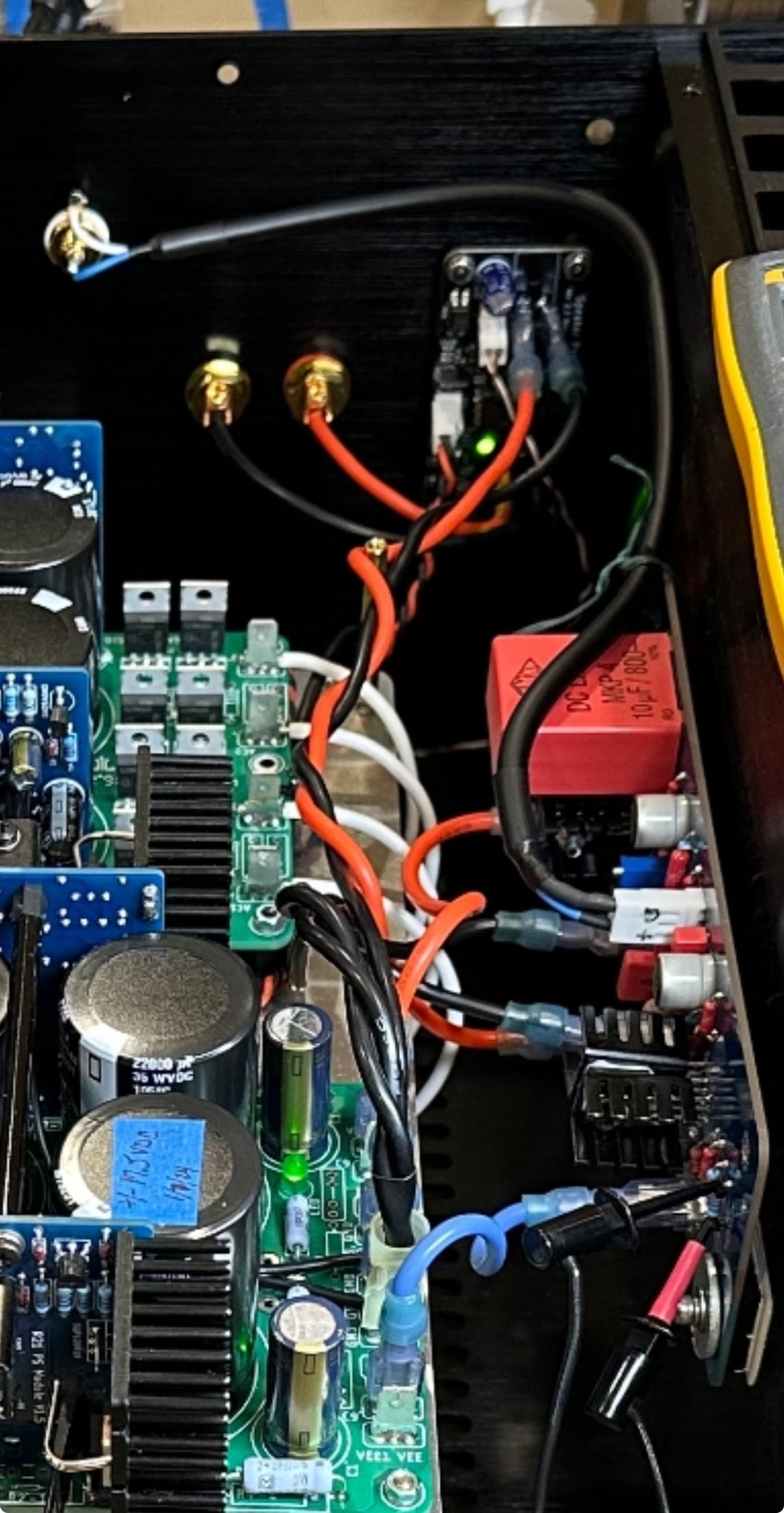

When I started to use SSR DC speaker protection boards I was skeptical also, I listened with and without in the first couple of amplifiers I used them in. I couldn’t tell any difference. Since then, the SSR protection boards are installed in every amp I build, besides single power rail cap coupled amps.
