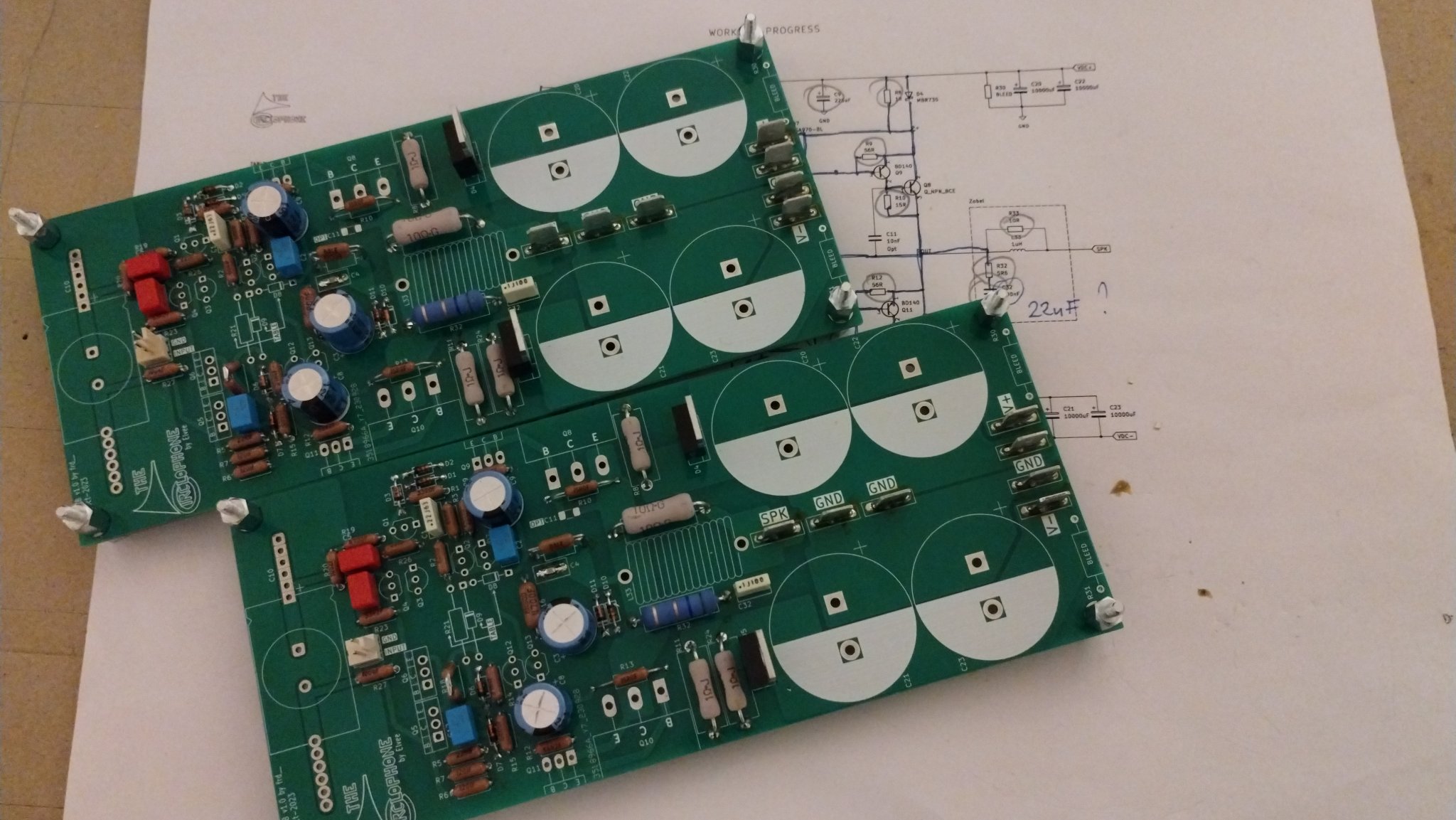

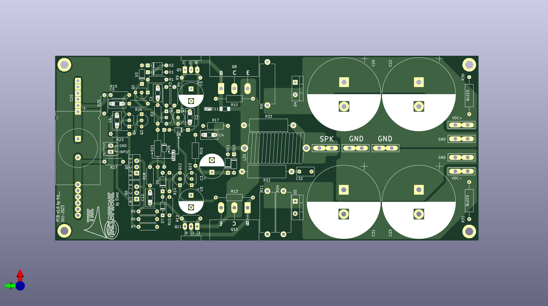

I also have been working on the PCB for the amp, and I think I am close to have it finished.
For a 8 ohm load, the 2SD1047 is OK.
The 2SC5171 should be OK, but marginally: it is too beefy and as a consequence has a largish B-C capacitance; same remark for the 2SC3902.
The 2SA1507 is OK as driver.
Best of luck with your build!
