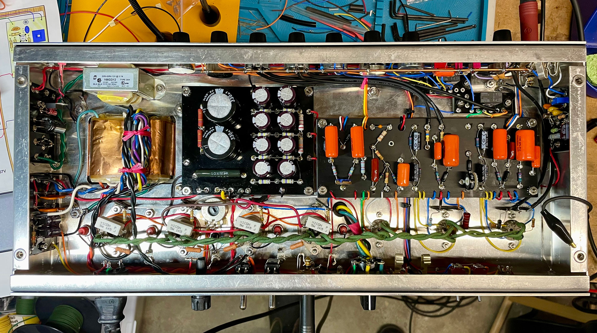

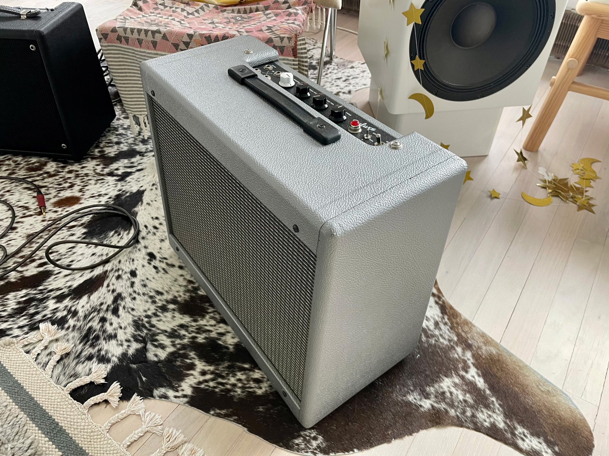

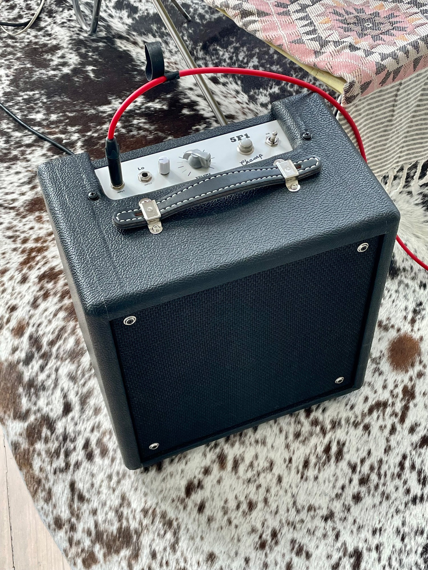

Some inspiration attached, Fender Champ and a "Deluxe"....The last image is a Dumble—it's NUTS but does sound incredible outside or in a big big space.

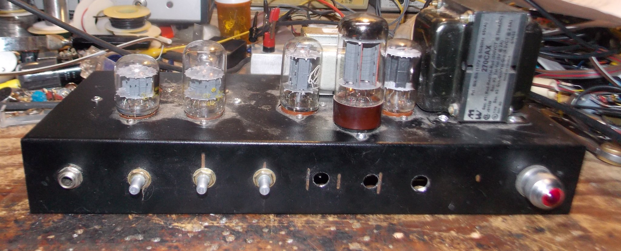

This is my guitar amp project for now. I actually started it a while back and had to shelve it for a bit. I did it on a sort of challenge from a guy I knew. The challenge was ( and he really was joking at the time). Why don't you make a guitar amp using those funny looking TV tubes. I chuckled and didn't say another word. When I went home that night, I went to my 1 shed, got the chassis, power and output transformers. Went to another shed started digging up tubes. I already had the pots and various other components in my work room. So, I sat down at the bench, laid it out and started cutting holes. I wanted to use all Compactron's and Novar's tubes but there were a couple I couldn't find. for one the rectifier. I am going to make another stab at find a Compactron rectidfier. If not, I will have to use the 5Y3WGT that I have mounted right now. The input tube is a 6AC10 like in the old Ampeg Jet. The other preamp tube is a 6U11. The 2 small 9 pins behind the input tubes are 5670's for the active tone and the output tubes are 6GF7's. The 6AC10 and the 6U11 are triple triodes. The 5670's are dual triodes and the the 6GF7's are dual triodes. One section is a low level triode the other is power. One of the low level triodes in the output tubes will be a cathodyne phase inverter the other low lever will be the reverb tank driver. The amp will have input gain, Master volume, bass,mid and treble active tone controls and reverb send and return. It should have around 12 to 14 Watts output with a nice tank reverb. I have some other trick I think I am going to throw in later. Telling your buddy to set up on a spread sheet is a good idea. For me though, I carry my spread sheet and schematics in my head. It helps to have an Eidetic memory. This is kind of the Dumble method of amp building. Now I don't know if he watched me or the other way around. Anyway, we both had the same belief in amp design. I don't want to build a Boutique knock off of an AC-15 or30 like Bad Cat and so many others. Each one is different and they all sound great. One thing I don't do that he did was fill the amps up with goo when I get it done. Oh yea, the speaker for this amp is an old single 10 Silvertone cabinet with a Jensen Blue Frame in it. I bought the cabinet over 20 years ago at a guitar swap meet in Phoenix. Bought it for $50 and the Jensen was good. I do a lot of that or at least I did. IO have a lot of bare NOS chassis, at least a half ton of old Iron, around 20.000 tubes( use to have 5 time that amount but had to sell a bunch of them when my Wife got really sick). I have been at this since I was 11 Years old and I just turned 70 last month... So, there's a bit for ya. Oh yea, one other thing I wanted to mention. You talked about The Gorilla amp. Back in the 80's I( went in the studio with my band at the time and we produced an EP. The only amp the guitar player used was one of those Gorilla's. Anyway so, there you are. Good to meet you.
Best Regards,
Jamie

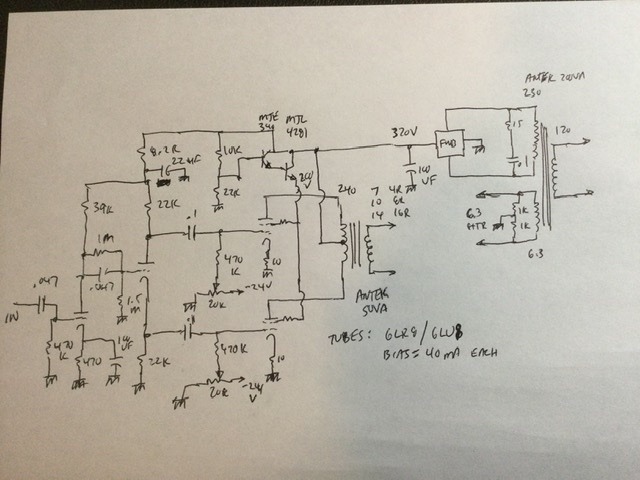

Very cool! Do you have a schematic?
I have never heard of 6LU8 tubes so I will look into those.
It’s one of those TV tubes, thats still available and around $8. Contains a pentode with more kick than an EL84 and a nice small signal triode. Not the cheapest on the planet anymore, but cost effective for what you get. Hundred (or two hundred) buck friendly. They “work” in standard topologies where pentode outputs work. Had a pair up and running on the bench with about the cheapest transformer set that you can get, and it didn’t give me any trouble. The only thing you e got to work around with these off the beaten path tubes is the fact that you have to drop the screen voltage. They are NOT happy at all running them up around near B+, hence the emitter follower for g2. This is just the simplest cheapest way to do it. SOA is an issue in the pass transistor - in theory you can use one cheaper than an MJL4281, but it is the strongest one you can get these days.
