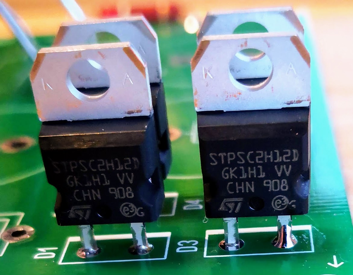

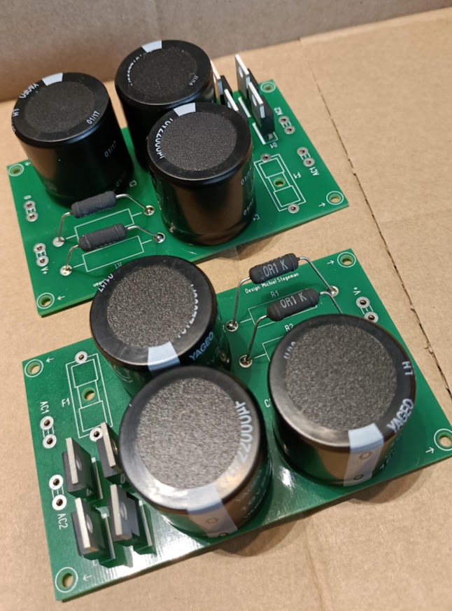

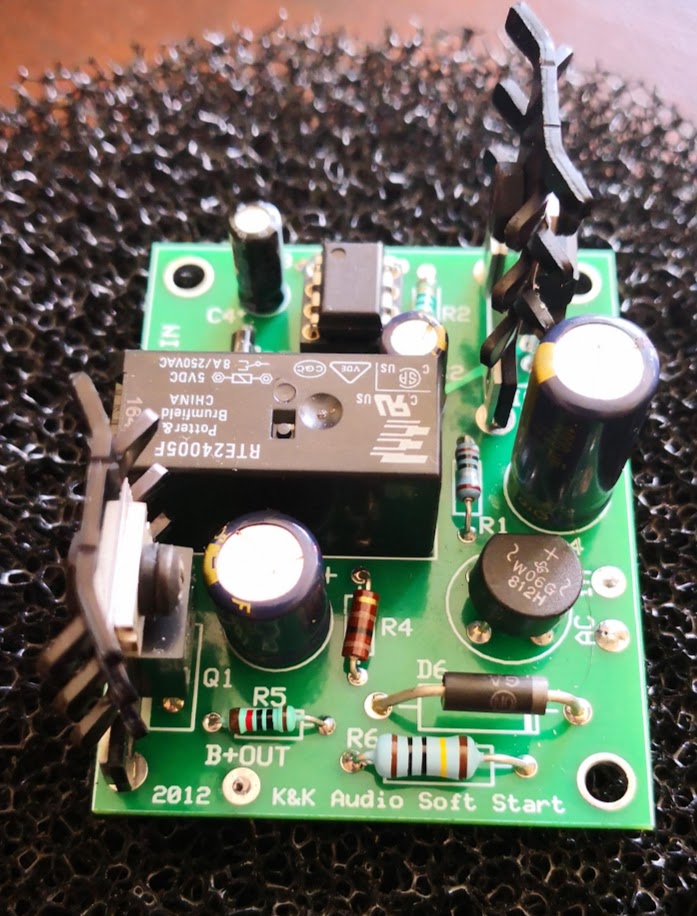

I'm planning to use 1200 V power Schottky silicon carbide diodes for the HV. Followed by the K&K Audio SoftStart module. (It uses a 30 second timer after which it ramps up the voltage in 2 - 3 seconds. Should be enough right? Otherwise I can lengthen the time...both for the relay and the ramp-up.
For the filaments I think I'm going for AC as shown. But I might try Rod Coleman's boards later.
Filaments: I think the Rod Coleman filament boards are soft start (delays full heat to filament and/or cathode). Take how long that is into account.
B+: Parts that have intrinsically correct timing may be more reliable than a circuit that drives a set of relay contacts. Depends on the exact parts, and their quality. I know some use the Damper Diodes, lower voltage drop that most 5V rectifiers, but not as low voltage drop as silicon diodes.
A completely different issue versus your thread, but applies to B+: I did have a B+ that had problems with killing 1kV diodes that should have been high enough PRV rating. There was a situation where the transformer primary was disconnected and the secondary was not loaded (no tubes in, so no filaments across the windings). I replaced the small diodes with 8A 1500V HEXFREDS. The Big Area Chips took any and all punishment that the circuit could put out.

I would run separate transformers for B+ and heaters/filaments. Then use the relay to switch the primary of the B+ transformer, do not switch B+ itself as the relay was not designed for that. 450V+ is way too much to safely switch with 250VAC rated relays.
I am actually planning separate transformers for B+ and heaters/filaments.
Because the K&K circuit I have ....also has a slow ramp up section...I'll just use switches...and will use the relay/slow ramp-up for another project.
A little snippet from K&K Audio website though on the relay:
The same PC mount power relay is used in both circuits and is rated for a hefty 8 amps. These relays have been used for years in products switching B+ voltages as high as 550V with no problems.

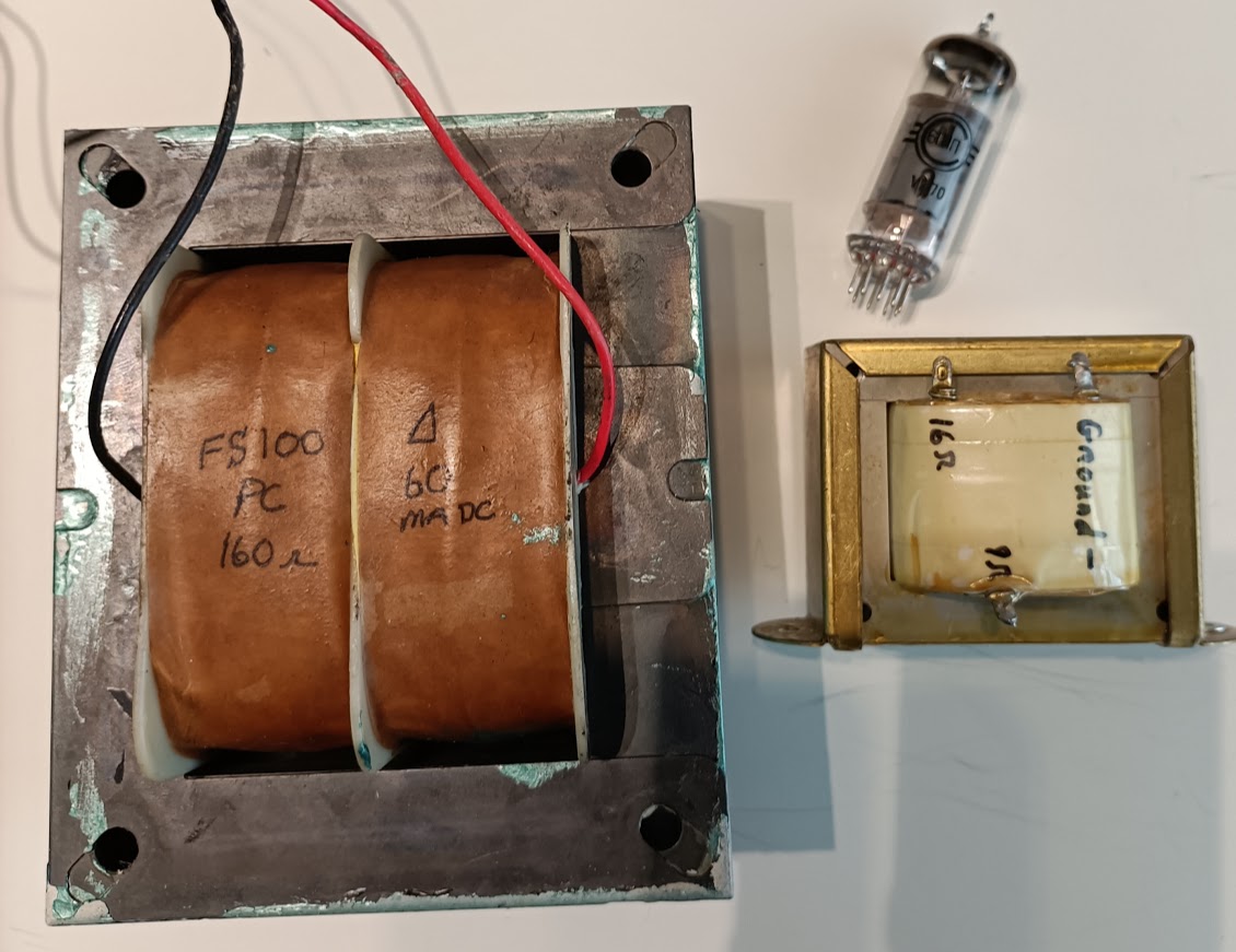

Finally started on this amp again. The plate choke paint was chipped off in some arease...so I just did a respray.
Pic with shrouds off the plate choke Magnequest FS-100 PC /60mA (around 125H). With output transformer (TFA 2004 Jr) next to it and a 6p1p as size reference.
