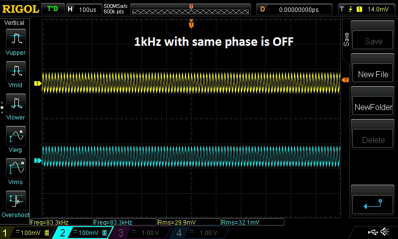

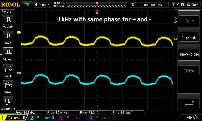

No change to noise level during my experiments. Aluminum foil on DC to DC also didn’t change it.
Should I try higher inductance coils, and let’s say to double it? Also, my U4 has no sink yet and it is hot. It might be noise.. Board is not in grounded box and also it might picking up some RF... This ripples are in 100mv RMS window.

When I experimented with this, I found that changing the filters didn't make a lot of difference. It seemed like most of the noise was radiated, not conducted. The thing that made the most difference was physically relocating the converter away from the rest of the circuit.
I also tried several different converters. The one I settled on was this:
https://www.mouser.com/ProductDetail/XP-Power/IE0505S/?qs=w/v1CP2dgqoXUua2Bslg5g==
I think it is a little better than the one I originally had on the BOM.

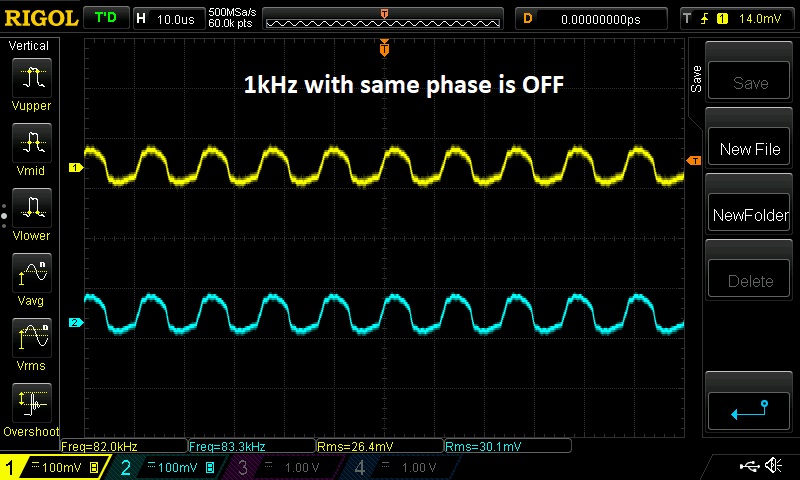

Installed IE0505S DC2DC and high frequency component is still there. Less jumpy output signal i general, but 80kHz is still there with about 80mV in average for RMS. Tried Mu Metal covers on these IE0505S and also on L1 and on L2 coils, and saw no impact.
So, I'm thinking about trying higher inductance coins anyway (in spite of your info about nature of airborne noise coupling). The problem is that coils have lead spacing equal to 2mm and the most of similar coils (I think about shielded once too) are 5mm lead spacing. There is only one coils from the same series that has same lead spacing is 11R474C with 470uH. Is any part that I missed will go to the same position with 600+uH? I see 22R684C, but it is 3mm and not shielded either....
Any way, I'm in waiting for enclosure which supposed to be here in 2 weeks. So, why now to spend that time for some trials...? :)
Tested with 1.5uH (22R155C) coils and still no significant change to 80kHz noise. Waiting for my box to arrive in a week or so and proper GNDing inside of it. Might be my boxing will reduce it. Let's see...

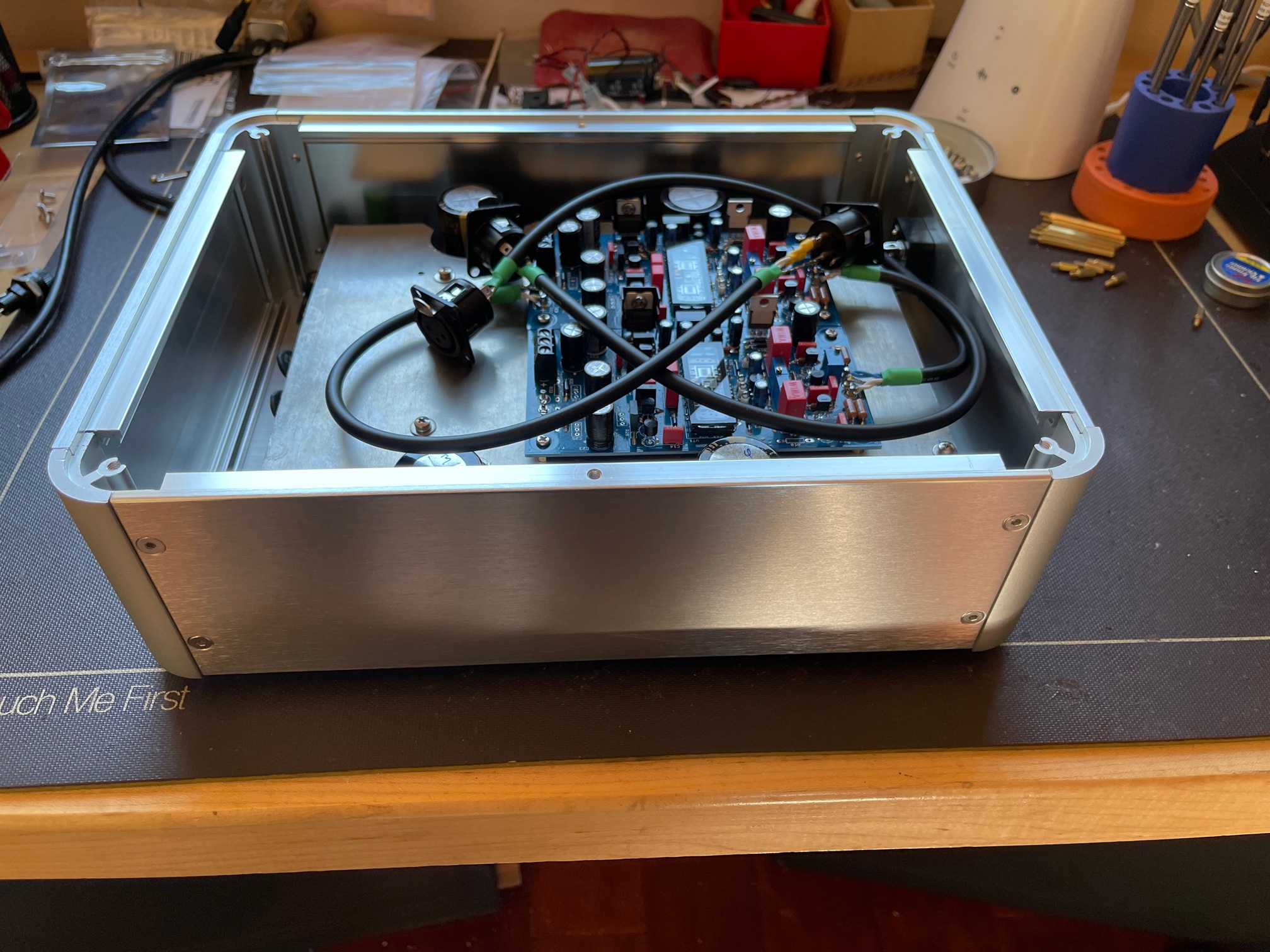

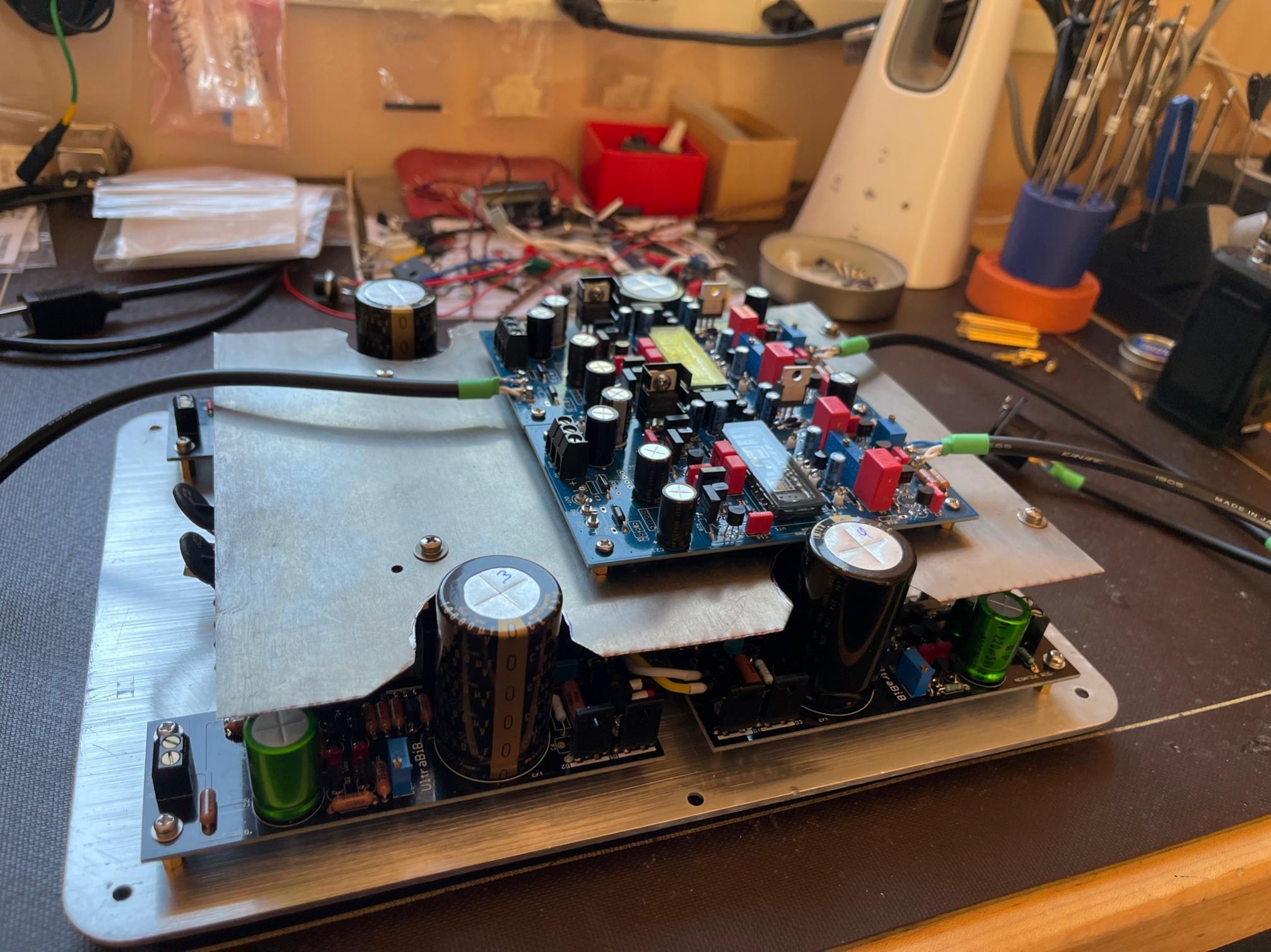

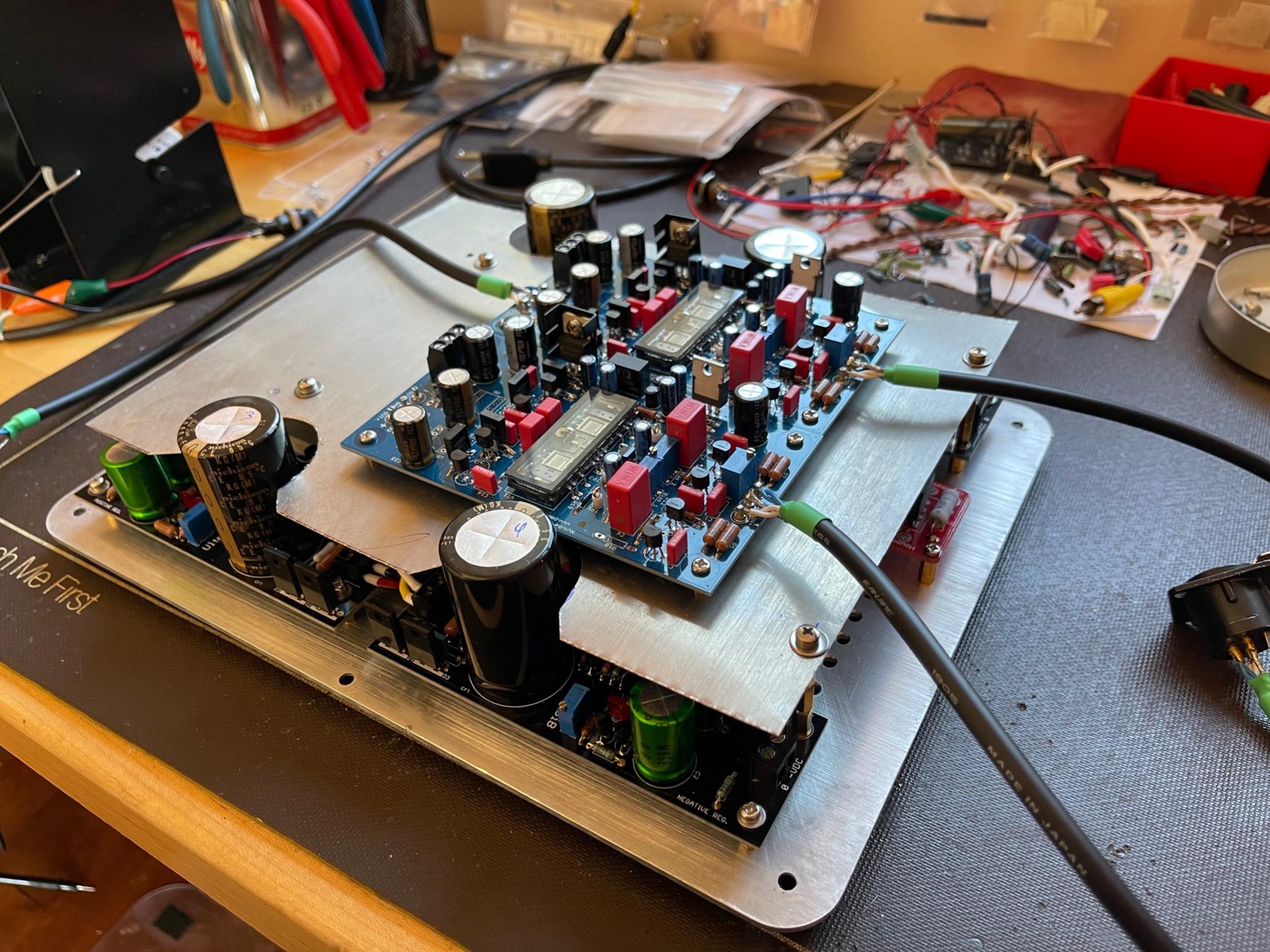

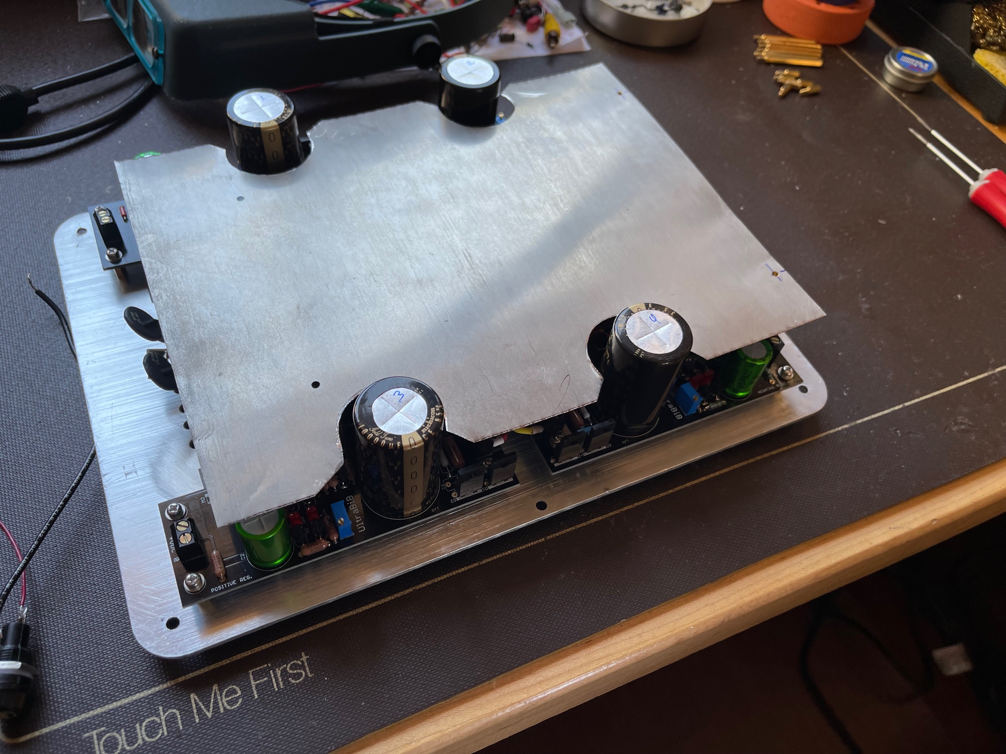

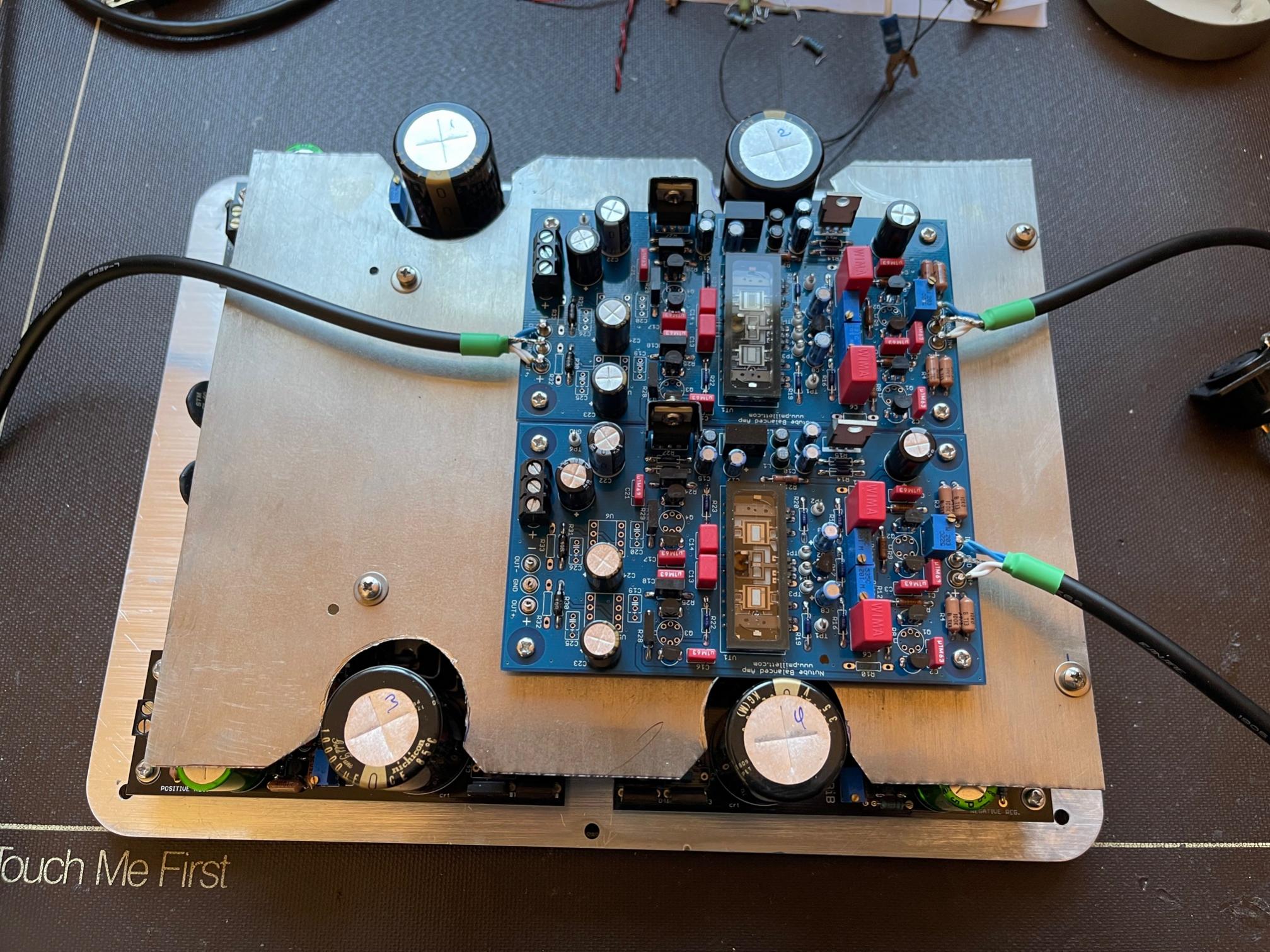

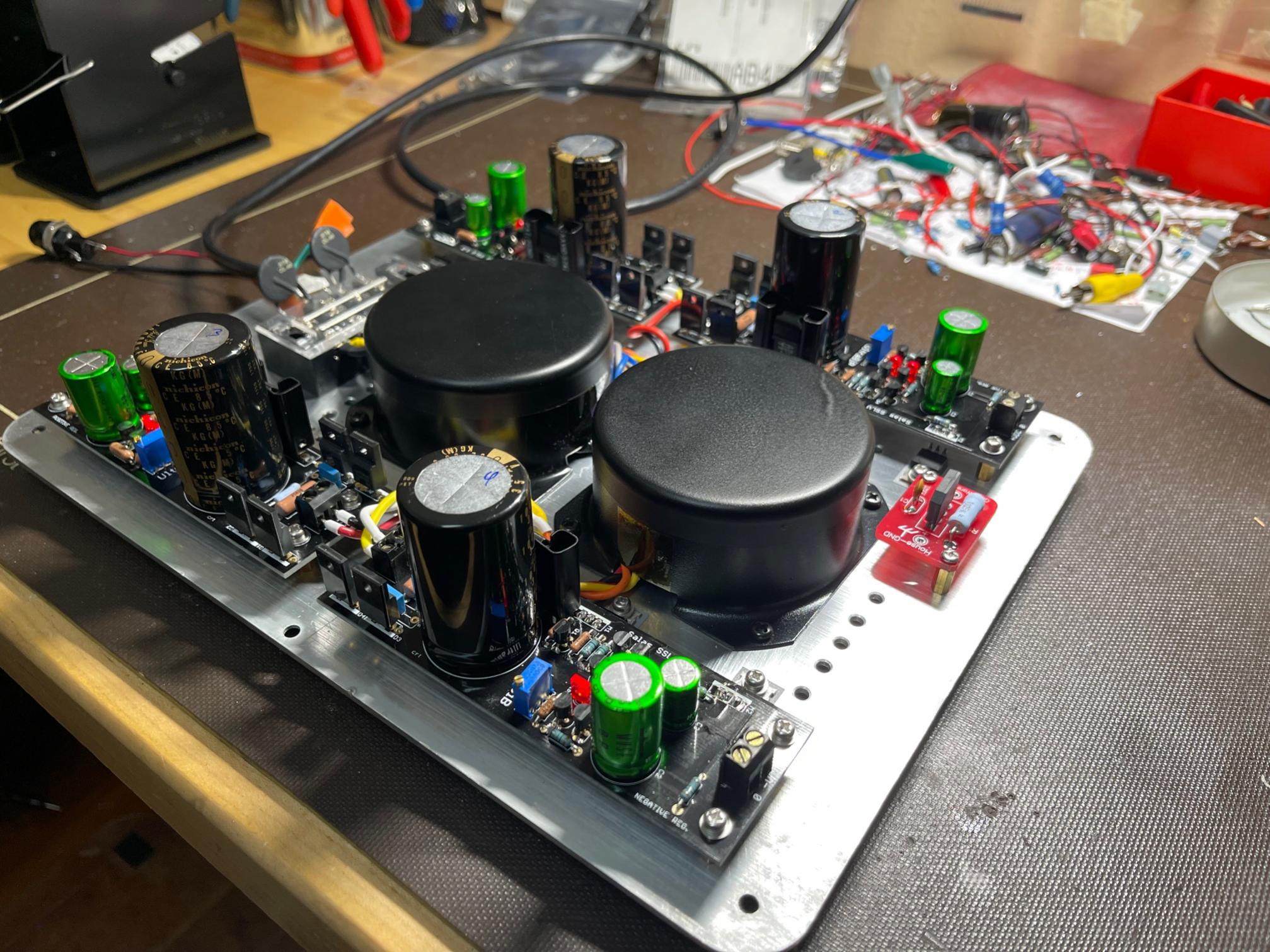

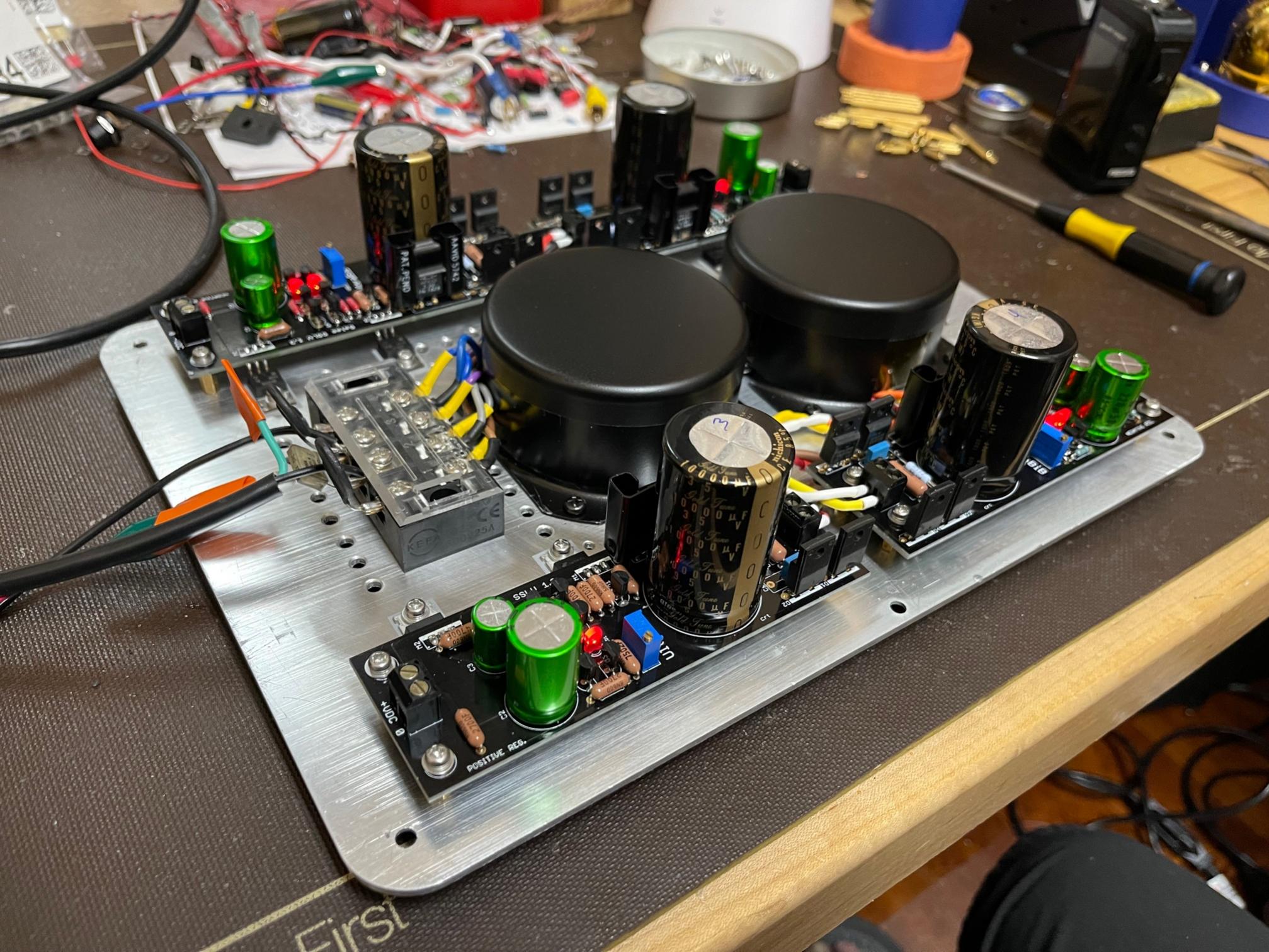

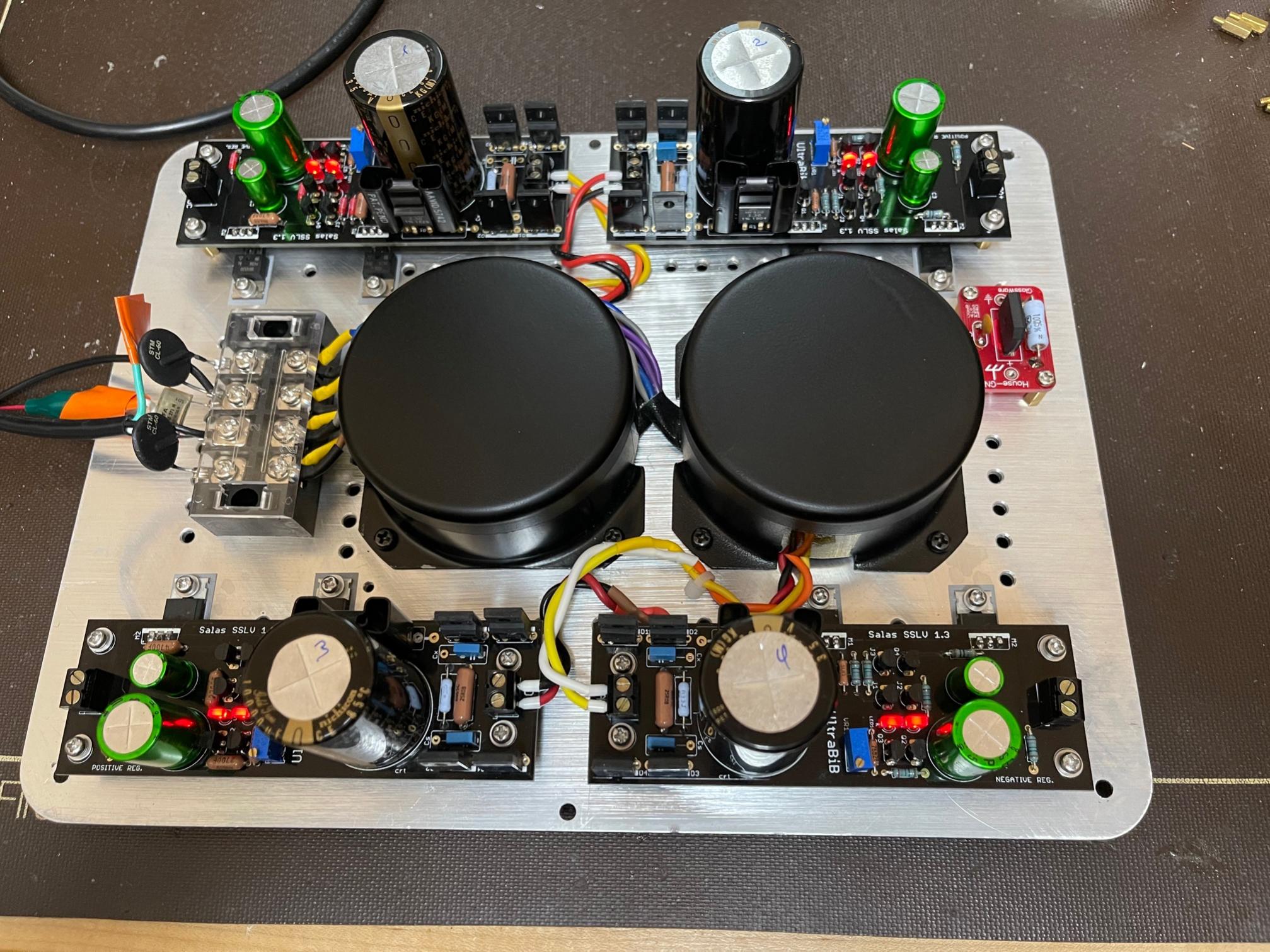

Finally, have my box arrived and I already started component assembly. Bottom part, witch is power section, is ready. Second floor will accommodate apm's PCBs and separation plate is made of 0.3mm Permalloy (Mu Metal).

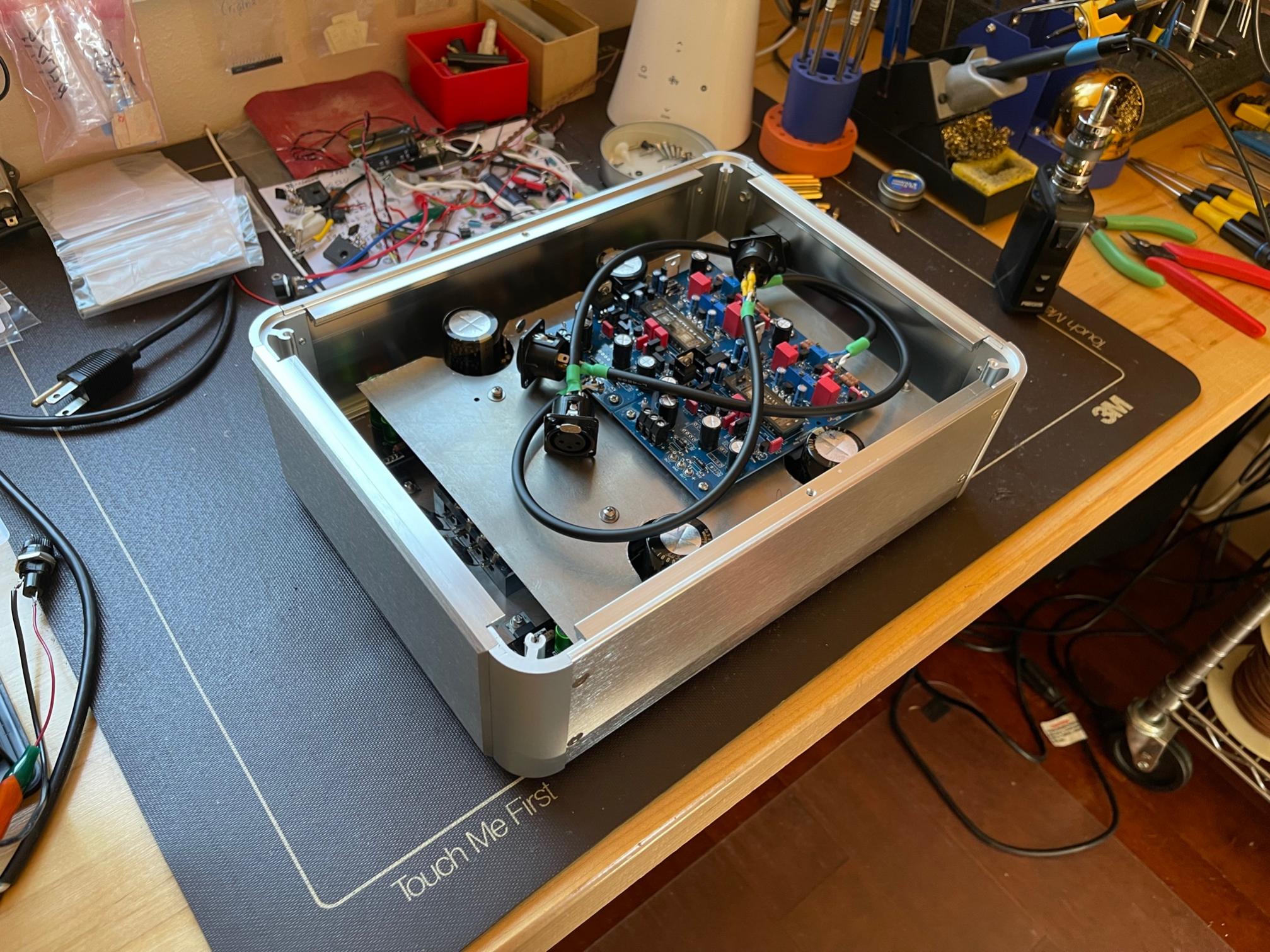

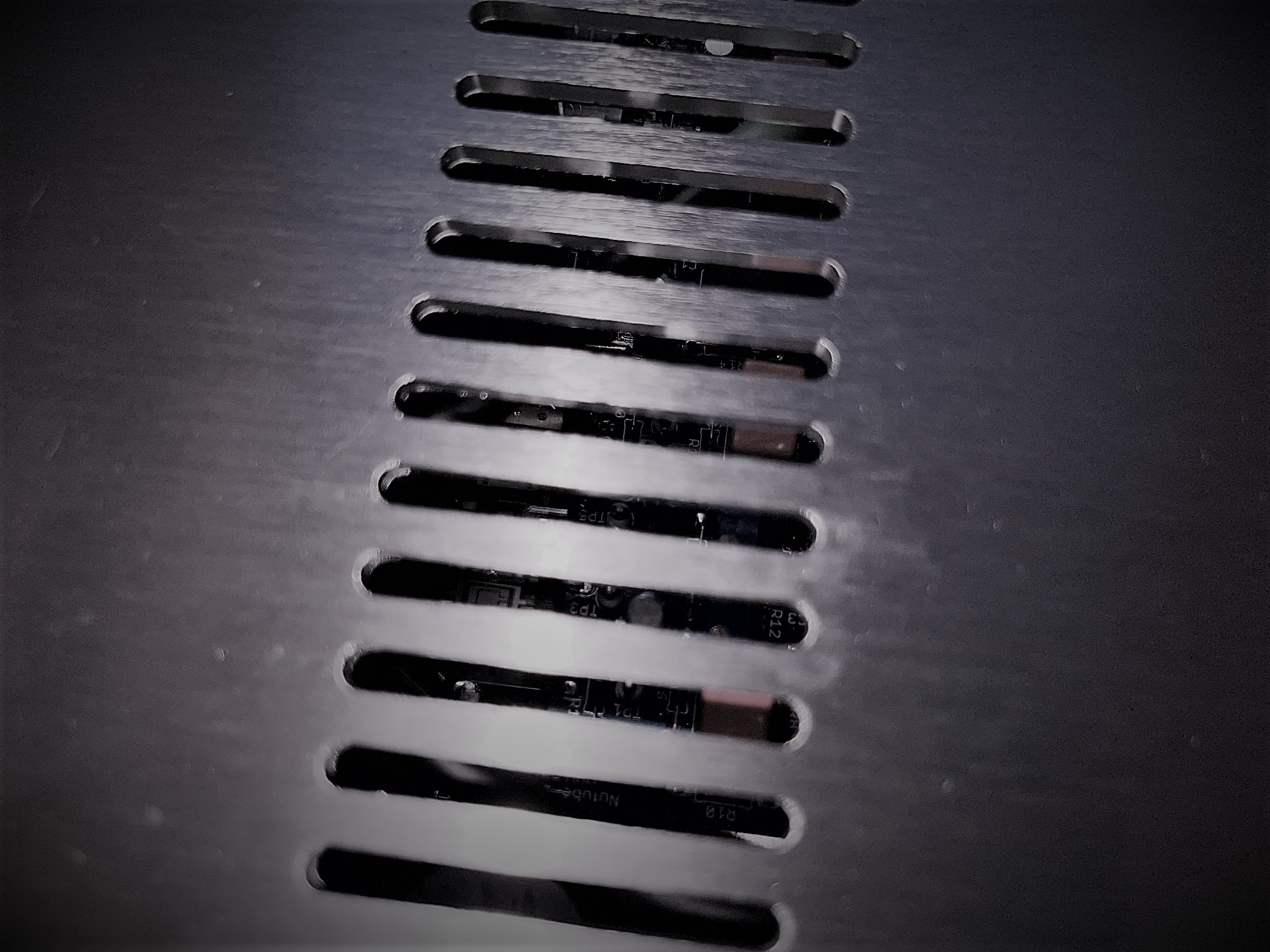

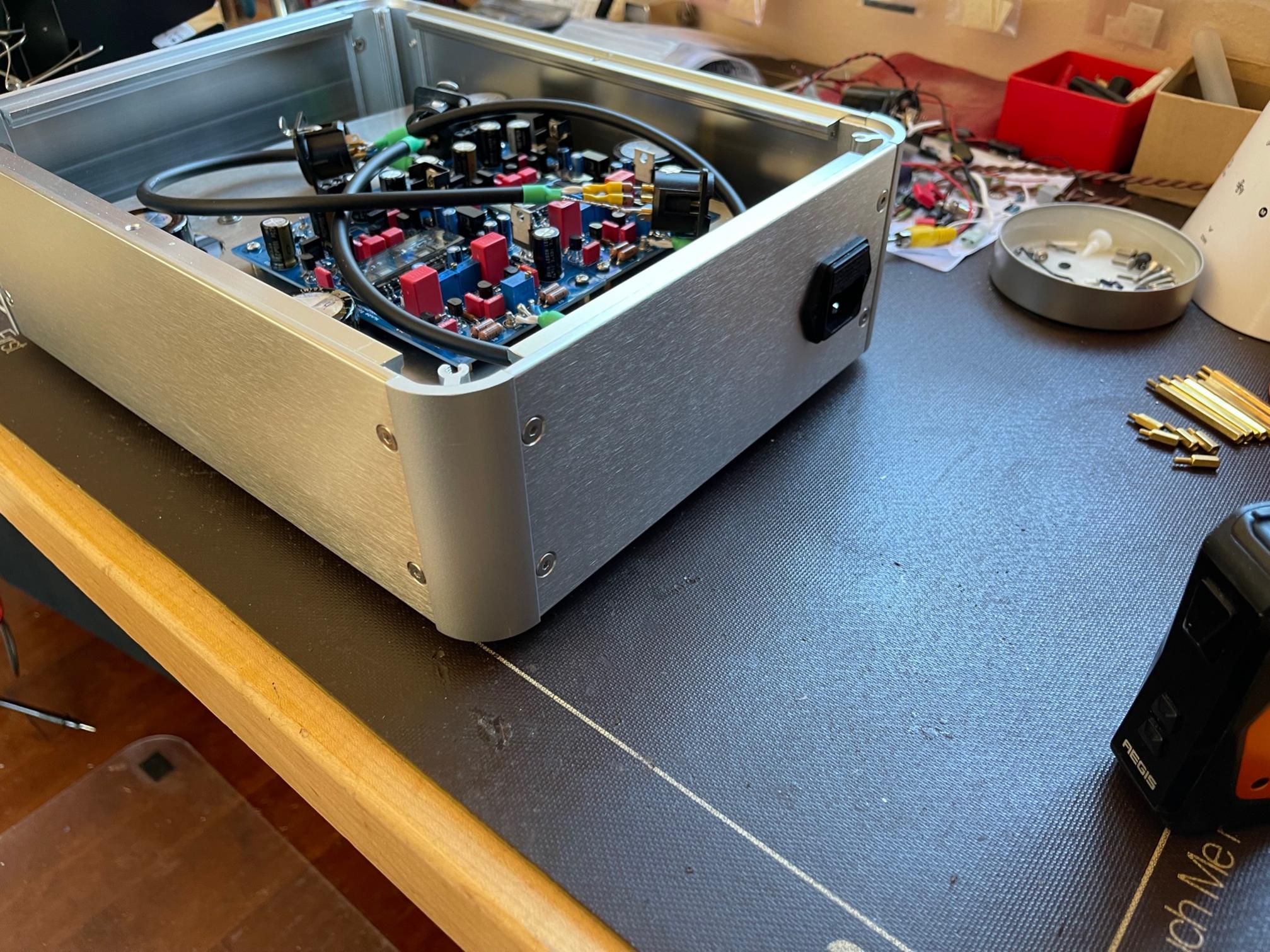

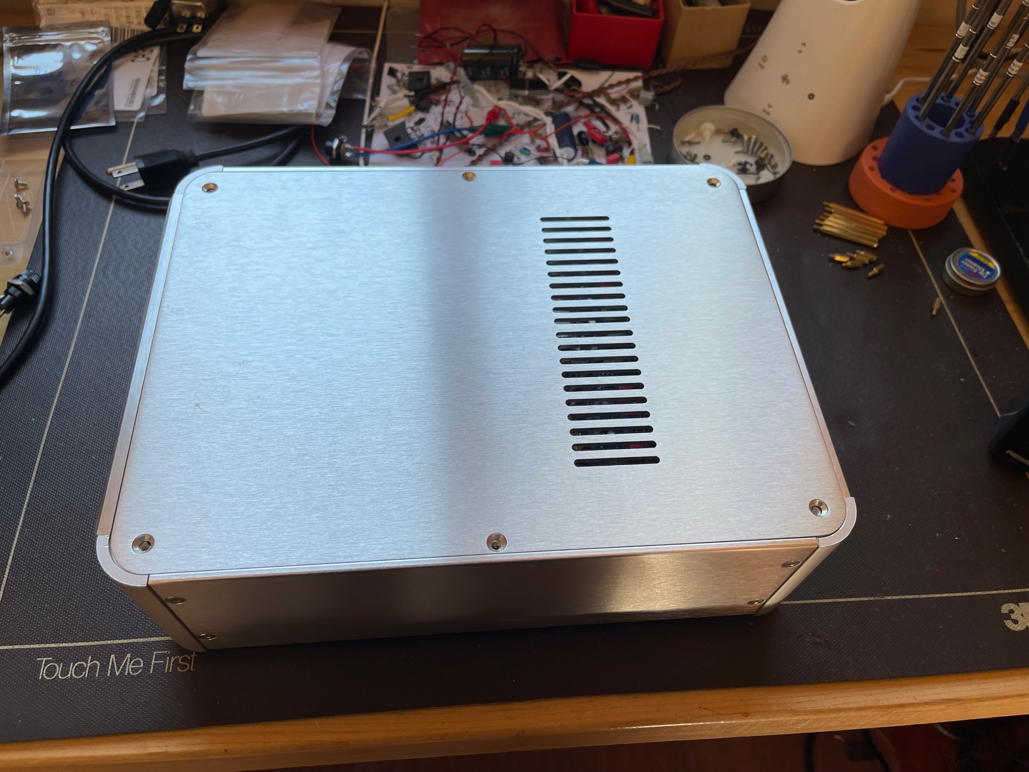

And here is with enclosure. Front and Back panels are not milled yet. Tried to make tubes to be visible through vents holes. Also, I'll add nice UV meters to the front.

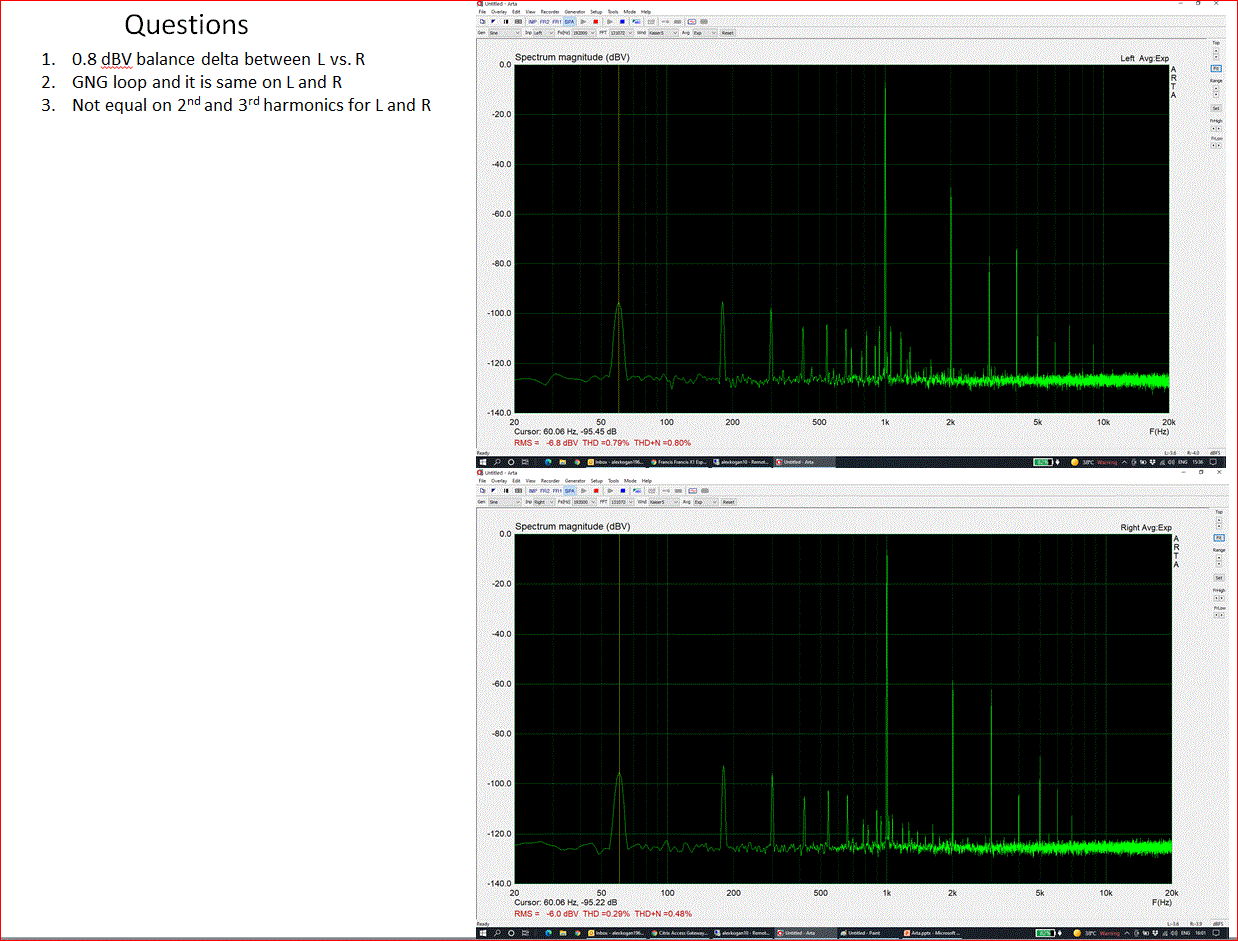

All is boxed, but I'm still waiting for some enclosure related parts that must replace damage caused by shipping from eBay China. I settled with my setup and I'm running +/-14.80VDC on both channels. TP3 and TP5 are at 5.4VDC on both. All the rest of TPs values are at advertised ranges.
I have some GND loop (hope it is not my Ficusrite artifact). Please see attached Arta. Also, I have some imbalance and harmonics seems bit different on each channel.
Please advice if you know how to defeat these....

Connected to balance source first time and I'm bit confused now. First of all, I hear no GND loop hum. Second, it is very quite at 2/3 of my total volume range (my headphones are 200R impedance and 130dB SPL). Farther volume increase creates obvious harsh and distortion.

Hi Alex,
Good to see that you are up and running!
Firstly, have you connected your Focurite with bal in and bal out? I am using Focusrite gen3 bal in and out, feed 1v in by adjusting the Monitor knob and keeping the Gain knob completely off. and measure out thru Arta. If you can do likewise we can easily compare notes.
Can you feed 1v in and do a loopback and post the plot? This will tell us what residual to expect. Next keeping 1v in in all cases and using the volume attenuator of the preamp do plots around 1v, 0.5v, 0.25v and 0.12v. This shows the behavior as the volume is reduced. Ideally, around 0.12v out there will be very little H2 and no H3 and then as volume is increased H2 rises and then you see H2 and H3 and as output is further increased H3 rises much faster than H2. And, the two channels must look similar. In my case most of my serious listening is at around 0.12 to 0.20v attenuator positions. Please post these 4 plots.
Personally, I feel your THD levels are very high and quite a bit different from each other. I realize that you have set it to 5.4v specs each but as I mentioned earlier it does not work for me. Considerable twiddling is needed.
Regarding the 50hz spike have you added a resistor between the Ubib G to chassis?
The db difference between the two channels is to be expected but can be fixed easily later by padding the attenuator.
