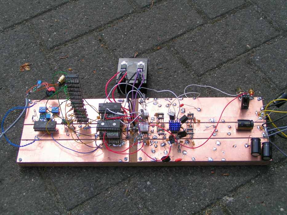

Prototype Direct Interpolation DAC
Hi all,
For those who can't wait to hear this DAC, I will post a better photograph of the breadboard prototype so you have an example of how it can be done. I will post the differential output stage schematic diagrams part 1, very soon (my ancient DOS CAD system cannot export files). Then you got all necessary information to get soldering....Tip: by piggy-backing the 74HC166 (see photograph), the timing chain can be easilly build.

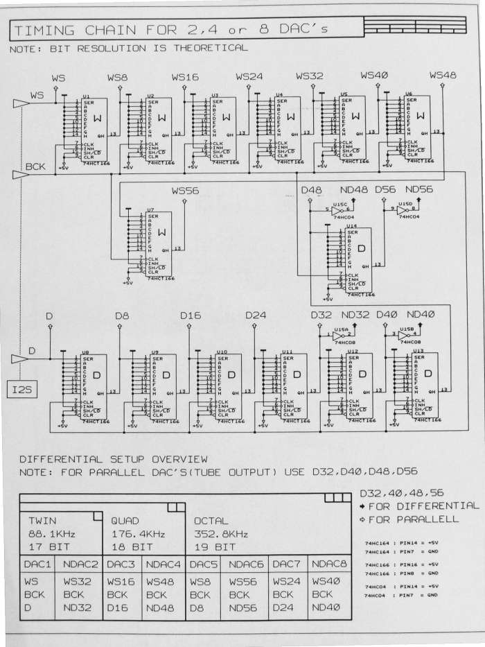

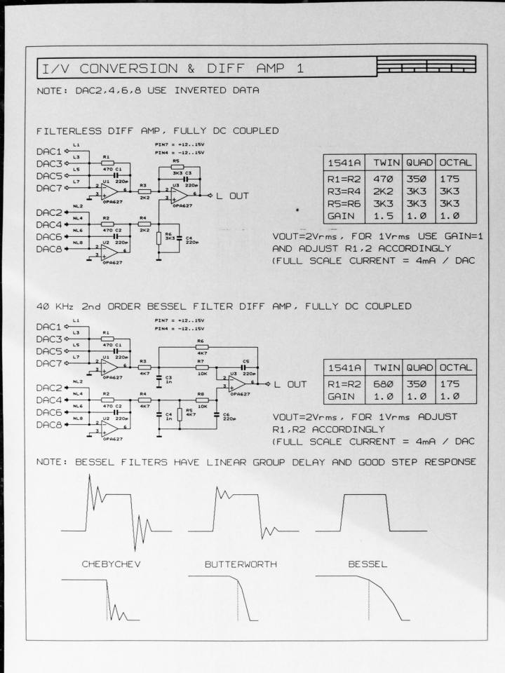

Schematic diagram I/V diff amp
Hi, all
Here are the schematic diagrams of the I/V and differential amplifier stage part 1 that I promised.
Guido had a question about delaying samples:
A dual DAC: DAC 1 sample appears immideate, DAC2 sample 32BCK delay.
A quad DAC: DAC 1 sample appears immideate, DAC2 sample 32BCK delay,
DAC3 sample 16BCK delay. DAC4 sample 48BCK delay.
An octal DAC: DAC 1 sample appears immideate, DAC2 sample 32BCK delay,
DAC3 sample 16BCK delay. DAC4 sample 48BCK delay, DAC5 sample 8BCK delay, DAC6 sample 56 BCK delay, DAC7 sample 24 BCK delay and DAC8 sample 40BCK delay
So minumum sample delay is zero (DAC1), maximum delay is 56BCK pulses(DAC6) still less than 1 sample. All samples are delayed in the same manner (synchronous shiftregisters)
Hopefully this will clarify the delay "issue" ':)'
max. 48BCK delay for all samples and the octal DAC has max. 56 BCK pulses delay for all samples

In my setup WS and Data has to be delayed in time, 4 clockcycles/ dac whith four dacs. Want to tie all outputs together after 4 I/V resistors/dac and tubes (allen bradleys), or maybe use the Pedja's AD844 output stage, an IC I/V with many good reactions on the sound of it. The AD844 is used in an other implementation with Pedja's I/V.
The interpolation with 4 dacs schematic looks very simple, yours Ecdesigns is more complicated, with more logic, and i want it as simple as possible to reduce extra's (jitter?) I think this design is allmost the same as Cambridge used, not sure, only they kept SAA7220, thus 16 times oversampled (4*4)
Btw wat clock do you use Ecdesigns, are you familiar with Guido's or Elso's creations?

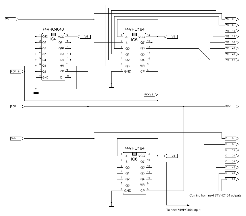

Why using so many chips ?
Just contemplated a bit on the usage of so many shift registers as the only thing each IC does is delaying the signal for 8 BCK clock cycles and than give an output. Why not divide the clock by 8 than and use one SHIFT step ????
So I put a quick circuit up and this should be giving the same result as the proposed circuit with 14 x 74HC166, with advantage, that VHC logic can be used, less inputs are loaded on the BCK clock (in stead of 14 inputs now 1) and the PCB design will be easier and smaller, so now a very small (if done in SMD) PCB is possible, so it can be implemented more easily in existing DAC systems (like my DAC-Modules) as a small add-on, directly where the I2S signals are entering the DAC chips.
Just my 2 cents ..... not tested and 100% thought through, but just have a look at the basic idea ...
doede
PS: mmmhh, already see that this will not work of course for DATA :cannotbe:
For the WS it should work though....
I put on a "new Circuirt" idea. OK, the gain is not so huge anymore, only "saving" 5 IC's.....
Hi, dddac,
Thanks for your reply.
If you read my explanations of the Direct Interpolation DAC in my previous posts carefully and look at the graphic representation picture called dip.jpg (twin DAC example), you will see that I have to shift the entire datastream realtime including wordselect, otherwise my concept won't work. The DAC's don't "know" that they receive a different signal, they just put the sample on their output after the trailing edge of WS.
By creating a true (bitwise) digital delay of both data and WS I can move the "cloned" samples around in the time domain with the exact same data as the original sample. These "clone" samples are then placed on specific points in the 64BCK time window (8,16,24,32,40,48 and 56BCK for an octal DAC version). Remember that I make "clone" samples of one sample only. Believe me, if I could have done it easier I certanly would, it has to be a true bitwise double digital delay line, one for WS and one for DATA.
A second issue is fully synchronous operation (all actions are synced with BCK)
for both data and WS signal to ensure that the realtime audio bitstream is not disrupted in any way, so the circuit must be fully symetrical for both WS and DATA. I specially used high speed 74HC166 synchronous shiftregisters and gates for this purpose, 4000 series are way too slow at 5v. I have already routed the circuit board for the timing chain today so "complexity" is no problem. Since the timing chain had to be universal for twin, quad and octal DAC's it got 2 extra shiftregisters. If you could only hear it's sound, you would gladly invest in a few cheap HCTTL chips. And when you look at the picture called prototype.jpg, it's not that complicated:).
simplifying timing chain
hi, dddac,
I have tried the setup you proposed, the idea is very good (because WS is just a symetrical squarewave and the databits are a continuously varying bitstream), but the VHC4040 (sorry I mixed this one up with CD4040:xeye:), is an asynchronous binary counter that delays the clock for the following shiftregister VHC74164. When the VHC4040 is replaced by a synchronous binary counter 74VHC161 it would solve this problem. Correct me if I am wrong but the BCK clock loading in your design is 8*74VHC164 (data delay), 1*VHC4040(divide by 8 counter), and 1*74VHC164 (WS delay). I used the same timing chain both for WS and DATA to make absolutely sure the audio bitstream is not disrupted. As far as SMD is concerned, this would make this project more difficuilt to build for other DIY members, unless they buy a complete assembled circuit board.

I tried self made stranded copperwire resistors (mobius loop using spiderweb winding to reduce capacitance). These sound very natural and exeptionally clear.
I tried all kinds of setup for the I/V stage. Passive resistor stages are problematic because a voltage drop of more then 50mV across them already compromizes distortion figures. So you have to work with very low voltages that are prone to noise and interference signals. Furthermore the following amplifier needs relatively high gain, reducing the bandwith and phase response. You also need capacitors and / or coils in the signal path (phase).
I finally settled for the high quality OP-amp version that I posted. The output of the DAC is connected to the OP-amp - input (virtual ground) so the voltage drop problem is solved keeping distortion very low. The OPA627 really sounds very good (just have a look at the reviews on this chip on the internet). The only "problem" is it's high price.

Hi bernhard,
Thanks for your reply,
No I use Direct Interpolation. The new samples are fixed in the time domain in a way that all subsamples have exactly the same length (if the length per sample would vary then you are absolutely right). So in this system no jitter occurs, this is also verified by measurements and listening sessions. The samples are also in sync with BCK (44.1KHz for all DAC chips). If my system had jitter it would be definitly audible on my sonic resonator speakers as these reconstruct recording room acoustics and depend on perfect phase properties. The slightest error immediately blurs the image. It is as if you put a "magnifying glass" on the audio signal. Furthermore I use a standard NOS DAC as Reference and toggle between the two. as I mentioned in earlier posts (this certainly has no jitter as MCLK is rock solid). The Direct Interpolation DAC gives a very clean natural sound with an abundance of detail, even the bass and midrange have improved. The reference DAC simply can't reproduce these because details are covered up by the well known ultrasonic interference. When this interference is removed by shifting the mirror image up to a higher frequency and enhance resolution as my Direct Interpolation DAC does, the covered up details appear clearly audible, and you start hearing details in a recording very clearly. On one test CD I could clearly hear the artist breathing between singing (CD: steppin, track: Will it go round in circles), I am very familiar with this recording (part of my test CD collection) and I never heard that so clearly with my reference NOS-DAC. So it's a significant improvement verified by measurements and listening sessions. Please read my other posts explaining Direct Interpolation carefully.
As linearity is concerned, optimalisation can still be achieved by changing individual I/V stage gain to get a logarithmic response. The timing chain needs no modification for this
