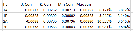

Good day,
I understand this thread was started many years ago and hopefully members will still reading my post.

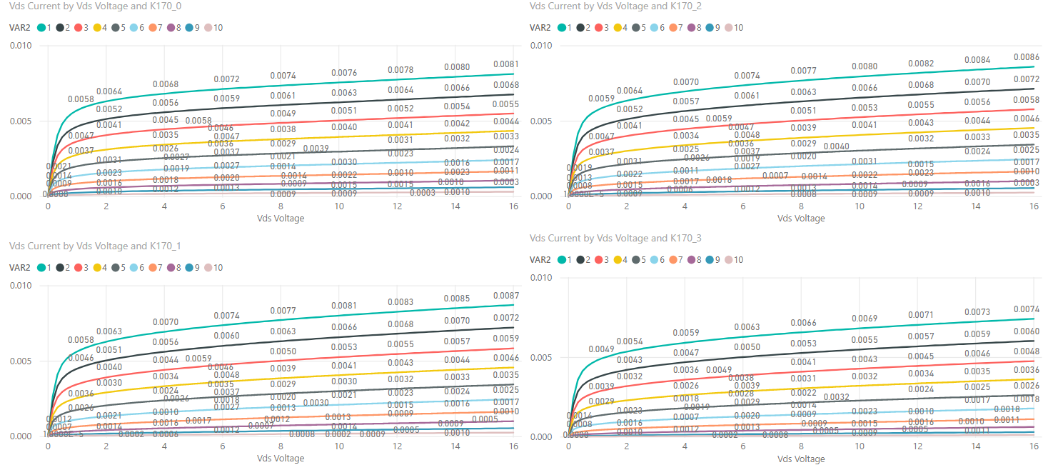

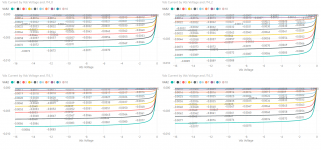

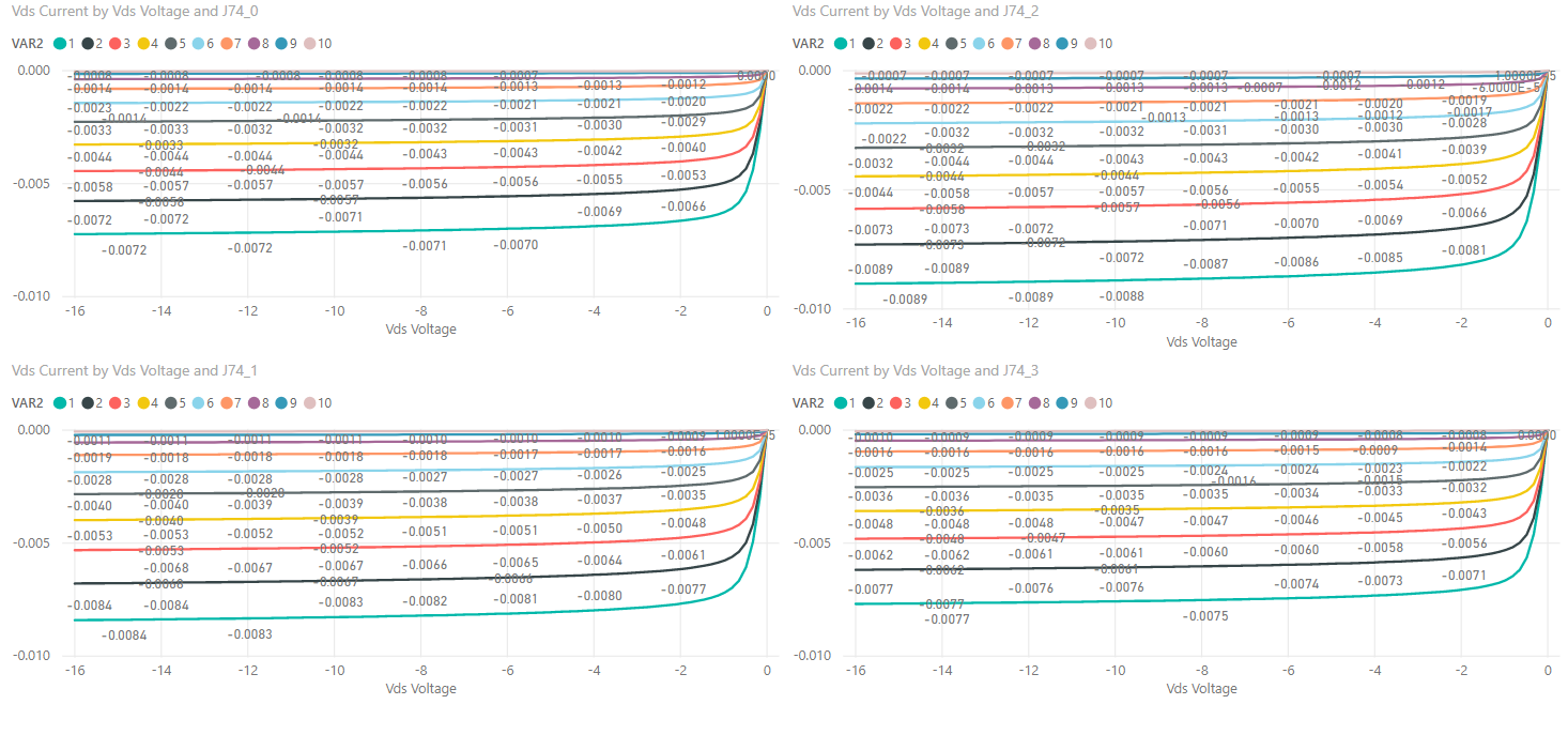

I am building BA3 to drive F5 in my recent project, and I bought 2 sets of LSK170/LSJ74 double matched pair from DIYAudio store since I am building two sets of them together with my friend. Upon receiving the parts from store, I performed one round of VI curve tracing using Keysight IV Measurement software on all of them.
attachment.php
attachment.php
The original matched pair is labelled as LSK170/LSJ74 & LSK170_3/LSJ74_3 in one group, then LSK170_1/LSJ74_1 and LSK170_2/LSJ74_2 in another group.

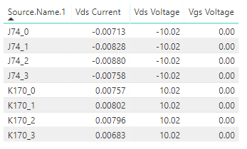

Below is the measured Idss value.
attachment.php

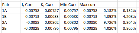

And this is the default matching suggestion.
attachment.php

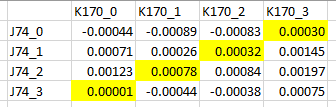

Below is another table showing the delta of each LSJ compared to all LSKs.
attachment.php
And from the delta above, I notice that if I rearrange it with yellow color matching, I can get a more balanced on left and right channel of each BA3 as shown below.
attachment.php
My question is, how I should choose the best matching pattern for a balanced Left and Right system? Is my new matching pattern make sense? Or is there anything that I should consider on selecting the matched pair?
