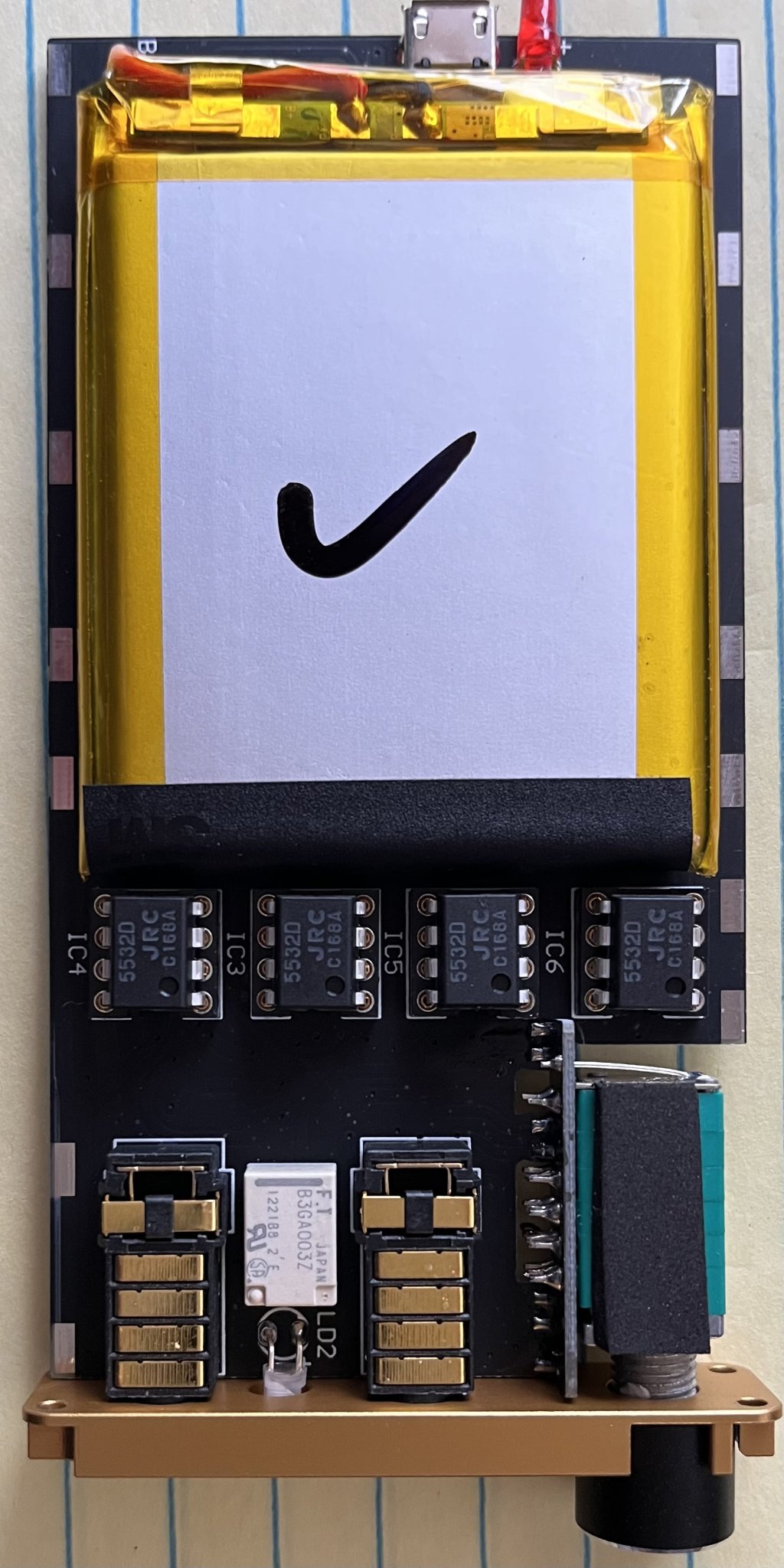

Hello. I’m new to messing around in this space but not new to computer engineering and software engineering.
I have a cheap Chinese amp. Was supposed to be 3.5 to 3.5. What was sent was balanced 4.4!
Can I convert from balanced to unbalanced. I am decent with a soldering iron and not afraid of giving it a shot. I wouldn’t mind modding the jacks and making custom cables. Might save time!?
Replace terminals.
Replace low signal relay?
Change opamp configuration?
Stay with 5532D opamps?
Throw in round filing cabinet and find something else?
Thanks for suggestions!

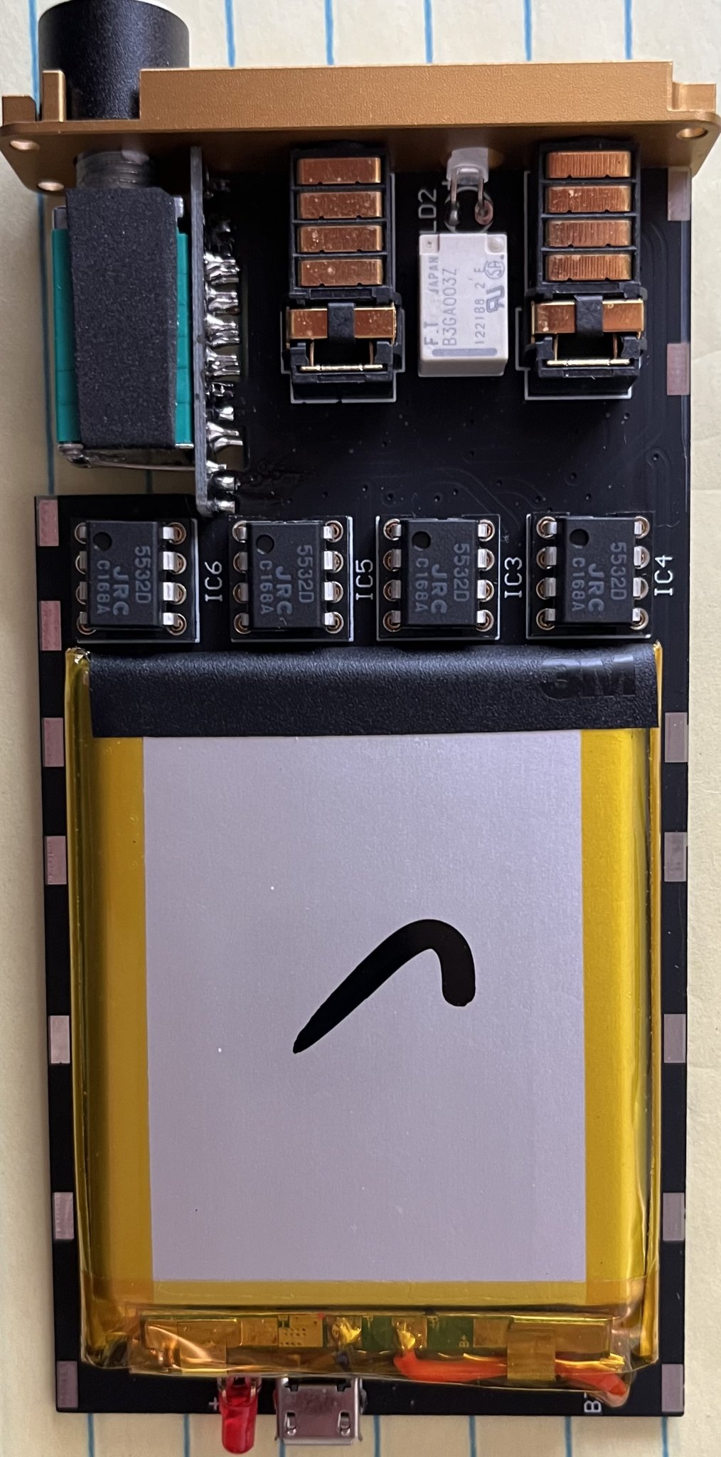

Hope I'm right but I think it might be as simple as removing two negative phase op-amps. then shorting the empty sockets outputs to ground, you will need to hit the datasheets to see which pins. the ones to remove are the negative phase drivers, these two need to converted to Gnd, leaving you with a pos/gnd to each phone cup.
Is there two output jacks? - Do your phones have a single lead to one side or two separate leads connected by a single jack plug?
Ah, actually one of those front sockets is the input right? Give link to item you purchased please and which headphone you are using.
Each side of your headphone needs to see a signal and ground, if they have a single cable to one cup then there are just three wires inside (both cups connected to a single Gnd connection) The Headphones themselves do not know what they are connected to really. Get a multi meter and do a continuity test between the op-amp output pins and the output jack top plates you see there.

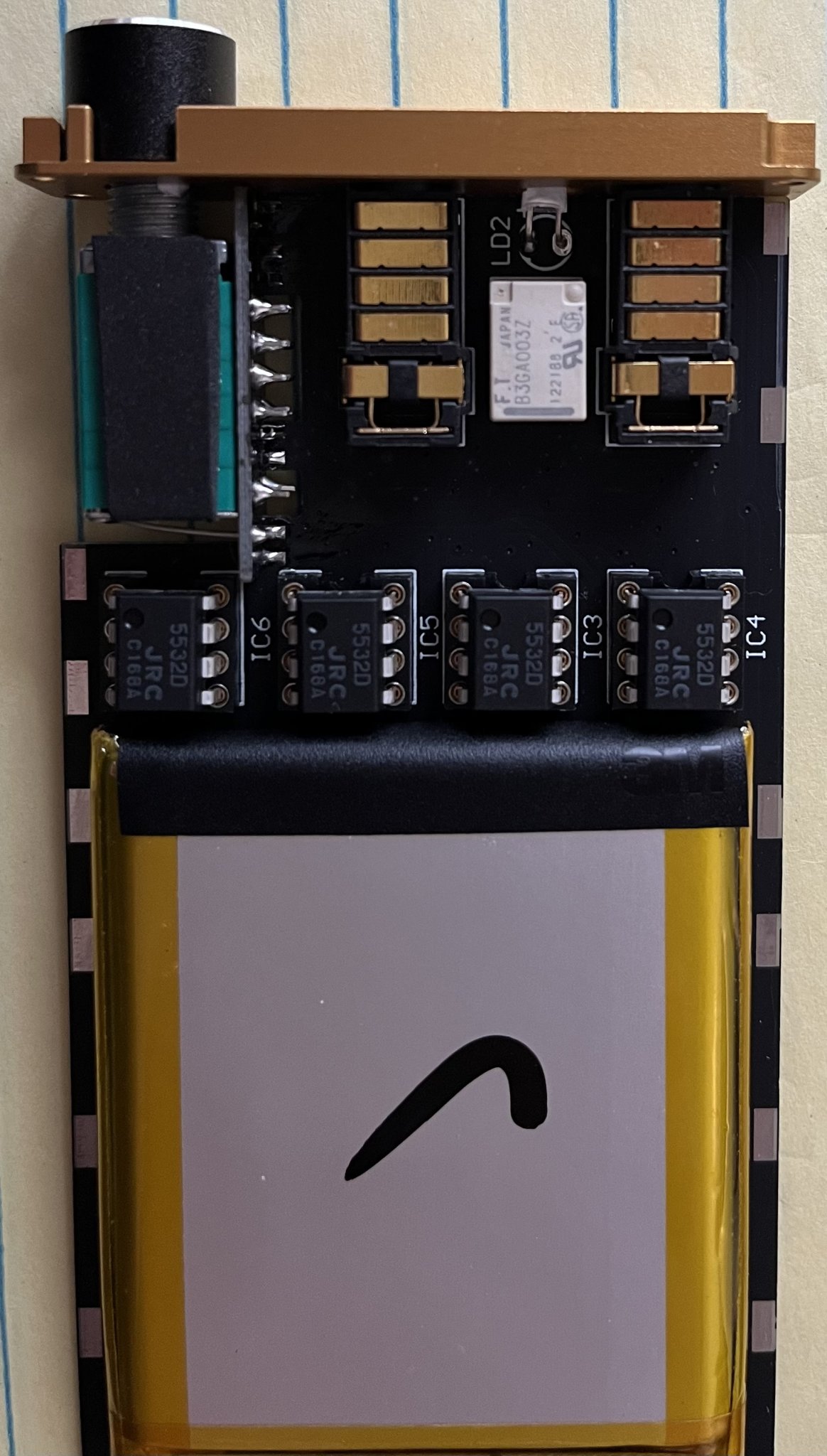

This is the configuration of a 4.4mm TRRRS connector here, the L+ & L- need to be converted to ground. So find the op-amps connected to tip and first ring. (two plates at rear of socket if you see)
You could of course do a very dirty wiring job and solder a single ended socket hanging out the amp to connect whatever jack socket you wish, this might be a way to determine how to proceed. Might be best to solder the signal wires to the positive op-amp output pins on the underside if you try this. Guaranteed way to get confused!

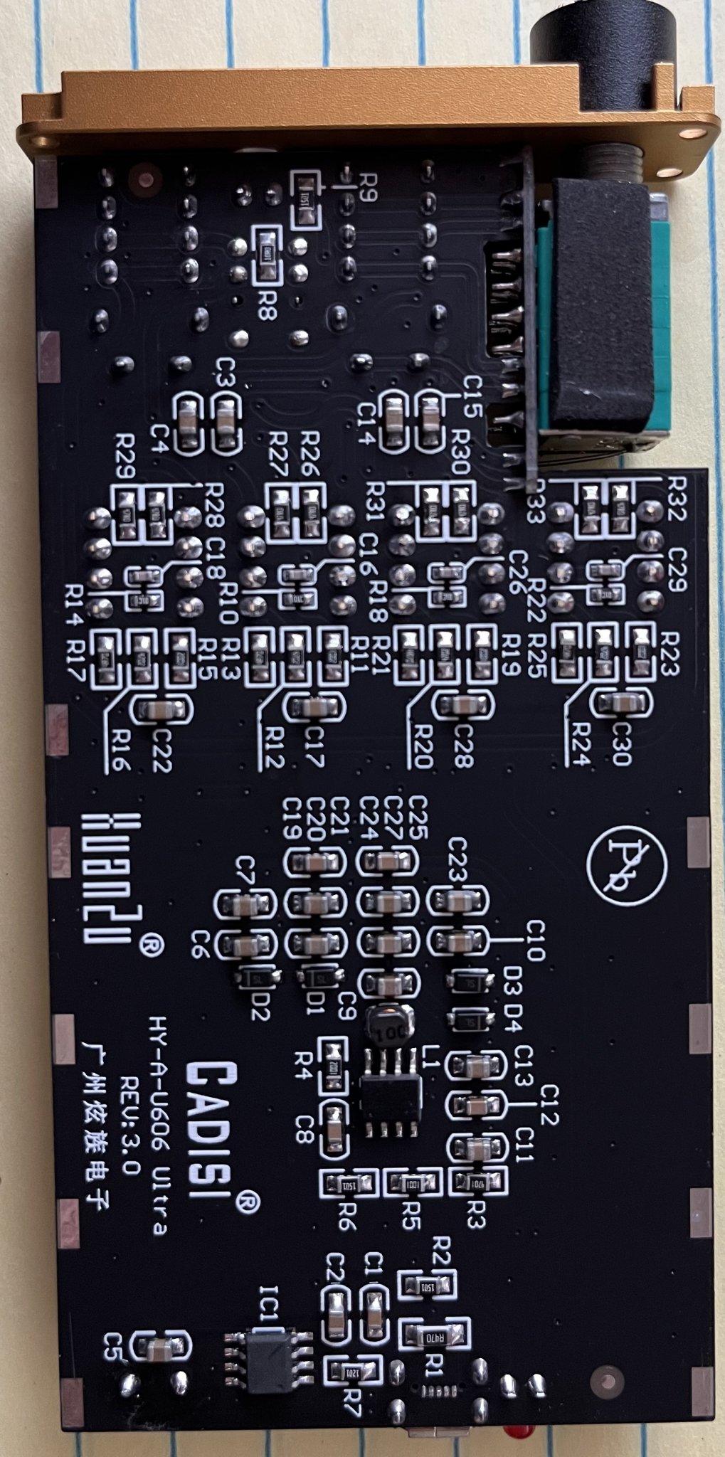

Bloody awkward one especially as everything is PCB mounted. Take your time, have a coffee and study the pin orientation in the datasheets. This can be done but maybe not very neatly.

These will be the negative connections, assuming this socket is output
Sorry, the other part of your question - you then need to make or buy a 4.4 TRRRS jack plug to 3.5mm un balanced socket adapter.
Hit google with '4.4mm balanced to 3.5mm unbalanced adapter' to get an idea. Actually maybe this is all you need to do and I have written an essay for nothing

“These will be the negative connections, assuming this socket is output”
Would this be the same for input? Just making sure. Making cables now.
