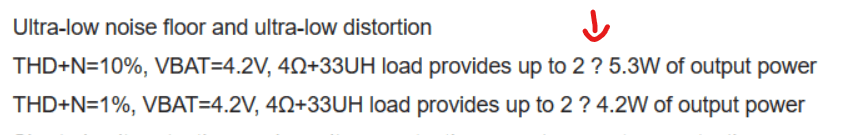

That is funny
maybe intended to be slash but hit shift by mistake.

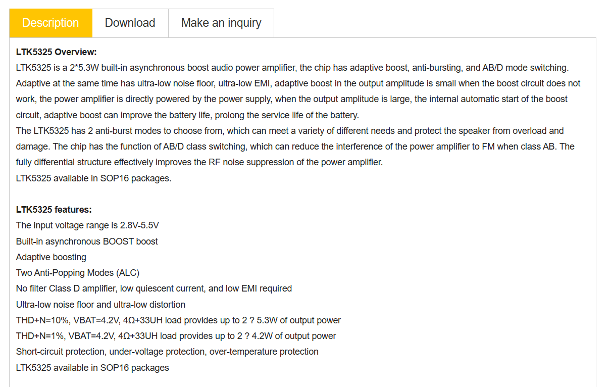

2 / 5.3 Watts

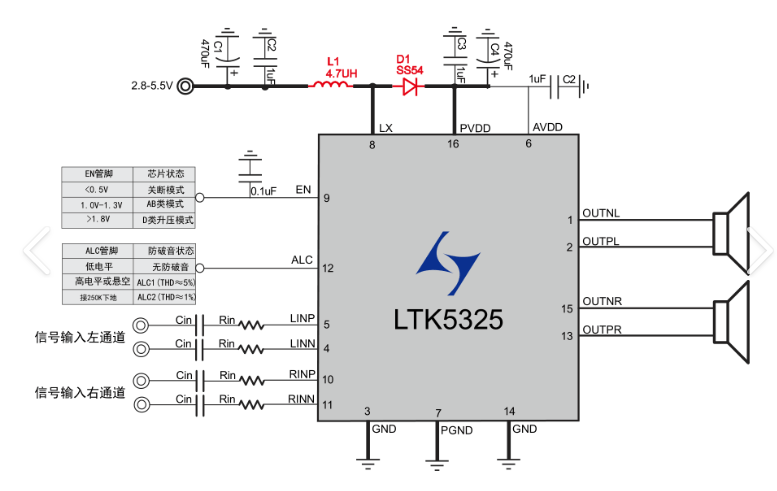

Chip looks good on low voltage from
2.8 to 5.5 volts
So yes, basically nice amp
for typical battery operation
and USB chargers.
Rated at 10% and 1% distortion...lol
So basically 3 clean watts.
What many small speakers actually handle
before linear distortion.
So pretty good really for the application.
And for home / non portable use. The power
supply is as simple as a high current USB charger
brick for cell phone.
