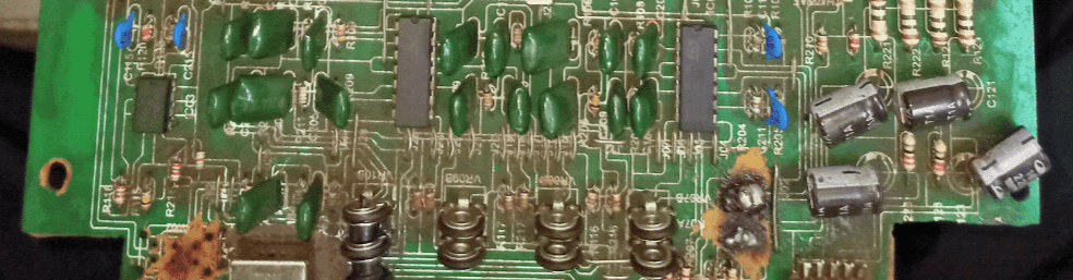

Car Amplifier have power but no sound. Please help me
You 'think' the jumper is fine?
^^ Why not confirm?
Remove the op-amp that was heating up.
Remove the shorted Zener but don't power up the amp without it.
You stated that both large resistors were 150 ohms. Do you read 150 ohms across each one while in the board?
Has the rail voltage changed from ±18v?
What was the 12v supply voltage when you read ±18v of rail voltage?
Please answer all questions.
Thank you brother. My amp is working now and the problem was in the two TL074CN op-amp ICs.
I can't find these op-amps near me but I will replace them soon but after removing them temporarily the rest of the channels are working now.
This wouldn't have been possible without your help, you taught me a lot about amps. Thank you.
Have you removed 100% of the brown fixative that's been applied to some of the various components?
Yes.
What's the DC voltage on all of the output terminals of the op-amps you replaced?
30V In the right side and 0.25V in the Middle one and 0.25V in the left side's small op-amp.
