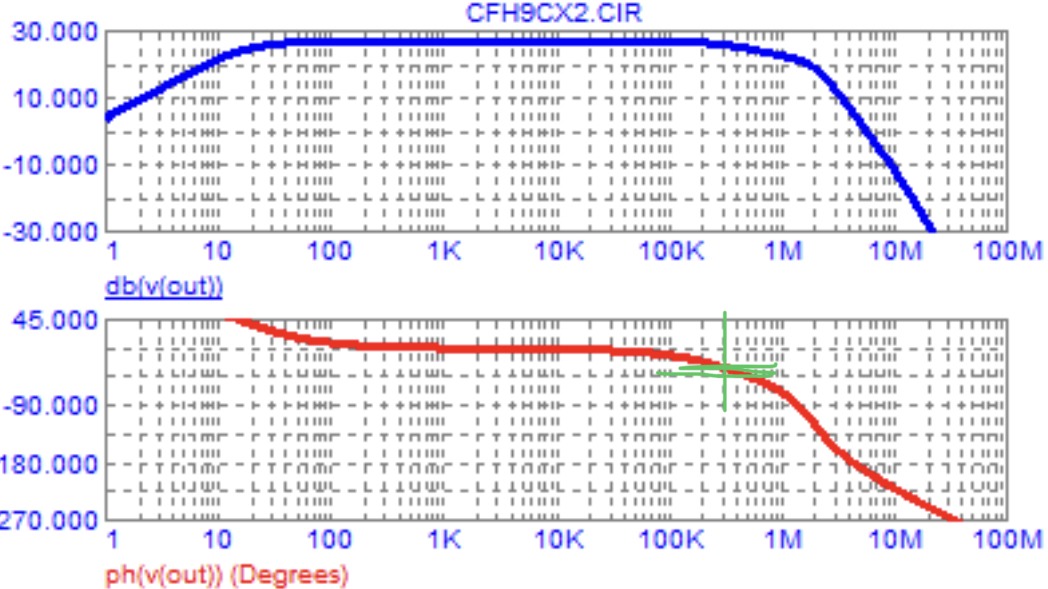

Nice work. Do you have a dedicated thread for your amp? I like low group delay on speakers. It’s important that group delay produce minimum phase shift in amps up to 300kHz. That’s where human auditory system can detect phase shifts and why amps with flat phase up to 300kHz have great image and soundstage.
The CFH9 could be better but it’s not bad at 300kHz.

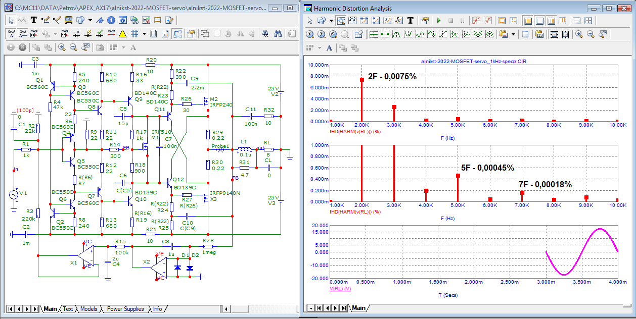

I did not create any branch on this amplifier. The history of the creation of this amplifier is as follows. I was contacted by my friend who bought a vintage amplifier and would like to replace his circuit with something modern with a supply voltage of + -25 V, but not very complicated. Without hesitation, I offered him this option.
Seems it is based on Apex AX17 front end. Looks nice - your FFT distortion analysis should plot excitation at F=1kHz and look at harmonics at 2F at 2kHz, 3F at 3kHz, 4F at 4kHz etc…
At 1W behavior is Class A and looks wonderful.
Not excite at 10kHz, and 2F at 20kHz, 3F at 30kHz which are beyond human hearing.

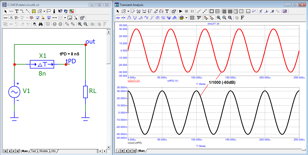

It is easy to see that in order to fulfill David Hafler's SWDT criterion at the highest frequencies of the audio range, the signal propagation delay time must be equal to only 8 ns.
Most amplifiers covered by negative feedback have a signal propagation delay time from 200 ns to 1.5 ... 2.5 μs. With such a signal delay, the sound quality does not depend on THD.

Another original test was proposed by David Hafler - the SWDT test ("straight-wire" differential test). As a quality criterion, Hafler proposed a difference signal of no more than -60 dB at the highest frequencies of the audio range, and no more than -70 dB in the rest of the range. However, this test also has a weak point that Hafler himself did not pay attention to. To reveal real distortions, it is necessary to use signal bursts, a triangular signal with a frequency of 10 kHz, or a square wave signal as test signals. What does -60 dB SWDT mean at 20 kHz. With an output voltage amplitude of 30Vpk, the SWDT signal should not exceed 30mVpk.
The figure presented in the previous post shows that in order to fulfill this condition, the delay should be only 8 ns (coincides with the conclusions of Kirill Hammer).

Our ears can hear maybe 2usec phase shifts. This corresponds to delays introduced by asymmetric folds of the ear (pinna) and helps us to locate sound position even with one ear. This phase delay corresponds to sounds up to 300kHz. I don’t think an amp needs to have 8ns propagation delay time. That’s how far signals in cables travel in about 8 ft. Speed of light is 11in per nano second. You can’t hear that effect - it’s in the microwave / RF region circa 125MHz.
Where does the information about the frequency of 300 kHz come from? If possible, please provide a link to the source. Or are these your personal observations? In order for the phase to be linear up to 300 kHz, the bandwidth of the amplifier must be an order of magnitude higher, i.e. 3 MHz, which is difficult to implement in practice.
