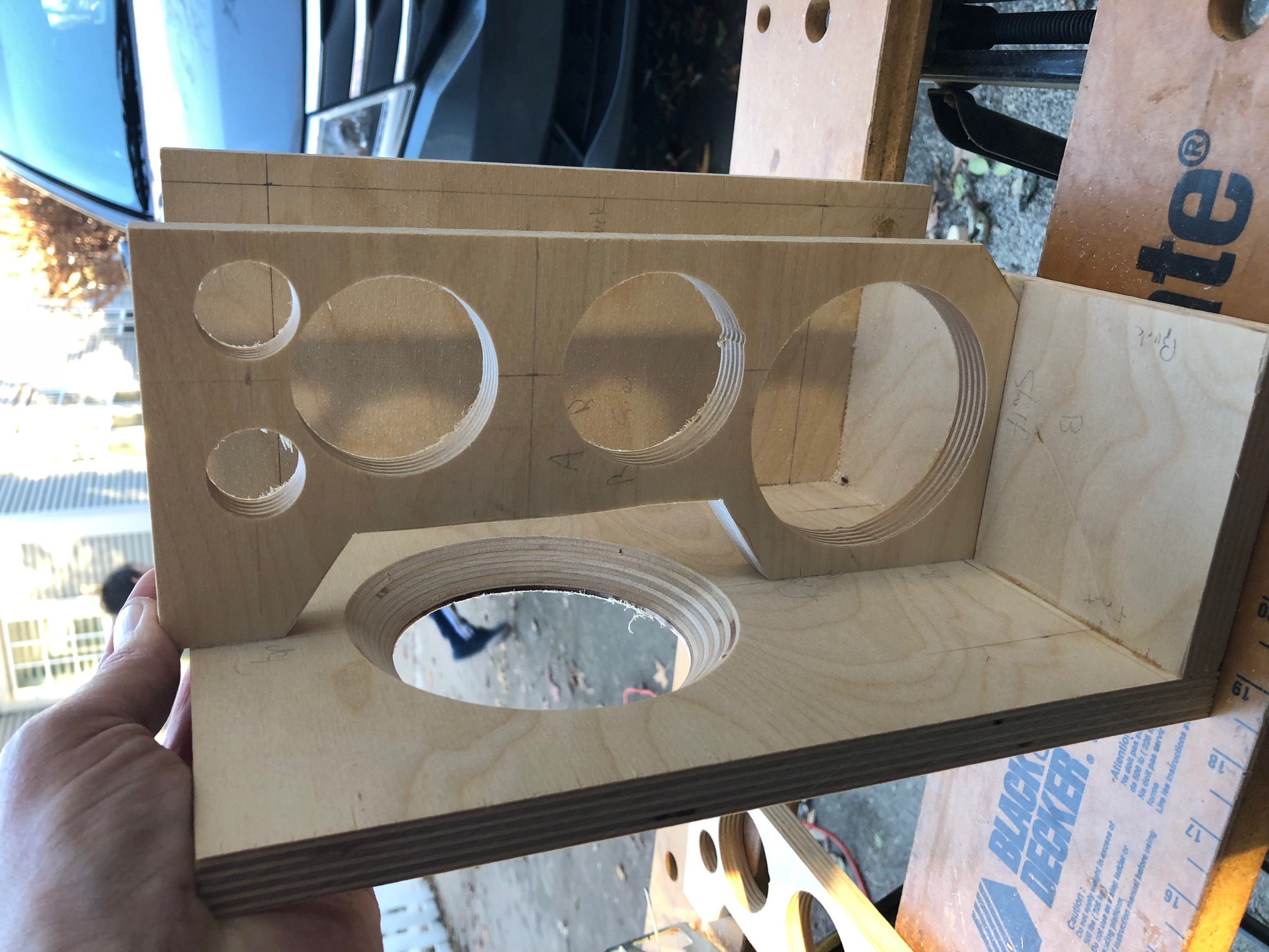

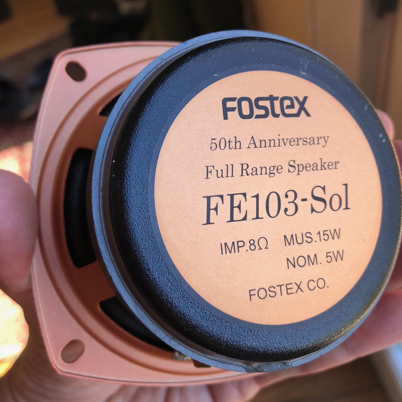

I'm part way through a build of the Classic Golden Ratio Fonken for FE103Sol. Tomorrow I'll cut the internal brace holes and will then apply damping material (wool batting) to the interior walls.

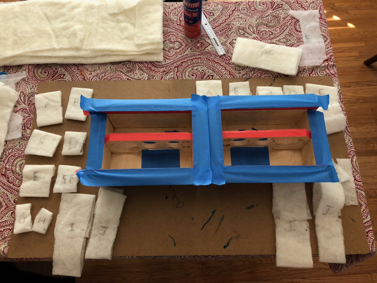

Should damping material go on the front baffle? In the Baby Labs plans it doesn't, but this one has more surface area and the instructions give no particulars on that.
Also, for the thinner polyester batting that goes on the center side of the brace, should I cut it out where the holes are or just lay it over the whole thing, covering the holes? There was some debate about that in a fonken build thread involving Chris but I can't find it right now.

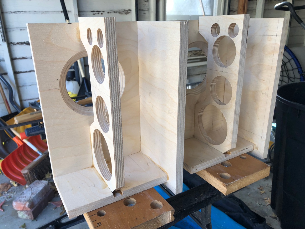

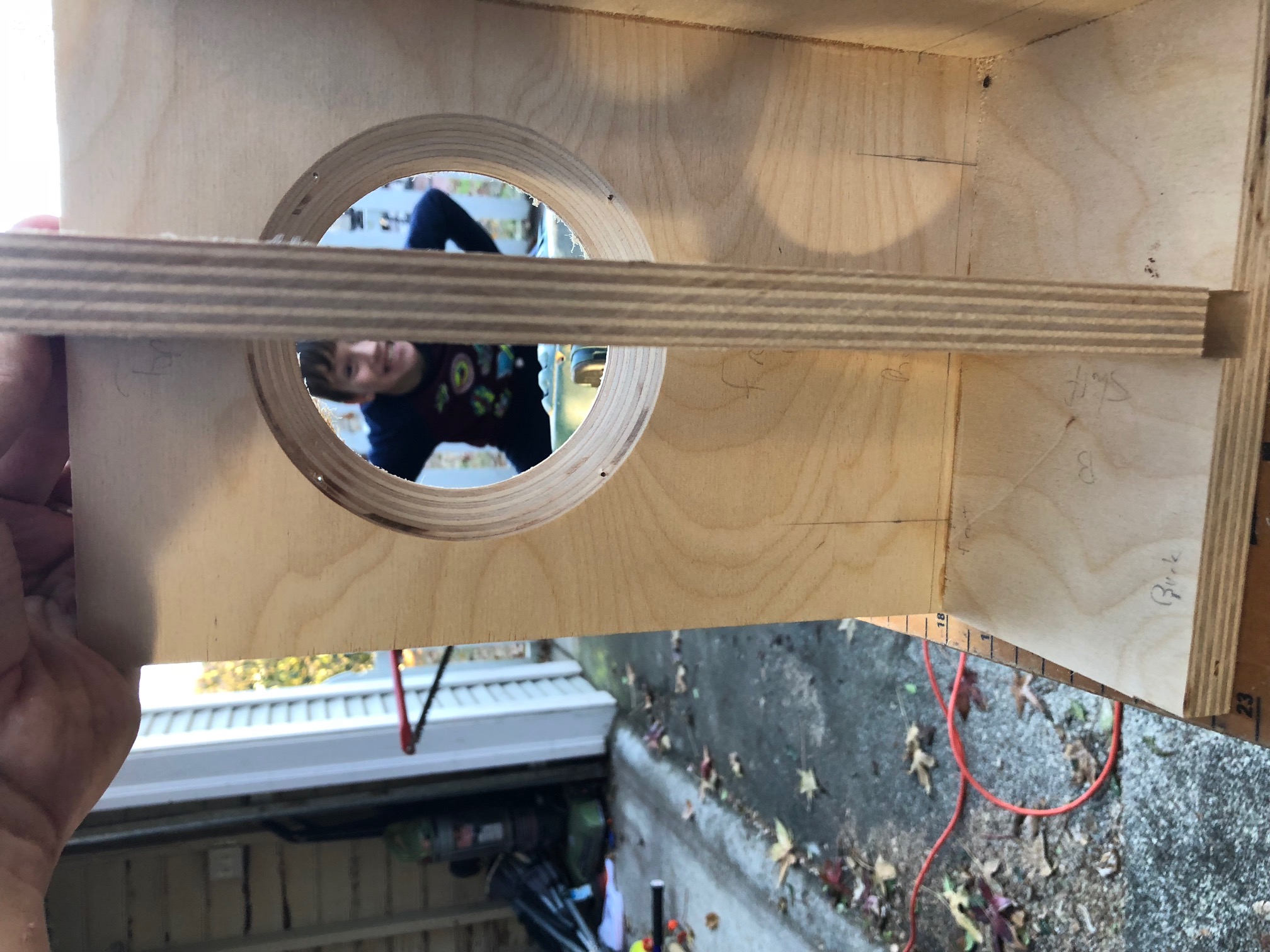

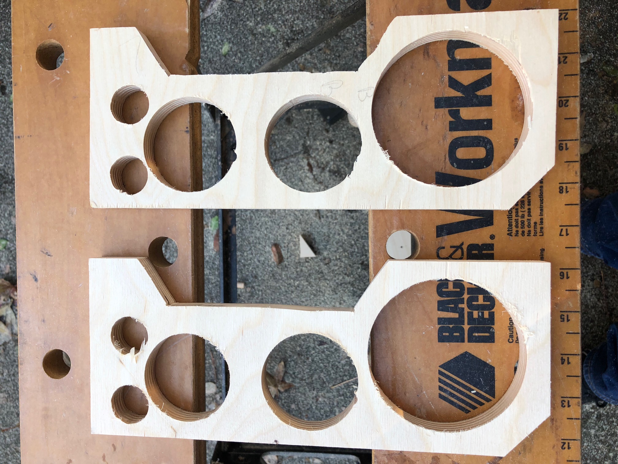

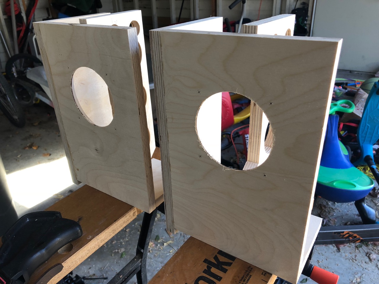

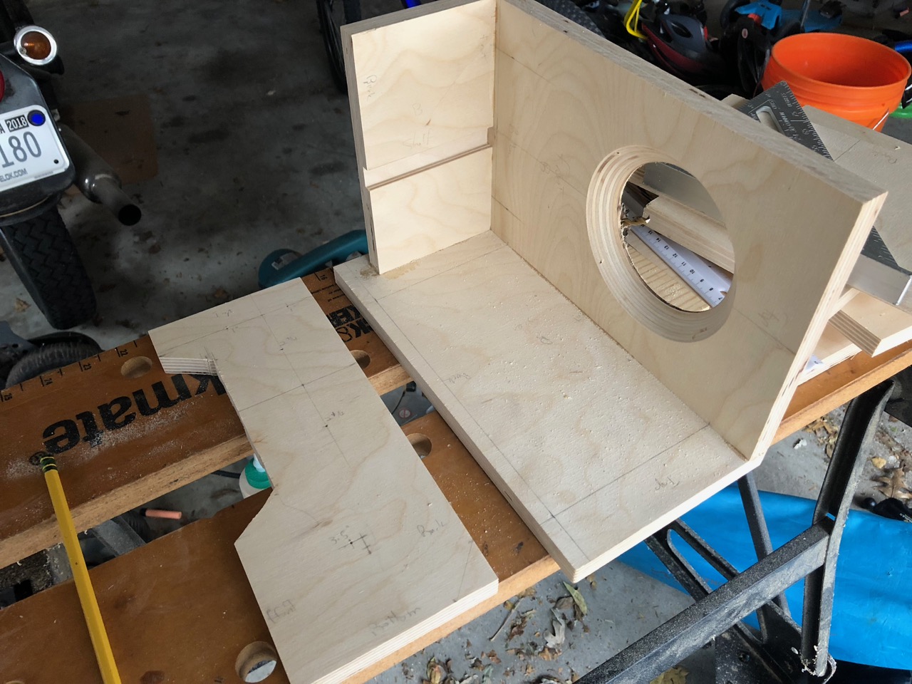

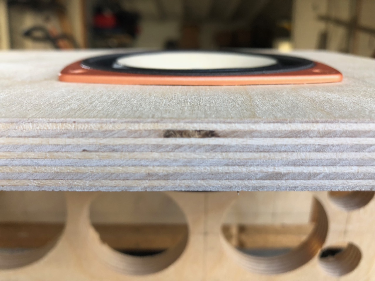

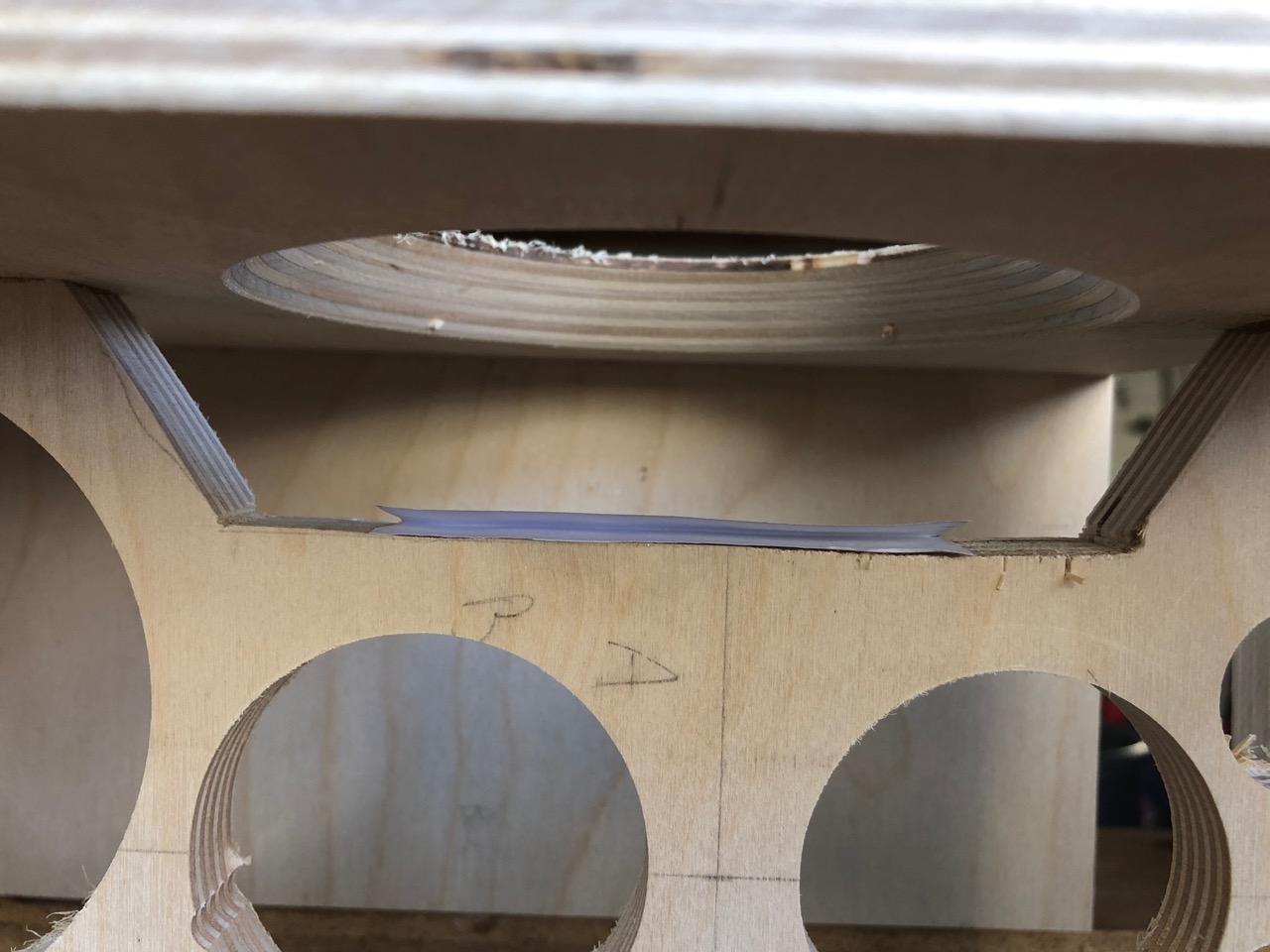

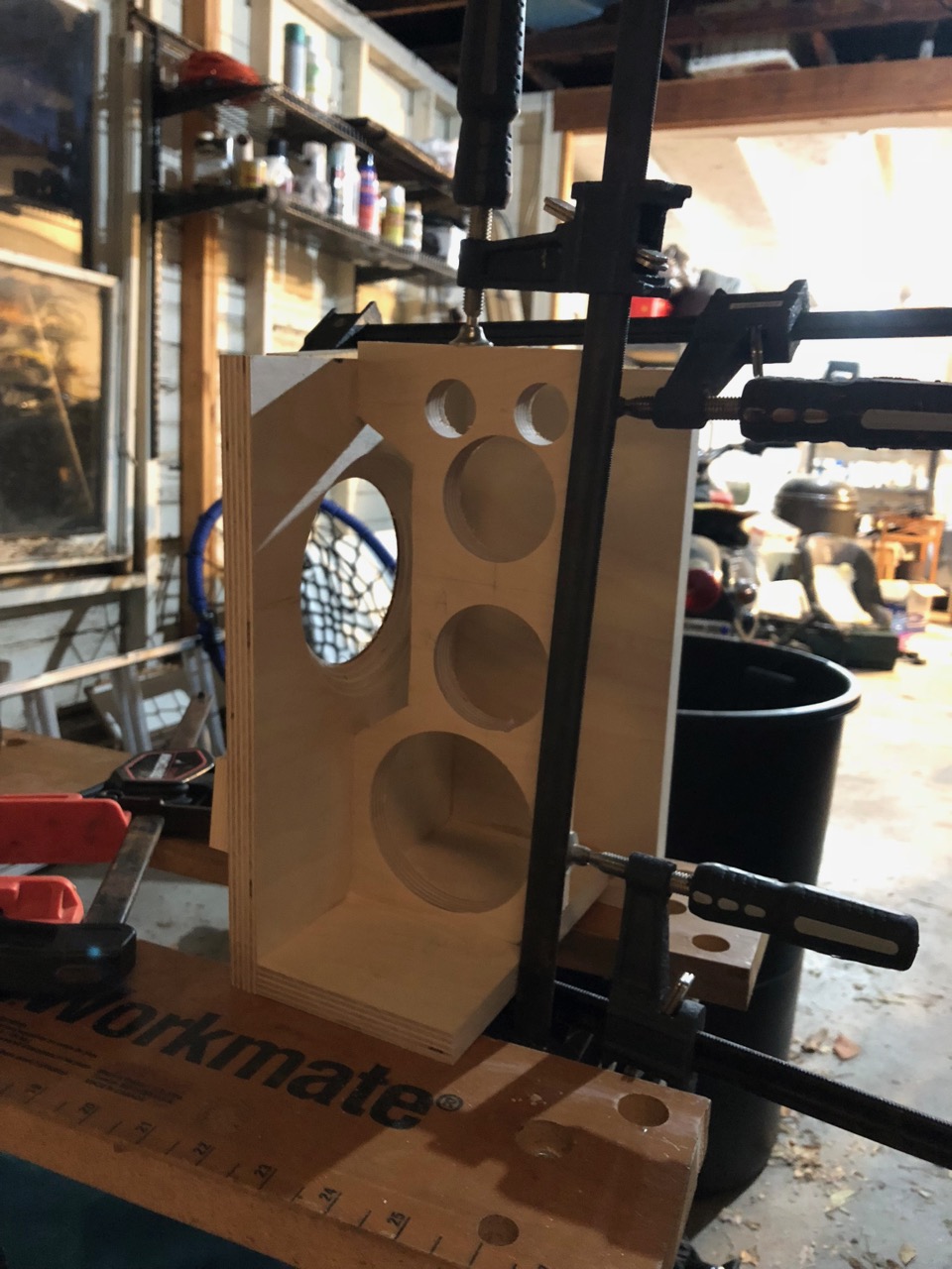

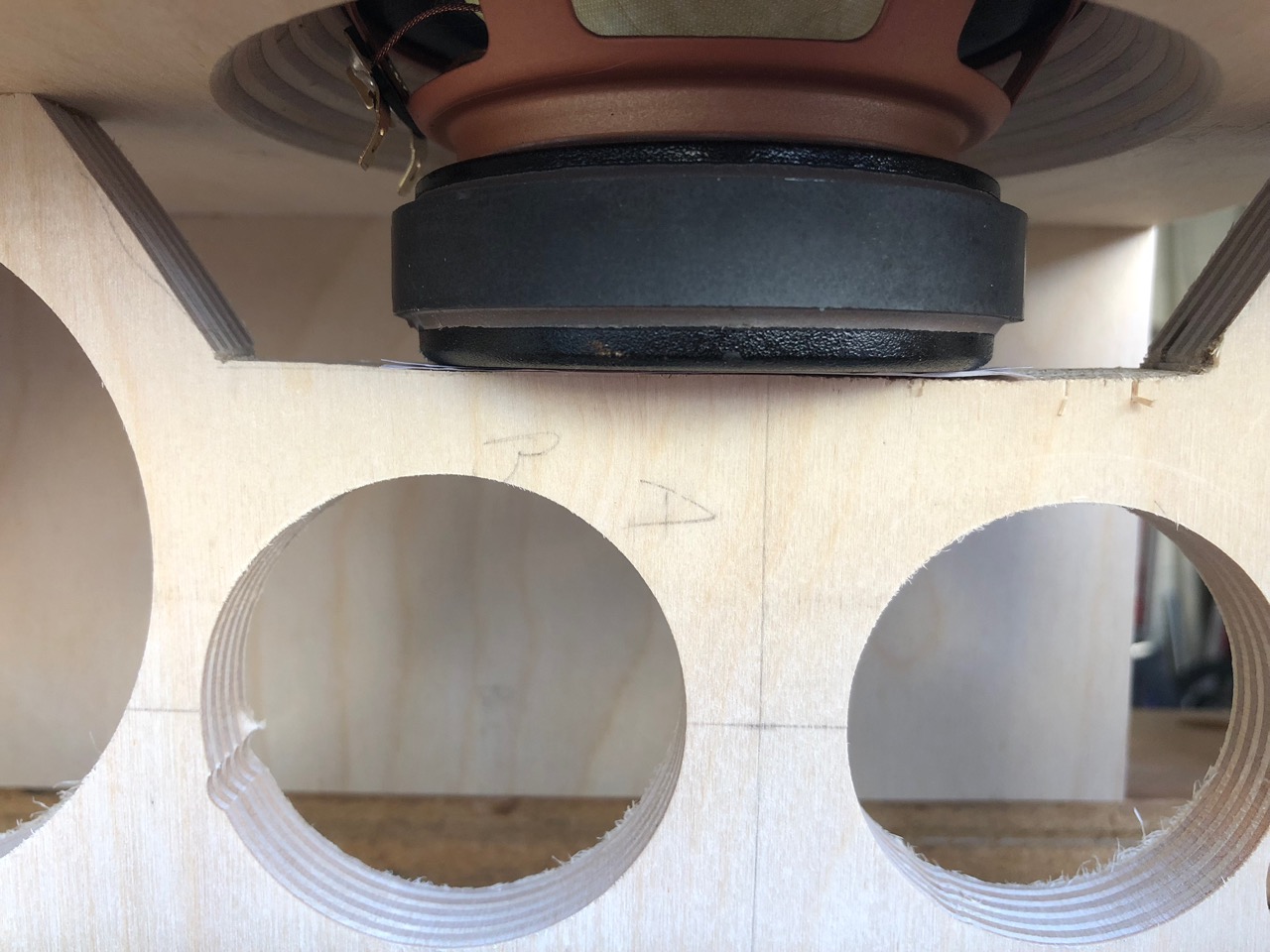

Managed to cut the brace holes and driver cutouts yesterday, and will glue the brace today. Using a jigsaw, I was unable to fit the cutouts exactly to the back of the driver, so I'll have to insert paper shims.
The holes are 1", 2 1/4", and 3 1/2", cut with a router and circle jig, following the plan as close as possible. Would there be any advantage with a roundover on the hole edges (or at least those that are far enough apart)?
Also, I plan to line the interior front baffle with wool batting, unless you think that's too much.

Yes, dsmping on the baffle (but not such that it gets in the way of the back of the driver). Do not cut out the holes in the damping on the holey braces. It is over the holes that we really want it — the peak of any side-to-side standing wave is in the exact centre, so the most effective place for the damping is right there.

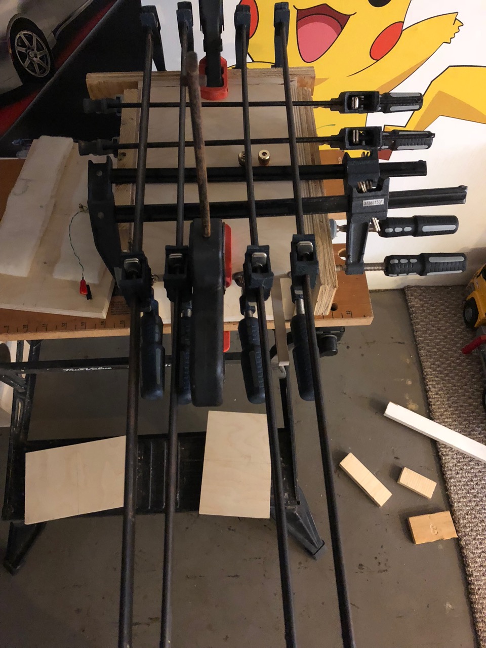

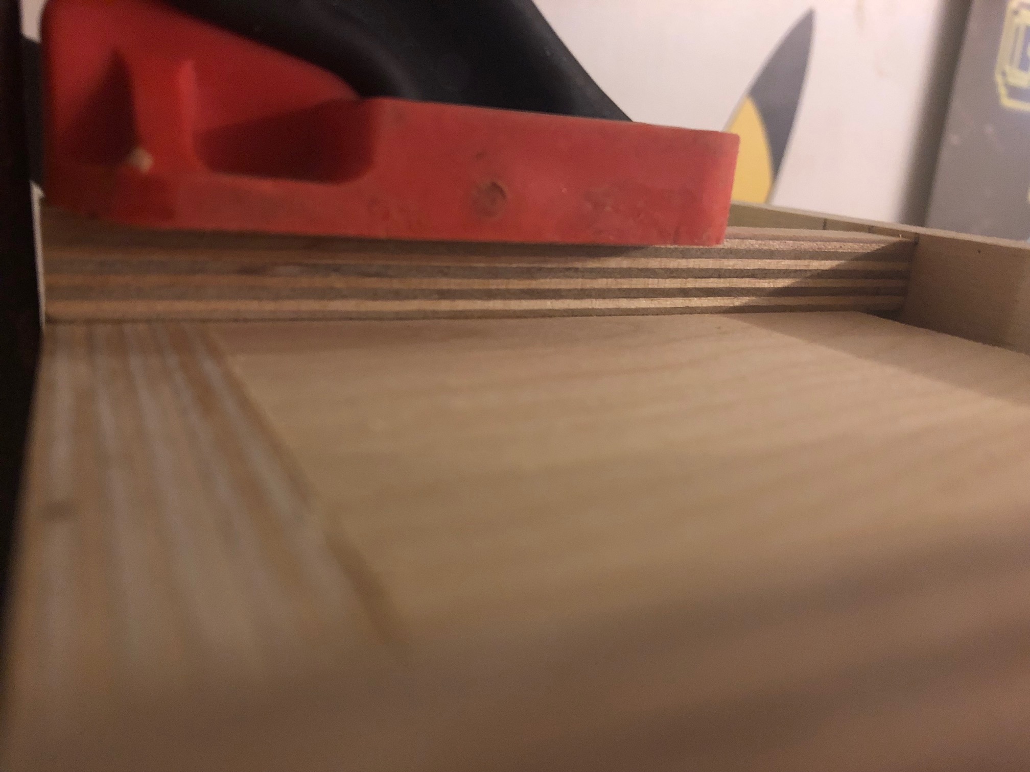

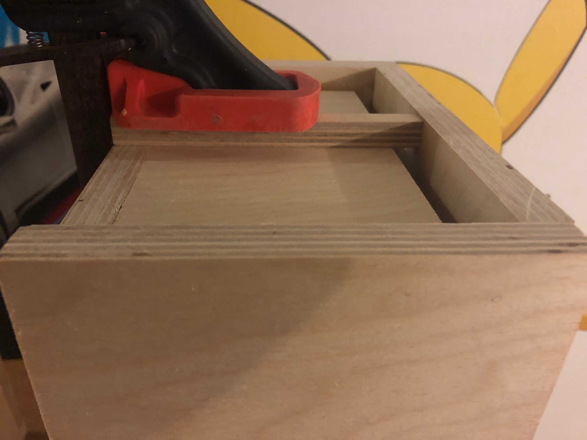

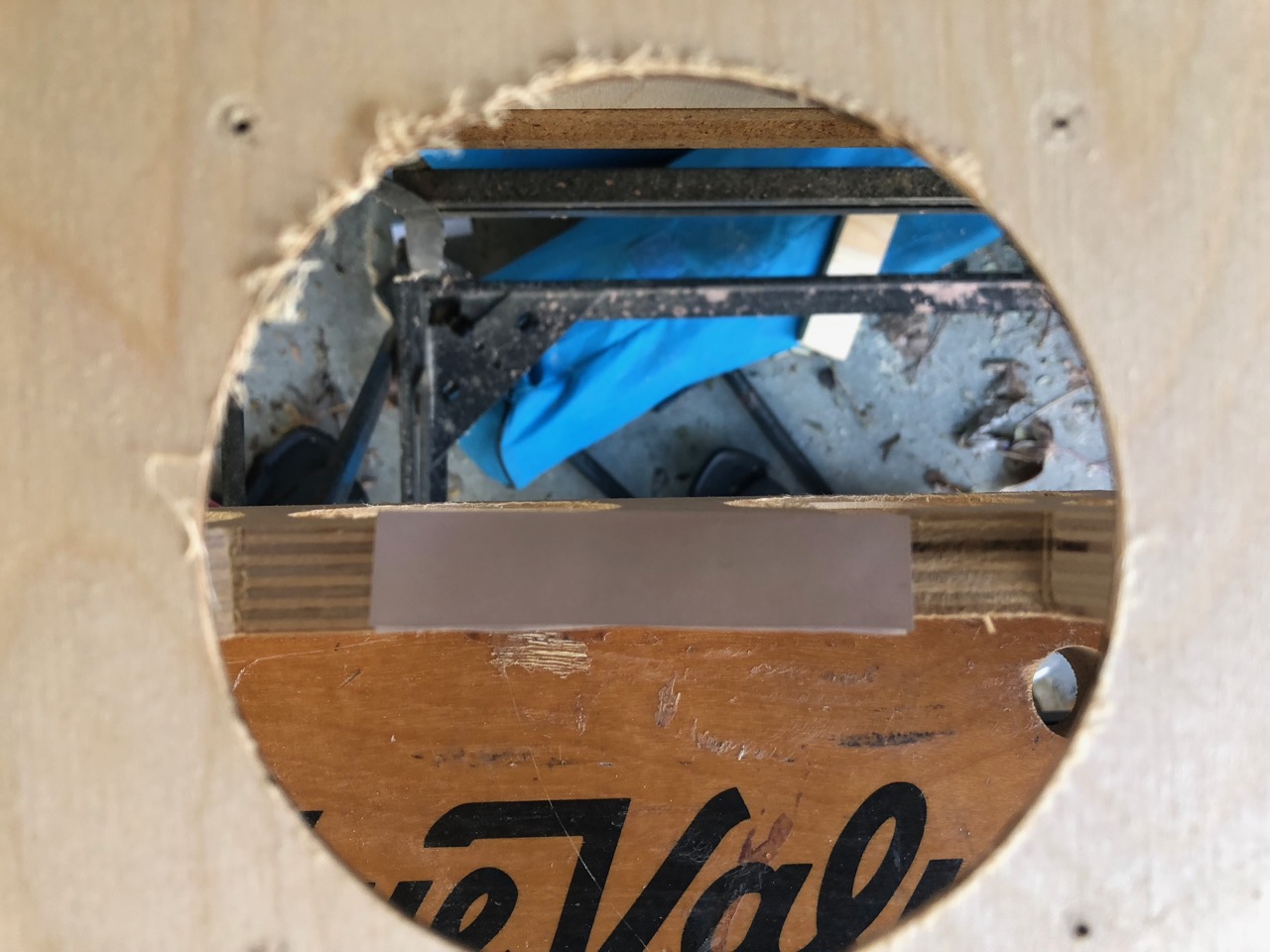

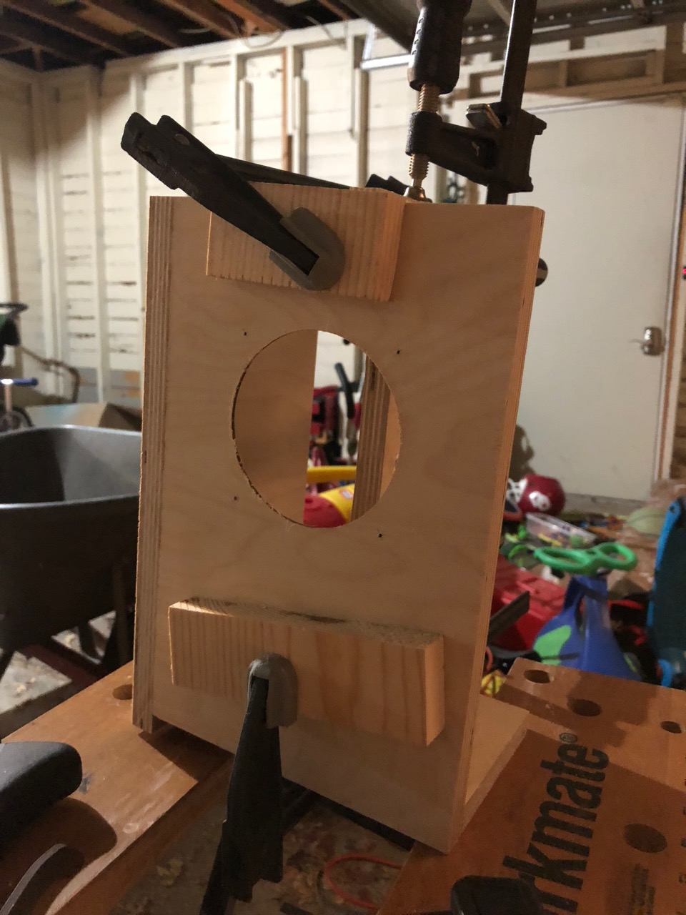

I glued the baffle, shelf, brace, and one side of the second speaker, and then fitted paper shims to each brace.
For each shim, I cut a piece of computer printer paper 3 3/4" wide to allow for up to six folds that match the 5/8" brace thickness, and 3" long to more-than-cover the contact length of the back of the driver. I then placed them on the brace and slid in the drivers, removing one fold-layer at a time until the bezel met flush with the baffle and had a tight enough pressure on the paper to make it difficult to pull out. One enclosure required five fold-layers and the other only two because of the slight variations in my hand-cut diver cutouts (I have allocated a specific driver to each enclosure for consistency, just in case).
When I make the driver cutouts in the brace of the mFonken103SolT, I'll be sure to clamp on a fence to guide the jigsaw, to ensure a good parallel contact with the back of the driver. Though it appears what I've done for the CGR will work fine.

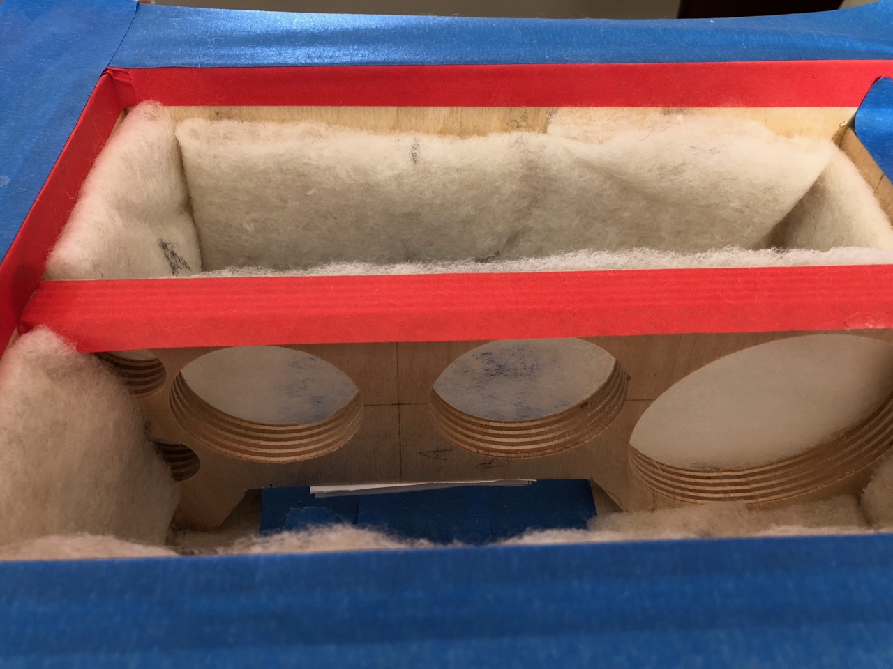

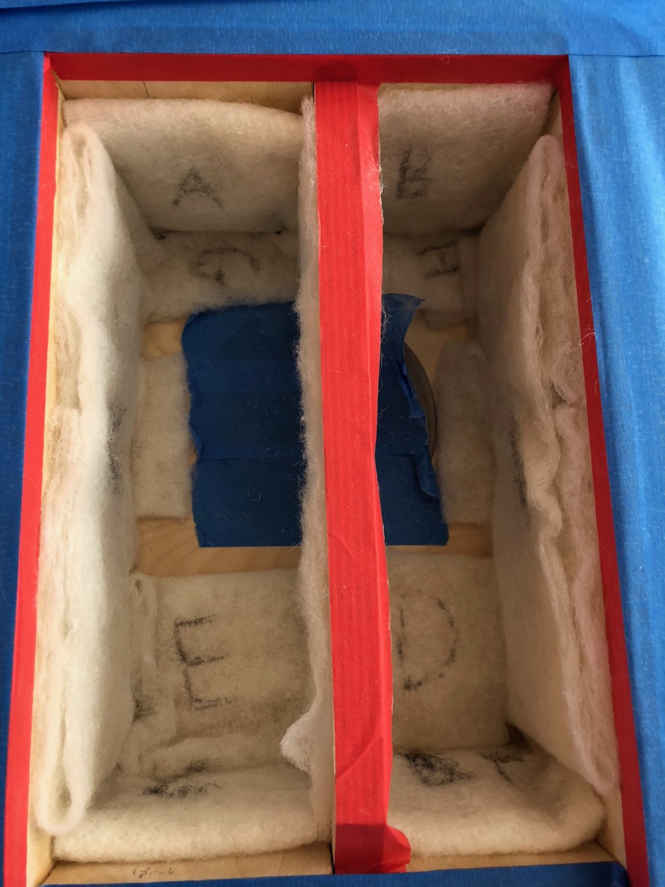

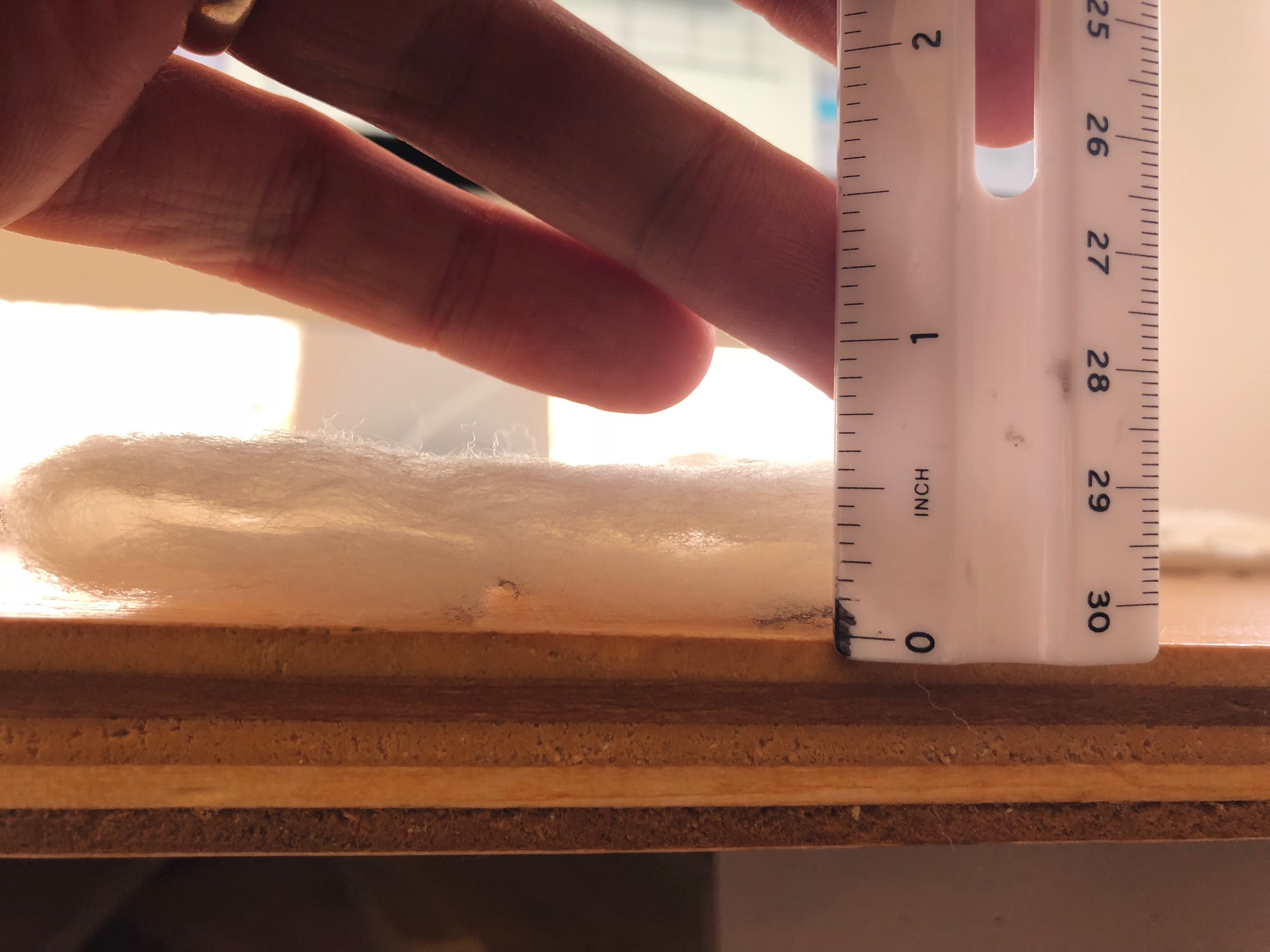

Thanks for that, David. The weather is warming up, so now that I can work outside again I thought I'd apply the lining. I'm using the wool batting that I posted above. When doubled over, it's 1/2 thick as indicated in the plans. However, it's also very light and loose, not as dense as the cotton denim lining that used to be available from CSS.
Does this seem OK, or do you think it'd be worth tripling the layers (or more)?

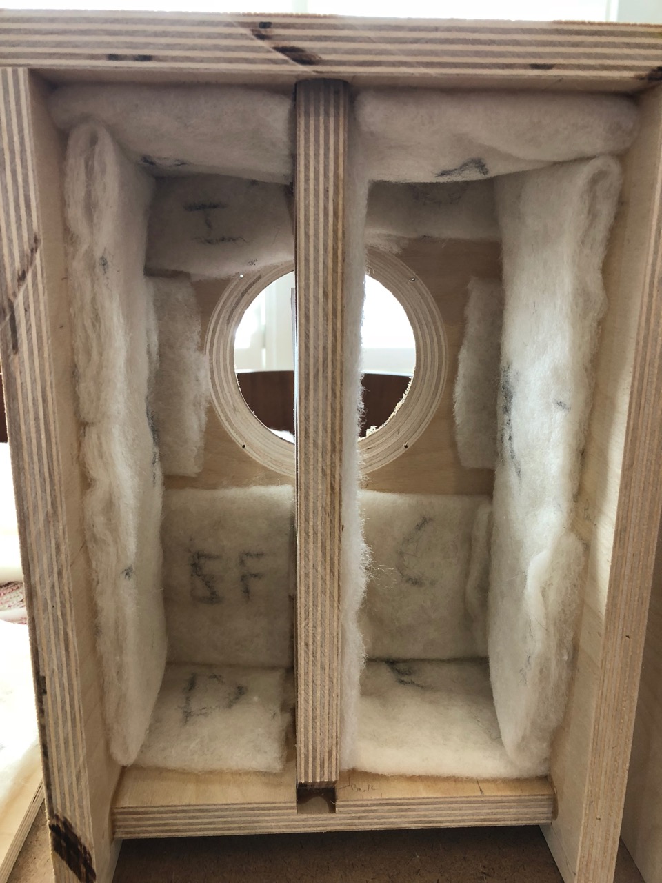

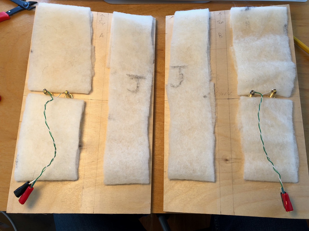

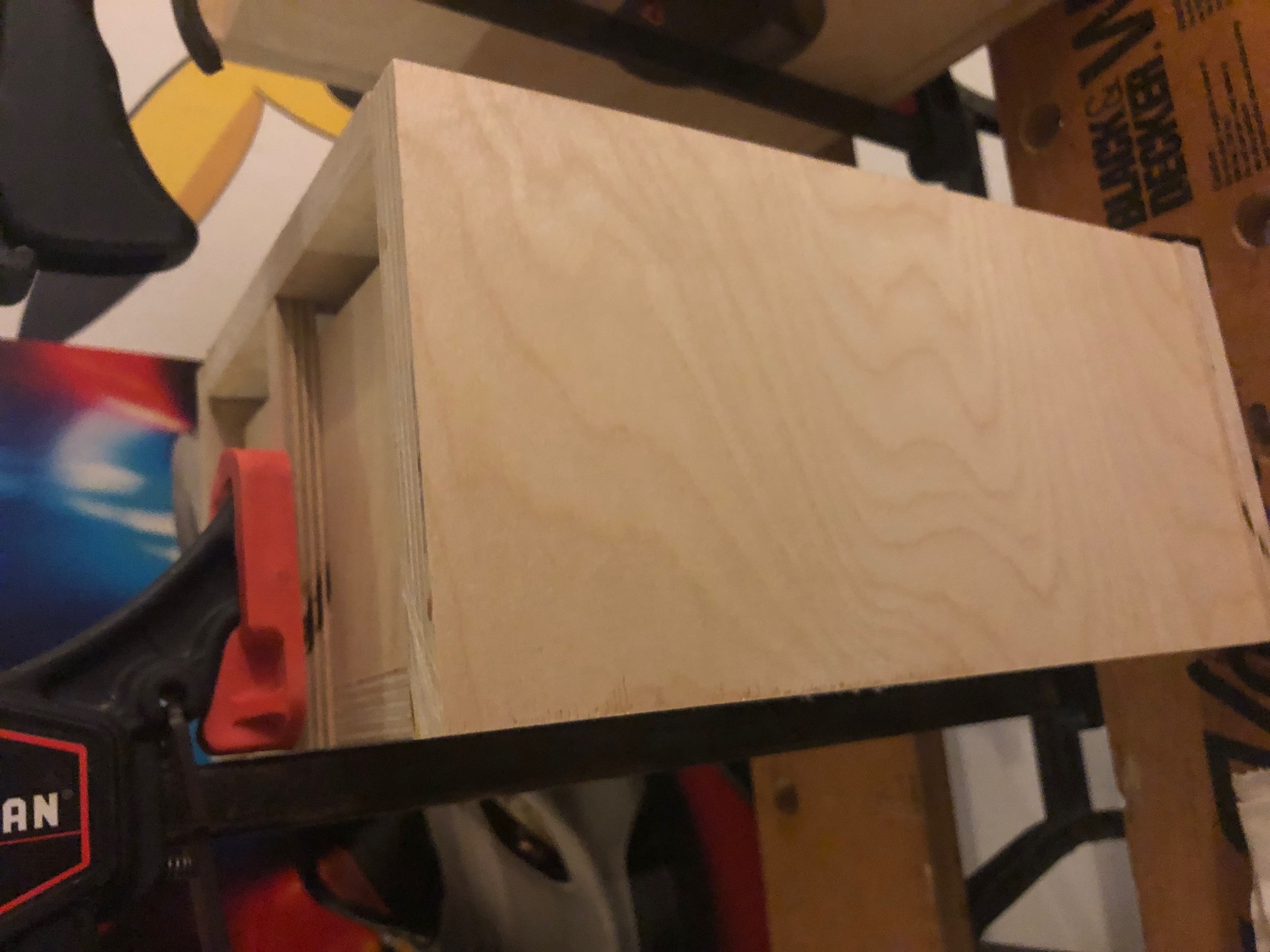

Today I installed the lining, soldered the wires (24 AWG solid copper CAT5E) and quick disconnects, and glued on the back panel of speaker A. I used painting tape to cover the driver openings, all the edges that will take wood glue, and to to protect from over spray.
I cut the wool batting strips for twice the length of coverage, and then folded them under so that the ends meet in the middle where they adhere to interior wall. That way they adhere securely while having double thickness for 1/2" indicated in the plans. It looks to be a good depth and sounds totally silent when I stick an ear into it.

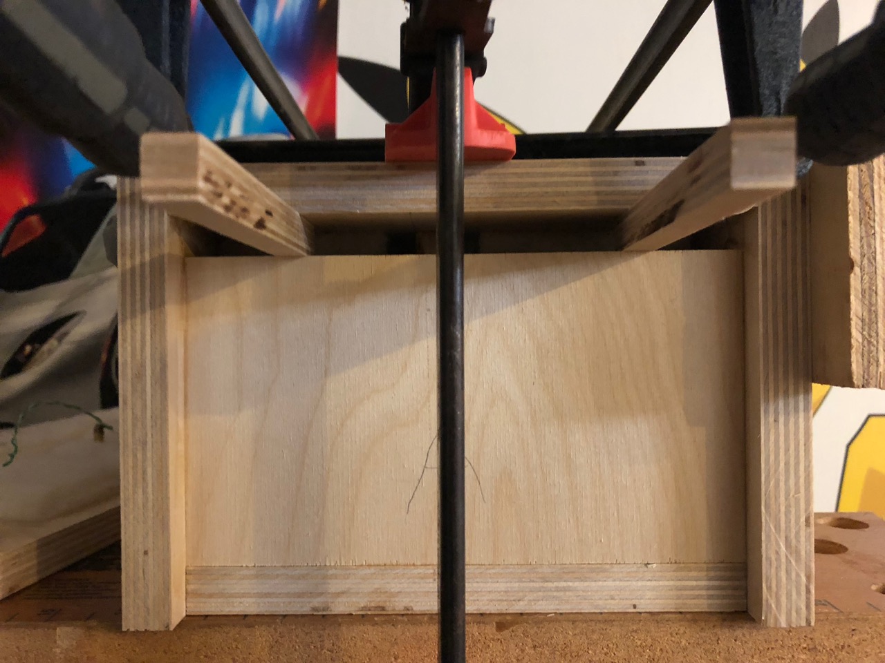

When gluing the back panel, I used the 12mm thick spacers to keep the rear opening at the correct depth.
Also, while working with the wool batting, I noticed that the material in the middle of the sheet seemed thicker and fluffier than the material at the periphery. When I make the mFonken103SolT I'll use material from the middle.

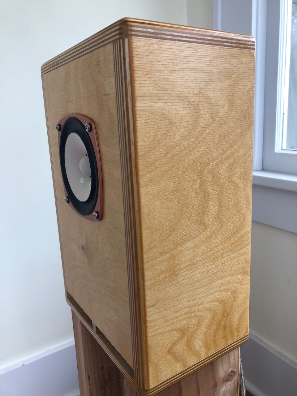

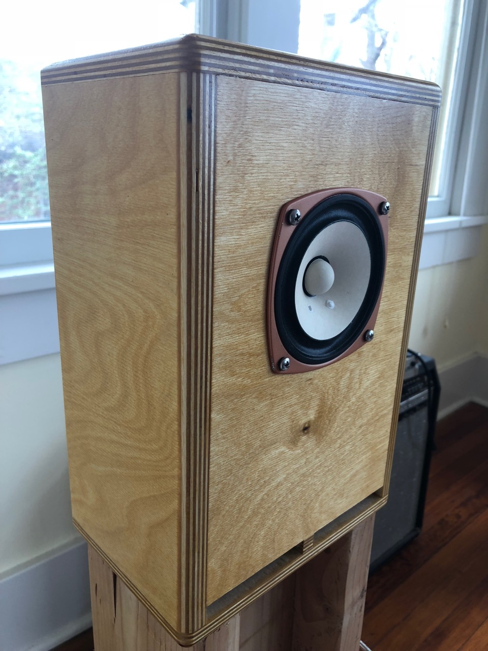

Vent spacers under clamps right now. In a few hours I'll glue the bottoms in place. Then the internal battle over whether to listen tonight or complete the finishing steps first.

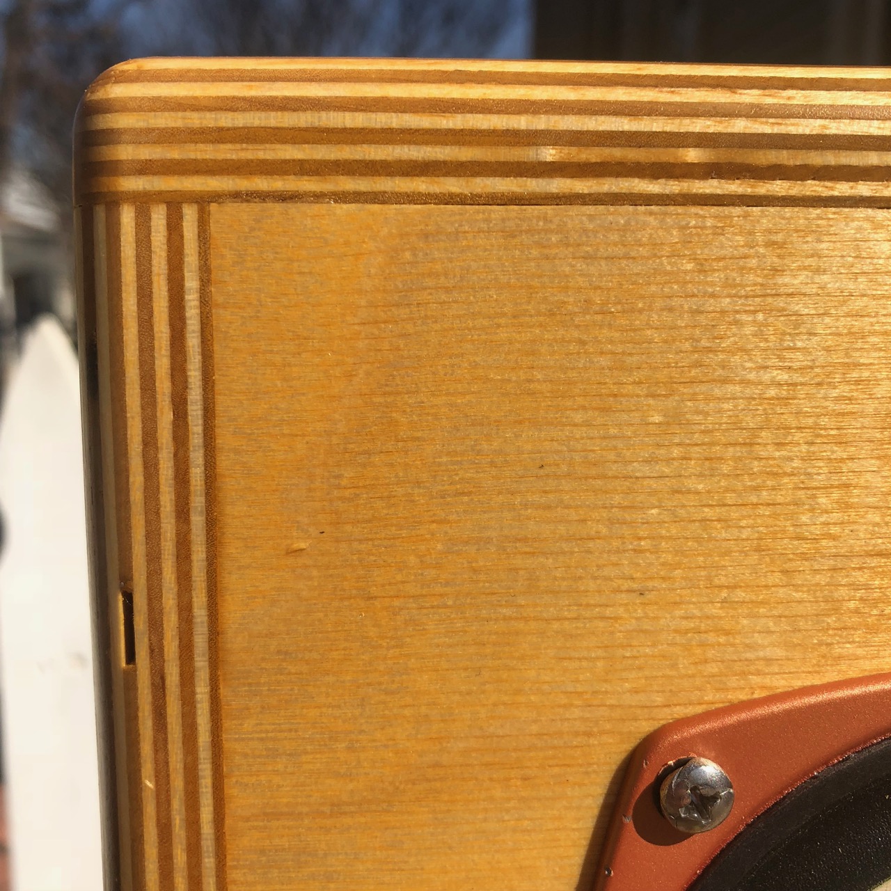

These are going to be trimmed and sanded, with a 3/8" roundover on all edges, sanded glass-smooth, a coat or two of Watco Golden Oak Danish Oil, and possibly a coat of satin polyurethane.
If anyone has tips on finishing baltic birch plywood, I'd appreciate it. Here's the procedure I usually follow, but I'm very open to trying something new:

This procedure looks great from a couple feet away, with a rich color and nice pearlescence, but close inspection often reveals streaks of the golden color that are visible in the grain or in those shallow straight-line cracks that seem to be a result of the baltic birch manufacturing process. If anyone has suggestions on preventing that I'd appreciate it.
I thought of possibly sanding at 120 grit again after raising the grain or using a pre-stain wood conditioner first. Not sure if the pre-stain would work with Danish oil, since I think the Golden Oak pigment is actually a stain but I could be wrong.

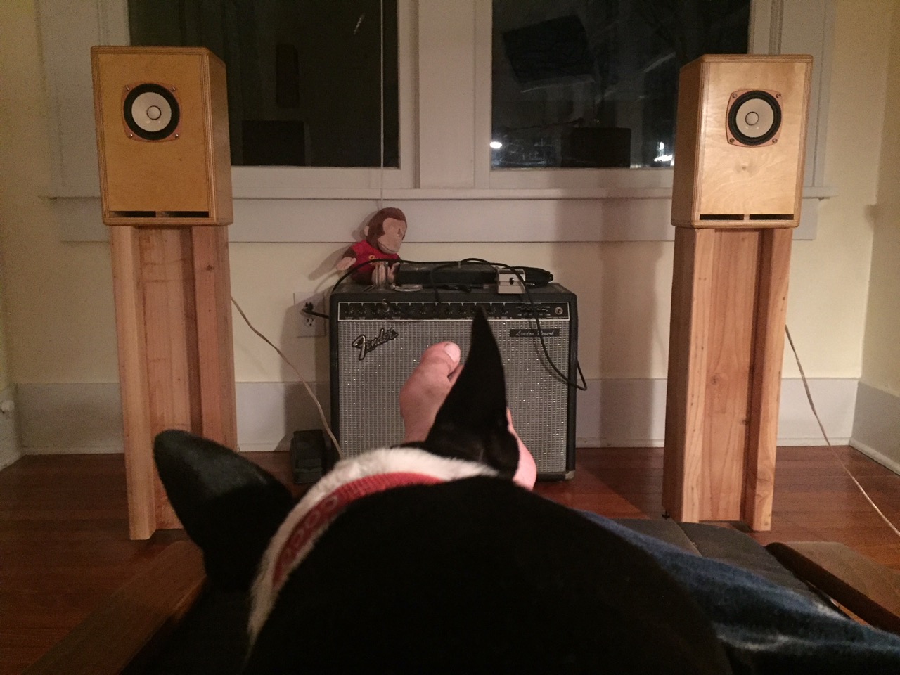

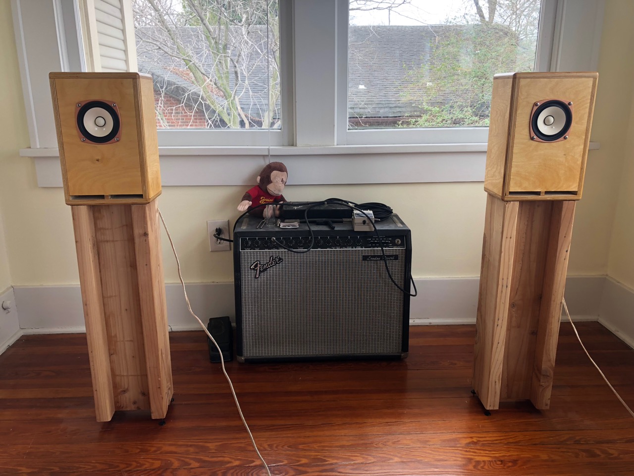

First impressions are very good. These speakers have a lot of control and detail. However, since I've only had about an hour to listen to them, I spent most of it experimenting with room placement so that I can form a better impression.
The room is 7' 9.5" W x 18.5' L x 9.25' H, with the speakers along a short wall.
I'd appreciate any suggestions for placement.
I tried the golden ratio placement (why not, right?). Nice sound stage but a bit lacking in bass extension, probably owing to distance from the wall behind them (~42"). So I left them at that width (25.81" from side walls and 41.875" apart from each other) and shoved them back so that the driver face is 26" from the wall behind. Better bass but some notable room reflections in that location, so I'll keep tweaking.
I was used to the Shrikes, which have a markedly different signature, so I'll spend time getting used to the CGRs before passing judgment. The CGRs have a more forward sound and give really nice body to single instruments, especially piano and voice. I think the wider front baffle helps there.
Also, I'm using 24 awg solid copper conductors from a run of CAT5E cable and suspect that they might be a bit thin for this application. Luckily the CGRs are shallow enough that I should be able to swap in some 18 awg, which works very well in the Shrikes, without too much trouble should it come to that.

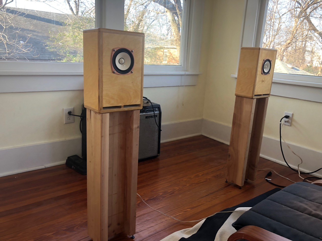

I got the CGRs into a better place in the room (back of speaker 19" from back wall, sides 20" from side walls) and did some more listening last night and this morning. The CGRs just sound "right." Initially I thought they were lacking in bass extension and dynamics as compared to the Shrikes. But after A-Bing them this morning, the only advantage offered by the Shrikes (and I *love* the Shrikes) is a slight amount of further bass extension, but it's a little boomy. What the CGRs offer instead is much more accurate bass, at least as much if not more dynamics, finer accuracy/detail/control overall, and a wonderful presentation of acoustic instrument body/internal resonance. Last night I was captivated by Chopin and Schubert lieder because the piano's internal resonance was entrancing, and the voice even more so.

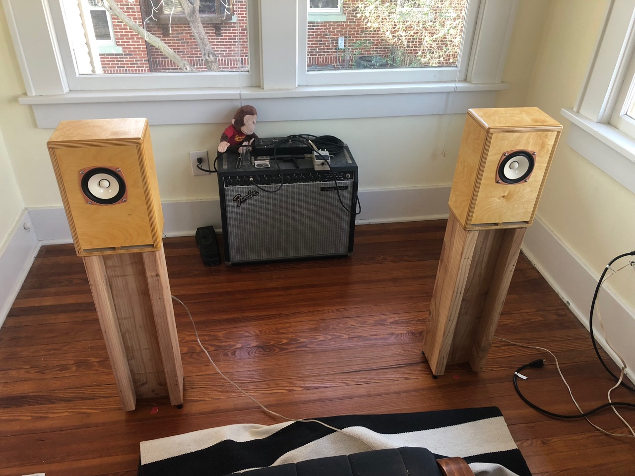

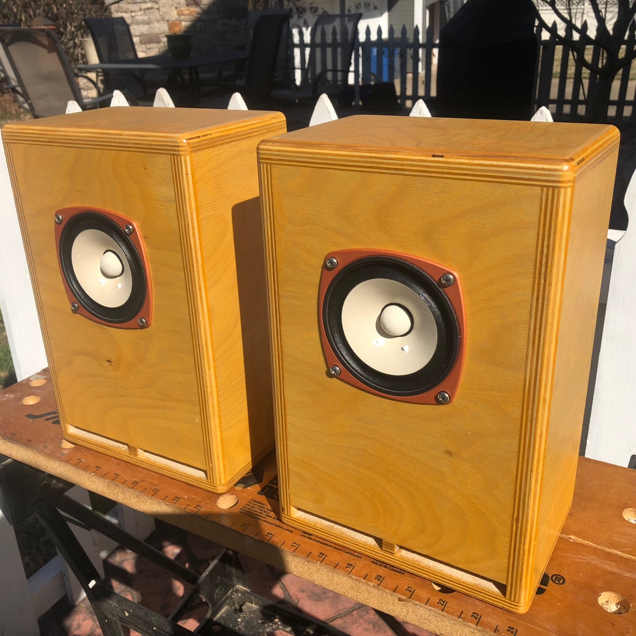

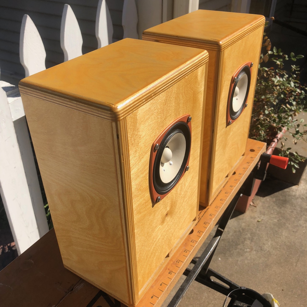

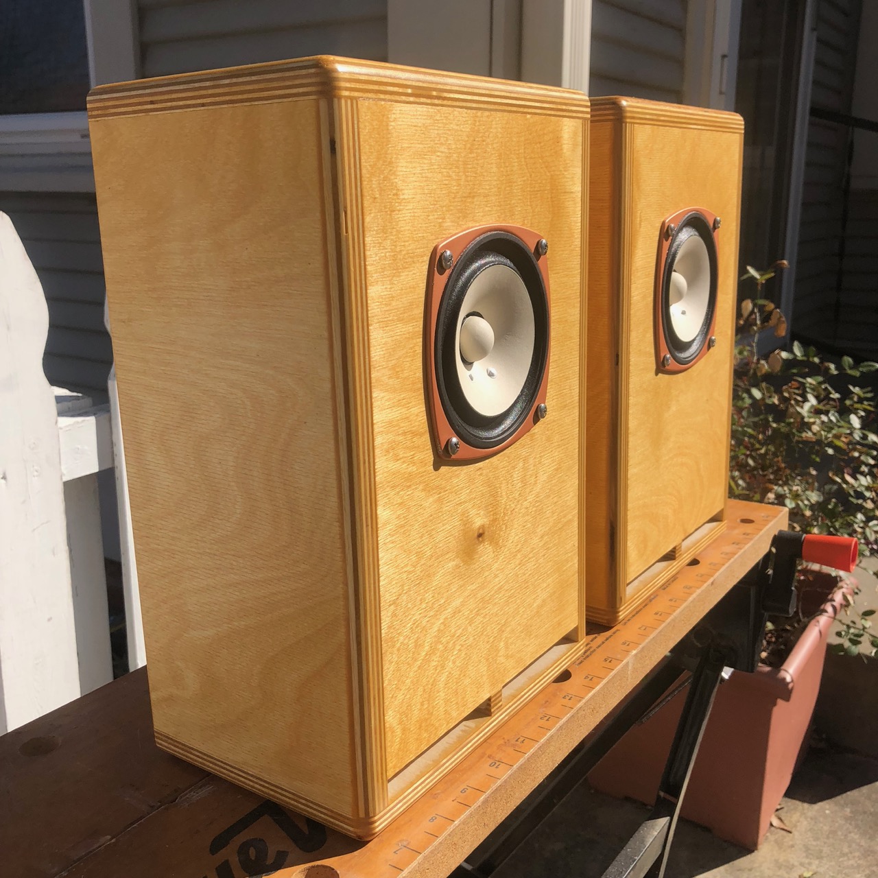

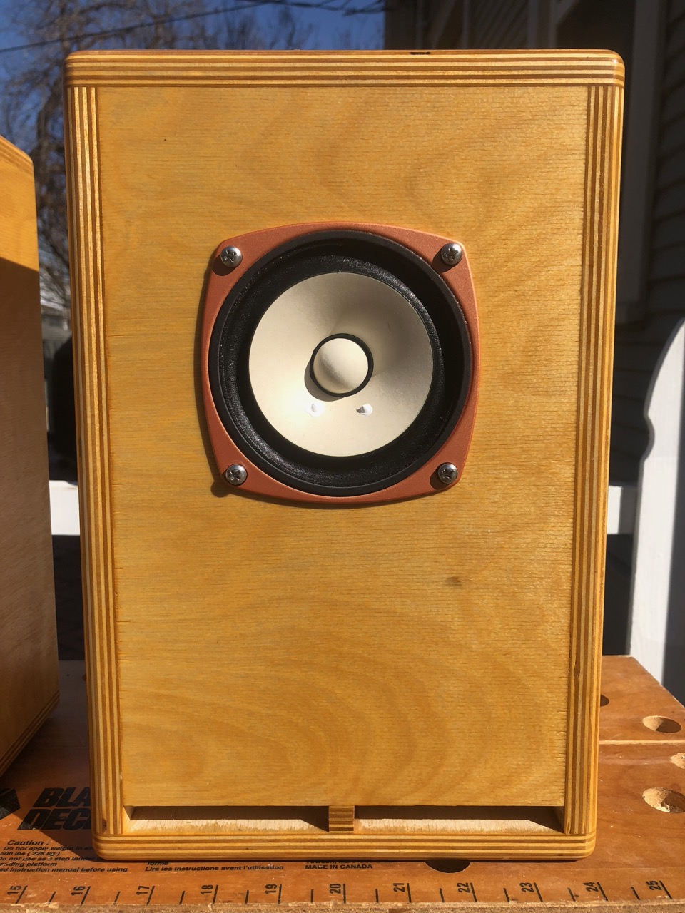

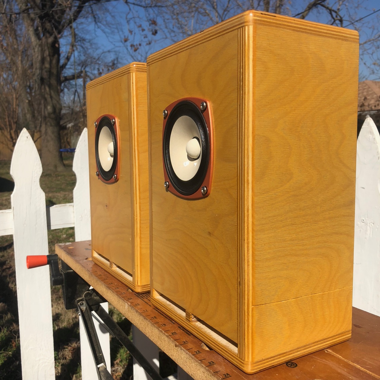

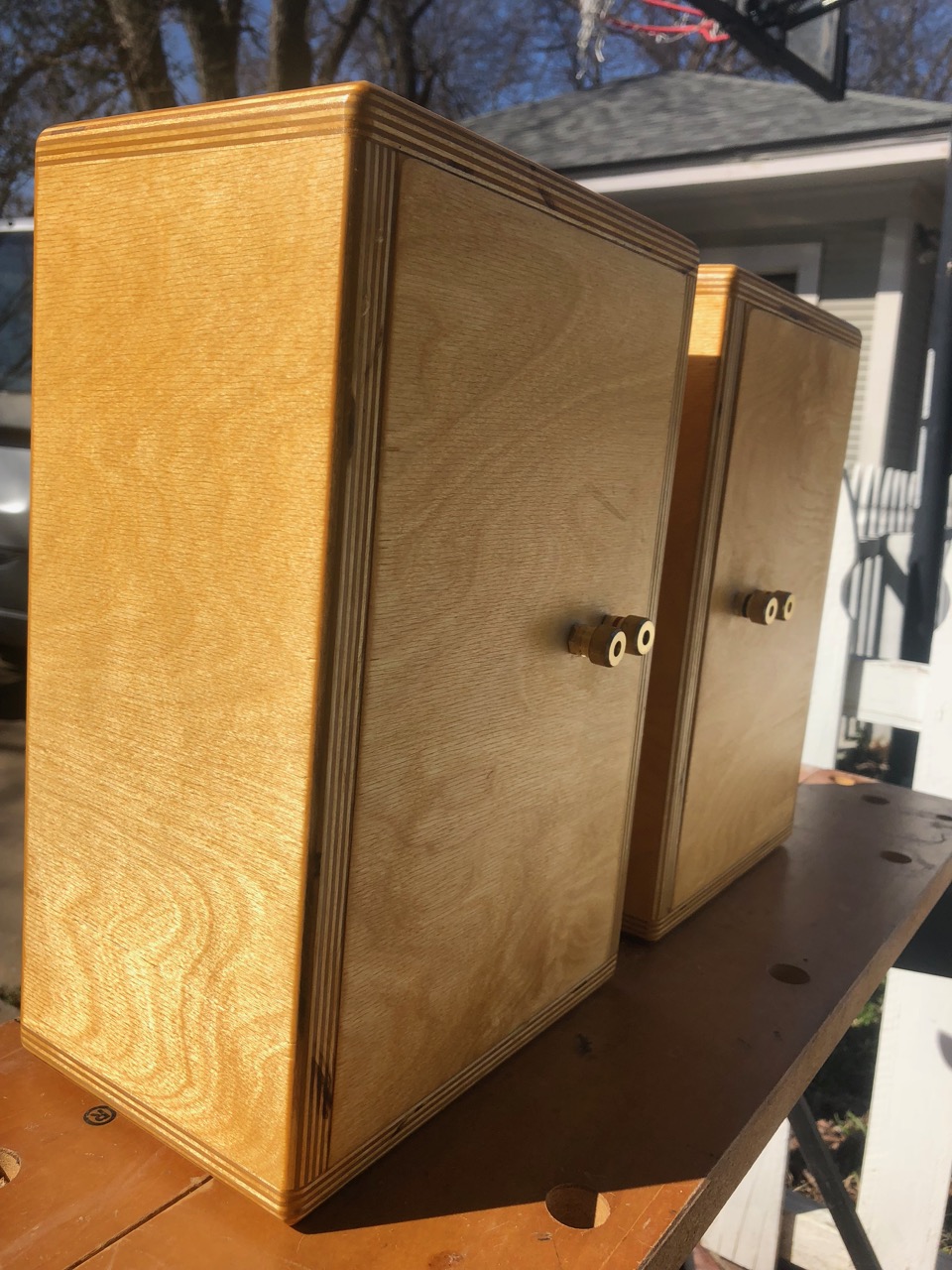

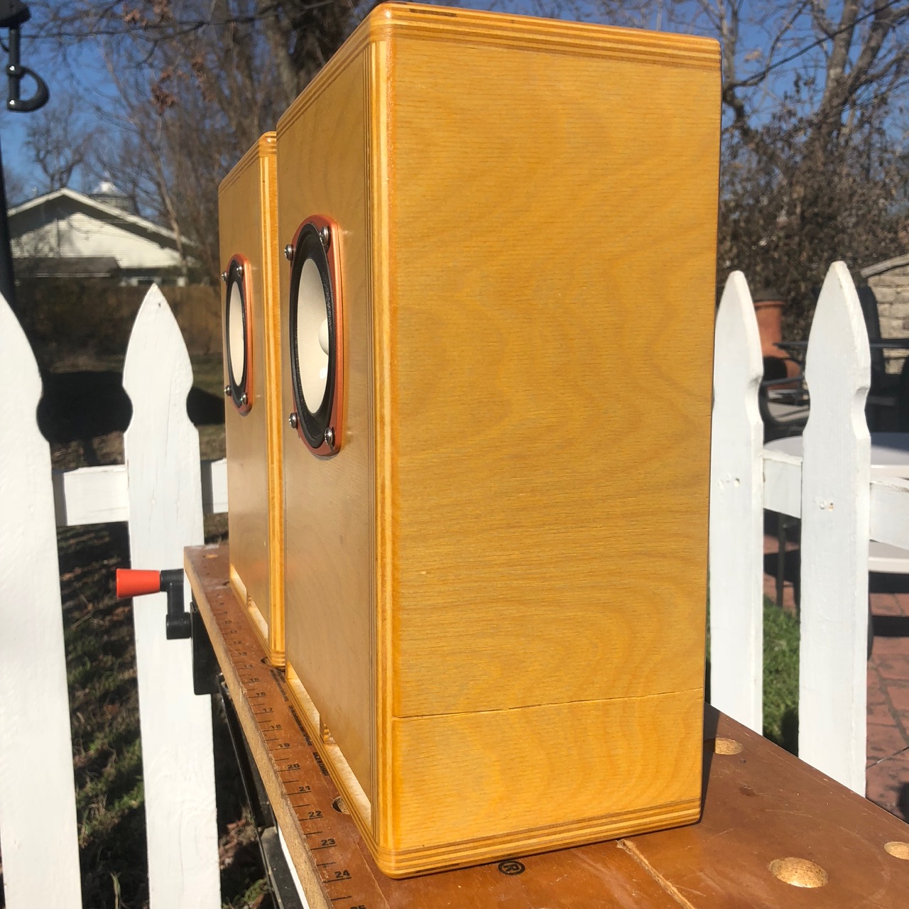

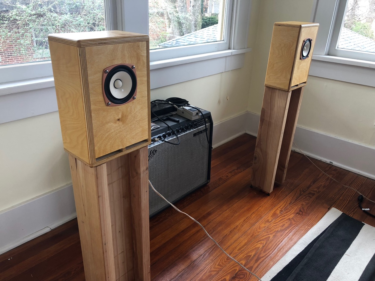

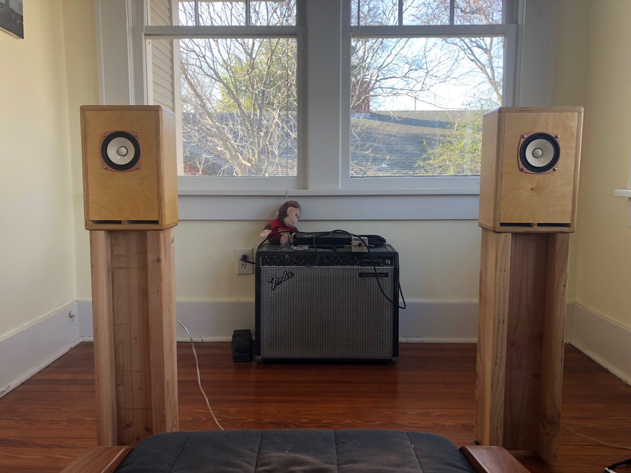

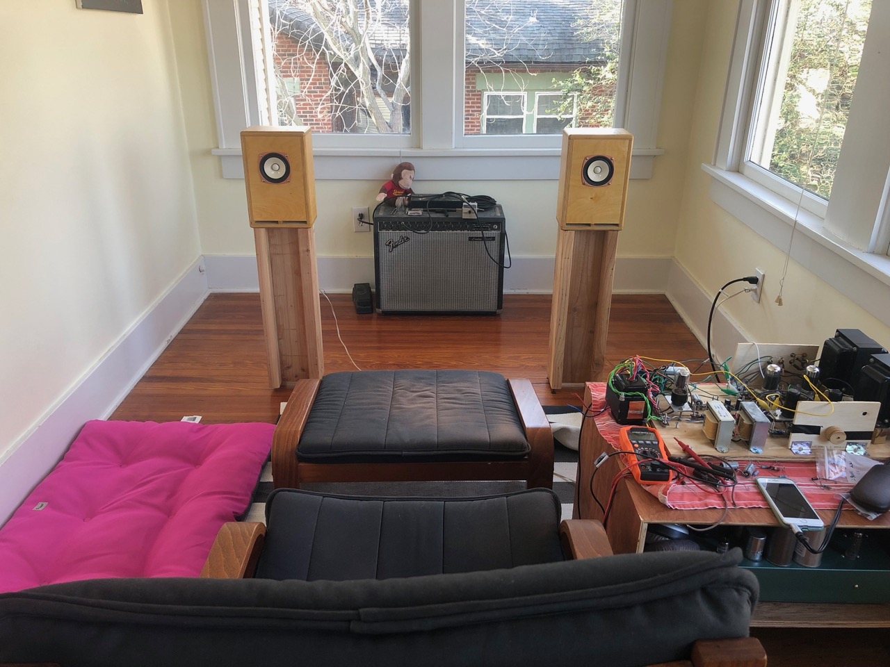

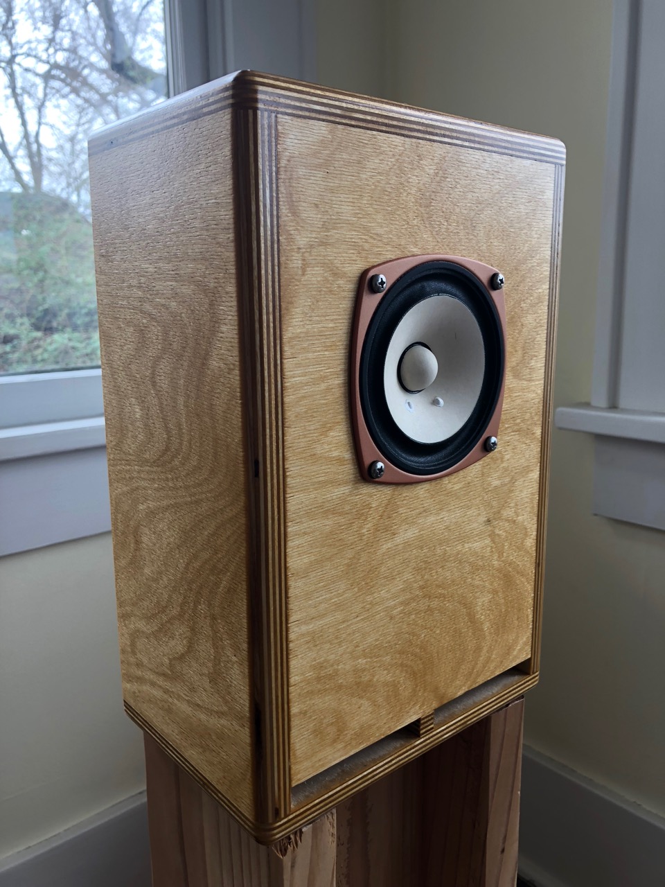

For some reason, the pics I posted above look excessively yellow. In real life they look like a more natural birch. Here are some pics in situ. First few show the golden ratio placement, last few show the current location, where they sound better (and soothe the savage beast).
Also pictured is the breadboarded 7C5 amp I've been designing.
