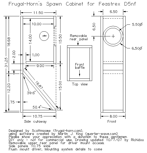

I printed out a Freddie Chang Single Mouth Moose BVR Horn 1vo box plan for the Feastrex D5nf. The problem is that the the sketch of the finished box shows the driver position a little down from the top. But the box piece plan sketches show the driver right at the top. which is correct?

i'm no authority on this, but i did see somewhere that the driver shouldnt be placed right at the top of the front baffle - it might have been on the frugal website.
I've been reading up a bit about 'speaker desighn just recently and drive units are placed to stop the formation of standing waves, maybe Dave (planet10) would be better qualified to answer.
Haveing said that, most of the single mouth bvr enclosures have the driver placed roughly 1/3rd the ways down the front baffle.
Original sketch ... 8.5?
Hi Dave,
The only sketch I have is the one alongside the technical piece drawings.
It doesn't have any dimensions on it, but it looks like the driver center is about 5" from the top of the cabinet. Is that the original sketch you were talking about? Or was there another drawing that I didn't notice?

The drawing i made is based on a sketch here somewhere on the forum drawn from Scott's verbal discription ...
dave
The picture originally appeared here:
http://www.diyaudio.com/forums/feas...fullrange-drivers-feastrex-8.html#post1318851
I closed that domain and the link broke.
Here is the picture again, for anybody who might be curious. Remember to make a donation to frugal-horn.com if you build this design.
I built them from solid pine, the cheap shelving stuff from the BORG, white pine from northern Europe. Those speakers sounded awesome! Best I ever heard the D5nf, and I've heard a lot of them. Even Mr. Teramoto heard them at mluckow's house during RMAF 2008 and really liked them. They like no bracing and no stuffing when made of soft white pine.
