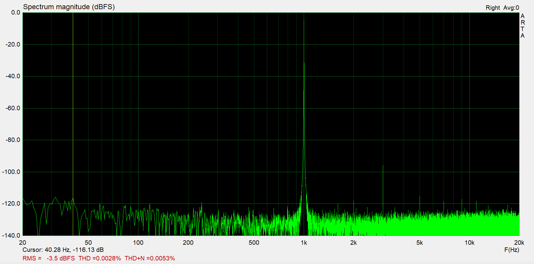

Might be useful to someone so I measured THD+N on this DSP with PCM1798 DAC. Fed with SPDIF in and E-MU tracker Pre as analyzer I got this result:
