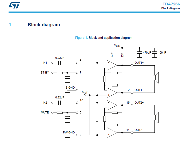

I wonder if someone tried to make from a chip amplifier a current amplifier design (inspired by Esa Merilainens - current drive info Website) if that is technically possible.
Maybe it is easier to do that with a chip amp or it is not possible at all. At hand I have some amplifier with TDA7266 soon - which has two times seven watts.
Would like to hear some feedback on this, maybe a modification of an existing mini-amplifier from the far east which could be found easily on ebay.
It would be enough for me to have two times five watts, just in order to hear such an amplifier together with classical fullrange loudspeakers with double cones.

Unfortunately it can't work with a bridge-tied load amplifier and it can't work when the feedback network is internal to the amplifier chip. Yours appears to be both of those things.
Reactions: 1 user

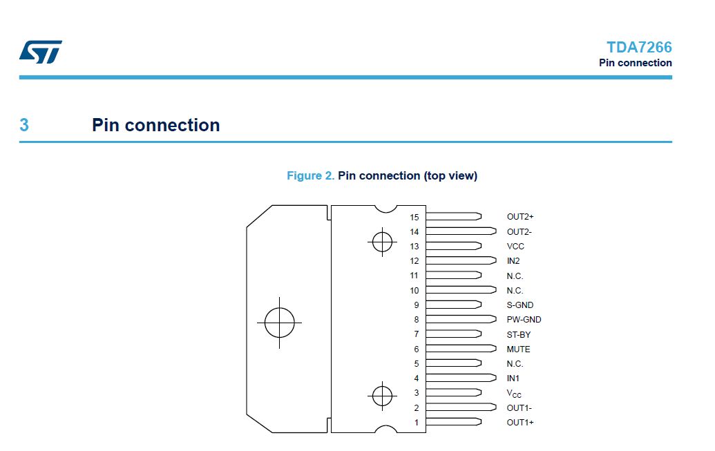

Here is the pin connection, maybe it is more secure to know where to attach directly at the chip for wiring.
I would be grateful for a hint.

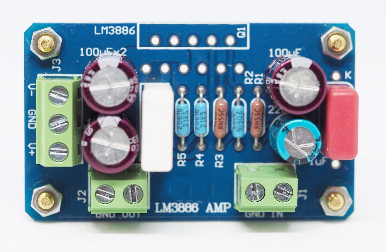

Makes it sense to buy this ready made gainclone with hard wiring from Ebay using LM1875? And find there the feedback point to work with the rewiring? (See attachment).

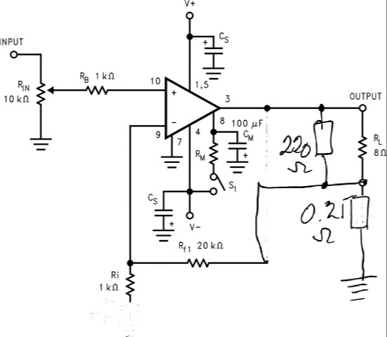

@adason
This looks very interesting.
Did I catch it correctly? You added just 220 ohms in between plus and minus of the loudspeaker output and you put 0,22 ohms into the minus output to the loudspeaker.
And you just lift off the leg of one resistor (feedback) and attach it in between the output-ohms?
This seems to be realizable even for me who is more into loudspeakers than electronics.
Easy mod!!

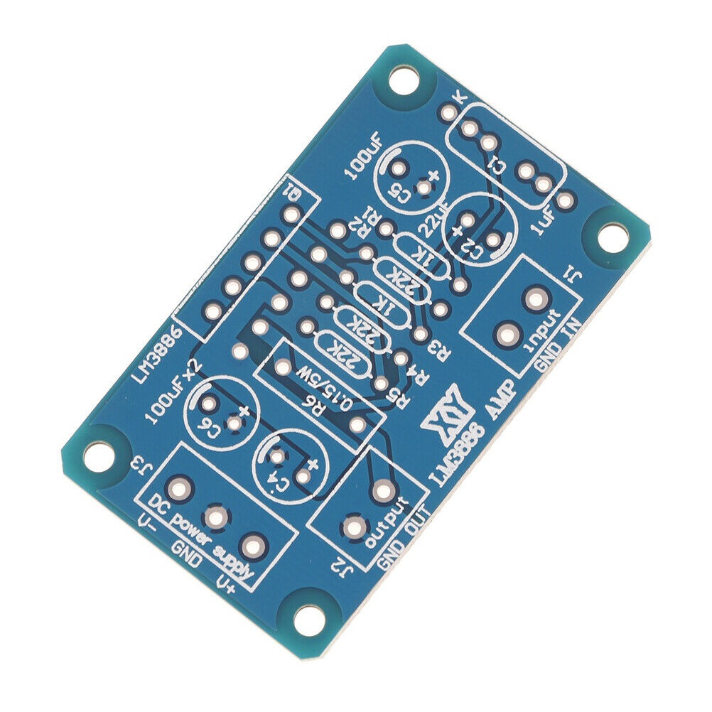

Like this? Sorry for awfull graphics, done on the phone...
Thanks.
Much clearer than trying to imagine "in the air" through verbal explanations ... even in a relatively simple circuit such as 1875 uses.
20220906_221940-jpg.1088359
It does work as intended (pure current drive), in principle, but with some side effects.
* original closed loop gain (the regular way to use it) has (20k/1k)+1=21X ... which is fine .
Since that amp can put out some 20W@8 ohm so some 12.6V RMS,its sensitivity is 12.6V/21=0.6V=600mV
Nice, comfortable, easy to drive.
* now if we add the "constant current NFB" network that way, we are adding its "gain" too .... more exactly "multiplying".
That network will give extra (8r/0.25r)+1=33X
Multiplying both we now have huge 21X*33X=693X
Sensitivity is now 12.6V/693=18mV
Might be good for some uses (direct microphone input? Rock Guitar amplifier?) but for ost uses,say after a preamp or almost any active Audio source it will be too much.
Besides, that gain also extends down to DC, so any minuscule offset turns into highish output offset.
* my starter suggestion (and that might be all that´s needed) is to short the 20k NFB resistor, and leave out the 1k one (it is shorted anyway by the 0.25 ohm one) so now we have 33X gain (which is manageable and comparable to "original" gain), reasonable sensitivity (12.6V/33X= 380 mV
And MOST important: now we have current drive .
Notes:
* there is still some power wasted in the 0.25 ohm resistor, but it´s nothing compared to, say, putting an 8 ohm one in series with speaker.
And which would still not be "current drive" but only "reduced damping"
  • it may be refined better but for a quick simple solution it´s good enough.
  • thanks to having an actual schematic to work with, a straightforward suggestion may be made ; otherwise we are never certain.
    * I didn´t even mention the 220 ohm resistor since it´sway higher than any impedance an 8 ohm speaker can take, so we can safely ignore it and simplify Math.
  • one image is worth 1000 words DOES have some merit ;)
