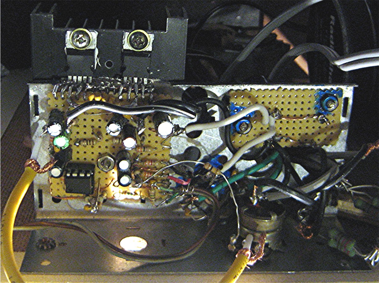

Stable 10 Watt Amp
Here's that 10 Watt 2 X TDA2003 Amp I built for my record player project. Proper ground wiring resulted in an amp that was completely stable under all conditions of my usage!

"shorted turn" alert!
google that concept and remove that yellow wire.
that's not a place to tap into chassis!
No need for Google. There's no complete circuit around the core of the transformer and hence no shorted turn.
I do take the point that there's no need to earth at that point though.
It was just a handy spot to use during the build and testing when parts were being moved around. I have a much more appropriate and neater location for that chassis connection in mind. :)
if you are deriving ground from the mounting bolt on top, it is a shorted turn.
it may not be as very bad one but it still meets the def, I think.
just wanted to point it out. other than that, I like the layout a lot.
If that yellow wire connects directly to the chassis somewhere at its far end, it's a shorted turn. Otherwise, whatever it's connected to has a one-turn secondary in series with it and ground, and is getting one turn's worth of AC voltage from the transformer.
I'd even want to put an insulator (at least electrical tape, or maybe something more elegant that matches the rest of this thing) over the threads and that plate so I wouldn't be tempted to use it as a temporary ground for a meter probe (or put a sticker on each one saying "Not A Ground"). There's surely measurable AC between the top of that thread and any chassis connection.
The other end of the wire is isolated from the chassis.
But like I said in an earlier post, I'll move it.
I'll relocate those earths to posts beneath the boards.
There's no good reason that it's connected there other than convenience when parts were being moved around during the construction.
I must admit that I hadn't considered that. Thanks!
Thanks for all the comments folks. Compliments and constructive criticism are equally appreciated. :cool:
