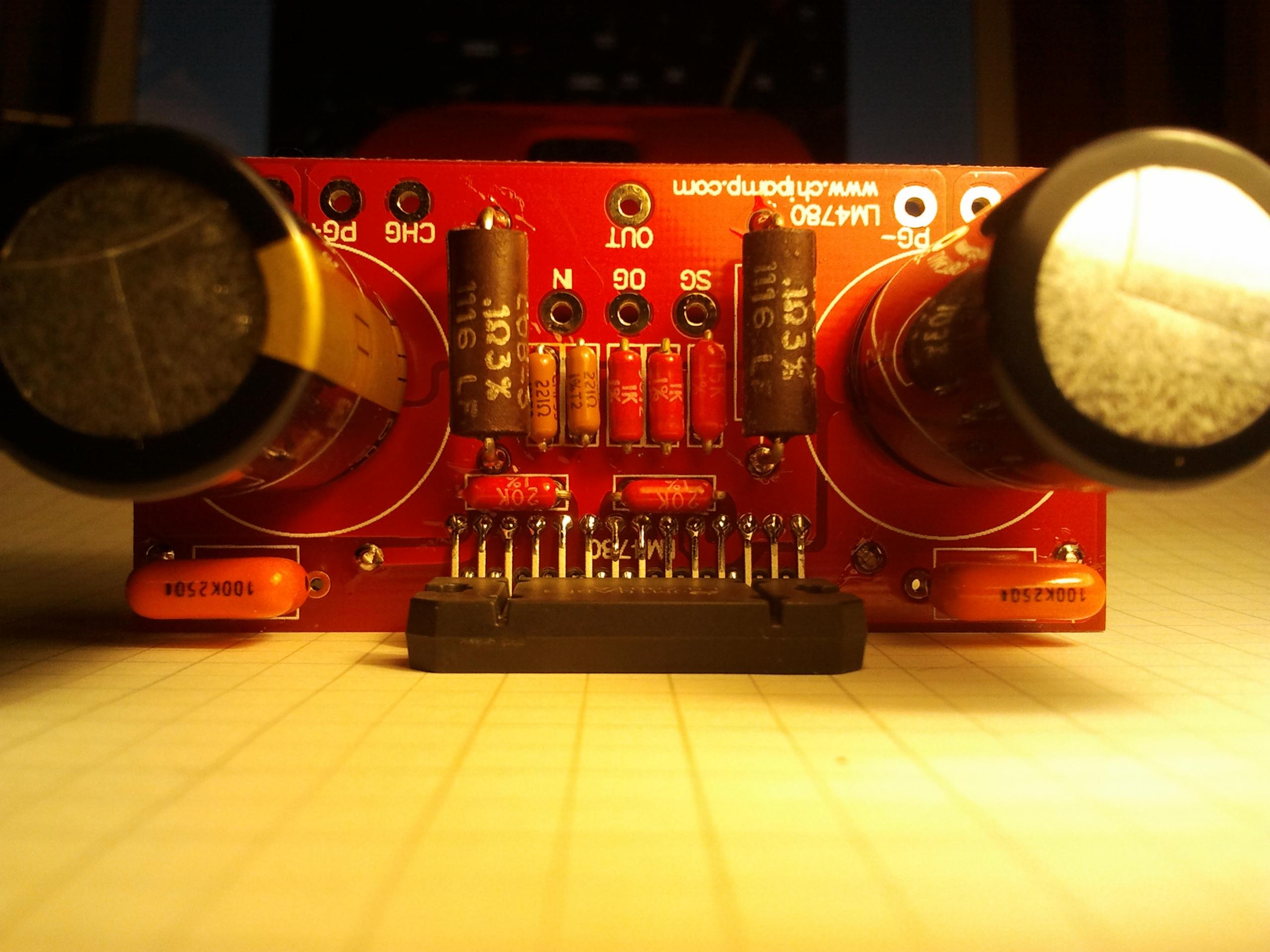

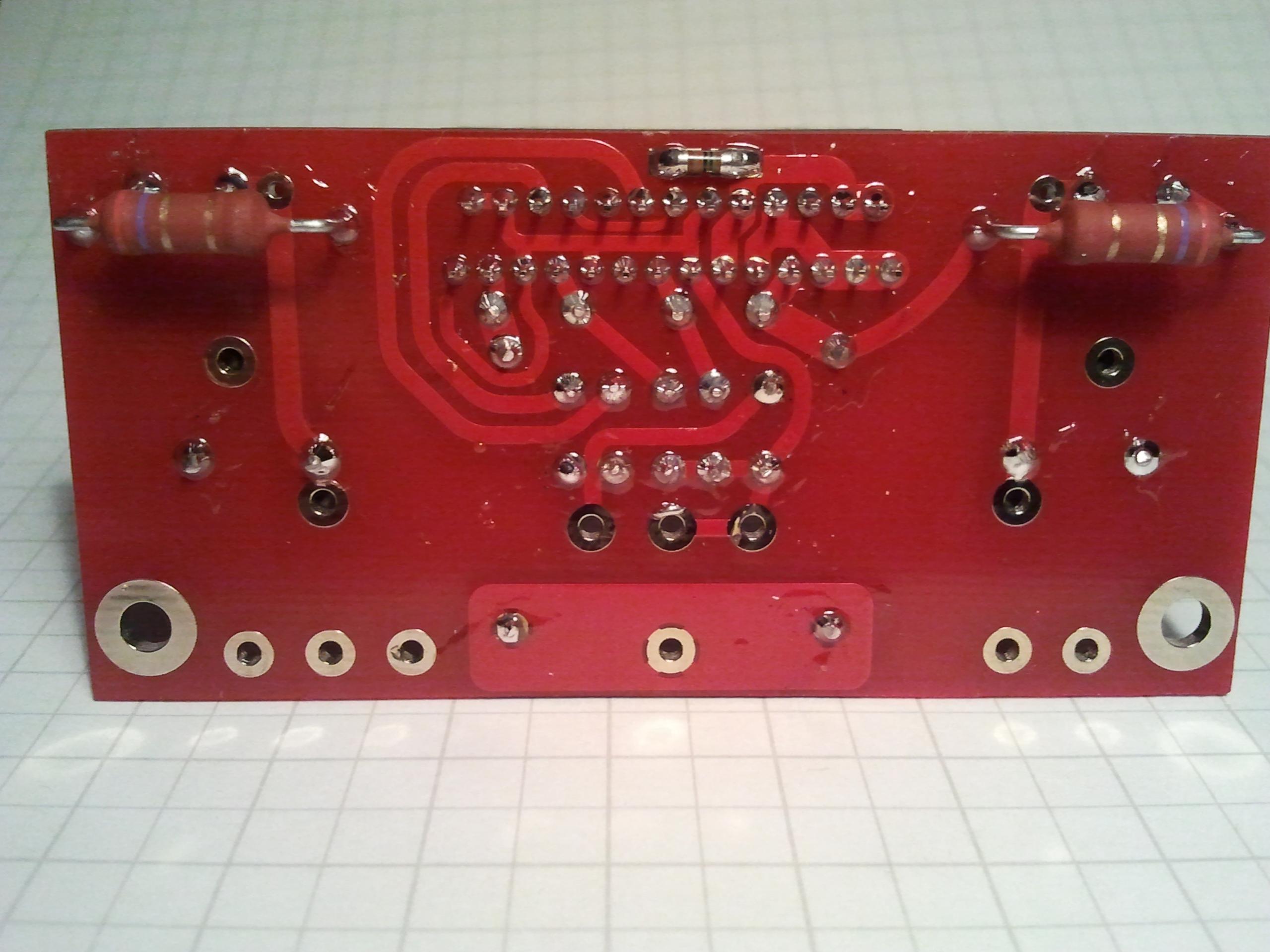

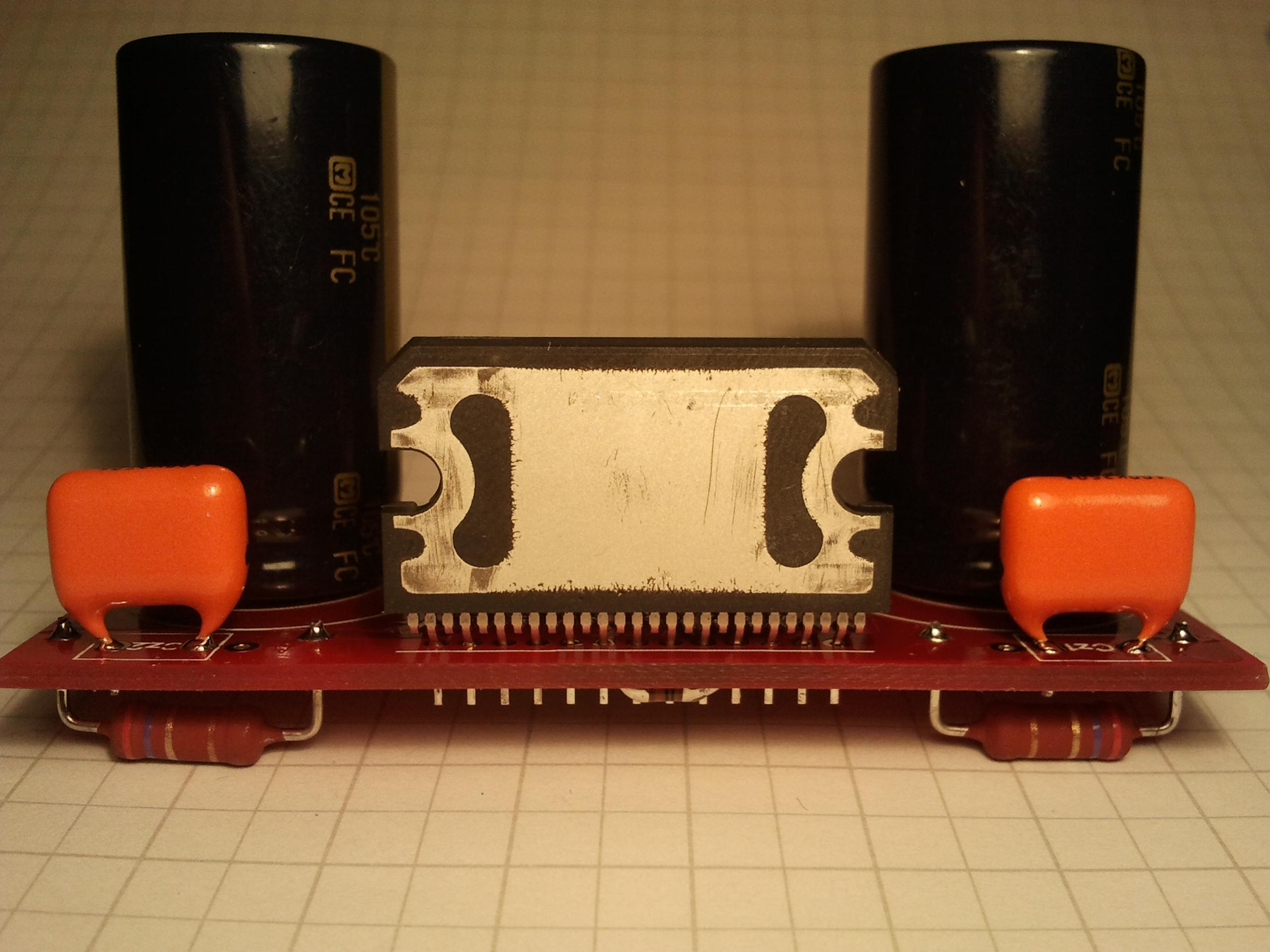

I saw that someone was wondering what the dimensions of one of the chipamp boards was, and while I can't help him with those dimensions, I can put the dimensions of the LM3886 Mono Board up here for people to see. I finally got it populated today and will spend the next few weeks (family, job, house and all) building the enclosure for them. Well, here is the link to the pics:
I also ordered and built the LM4780 Parallel board [LM4780 (1)] pics here:
And I ordered the LM4780 Bridge/Stereo board [LM4780 (2)] but have not put it together yet. Here are the pics of it as well:
Since I was at it, I took pics of the ChipAmp power supply. I am using one per LM4780 parallel amp.
I needed something to do this winter I guess.

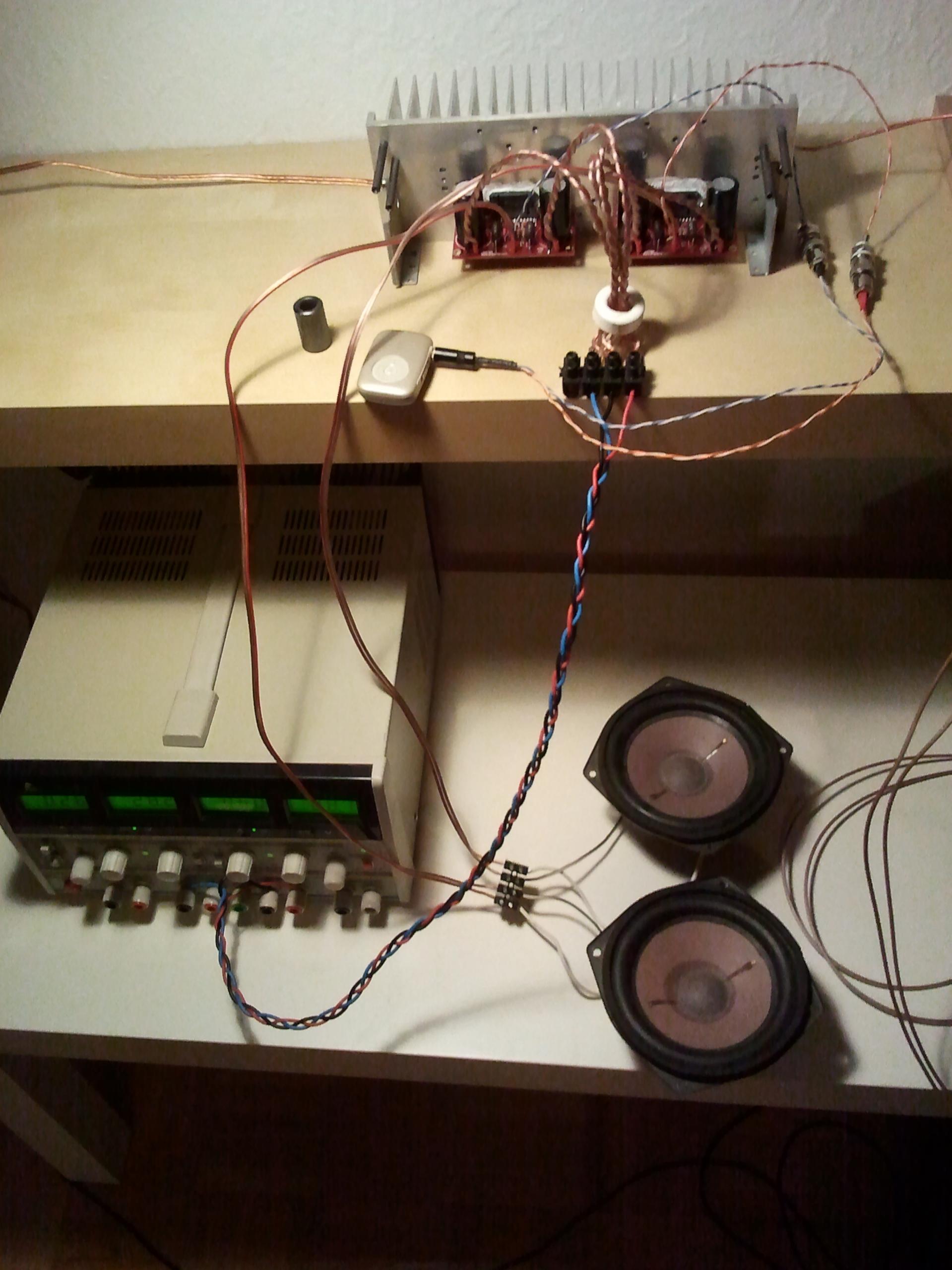

Slowly working my way forward towards a working amp. Another weekend coming close so perhaps some progress in a few days. Anybody else?
As for feedback on the boards itself I would say that I would have been really pleased to find either some surface mount pads or holes for the standard 220 pF caps that protect against EMI/RFI as I suspect some people will use these amps connected to MiniDSP and similar which sometimes emit residual switching noise. The caps I suspect would make that problem a bit smaller. It could be omitted for the less is more crowd.
The amps are finished. A big thanks to ChipAmp and Joe for the Beta Boards. My boards were incorporated into a three channel amp where the Beta boards are used for the bass channel and a normal two channel LM4780 board (from AudioSector) is used for the mids and highs. The filter used will be a MiniDSP 2x8.
My feedback is the following:
1. The power supply holes are two small as mentioned earlier. Nothing over 1 mm2 fits easily.
2. I'd love for normal size resistors (i.e. 10 mm pitch) to fit rather then the small profile (MRS16 et al).
Other than the above the boards are great and the quality exceptional. The amps sound great.
