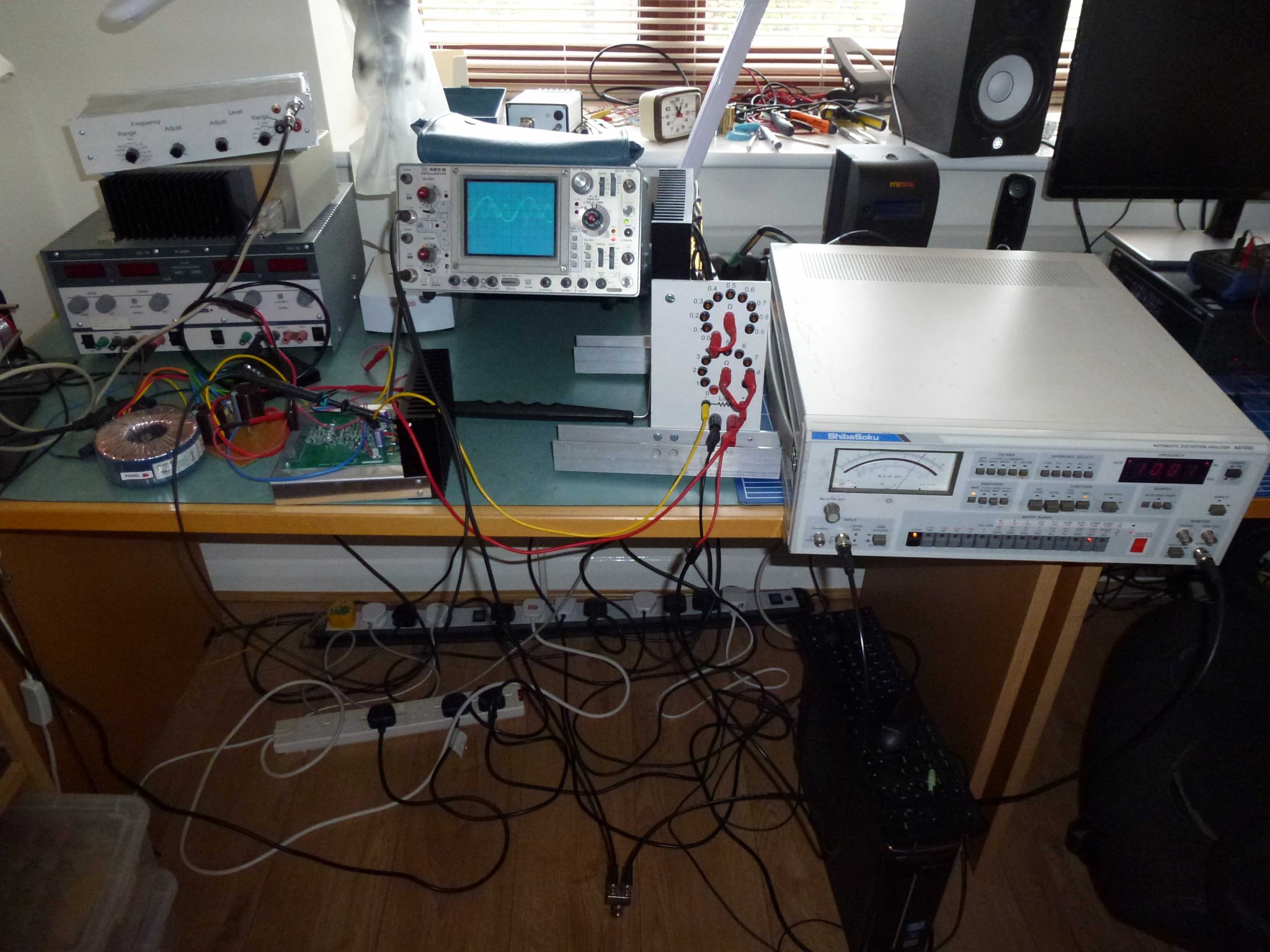

A slightly different circuit strategy was described in Linear Audio - Volume 2. In it Kendall Castor-Perry described a concept labelled 'Class i'. The picture shows a prototype that uses the idea. It doesn't require any presets or adjust on test resistors and the output is Class A/B and provides a relatively smooth transition cross over transition.

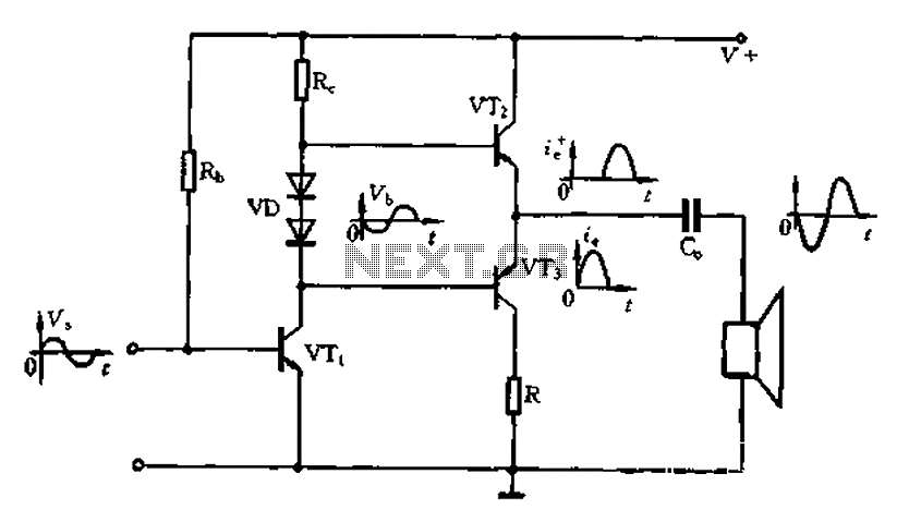

I had built someone a small 2-stage complementary push-pull, something like below. The buyer was of the opinion that this box sounded like his 300B;-)
I meant the comparison of components, not of circuits. But you can also track down the sound of circuits;-)

Well, it will put out about the same power, and VT1 operating without a bootstrap has a LOT of 2HD. Probably a DF of about 1 with no NFB. With a good set of modern sustained beta outputs, and the diodes selected to give say 100 mA of bias current the whole characteristic is going to be dominated by that first stage. Will it sound like a 300B? Probably more like one than your typical SS amp.

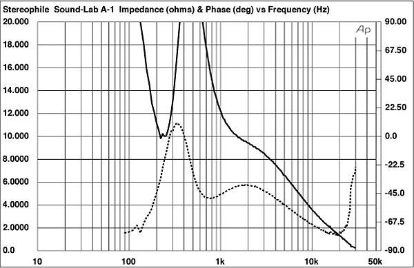

Maybe no amplifiers are good if they sound a little different with very difficult loads (including for stereo imaging of real music, or of equivalent multi-tone test signals)?They were not good.
Maybe a real world load like this:
IME not all "good" amplifiers sound equally good with all loads. That includes Benchmark AHB2.

What problem? My Sound Lab Majestic series ESL panels (different series from A-1 but still a bit of a challenge to drive) sound very good with dual Marantz MA9-S2 mono blocks. Can't say the same for some other amps I have tried. Some are better than others though....the problem...
